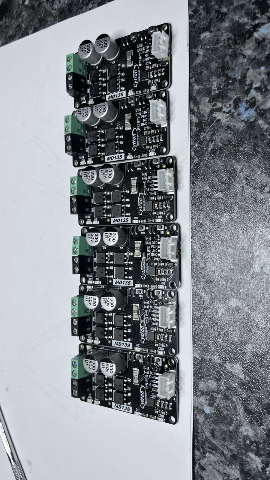

  3. Martwana
    Martwana New Member
    Jul 28, 2025
    41Coins

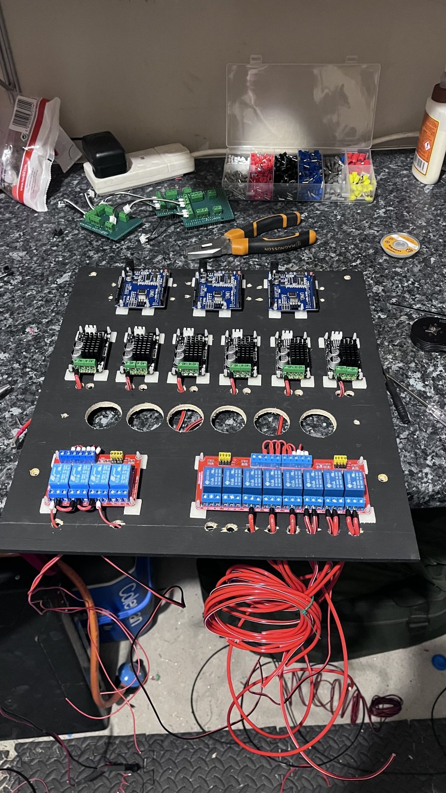

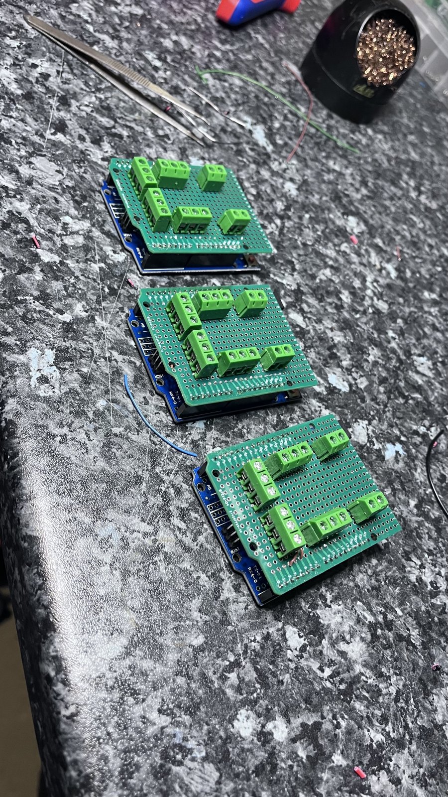

    RE Arduinos: Perfect, I knew there would be a good reason and that’s good enough for me!
    For the drivers, and the ECB in general, I just want minimal wires and for it to be very neat, so I’ve removed the original connectors in favour of a 3 pin JST and will make my own cables so they can be routed as required.

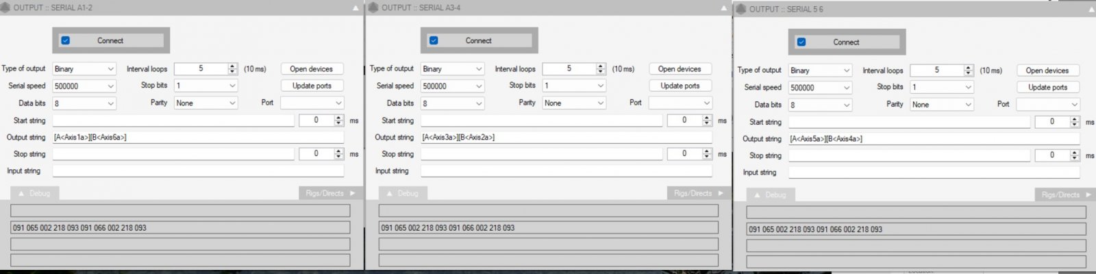

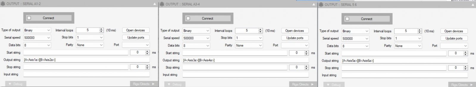

  8. OrtiMai
    OrtiMai New Member
    Jun 29, 2025
    19
    66Coins
    @Ronan Design Hi Roman, with regard to my question, I think the only difference, that I see right now, that I used the "serial output alignment" according to the FlyPT model.
    E.g. Serial A1-2 = [A<Axis 1a] [B<Axis 2a] and so an. And not like you A1-2 = [A<Axis 1a] [B<Axis 6a]
    Please see the attached pictures.
    Does that cause any problem with SMC3?

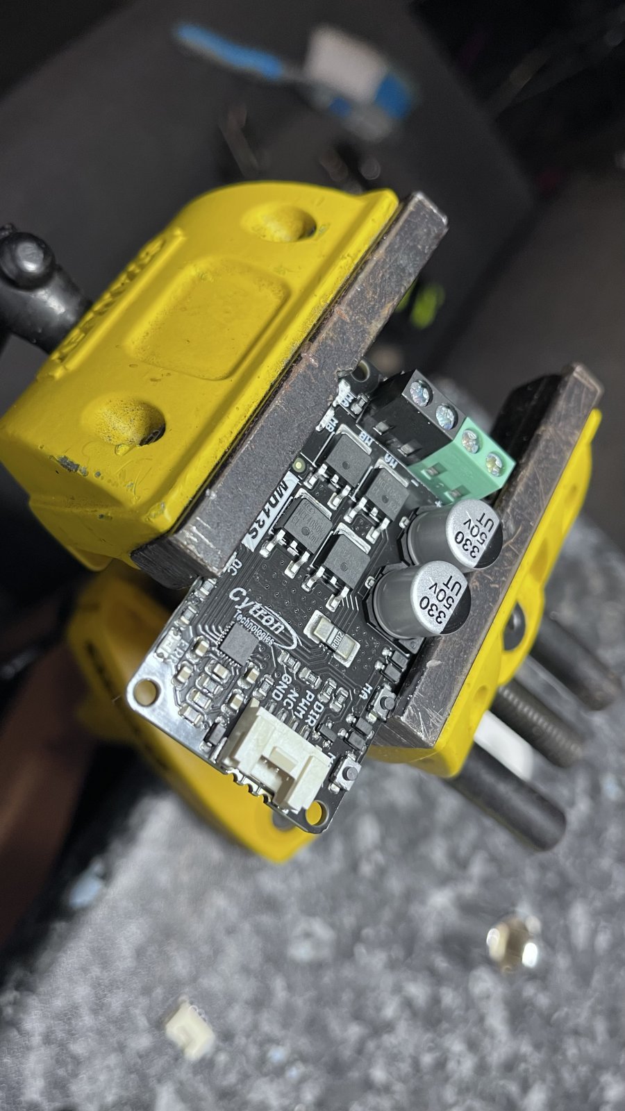

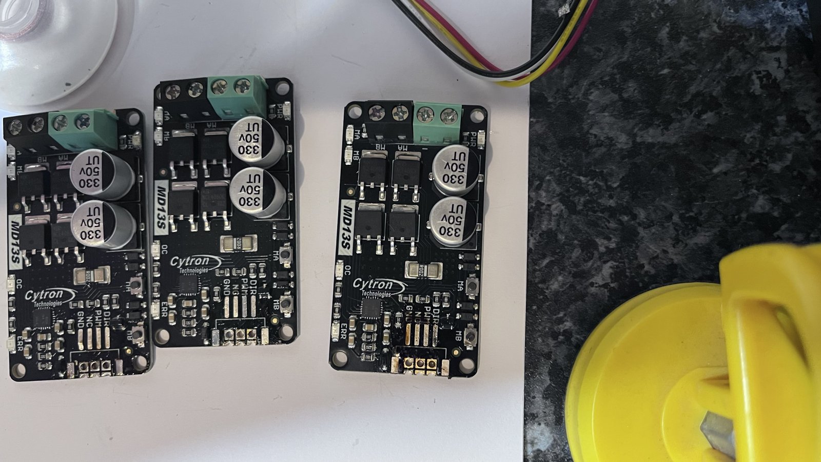

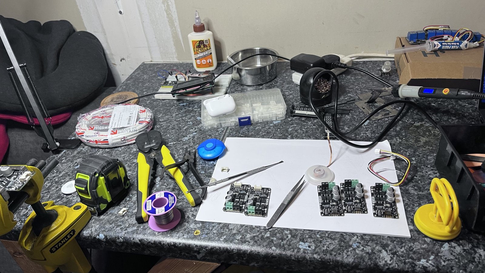

  9. Martwana
    Martwana New Member
    Jul 28, 2025
    41Coins

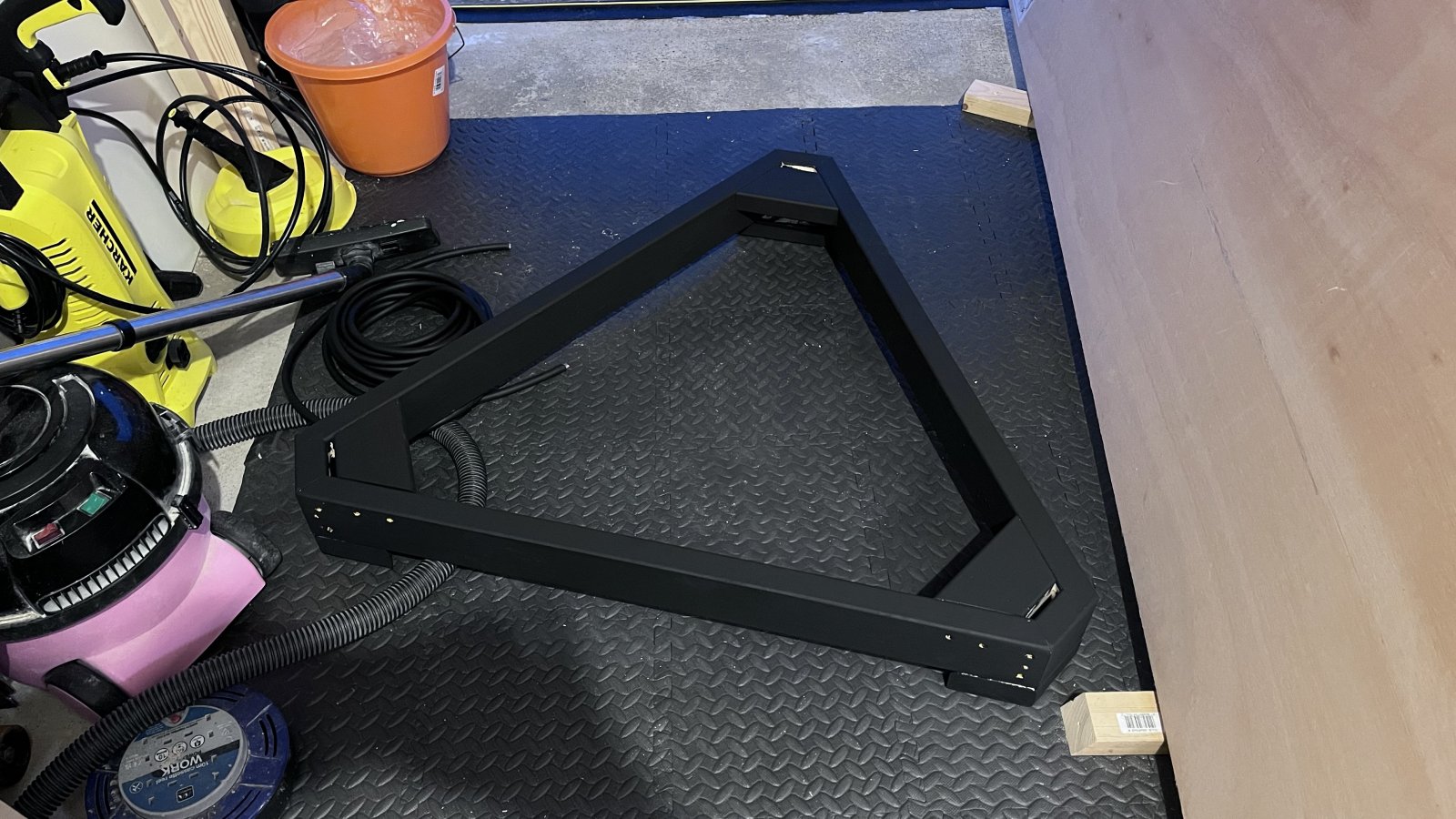

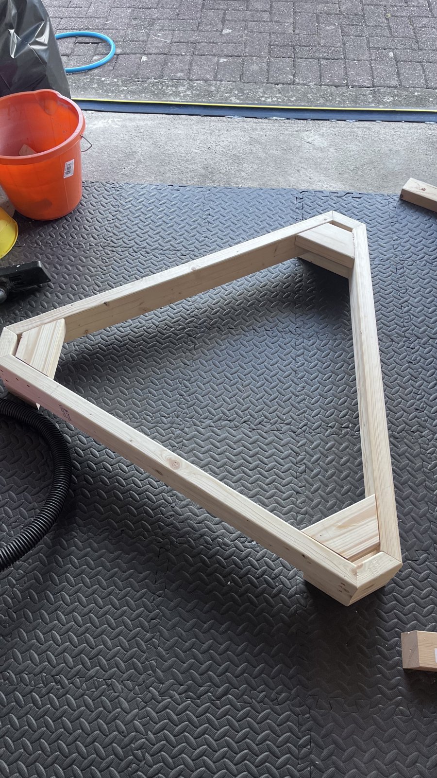

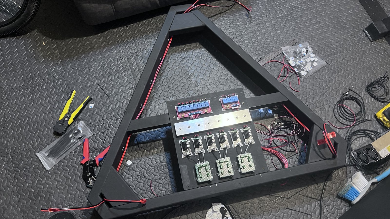

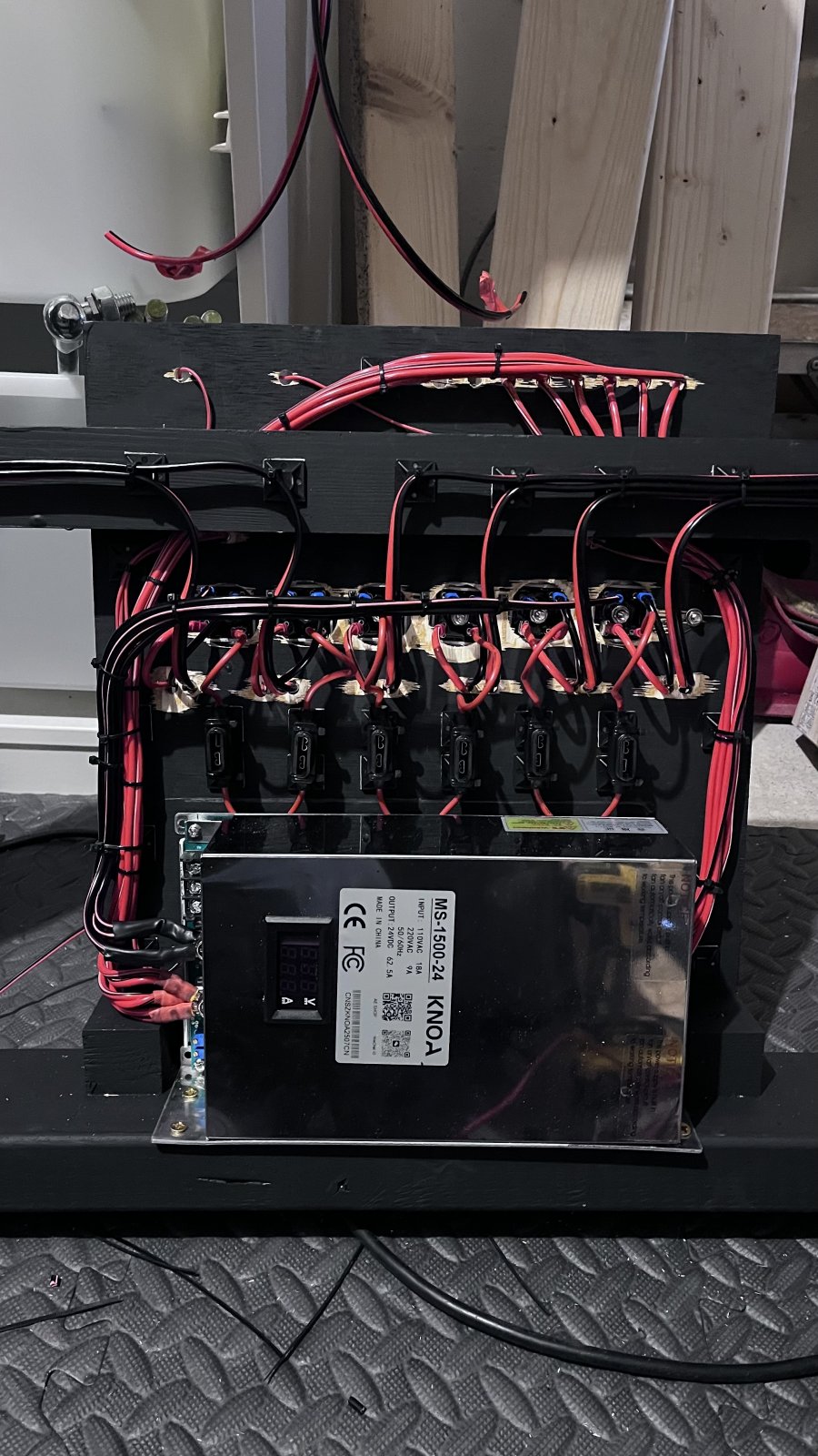

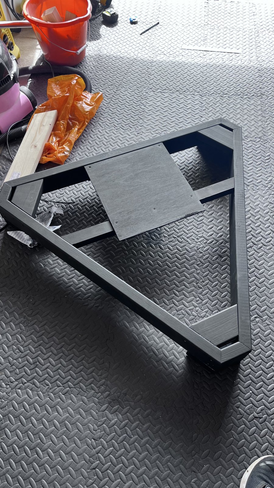

    I’ve thoroughly enjoy this build so far. It’s mostly going to plan too.
    I had a look over the build guide and notes and read them end to end twice, followed your blender model for the frame sizing and I’ve broadly followed the plan for the ECB.
    I did however make some changes you may consider putting in your plans.
    After working out that the motors will draw 13A at full load, I realised that the relays are only rated for 10A. With 20A fuses, 16 AWG cable and 10A relays, the fuses should really be 10A as the lowest rated component is the relays. If I start to blow fuses, then the fuses and the relay board should really be upgraded to high current ones. I do believe however, with the correctly sized gas struts fitted (still to source)
    So I’ve added a second 4 channel relay module to handle the runaway stop switches, then have each motor on its own relay. I'm also powering the relay boards with their own 5v supply as turning on 6 relays was drawing too much current causing the Arduino to drop to 3v and crash.
    I’m also using a sheet of aluminium as a common heatsink for the rectifiers. I’ve opted to use them in full bridge mode to protect the GND rail too. It technically doubles the heat produced but is electrically more sound.
    Last night I had a motor powered for the first time and turning via the motor driver buttons after verifying all this cabling using my multimeter.
    Still to solder the Hall effect sensors and print the rest of the brackets once I’ve done a test fit of one. With all these cables being laid out the way they are (which I do think looks very cool), I’ve struggled to keep the shielded audio cables clear of cables, but will test and see how it performs and make adjustments if required.
    Custom perfboards turned out great. It makes the arduino a hot swappable. I’ve aimed for everything in this build to be removable/replaceable should anything go wrong. Connectors over soldering where possible. My little boards bridge that gap in one place that’s easy to test. Might consider getting a handful of PCBs made to formalise the design.
    Plan is to put an acrylic cover over the electronics and add some small fans to push air over the heatsinks.
    I’ve marked up and will make the motor mounts tomorrow. I’ve got some 5mm angle steel that should do nicely.
    More updates to follow!

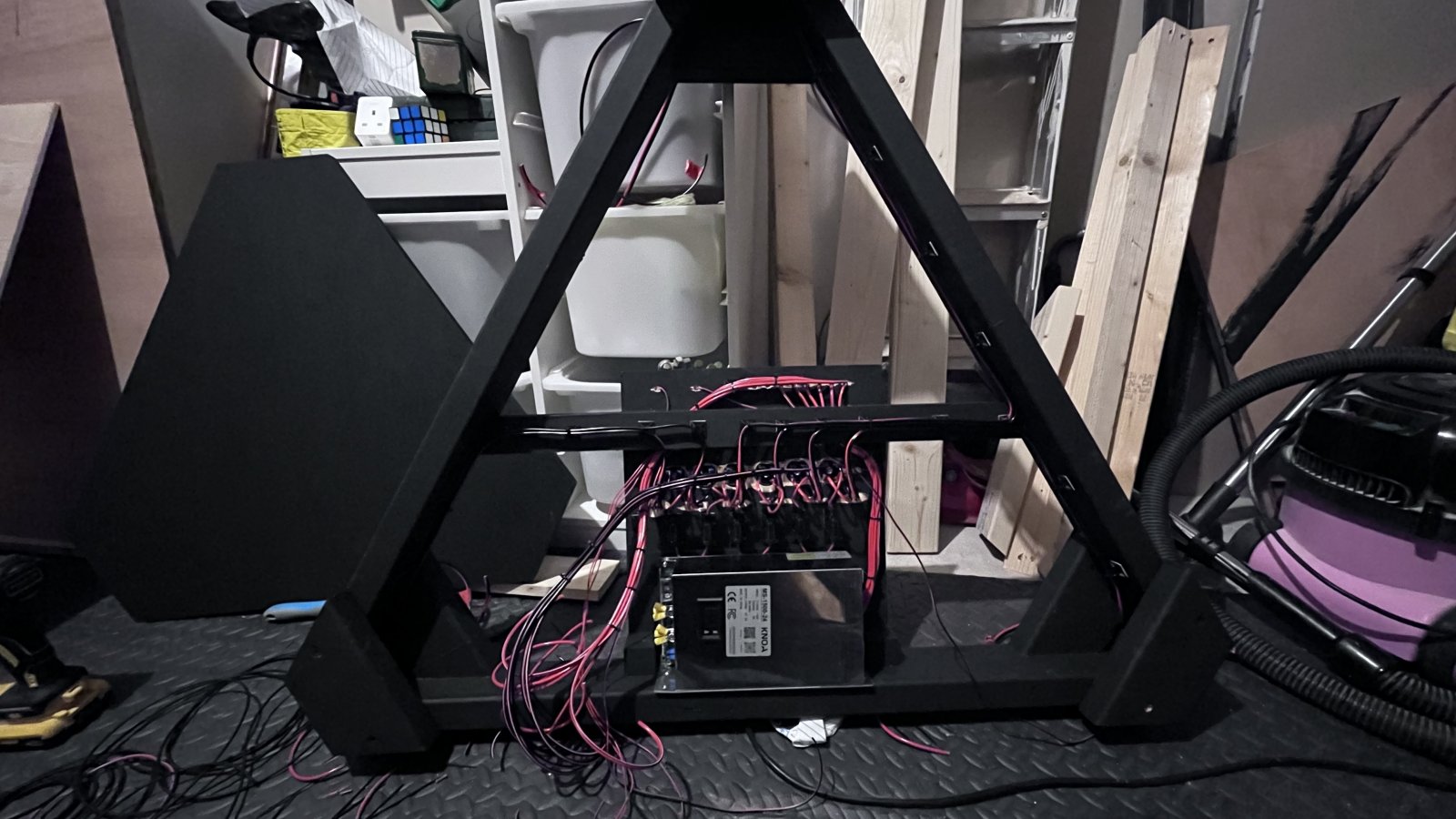

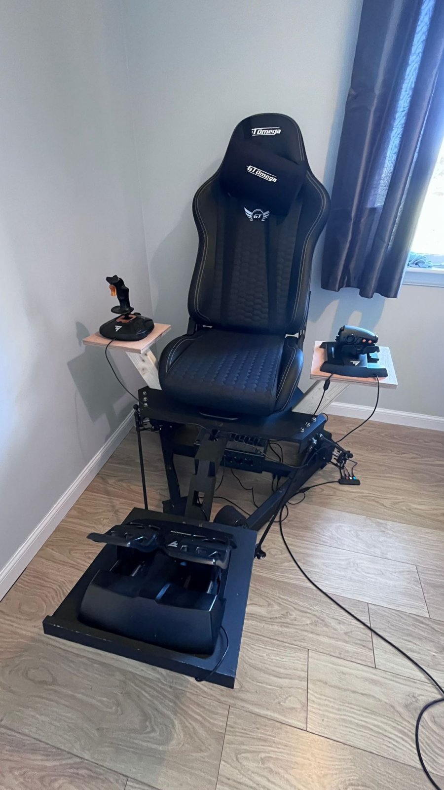

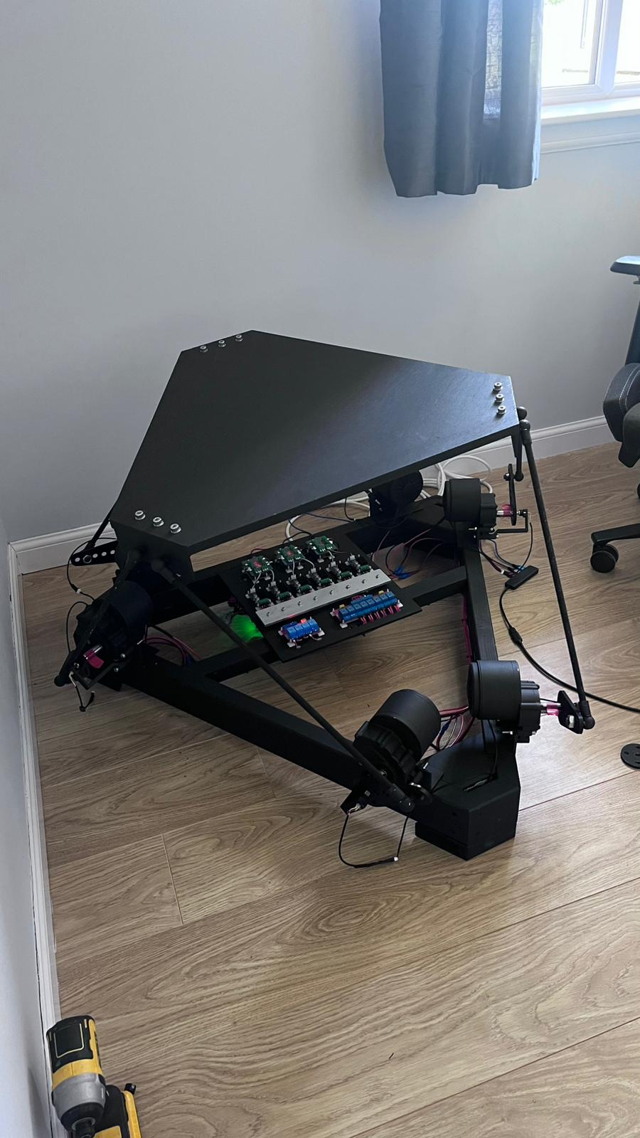

    Okay, so the MVP build is complete and I'm all tested out - time for VR tonight!
    As it stands, my PSU is running at about 40% load with me sitting on the rig and it parked in the middle of the range. It can still throw me pretty well without gas struts. I had a hard time getting them placed well enough that the footrest didnt end up in the air.
    My electronics box is now enclosed with some fans driving air through it. I might try to 3D print some shrouds to allow me to blow air over the motors to keep them cool vs putting in gas struts, as right now when unpowered, the rig sits low which I like. I used some spare bolts and multiple nuts in the 2nd hole below where the rods are mounted to the arms to act as a bottom stop.
    WhatsApp Image 2025-08-13 at 17.26.26.jpeg WhatsApp Image 2025-08-26 at 15.19.19.jpeg
    In addition to this build, I've spent a decent amount of time with SMC3 and the Windows Utility. It's a shame that the source was lost for the windows app and its been stuck in time since it's release.
    I've been working on a new version of the Windows app, that runs in a browser and allows us to connect multiple devices at once (something I found very annoying while aligning my magnets with the hall sensors).
    I've almost got it ready for a release, so I'll start a new thread on here to get it out there and try to get some more testers.
  14. OrtiMai
    OrtiMai New Member
    Jun 29, 2025
    19
    66Coins
    Little Update:
    My answer is no. As long as all motors are set up as planned, there are many ways to realize it.
    FlyPT Numbers the motors clockwise, as seen on their model, whilest Roman set his motors up in pairs on the edges:
    • Serial 1-2: Axis 1, Axis 6
    • Serial 3-4: Axis 3, Axis 2
    • Serial 5-6: Axis 5, Axis 4
    At my Setup, I had to twist even the controllers to make it work:
    Eg. Arduino 1 is serving controllers M1 and M2. Then M1 controls Axis 6, M2 controls Axis 6. It's all crossed. But it works fine.
    You can find the correct match by loading the FlyPT test set and locate the correct motors, that fit to the desired action. E.g. for a roll left movement Axis 1 & Axis 2 should go up whilest Axis 5 & Axis 6 should go down.
    My actual problem that the ran away was in the SMC3.
    Roman gave me a test setting for the utilities, but only motor one had boundaries that worked. So I had to copy ClipInput and MaxLimit.
    Original values Motor 1
    • ClipInput: 180
    • MaxLimit: 140
    (These kept the boundaries)
    Original values Motor 2
    • ClipInput: 120
    • MaxLimit: 82
    In the Arduino IDE I found:
    • ClipInput --> ClipMin: 190
    • MaxLimit --> CutOff: 50
    (This causes overswinging)
    I took Roman's values from motor 1 and set them as standards on my arduino. No overswinging anymore and the expected behavior, when it goes into the limits. It breaks and stops there.
    It would be very helpful, if you guys could share you motor parameters and limits as well.
