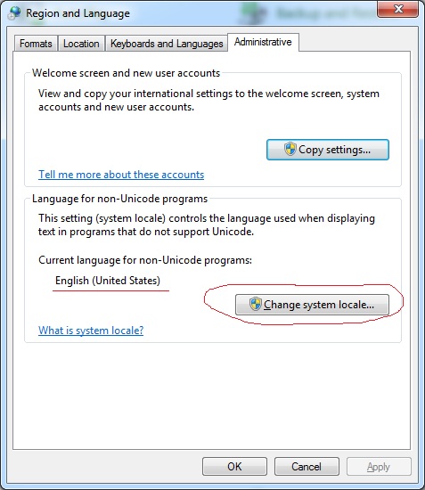

  9. tadeusz
    tadeusz New Member
    Nov 4, 2025
    34Coins
    Hi
    Thanks to for Yobuddy and Noorbeast :thumbs:thumbs
    For helping me solve my problem hug:
    Yobuddy -you are the best
    All problems are gone after change in system local.
    It is very important !!!
    Again thank you very much
    best regards
