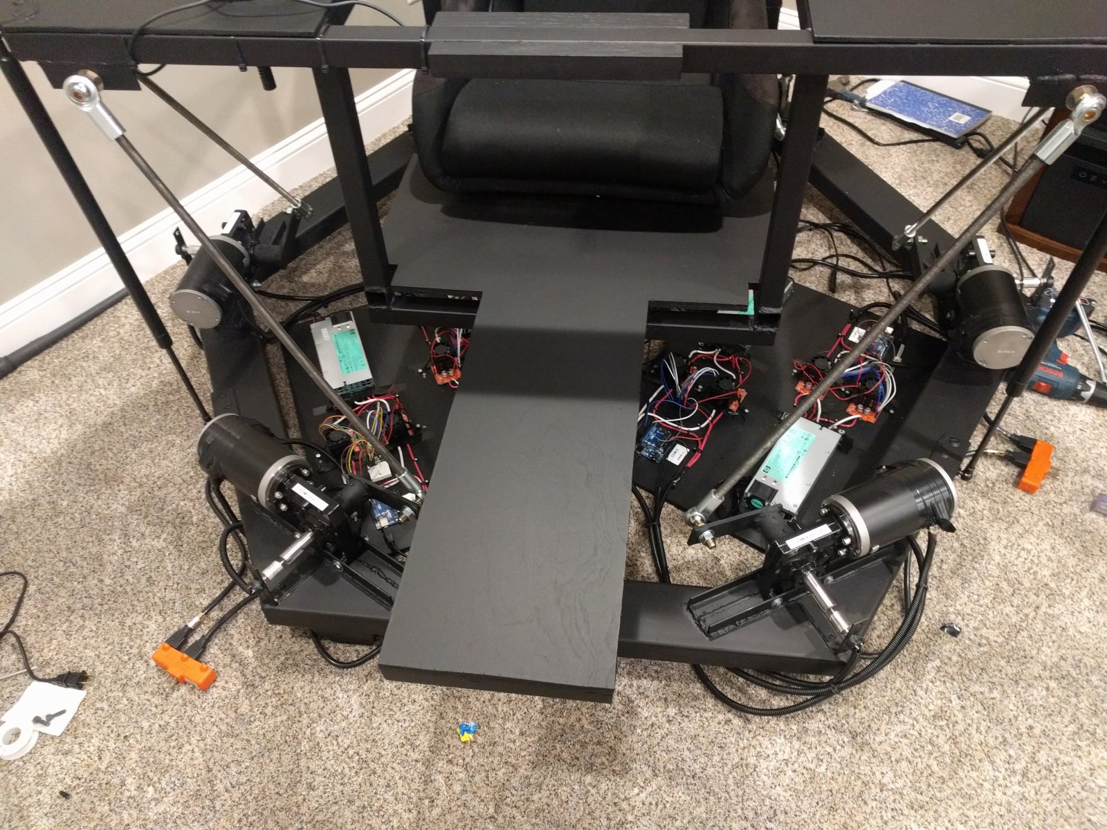

  10. CLEOPHUS
    CLEOPHUS Member
    Apr 12, 2016
    47
    229Coins
    +69 / 0 / -0

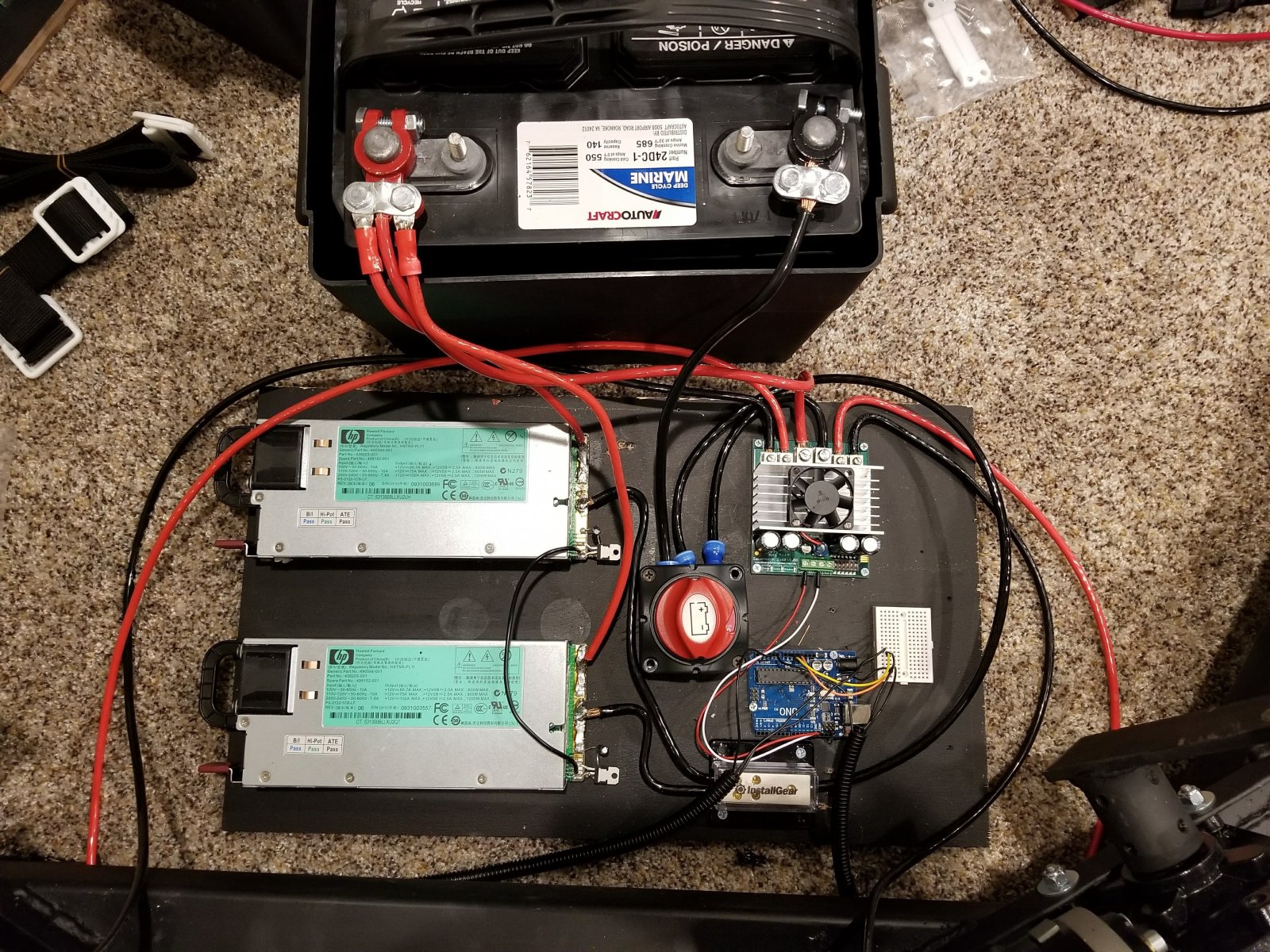

    So Sabertooth testing has commenced. Here is a shot of the new wiring for 2 motors.
    So far - they seem way better than the MM's.
    I'm able to crank the PWM all the way up without any heat at all. Can't wait to really test them with weight.
    Here is what I added so far:
    3 - Sabertooth 2X60 @ $189.00 USD each http://www.robotshop.com/en/sabertooth-dual-motor-driver.html
    3 - BEP 701 Marine Battery Switches @ $19.58 USD each
    3 - Install Gear Power Distribution block @ $7.58 USD each
    3 - AutoCraft Deep Cycle Marine Batteries (75AH) @ $84.99 USD Each https://shop.advanceautoparts.com/p...ttery-group-size-24m-550-cca-24dc-1/2080060-P

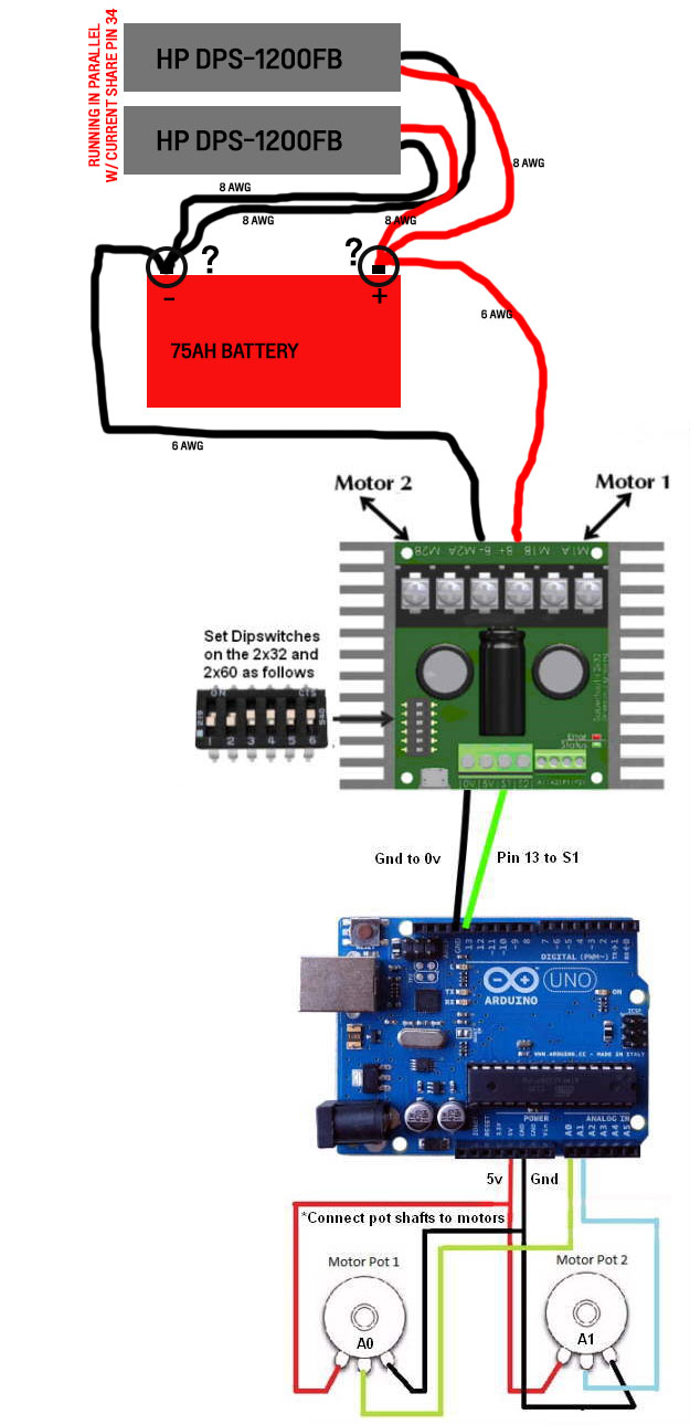

    No problems with overcharging the batteries while in use? I am in the first stages of a 6DOF and like your simple design with the 12v motors. Just trying to come to terms with the wiring you show.
    Thanks!
  12. CLEOPHUS
    CLEOPHUS Member
    Apr 12, 2016
    47
    229Coins
    +69 / 0 / -0
    I completely agree - the wiring is a bit crazy and I was overthinking it too. Here is a rough diagram I made a few weeks ago to help explain it better. The only change is the battery switch on the negative wires. No overcharging.

    Excellent thanks.

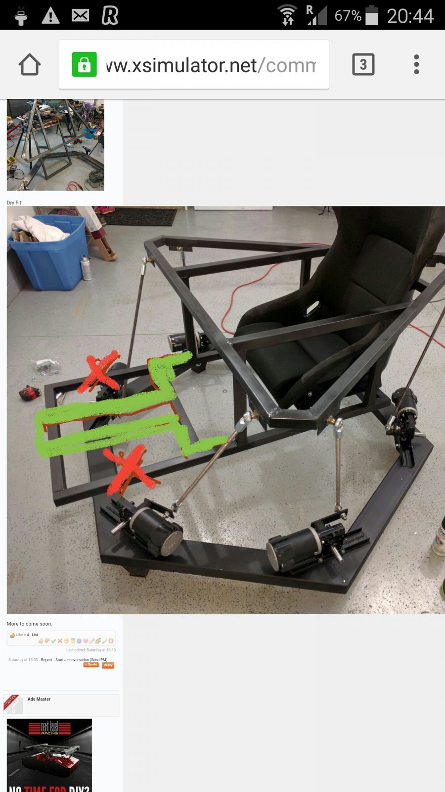

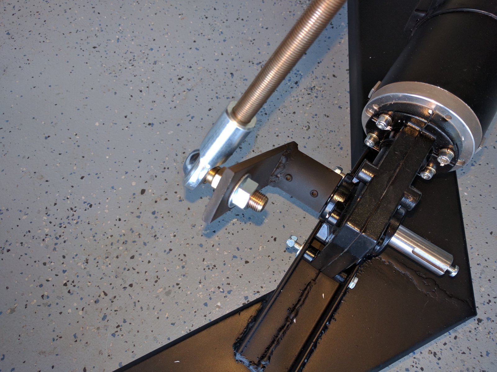

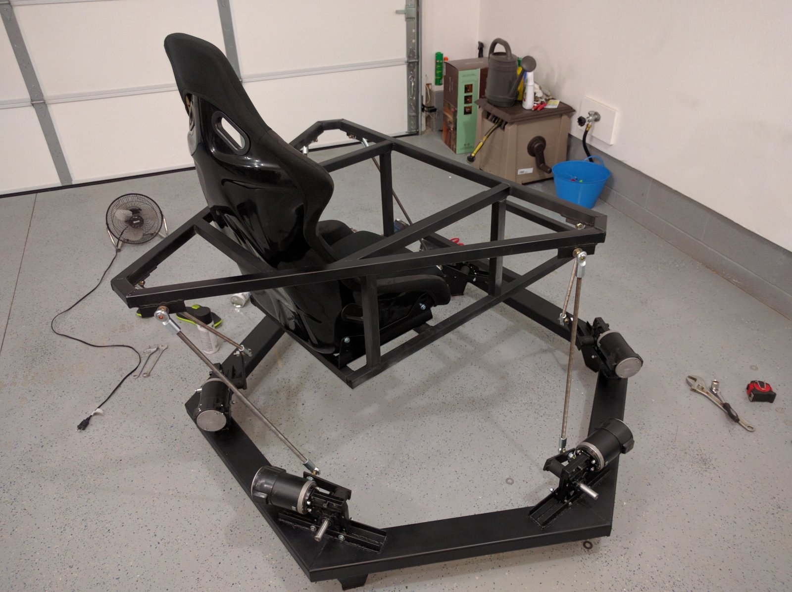

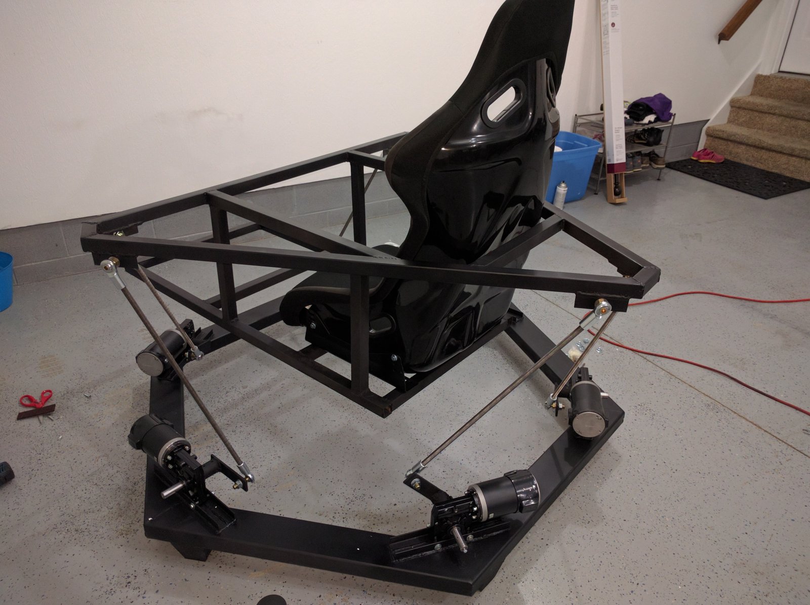

    @CLEOPHUS, I really like the neatness of your build. I'm in the midst of my own right now, using aluminum instead of steel. If you don't mind, I have a question. On the first page of your build thread, @SilentChill recommended, "Also you may need to get the arms a bit further out from the levers else they might bind in the lower position of the axis and end up bending the arms. " It sounds like you confirmed that that was a problem, and fixed it, but I can't tell from your photos what you did. Can you provide some detail? Thanks!
  15. CLEOPHUS
    CLEOPHUS Member
    Apr 12, 2016
    47
    229Coins
    +69 / 0 / -0
    I ended up doing exactly what he drew up. The first image is the original design with his drawing and the second is the final design. Hope that helps.
  16. Squonk
    Squonk Member
    Aug 29, 2017
    93
    USA
    482Coins
    +86 / 0 / -0
    Thanks. I saw that you modified the support for the pedals has he suggested. I was wondering more about what you might have done to "move the arms out from the levers." I apologize if I am missing something obvious. Did you somehow modify the mounting of the arms to the levers on the motor shafts?
  17. CLEOPHUS
    CLEOPHUS Member
    Apr 12, 2016
    47
    229Coins
    +69 / 0 / -0
    Sorry - I misunderstood your question. That photo was taken just as a dry fit, so I agreed with him that they appeared to be at extreme angles. Once fully assembled and levers were set to the proper angles, everything was great - so no modification needed.
