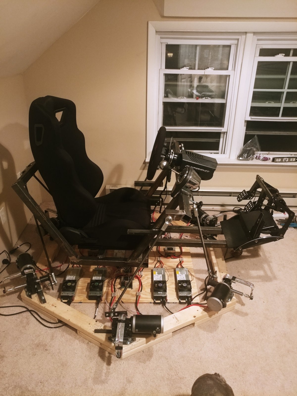

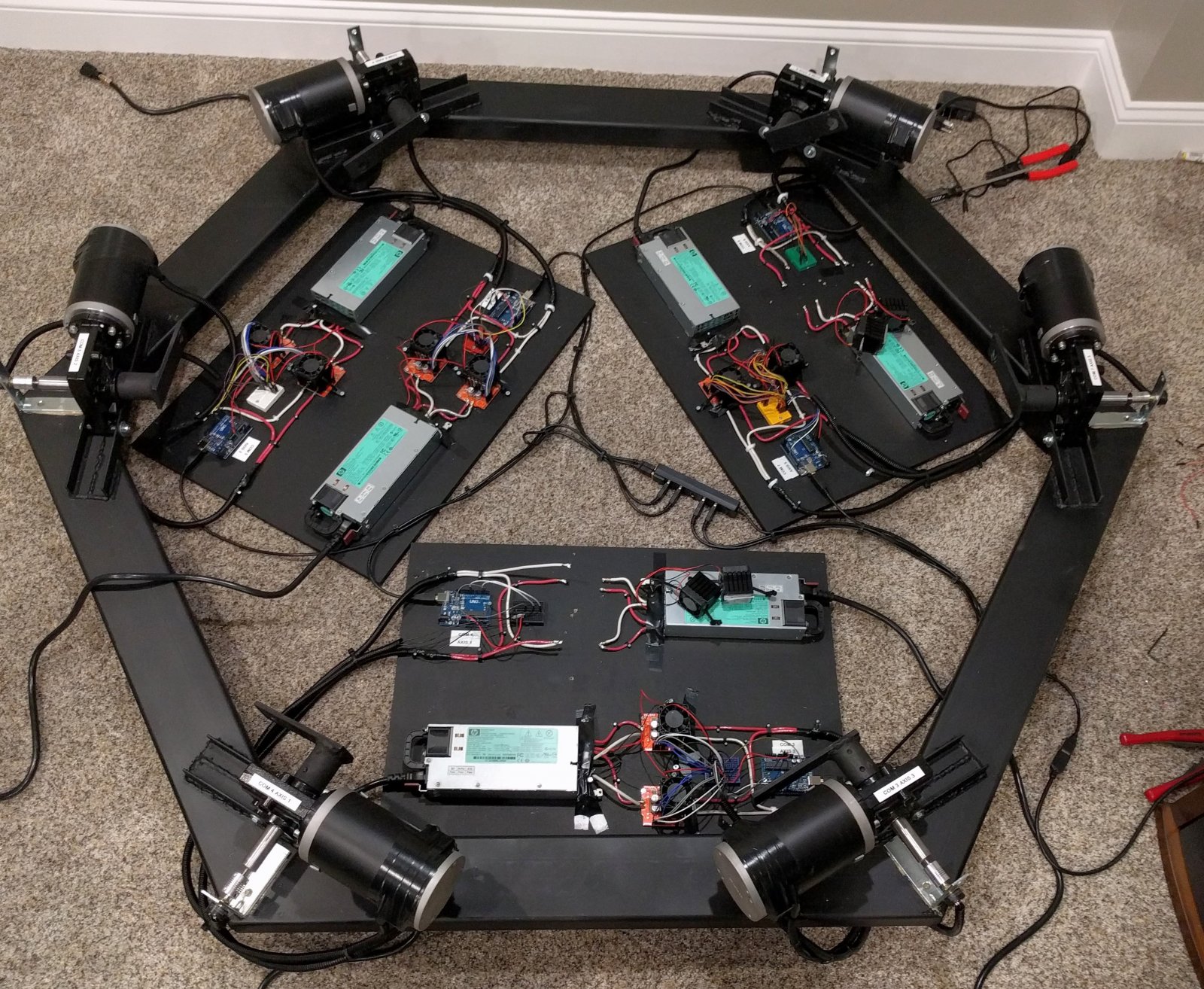

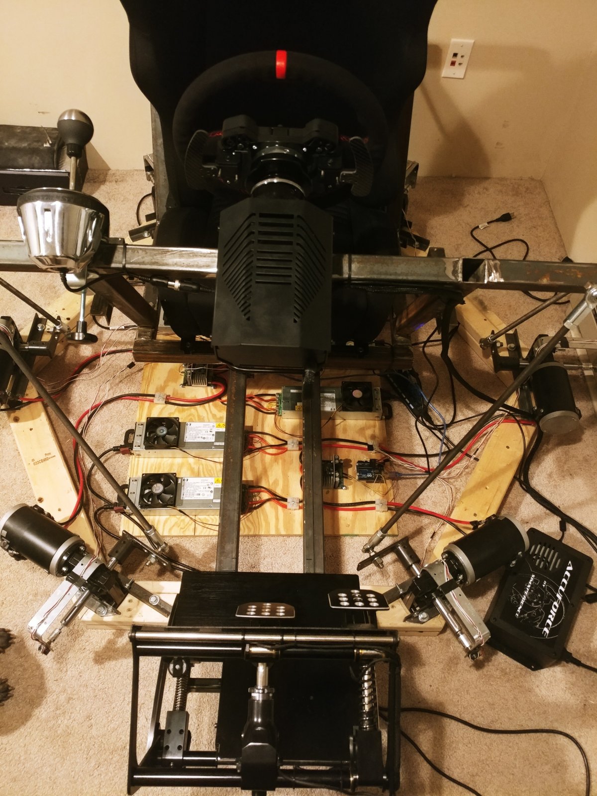

    I would run from MMs. Only go with the sabertooth. They are more $ - but you'll be spending it sooner or later anyway. 500w seems to be overkill - especially for a 110v outlet. They would take 42Amps to power and you would have spikes in the neighborhood of 100a. Technically - the sabertooths can handle 60a and spikes up to 120a.
    The 350w motors have held up great. Would buy them again.

    hello... what happened when you use MM ? and why change use sabertooth ?
  14. CLEOPHUS
    CLEOPHUS Member
    Apr 12, 2016
    47
    229Coins
    +69 / 0 / -0
    They would catch fire. Too much for them!

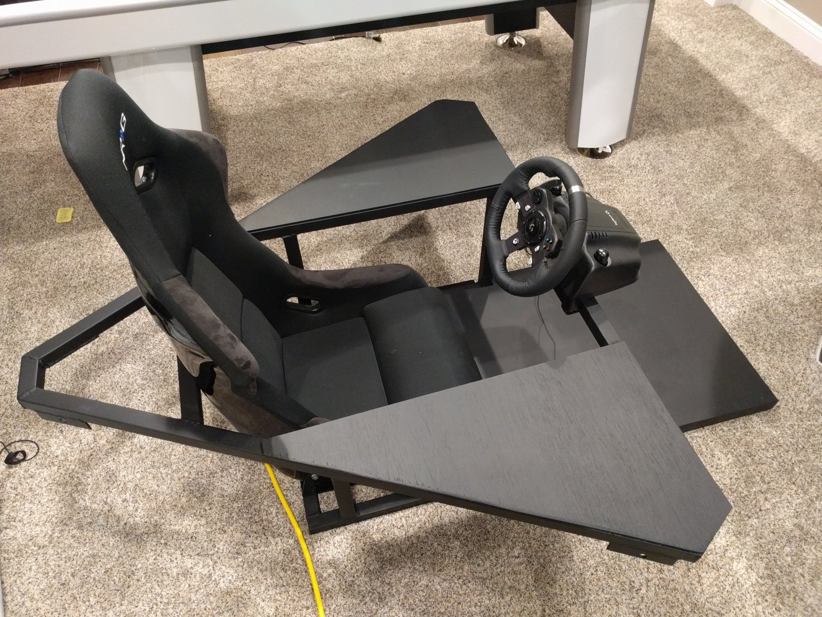

    @CLEOPHUS …. Look like something yove seen before? :)
  19. CLEOPHUS
    CLEOPHUS Member
    Apr 12, 2016
    47
    229Coins
    +69 / 0 / -0
    Just awesome. Sorry I didn't see this earlier. Please post an update. Moved and just getting the sim set back up!
