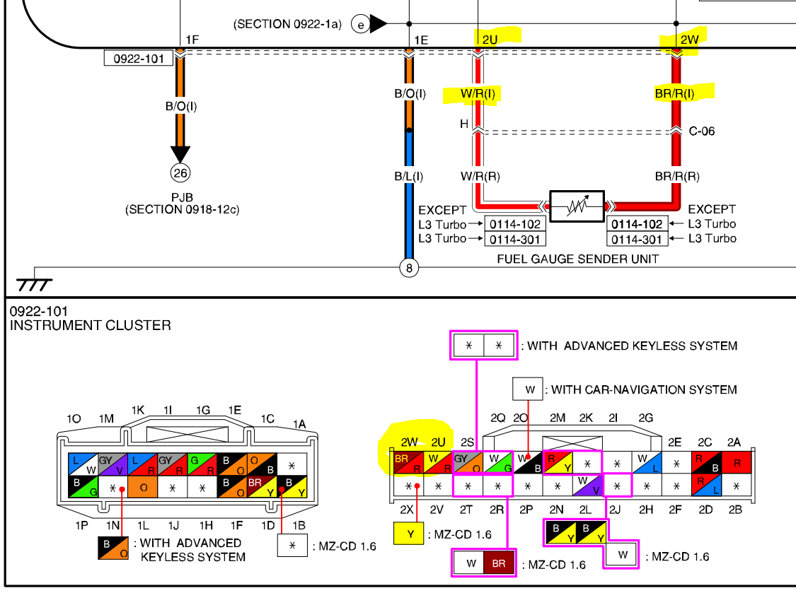

    My current thing I'm trying to get working is the Fuel gauge. Do you know how it works ? Like would you need something like PWM or the arduino "tone" library to control it ?
    See the attached from the Mazda Wiring Diagram manual. I know it's the first two pins on the connector (2U and 2W) but not too sure what those wires actually equal.
    Thanks,
    Matt

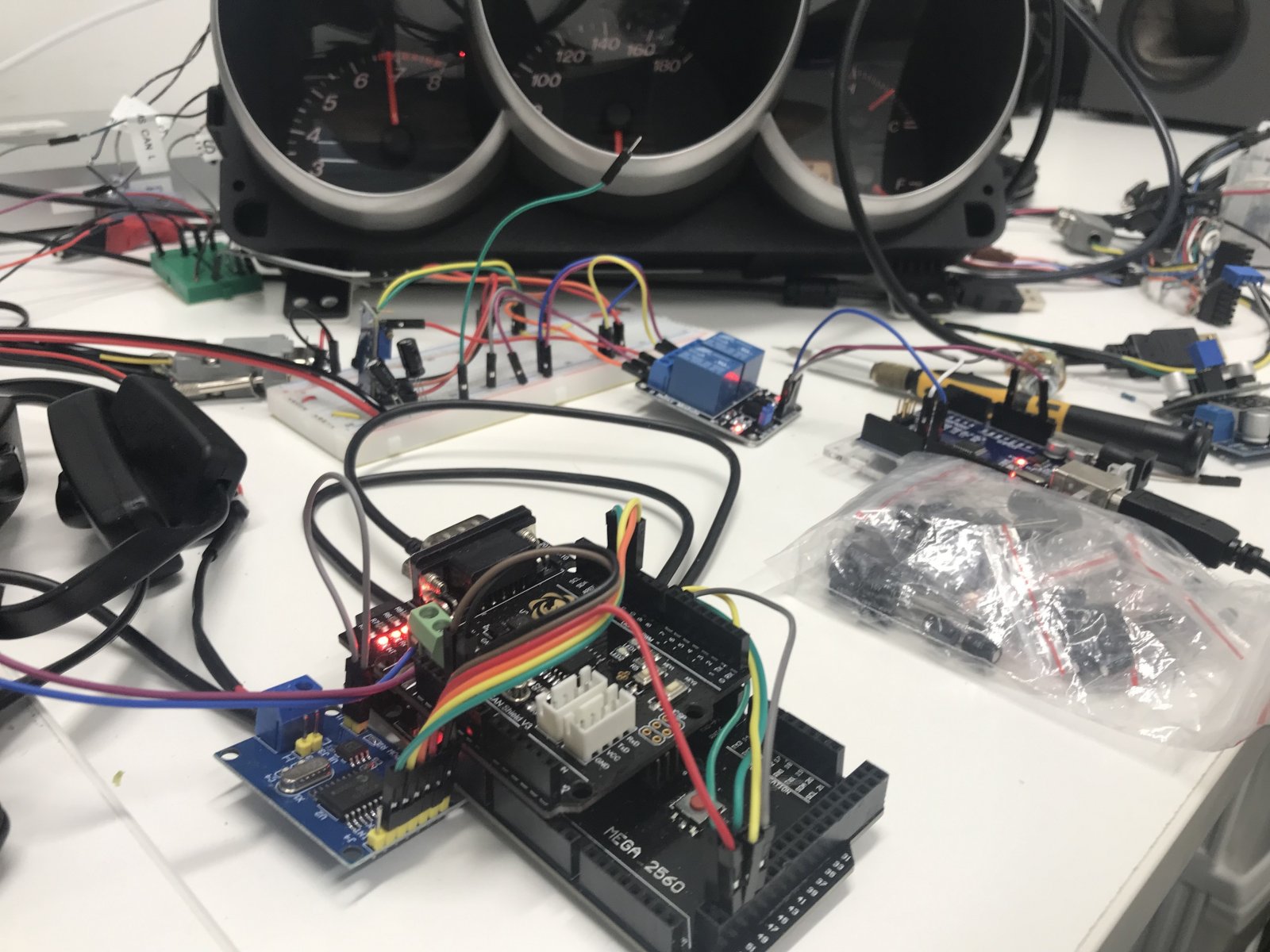

    @jjanu thought I'd give an update.
    I've got it working with dual speed can bus now. I had both a Can Shield (clone from Aliexpress), and the smaller MCP CAN adaptor.
    See attached.
    Here's a quick vid with data from Dirt 3 :) - https://drive.google.com/open?id=1YugTIoAATD0jCyOnfMgvdUqCdpXG7Yy8
    Also - I figured out my problem with the Fuel Gauge. Originally when I used a potentiometer, it was a 10k Pot. The Fuel gauge seems to be from about 10 ohm to I think 270 or 300 ohm.
    The Pot would do nothing unless I had it in that range *AND* in that range when first turning on the cluster. Which makes sense, I mean if it gets no value when the cluster first turns on, it can only assume there's a fault and it's better to report no fuel than something else.
    If I twist the pot while it's on, it can take a few minutes for the gauge to actually change. This also makes sense since it probably doesn't to constantly be polling the fuel resistor for details... I was thinking about getting a programmable digital resistor or something but to be honest it feels like overkill, and I think just getting the gauge to show fuel makes it feel "real enough"....
