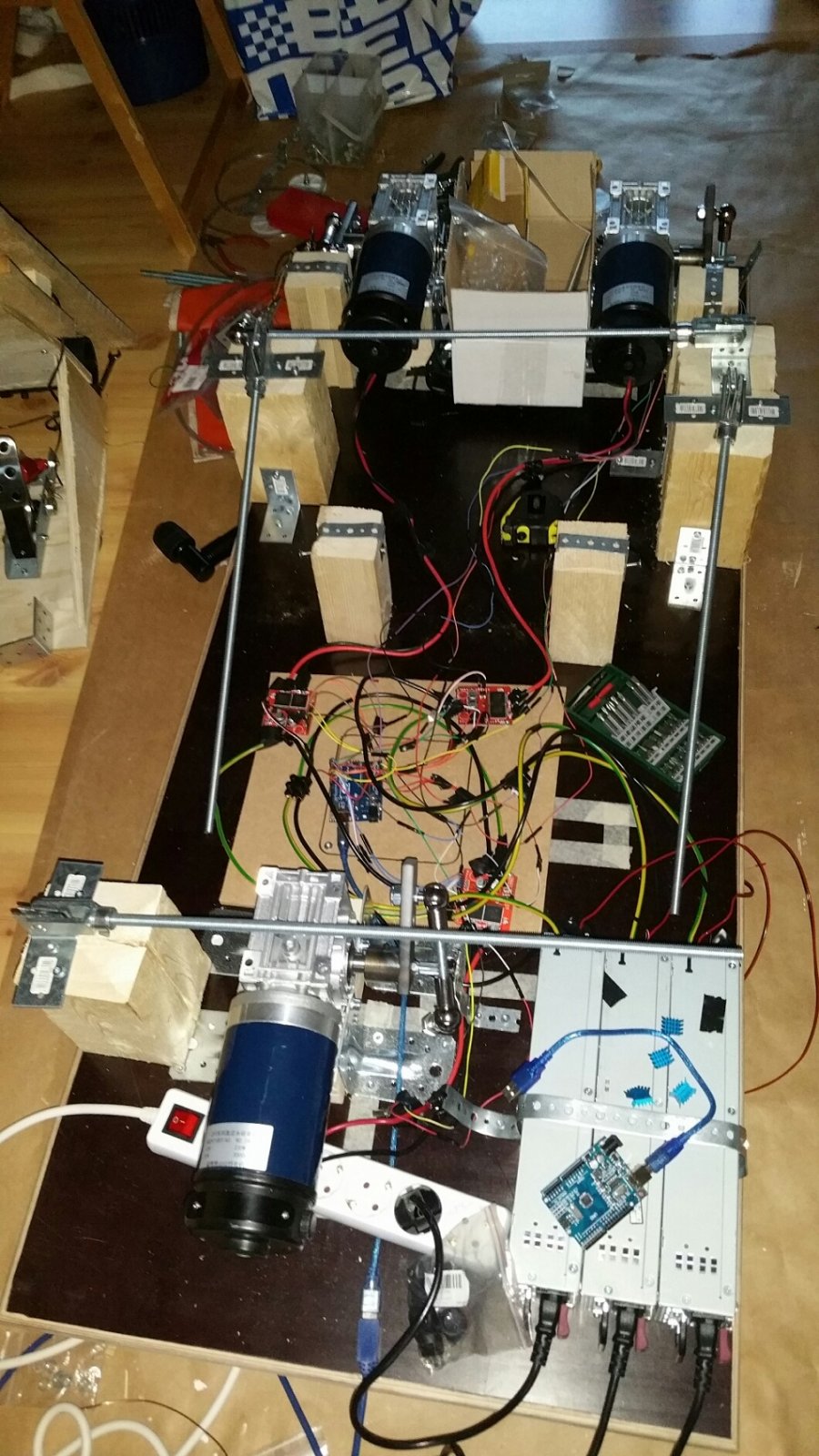

    Almost a month since I wrote anything the last time.
    The reason for the silence is simply that I haven't have that much time nor motivation to continue with the build.
    Stuff that has happened with the build:
    - Stiffened the motor bases with wood blocks and screws.
    - I received the Hall effect sensors ( I should still solder them, well I soldered one, but didn't install it yet)
    - Got some on/off switches for the PSUs (soldered the wires to them so that I can install them next to the seat, to be able to switch the powers from there if something goes wrong)
    - Installed the bases for the springs on the bottom plywood, still some misalignment with one of the springs: it seems straight when there is no load, but with load it tilts ( have to adjust it a couple of centimeters)
    - Installed the 3/4 bases for anti-twist
    Stuff to do:
    - Correct the spring
    - Finnish the anti twist and modify the top plywood so that it wont touch any of the anti-twist "bases"
    - Install better cooling system to the MMs (almost burned them with 1/3 load while trying to load the springs. Luckily thermal throttle hit the spot. I had small heat sinks and a case fan. I threw the heat sinks away and modded the northbridge coolers for MMs. I have to make the wiring for them and attach them.
    - Solder and install hall effet sensors
    - Modify the top plywood so that while tilting to the max positions nothing will touch it (now front motor will slightly touch if front is down and back is up)
    - Try the whole thing with motion and hope that it will work. (And then fix something so that it will work even at some extent.) I do fear that my mechanical build is not good (just a hunch) or the motors are not strong enough.
    - Build and install some HOTAS holds.
    - Build and install something to hold a Vive basestation.

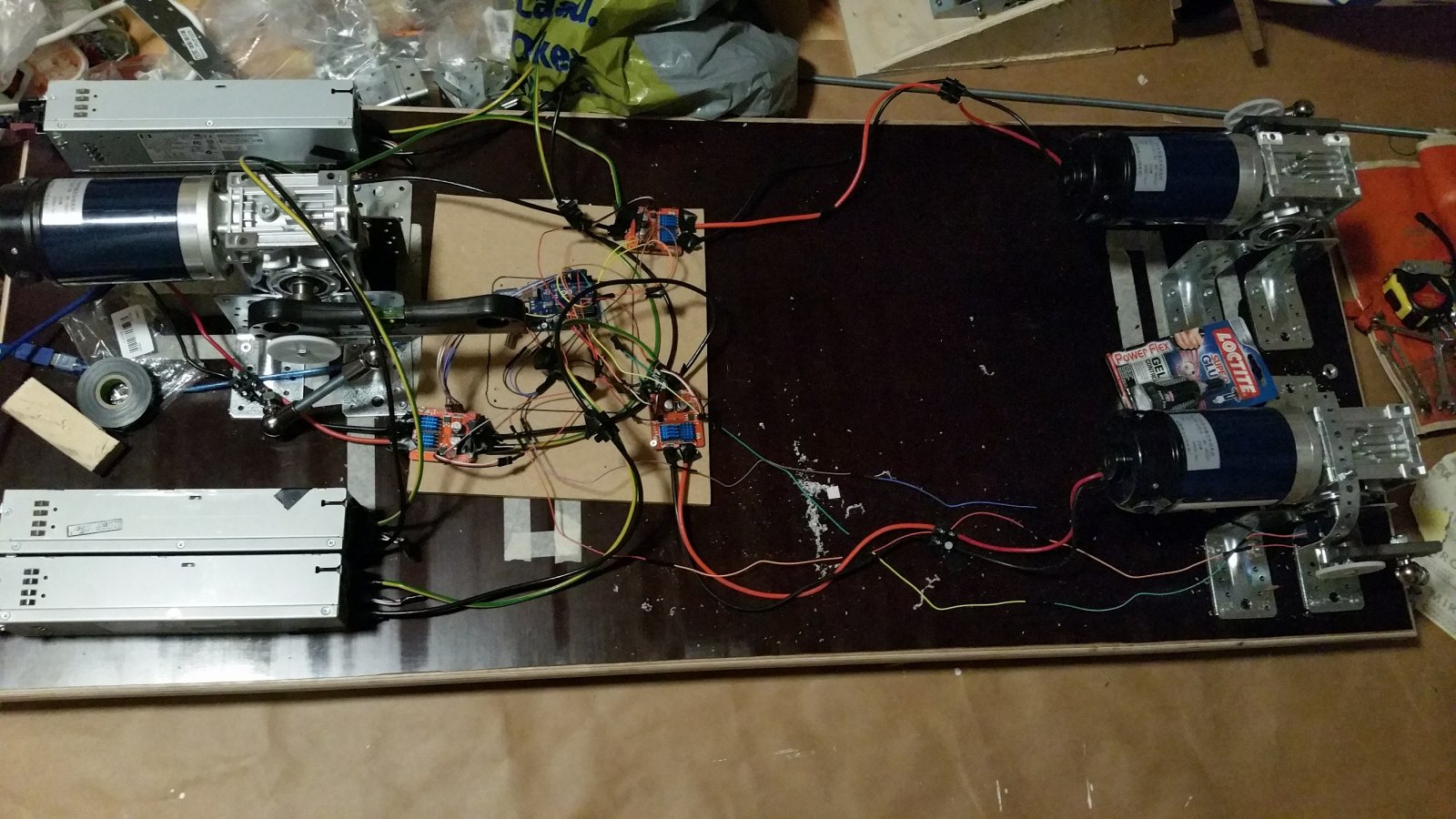

    Some stuff I managed to do today:
    - MMs northbridge coolings are now installed.
    I accidentally dropped some of the thermal compound on the MMs chips. Took a while to scrape it out between the pins. I cleaned the rest with alcohol and a cotton swab.
    Also as I fixed the northbridge coolers in place I managed to almost break one of the coolers while making the fixing irons / installation thingys. Luckily it was rather easy to bend the steel plates inside the sink back to original positions.
    - All hall effect sensors are in place and working. I used clear hose and hose clamps to attach them to the shaft. This way the coupling will be flexible.
    I was just too tired to realize that 2/3 of my motors are installed so that I have to reverse the leads of the motors.
    I started to make some changes to the SMC3 code to reverse the motor directions, but fortunately that is not necessary.
    As soon as I have reversed the leads of the 2 motors everything on the electrical side should be complete.
    I still have to make sure that the northbridge coolers are contacting the MMs effectively.
    At least the one motor that was already moving to correct direction could not overheat the cooled MM. We'll see how they will work under real load.
    I'll post some photos probably on sunday as I won't have time to work on the project before sunday evening.
    The project is progressing slowly as I don't live even in the same city where I build the project :p

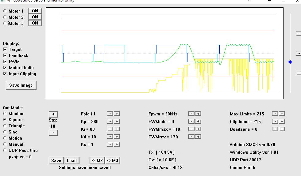

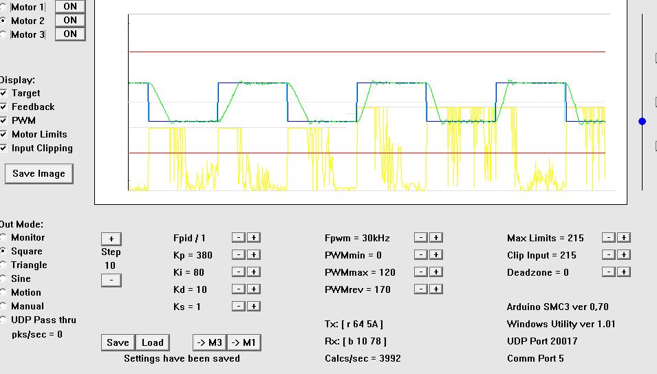

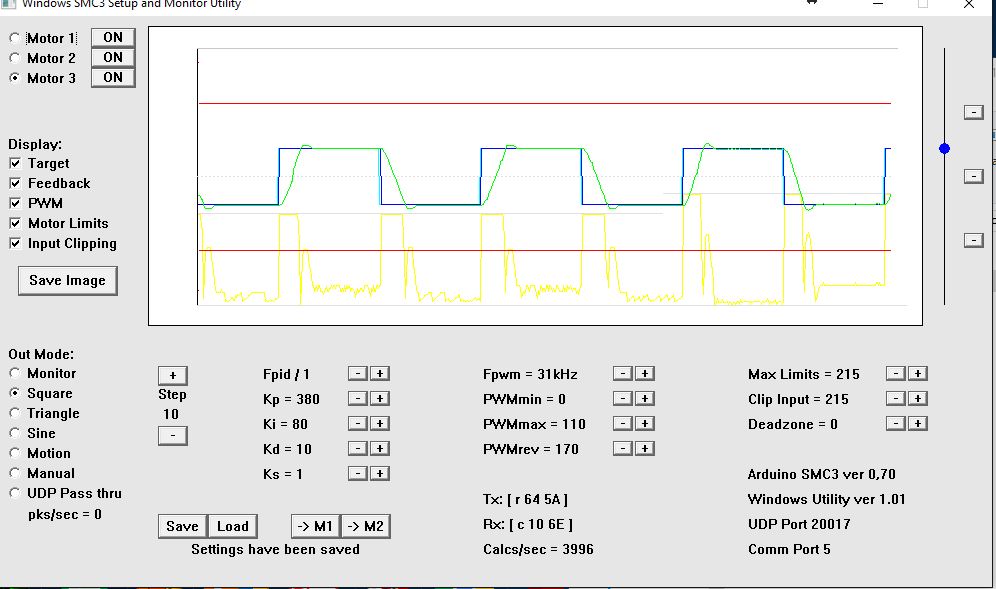

    Hi again,
    I moved the project to my place if I had more time to work with it during evenings.
    I started to investigate the oscillation problem and found out that motors 1 and 2 are affected by it and motor 3 isn't, or at least the oscillation of motor 3 is negligible compared to motors 1 and 2.
    The three motors were supposed to be similar, but the motor three has a bit different label (27A motors 1 and 2 are 25A) and the arm is on left hand side as motors 1 and 2 arms are on the right hand side.
    You can see from the photos that the motors 1 and 2 tend to oscillate and draw current spikes and motor 3 doesn't do that.
    Do you have any suggestions that I should do?
    The looseness of the gearboxes feel pretty similar with all the three motors.
    Increasing deadband to the motors does help but that doesn't solve the problem.
    It feels like one of the motors is a little loose from the gearbox when it changes direction, at least the motor moves more than the others (the gearbox stays still as it is fixed to the plywood), but when tried with hands the motor seems to be well fixed to the gearbox.

  12. E1m0
    E1m0 Member
    Feb 13, 2016
    53
    Plant Engineer
    Finland
    217Coins
    +28 / 0 / -0
    Thanks for the input, but i don't believe that it can be that as the three motors are (almost) identically installed. The motors themselves are only connected to the gearboxes, which are secured to the plywood with brackects and blocks of wood.
    I believe that it has something to do with the internals of the 2 motors or the connection to the gearbox.
    I was thinking to remove the motor from the gearbox and see if there is anything loose.
    I do know that worm gearboxes do have inherently some looseness, but it shouldn't result to this...
    Of course there is the option that I have to further fiddle with the SMC3 utility's control values if the two other motors do need different tuning parameters (for example smaller proportional (Kp) value, which would make them slower but less likely to overshoot), but the oscillation is so severe that I wouldn't believe that would cure the problem.
    EDIT: While reading about the same problem that other people have seen, I believe that I have to recheck my pot mounts to make sure that they are equally stabile for all the motors.

  14. E1m0
    E1m0 Member
    Feb 13, 2016
    53
    Plant Engineer
    Finland
    217Coins
    +28 / 0 / -0
    Thanks!
    Actually I tested my computer connections and axis/dof settings etc. exactly like that: using udp connection with LFS without plugging the sim in.
    And I run a lap of LFS with motors plugged in. There was very severe oscillation wit hthe motors 1 and 2, motor 3 worked fine.
    I will have to do more testing with the PID values. I hope that it will solve the problem eventhough I'm not that sure....
  15. E1m0
    E1m0 Member
    Feb 13, 2016
    53
    Plant Engineer
    Finland
    217Coins
    +28 / 0 / -0
    I the oscillation was (all but) completely removed from the motors with change of the PID values.
    I had to put the proportional value down to 210 and integral to 2 to get rid of the oscillation, for motors 1 and 2.
    For motor 3 I could have much higher values and it tracks a little bit better the set point.
    I still have to try that with load.
