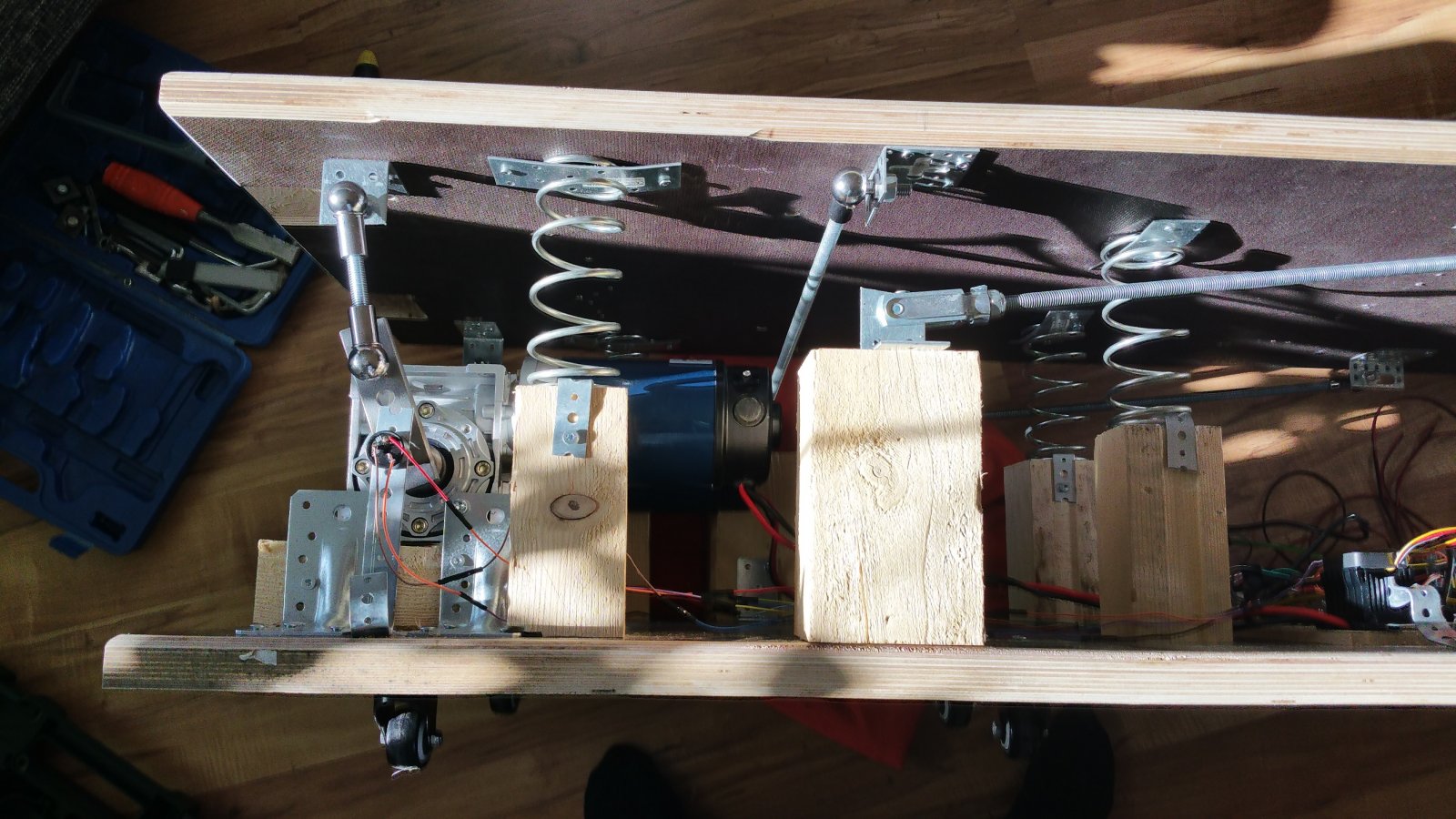

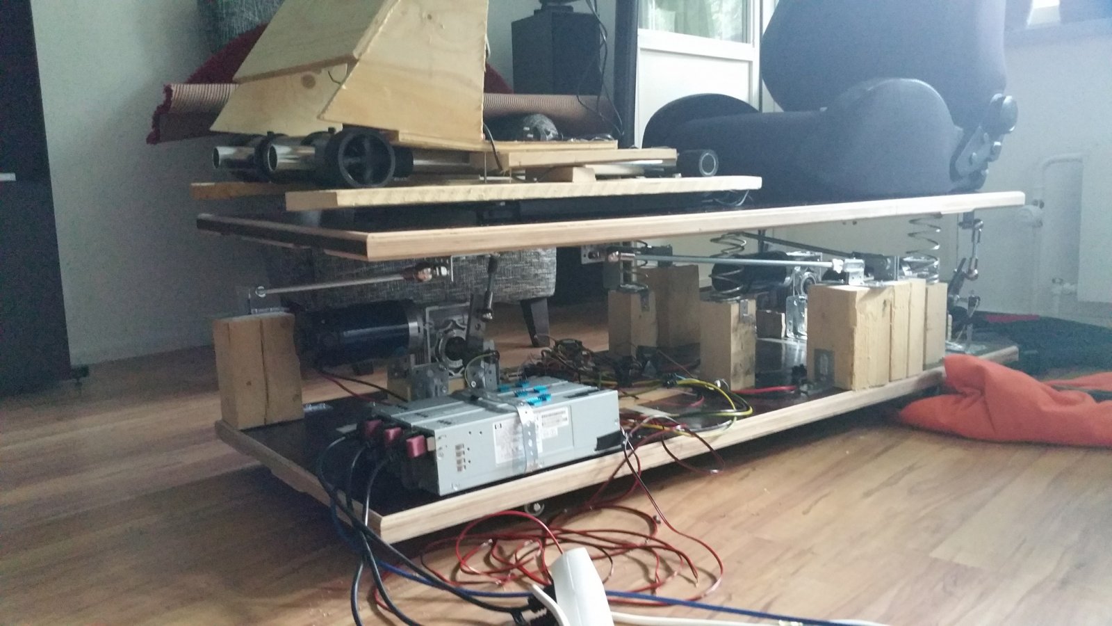

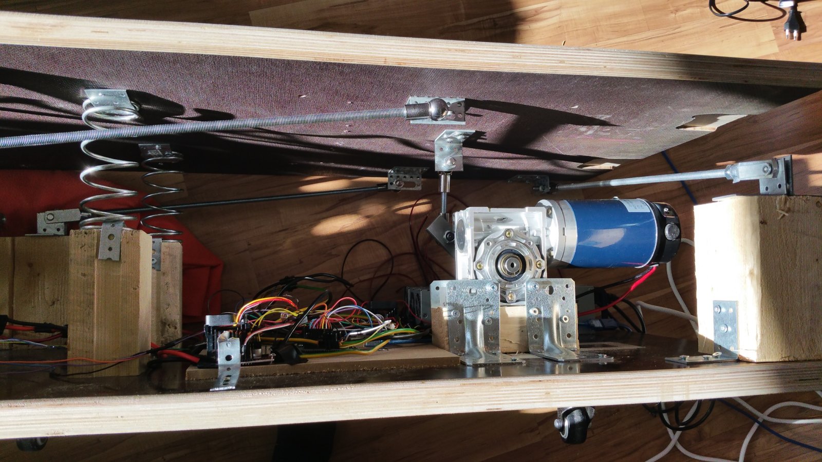

    I installed the anti-twist and did a "test ride". I'm not too confident about the motors. They get the whole thing moving, but do not track as well the set point as with out load (the motor 3 again is the best of the bunch).
    The anti-twist makes it even harder for the motors, but is necessary to eliminate wobbling. I didn't do much testing as I run out of time and I feared that I would burn some MMs ( as at least one of them has one of the chips badly installed, one chip is 0,5mm higher than other, so my cooling is not necessarily effective on the lower chip).
    The whole system is light enough to push around with wheels, but heavy enough not to move while "riding".
    Some new photos:
    Front motor and some anti-twists

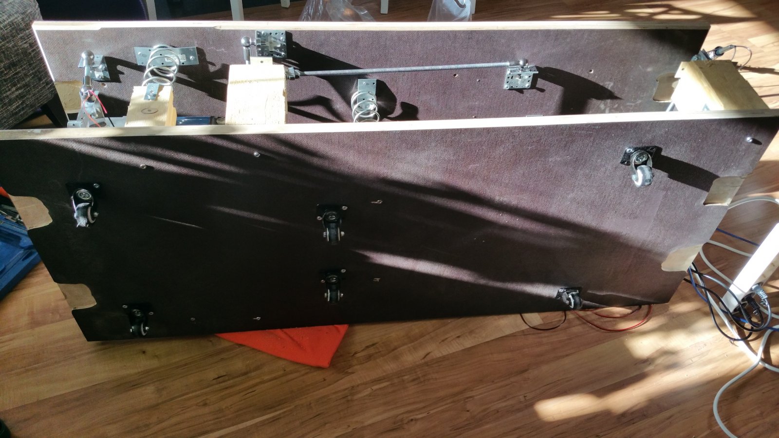

    Bottom, wheels and such
    Back motors and anti-twist

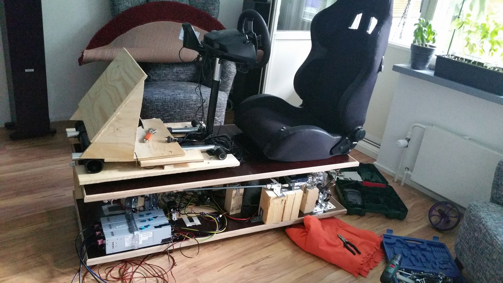

    The rig at this point
    There is still a lot to tweaking and some parts to do (e.g. removable HOTAS stands and motor on/off-switches).
    And of course if I ever get this thing performing the way I like, I need to decorate it.
