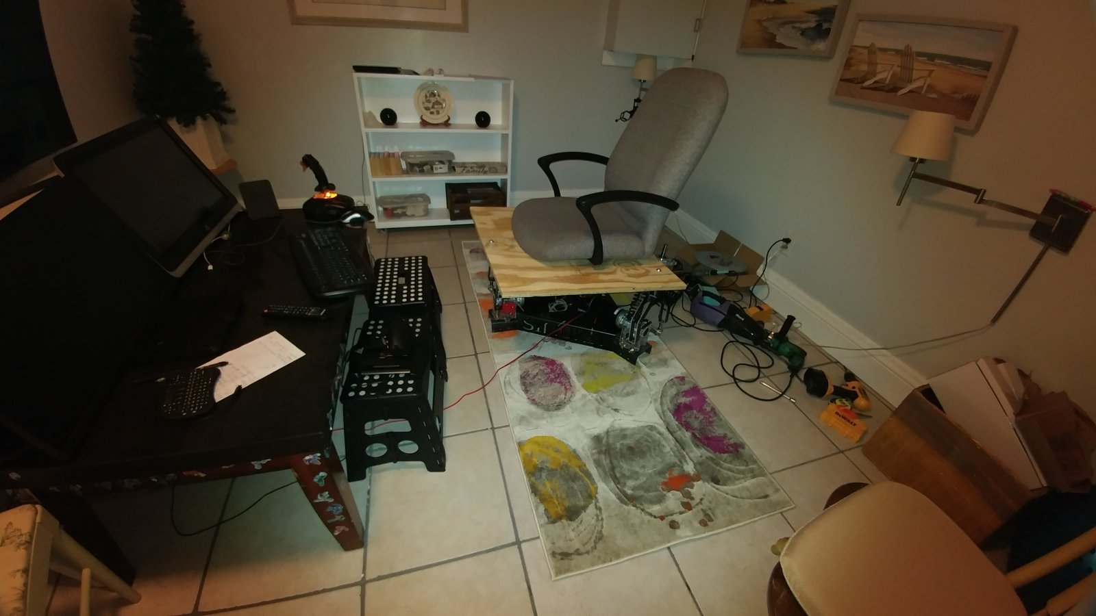

    I have not installed the cockpit yet. For now I simply bolted a chair to the platform so that it can be tested.
    Here is a video of my daughter riding the roller coaster

    You have a LOOOOT of play in the rear right ball joint ! That is not good. You should tighten firmly the balljoint to the "U" shape piece.
    Please secure all your bolts, and revise then often, for your own safety.

    Good to know. Another piece of advice, you should place a blanket or a gym mat under your simrig : it will save a lot of vibrations.

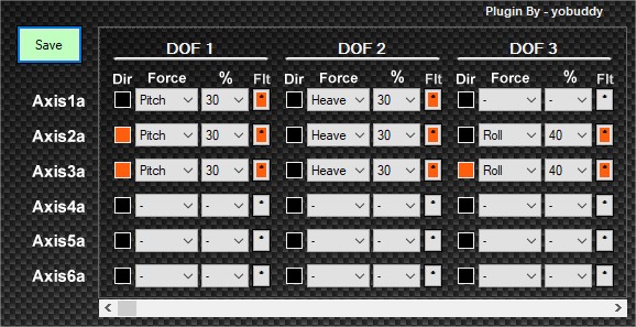

    Hi Stargazer,
    I didn't understand your question about what data to provide into simukit.
    So, here is a list of screenshots of my "default" setup :
    Axis1a 2a and 3a correspond to each of your motors. You have to test to know which one is which, as it is directly related to your wiring.
    Once you have identified your front (or rear) letf and right motors, you will have to determine their direction : this is directly related to the way you placed your red and black wires to the sabertooth.
    Let's take for example my heave effect (which I totally randomly set on DOF2). To get all the motors toggle off (the little black box on the left of the effect, labeled "dir"), I had to rewire some of my motors.
    I personnaly think it is important to wire your motors that way, as it less twisted-minded to assign your effects.

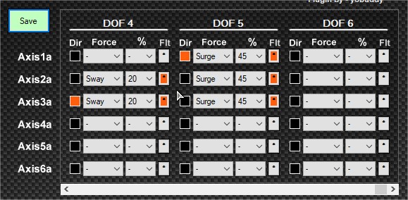

    Let take the surge effect (DOF5) :
    I know my axis1a is my rear motor, axis2a is my left motor, and axis3a is my right motor.
    What do you want to represent when you encounter an acceleration ingame ? You want to be inclined to the your back, as if you were pushed into your chair.
    So, I want to raise equally my left and right motors, and lower my rear motor : I toggled my rear motor.
    For the roll effect, the rear motor is not used, so it is not set.
    Finally, the % correspond to the % of your axis amplitude used for the effect.
    You have to understand that you will likely have other effects applied simultaneously, but very rarely all your effects on the same time at their max.
    So the sum of all % must be near 100 (like 100% of the amplitude used), and it can be over it (165 in my case, and I do not feel the saturation.)
    If you target something too high (my first settings was at 100% for each), you will saturate your axis, and mask some effects.

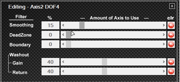

    Finally, the last picture show the "fine tuning" applied to each axis for each DOF. @yobuddy : this is a pain to have to set values with sliders for all of the axis, would it be possible to have a numeric input box and a "duplicate" button on a next release ?
    This is a personal preference, I like to add a little smoothing to all of my axis/DOF, it is more enjoyable.
  13. yobuddy
    51,529Coins
    +5,204 / 19 / -0
    Then use the 'Main Level %' in (Game Manager > Profile Editor) for the game buddy.
    It will apply smoothing to all axis at the same time, you can even adjust the Main Level % value live while you are playing the game!
    Take care,

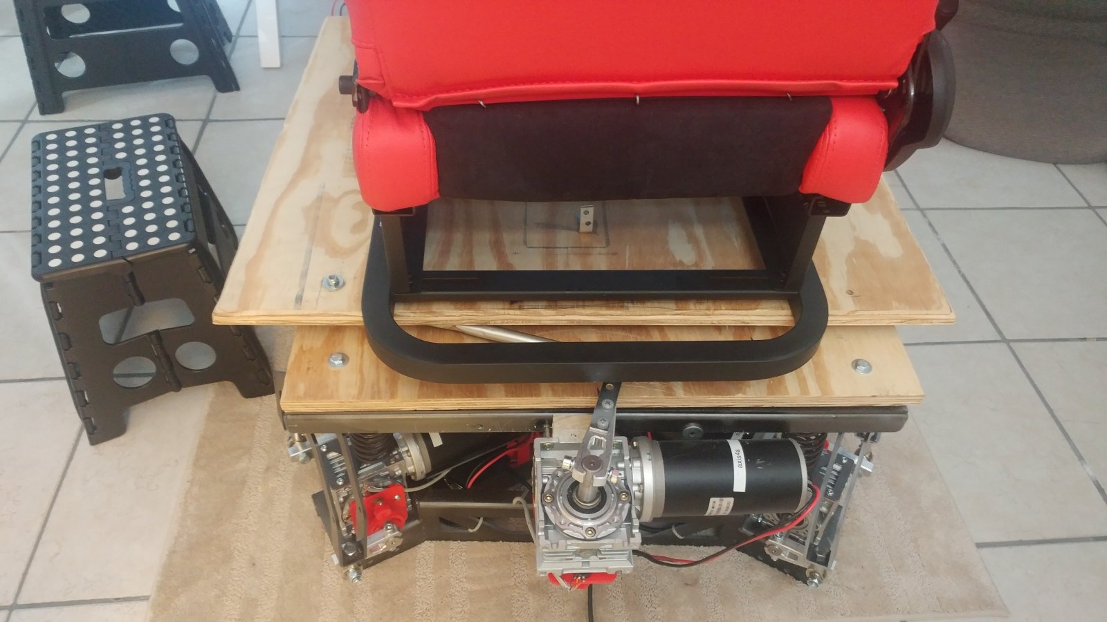

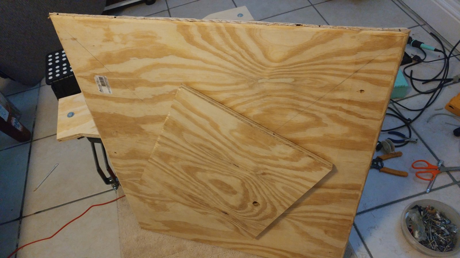

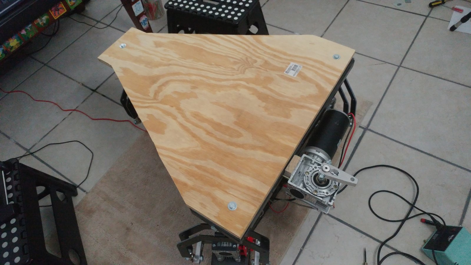

    I have been busy working on the traction loss construction. My idea is to use a large lazy Suzan that can withstand a large weight for the traction loss motion. I found one on eBay that is 12 inch large and can support over a thousand pounds. You can see out here https://rover.ebay.com/rover/0/0/0?mpre=https://www.ebay.com/ulk/itm/263794483947 . That costs only $13.10 apiece.
    Then I built the wooden platform on top of the motion frame to test out the structure. So far it is working well and is quite stable. It spins readily with me sitting on top of it. I think it will have no problem when I mount a cockpit onto it.
    One thing that I did with the lazy Suzan to help it works better was to grease the bearings generously. That helped cut down on the noise and making it rotated smoother.
    Now I am waiting for the ball joint parts and screws from Simukit to help connect the motor crank to the platform. After that I should have a pretty good idea how well everything works.

    I could not wait for the ball joints and parts to arrive from Simukit. So I just use a thick coat hanger to connect the traction loss motor to the platform. That worked out not too bad. The coat hanger was strong enough to move the platform with me riding on it. This showed that the platform spins well with very little friction.
    At the moment the angle of traction loss is probably just between -20 to +20. If the motor was placed underneath the seat, at the center of the lazy Suzan instead, then it could give a much bigger angle range for traction loss. However, even with a small angle of traction loss it is already quite fun to play with.
  16. RiftFlyer
    RiftFlyer Active Member Gold Contributor
    Apr 15, 2014
    198
    1,711Coins
    +121 / 0 / -0
    DC motor
    Won’t putting traction loss on top of the platform result in pitch becoming roll and vice versa at large deflection? I suppose if you keep the deflection small it will not matter. It may result in some strange sensations with large deflections though.
  17. stargazer
    stargazer Active Member
    Jun 29, 2018
    129
    Electrical/Computer Engineer
    Boston,USA
    811Coins
    +35 / 0 / -0
    3DOF, Arduino, Motion platform, 4DOF
    @RiftFlyer thanks for pointing that out. I didn't think of that. May be it is fine the way it is for now. Is this why some simulator, e.g. racingcube, has the whole platform moved on a set of wheels for yaw effect?
  18. RiftFlyer
    Apr 15, 2014
    198
    1,711Coins
    +121 / 0 / -0
    DC motor
    Exactly. If you just plan on having very small rapid yaw changes to give the impression of traction loss then it may be ok as it is. As you have it built already you should test it and see. My advice is keep the deflection small so it doesn’t cross over the pitch and roll axis too much.

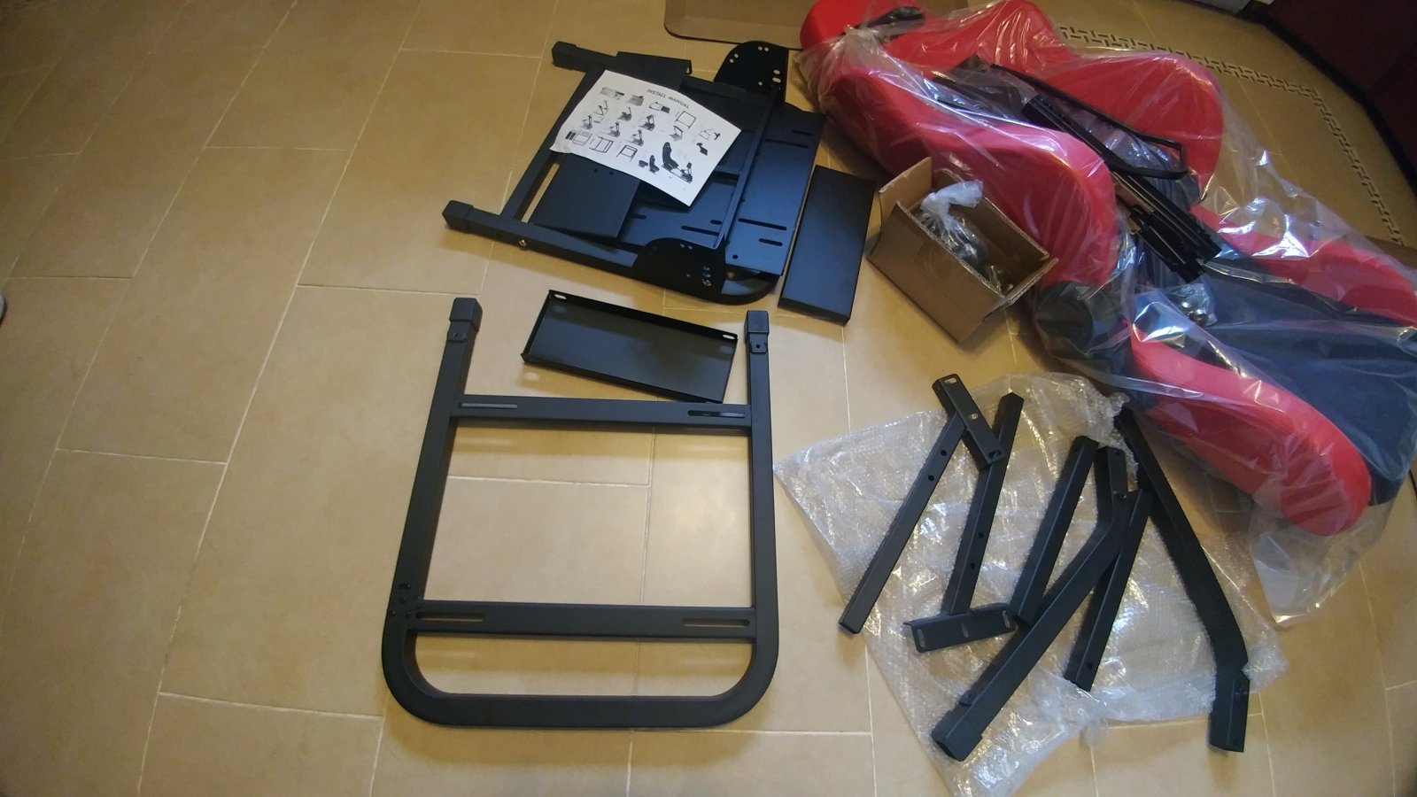

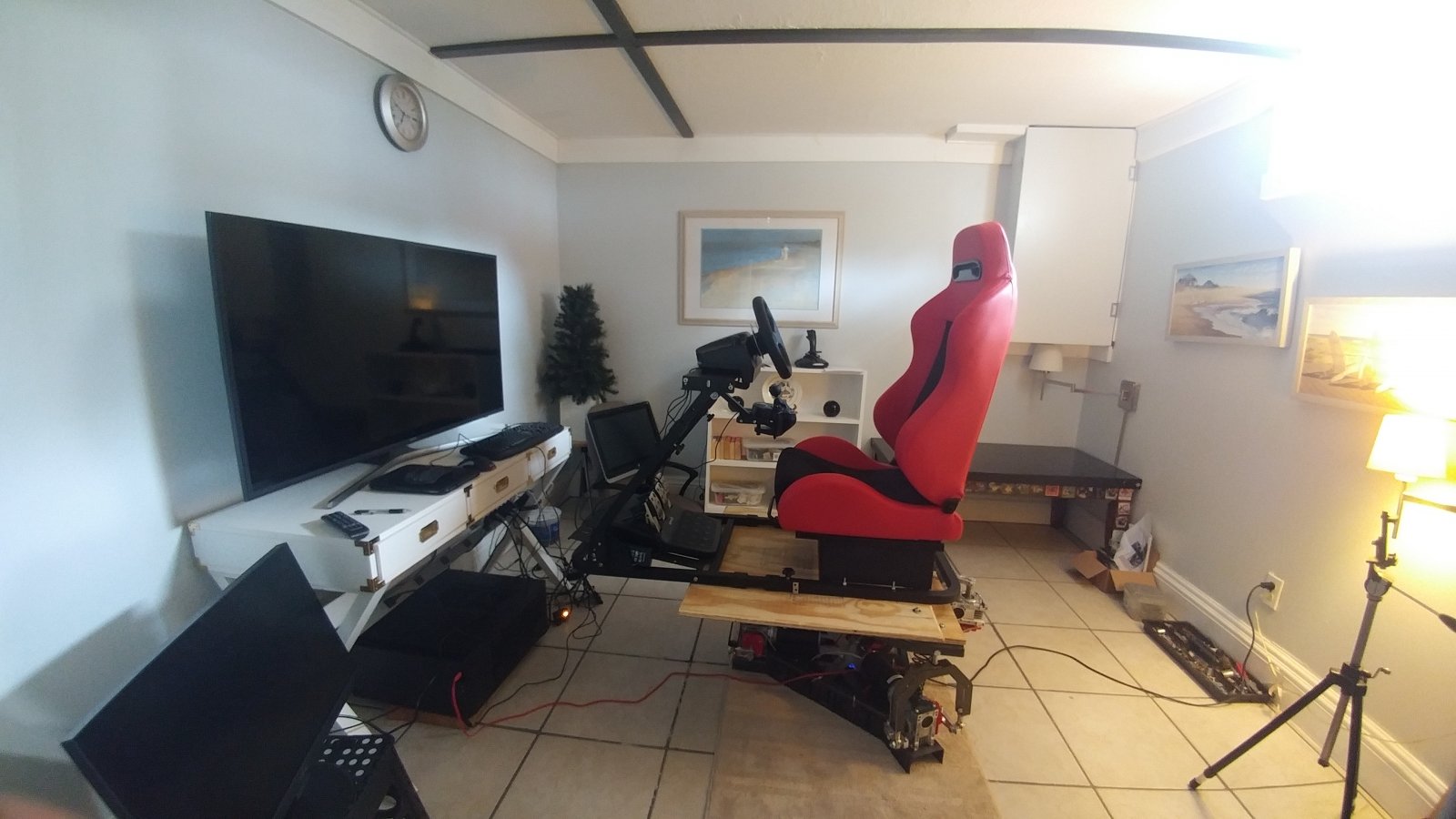

    The cockpit arrived finally this week. It costs just $240.99 from the eBay seller harmoniccd. It is sturdy and pretty decent for the price. It took me the whole day to assemble but so far everything is working well.
    The next project will be building a monitor stand to raise the tv up so that it would be at the same eye level as when I am sitting on top of the simulator.
    I am also torn between getting two more monitors for the display or just get the occulus rift???
