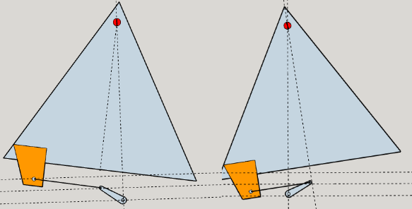

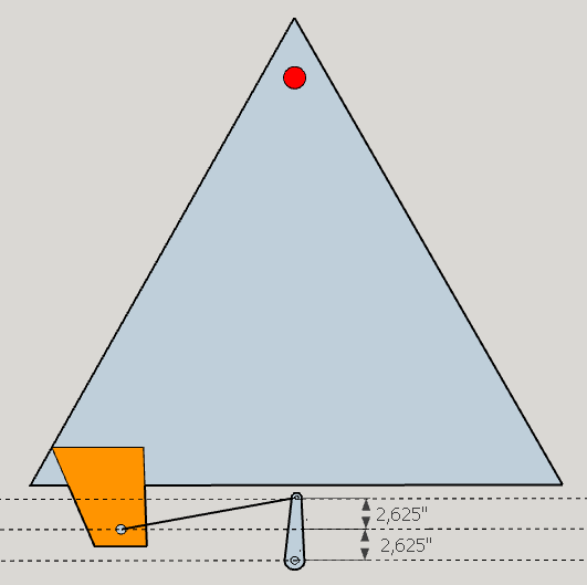

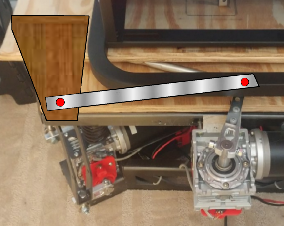

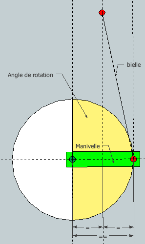

    The idea is to add a bracket that will serve as a pivot point to the end of the connecting rod:
    In order to comply with this rule:
    Angle de rotation = Angle of rotation
    Bielle = Connecting rod
    Manivelle = Crank handle
    Only method that guarantees the symmetry of the movements.

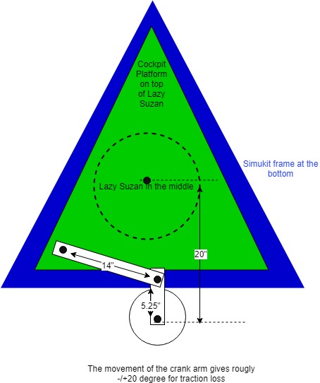

    @momoclic I guess you are concerned that the traction loss (use motor axis4a) doesn't have symmetrical movement around the center. This is not related to the motor on axis1a that always sags and spins backward.
    I am uploading a diagram of how I built my traction loss if it could help someone else.
    I didn't work out the math but from my experimental measurement this gives me about +/- 20 degree so that is good enough for me. So far I don't have any problem with this motor (axis4a).
    My problem is with the front motor on axis1a which sags and spins backward over time. Given it enough time it just spins backward continuously. It is a pretty scary situation when it does it. It did it to me several times and it did it to my daughter once and, fortunately, I was in the room to shut it down right away. Otherwise I don't know what would have happened. @yobuddy think this is a motor problem. I just wish to hear from Simukit if they know what the problem is and how to fix it.

    On the other hand I insist you do the same number of degrees on the right and on the left but the plate does not move the same distance on each side.
    The movements of the connecting rod have a very complex kinematics. It is not a question of calculation but of geometry ;-)
    It is the only solution that ensures correct travel !
    In addition, if you move the pivot point (red) to the front of the triangle you will increase the sensations. :)
    As you can see in the image, the center of the triangle moves by multiplying the feeling tenfold.
    And the end of the connecting rod moves +/- 60° by +/- 4.5".

    If I move my lazy suzan toward the top of the triangle then I will need to build some wheel support on the back of the cockpit platform, otherwise nothing will move. This will be another new project for me. The reason that I was able to get this far was because I was unemployed the last few months. Now that I am about to go back to work next week, I doubt very much that I will be able to get anything done anymore. Working on this project gave me nothing but admiration for other builders. Such dedication and resourceful they all are. Before I started this project did read your tutorial and I found that simukit sk3 kit is actually very close to your idea. I am glad to have met you here finally. I would have consulted with you on some of the ideas for building the rig if I had known you from before.

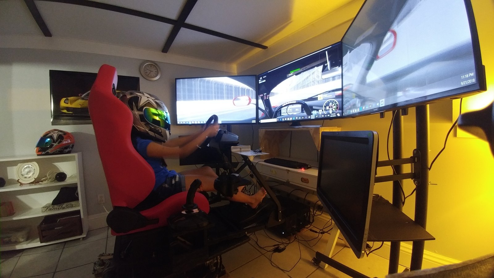

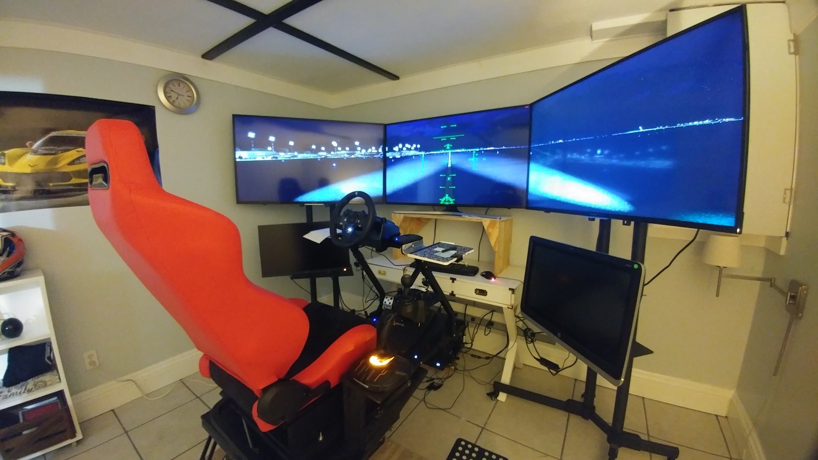

    It was a great coincident that the day I received my motion kit was also the day I got laid off from work. So in the last two months I was able to spend a good deal of time building the rig. Now that I am about to go back to work and probably don't have time to work on it anymore, I like to share some concluding remarks with the hope that it could help to improve the built for somebody.
    First I like to express my heart fell thank you to a lot of people on this forum who had helped me. Without them I would not have made it. So thank you @jjanu , @axenic, @noorbeast , @yobuddy , @RiftFlyer , @momoclic , @Wanegain . you guys rock!!!
    Here is the picture of my final built.
    I am very satisfied with the performance of this rig. It took me a while to learn how to tune it right but once it is done I can feel every little movement of my car or airplane. I found that for motion simulation a little go a long way. For example the traction loss movement I only have to set at 40% out of a 100% and it already gives me a nice drift feeling as the car race around the curb.
    In terms of cost the whole thing costs me about $4500 (monitors and stands included). It is not cheap but compared to all the available 4dof commercially available I think this price is not bad at all. If you are an experienced builder may be you can source most of the parts from eBay for less but for a beginner builder like me, I would recommend buying the kit instead.
    If you follow my built thread from the start you must have seen a number of issues that I have encountered. Some were from my inexperience but some can be avoided if Simukit would readjust their design a little bit. It is still a great kit that can help you to get started though. Simukit is also working on adding traction loss to their kit so in the future you don't have to build it yourself.
    There are enhancements that I am making to the rig. One is adding a buttkicker unit to the seat. The other is to add vr. For the vr I would like to wait a bit for something that offer good resolution and motion cancellation. But this is something I would like to get into soon as so many people are having great experience with it.
    Once again thank you to all who have shared ideas and helped me with the built. And good luck to all who are inspired to build their own simulators.
