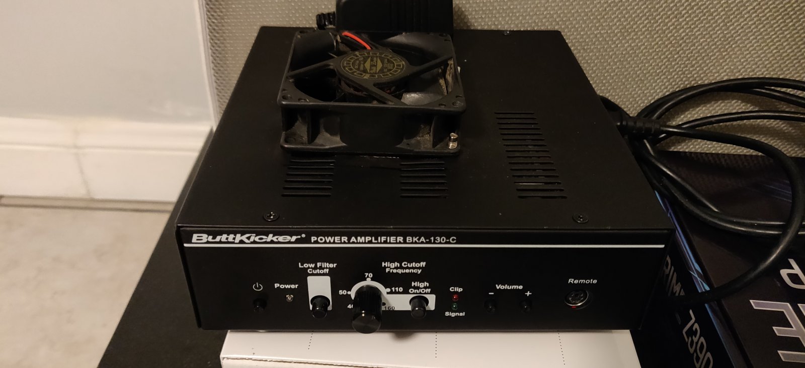

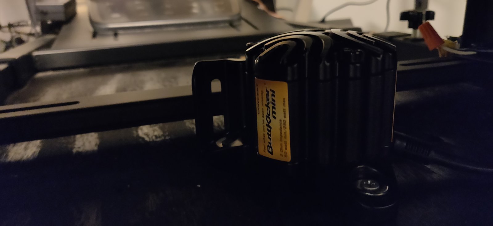

    Another thing which is not working well on my setup is the buttkicker. I have a buttkicker gamer 2 amp and a buttkicker mini concert installed. I found that it would work for about 20min and then cut off for long period of time before it would work again for another 20min. I thought that the problem was in the amp so I installed a computer fan to help cool it down. The problem still persist after the modification. Now I think that the buttkicker mini is actually the one at fault because it felt really warm when it cut out. Does anybody have similar problem? BTW, I watched this video and bought the $10 amp there. As far as I can tell it works really well. I wish I have bought that instead of the Buttkicker gamer 2 which costed me 10 times as much.
    22,185
    154,750Coins
    +11,196 / 57 / -2
    It sounds like the Buttkicker itself is being overdriven and that may be leading to thermal shutdown.
    With transducers it is all about refining the cues they give, not maxing them out, resulting in general but non distinct rumble. Are you using Game Vibe or some other software to control/tune the Buttkicker?

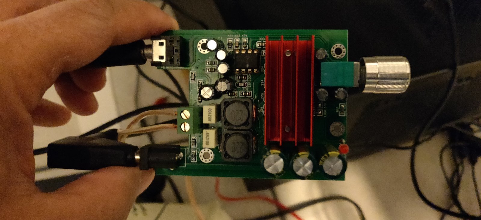

    Before I had the Game Vibe working, I was driving the amp from the speaker output. Then I found the cut out problem. Now I am using Game Vibe and the cut out problem still happened. I also tried to turn the amp output down but the problem still persists.
    22,185
    154,750Coins
    +11,196 / 57 / -2
    Please post pictures of all your Game Vibe settings.
    What volume is the Buttkicker being run, as it sounds like it could be maxed out?

    I normally run it at 1/4 of the max volume (just to feel a light rumble on the chair) and it still cut out after every 20min. When I used the $10 amp, that one has a max of 100watt, the buttkicker mini has a max of 250watt so it suppose to handle the signal from the amp well. Especially when the amp volume was not even turned half way. Could it be that I have a defective transducer?

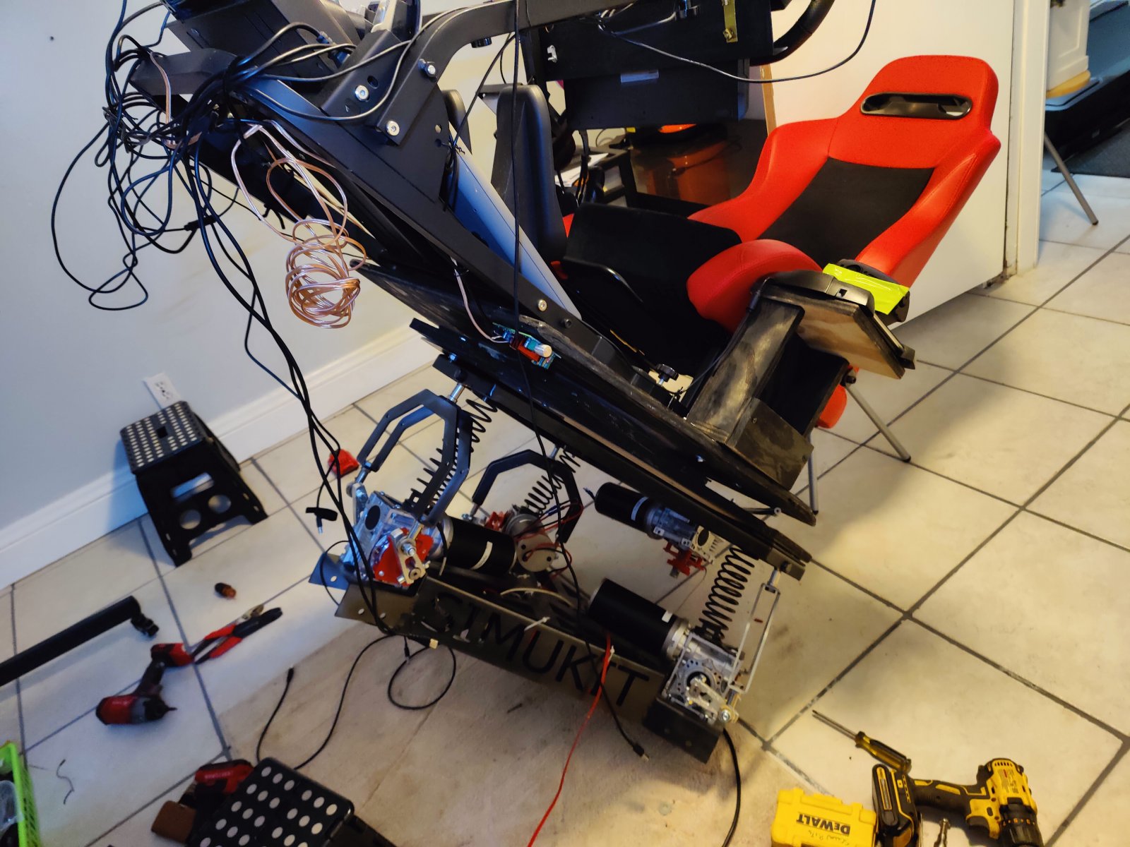

    today is a really sad day for me. My motion sim went up in smoke and nothing is moving any more. :(
    It started with a troublesome motor that I always have a problem with since the beginning of this built. It is the motor on axis1A of the sim. I found that sometimes this motor wouldn't move at all because the carbon brush stuck in the open position. Each time that this happened I had to open up the motor and clean the contact and brush housing so that it would work again. That happened over a dozen times in the course of the last few years.
    So when the motor stopped moving again last week, I again opened up the motor housing, cleaned the brush and put it back again. Then, it worked for a few seconds before I saw the smoke filled up the room. I checked the motor and it is cool and I didn't see any smoke from it and I had problem identifying the source of the smoke. I disconnected the motor and try to restart the system but nothing would work anymore.
    I tested and saw that there is still communication from the PC to the arduino micro so I think the arduino controller is still good. So it is possible that the saber tooth board or the power supply is gone.
    I am having problem understanding why would all the motors stopped working all at the same time. The motors are connected to two different saber tooth units and two different power supplies. So if one of the saber tooth or power supply is burned out then that shouldn't effect the other motors on the other saber tooth, right?
    I still don't understand how cleaning of the motor brush could have caused the burn out of the whole sim??? If anybody has an idea please let me know.

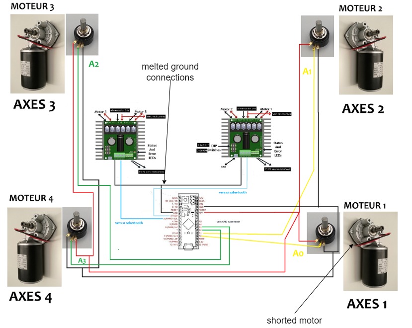

    With a help of a friend, I was able to lift up the rig and found out where it was burned.
    First we measured the motor winding and connection on the axis1a motor (front motor) and that one shorted to ground. This was the motor that I was cleaning the brush and I left it in a state where its brush cable touched the metal cylinder of the motor. The motor is not burned. After tugged in the cable, the motor is no longer shorted.
    Second, we found that the ground connections between the arduino micro and the two sabertooth boards were completely burned and melted. We replaced these ground connections with good ones. The sabertooth green LEDs are still on so we were hoping that the sabertooth boards are still ok.
    Third we checked the power supplies and they were ok. They both showed 24v on the output.
    Fourth we checked the connection to the arduino micro and was able to compile and program it without issue.
    Thinking that the problem might just be the melted ground connections, we tried to power up the rig and test its motion. However, nothing moved. We checked the pwm signal on the arduino and it appears to have some square wave signal even without any motion. At this point I am not sure if the arduino is still good or not. I think I will replace it and see how it will go. After that if it still not working then I'll try replacing the sabertooth boards. Those are a lot more expensive than the arduino.

    I found out that we didn't connect the ground connection between the sabertooth and the Arduino correctly. I made the correction and all motors were working well except for the front motor. It constantly shaking and wouldn't settled down quietly like the others. I tried to replace the potentiometer but that didn't work either. If you have some ideas that could help me then I would appreciate that a lot
    I found out that the sabertooth and the Arduino ground was wrong. After fixing the connection then all the motors worked well except for the front motor. It kept on shaking all the time and wouldn't settled down like the others. If you have an idea please let me know. Thank you
