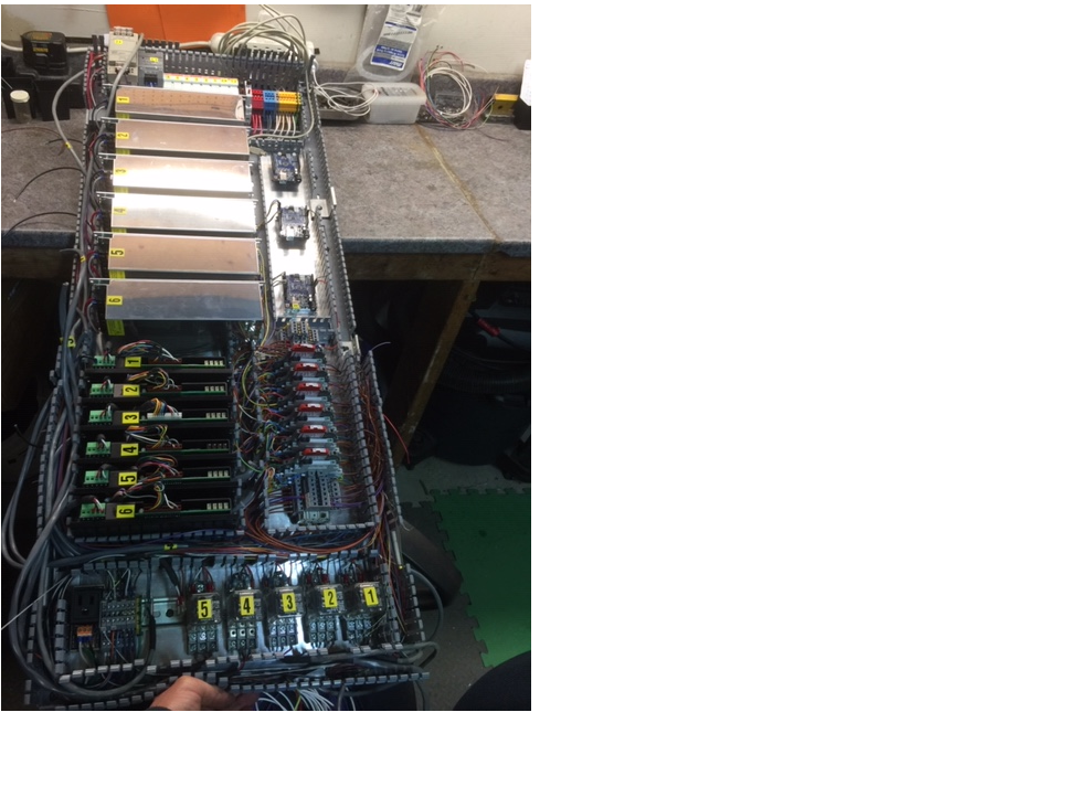

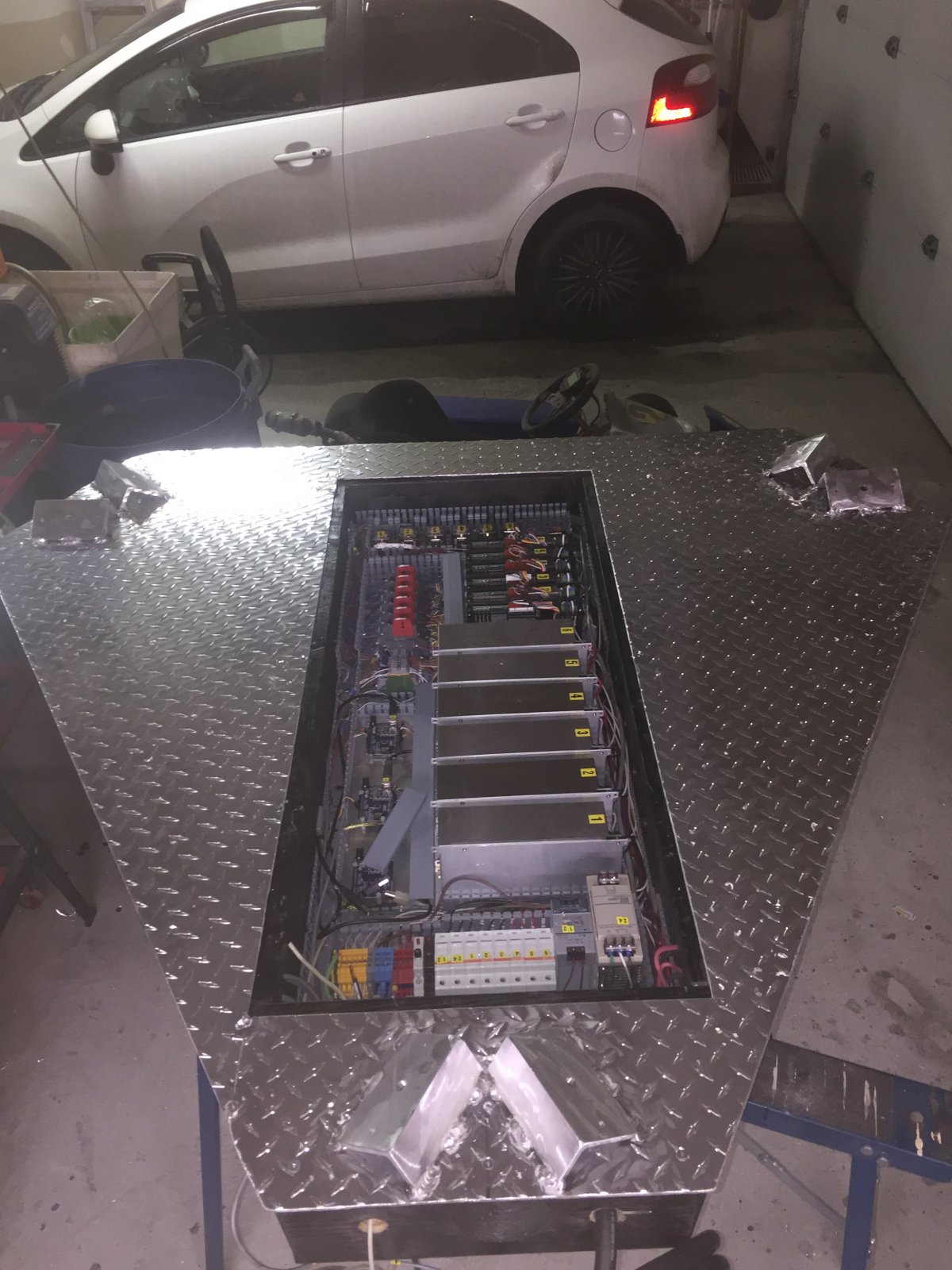

    New control :)and up date electric board!!!( missing safety relay 6 and two cable pot !):thumbs:grin

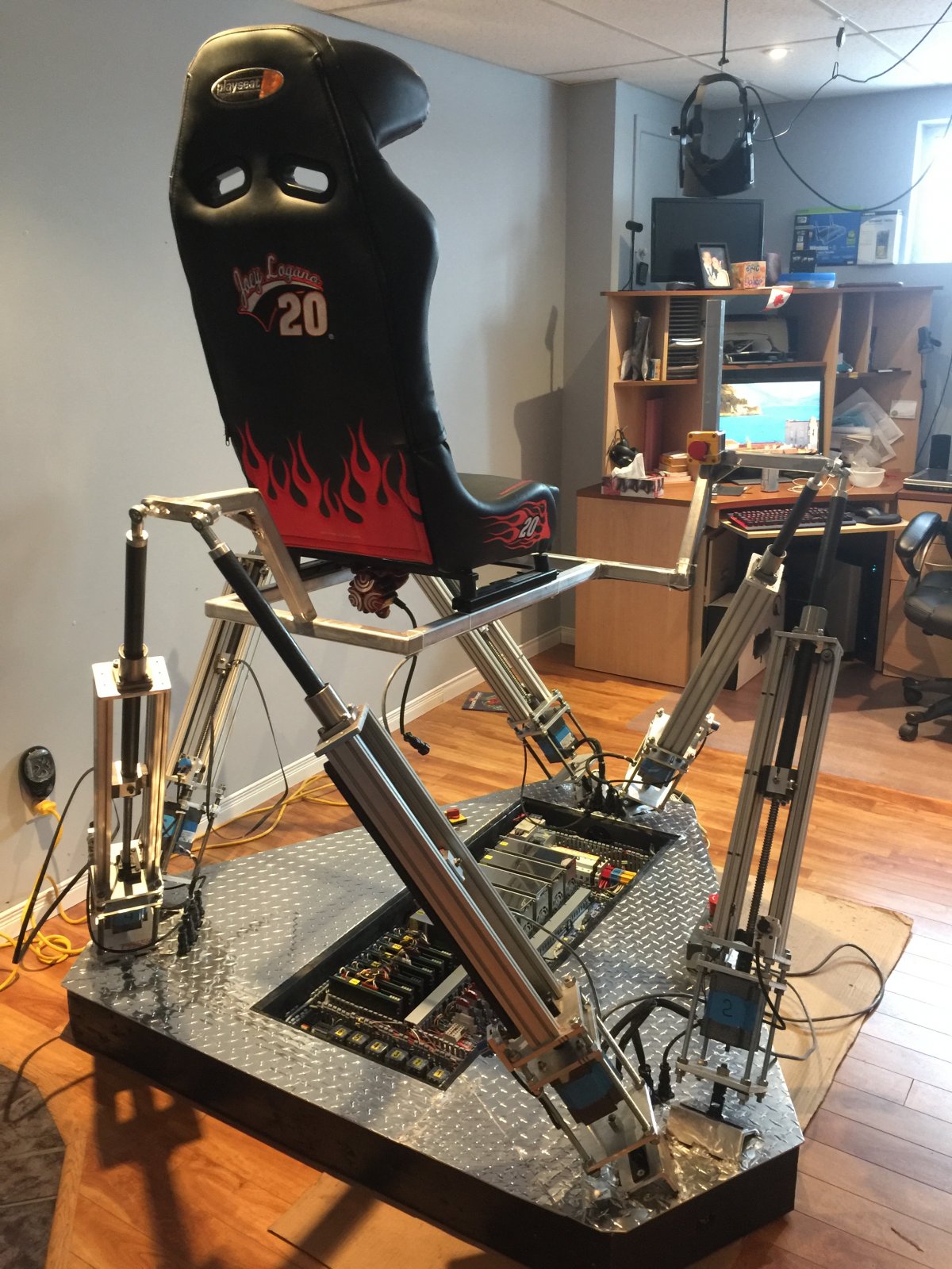

    DC motor, 6DOF

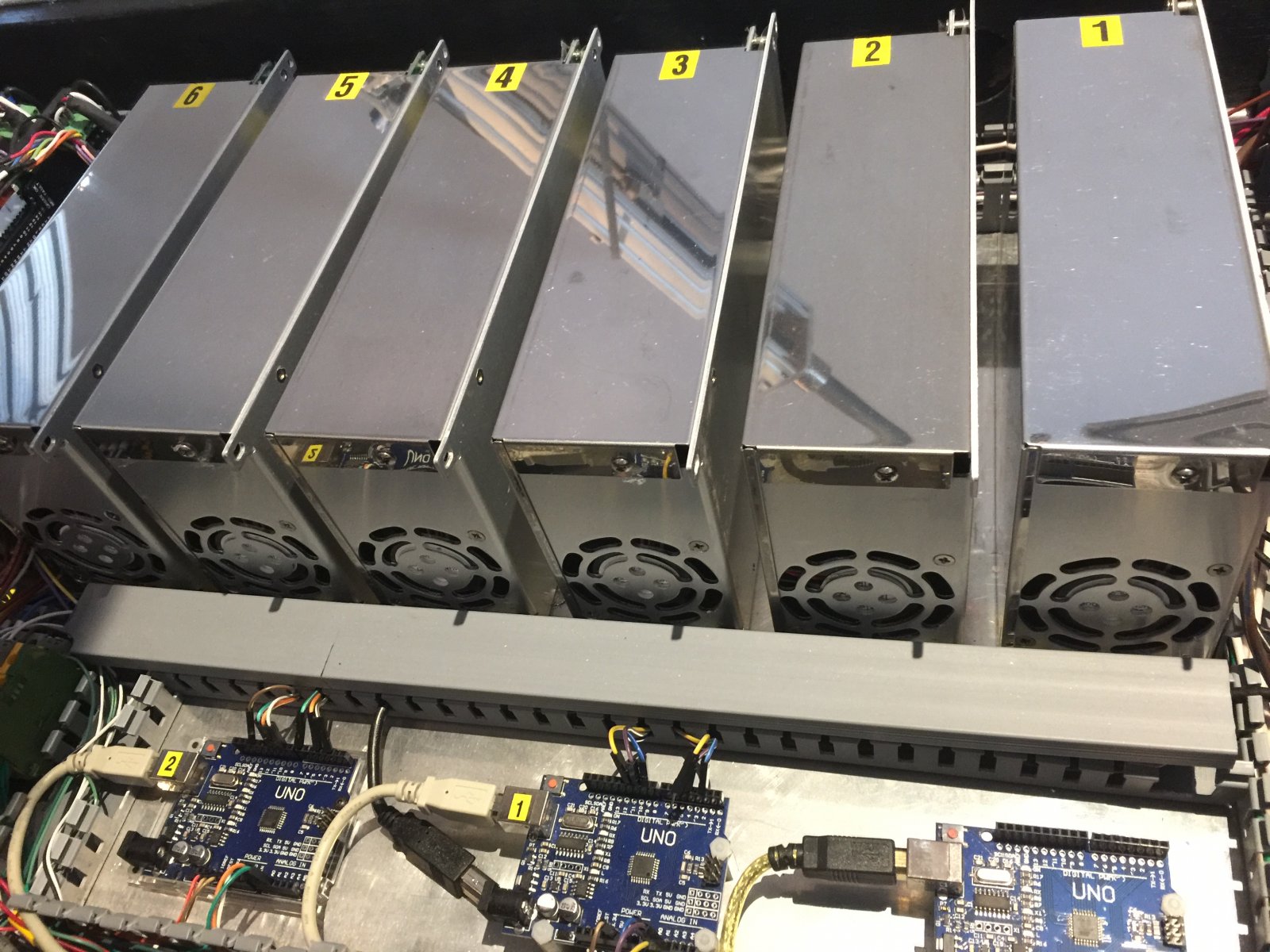

    New up date !! I can see the light at the end of the tunel :grin

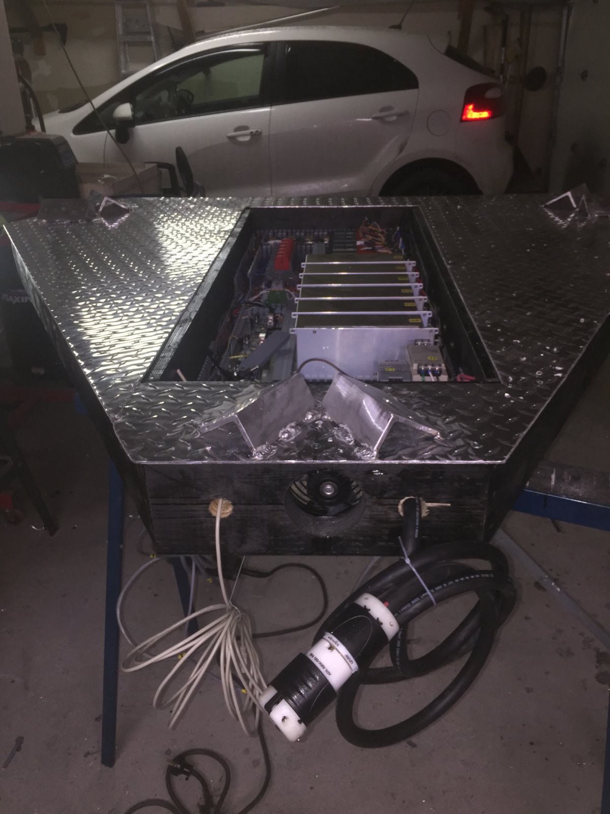

  3. SilentChill
    2,653
    20,661Coins
    +3,593 / 34 / -0

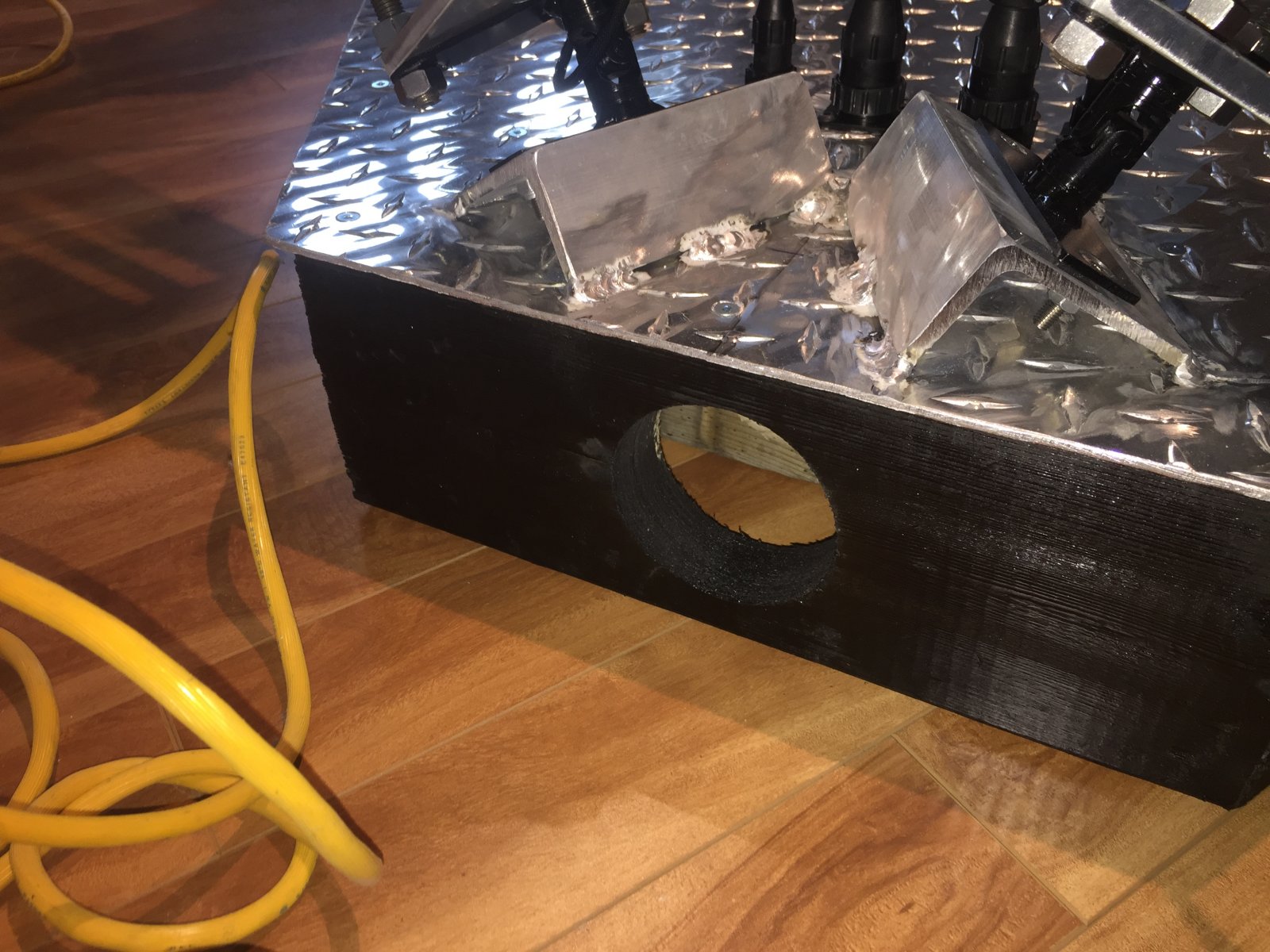

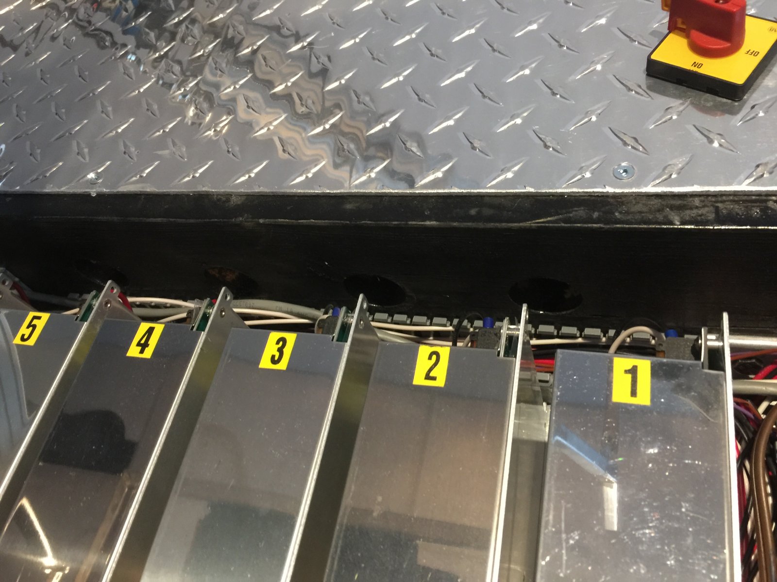

    Hiya you need to tag us in the post properly like @SilentChill or else it will not come up in our notifications :)
    Great work by the way, looking forward to seeing it all setup and in action ;)
    edit: I hope you've got plenty of fans pushing air through your controller box

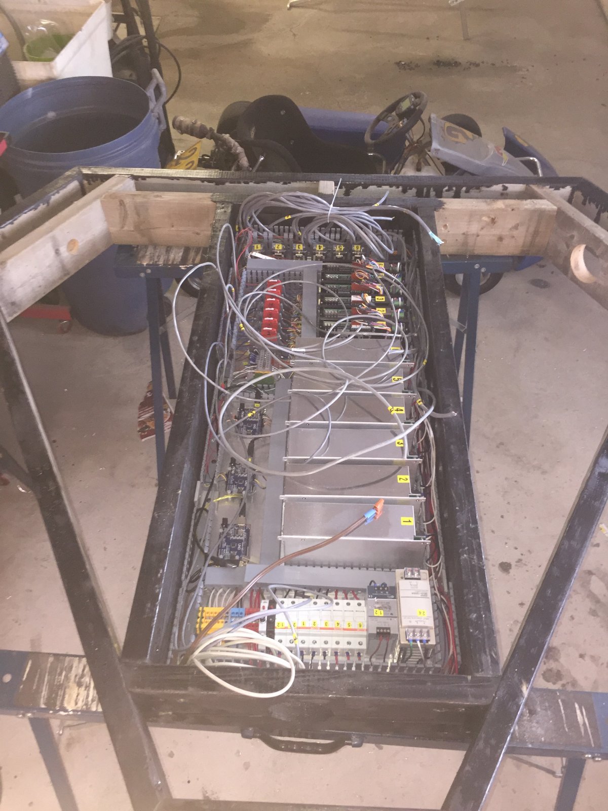

  4. Flymen
    May 19, 2018
    355
    Montreal, Canada
    2,503Coins
    +196 / 2 / -0
    DC motor, 6DOF

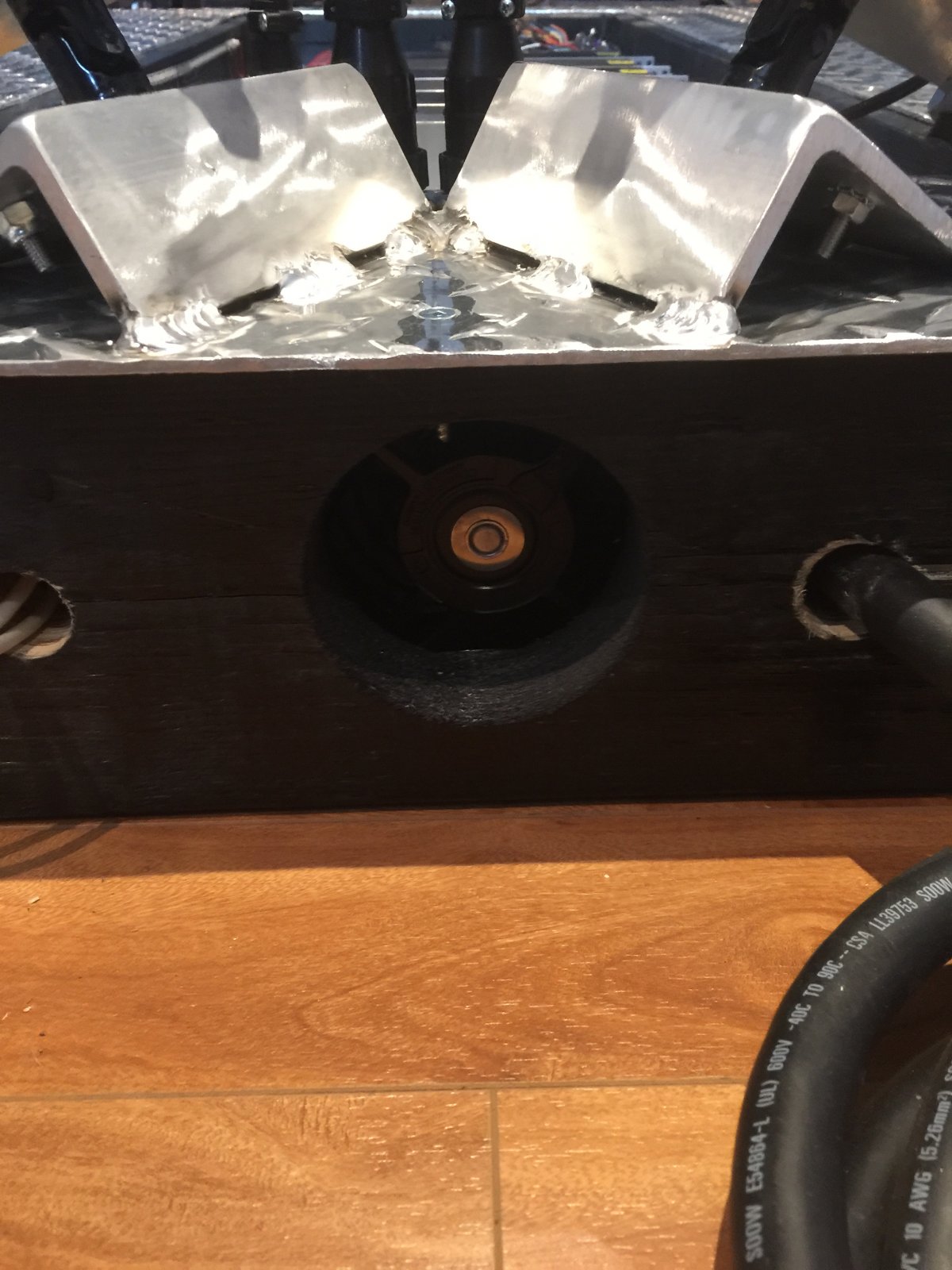

    Hiya…
    yes , I have some fan to pushing air through the box ( see pic )
    All Power supply have a Fan !!! and two others , in and out the box !!
  5. Flymen
    May 19, 2018
    355
    Montreal, Canada
    2,503Coins
    +196 / 2 / -0
    DC motor, 6DOF

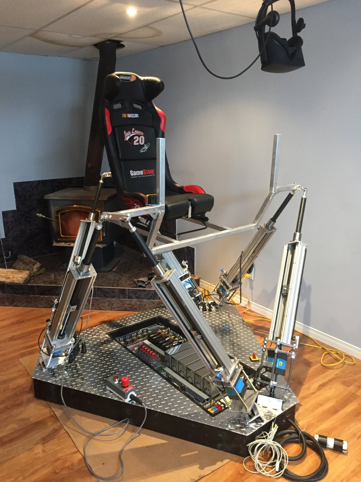

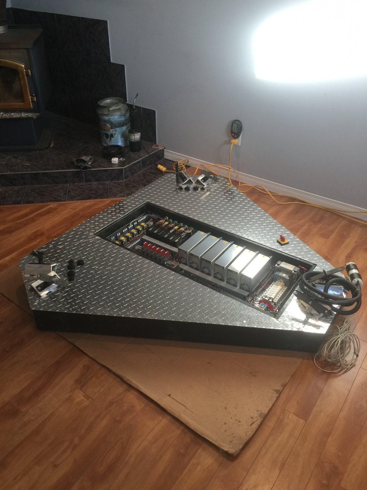

    A Baby is Bornnnn!!!!:thumbs
    Next step , is put the power on it and try every safety limit and EPO !!! and finaly FlyPT Hexapod Interface tonight or tomorow !!!:grin

    Just found it, just read it, right at the last streach before the end. (It`s never finish.)
    And just like SilentChill, I was worried about the air flow in your electronic's box.
    Your actuator looks powerful and I'm looking foward to see them in action.

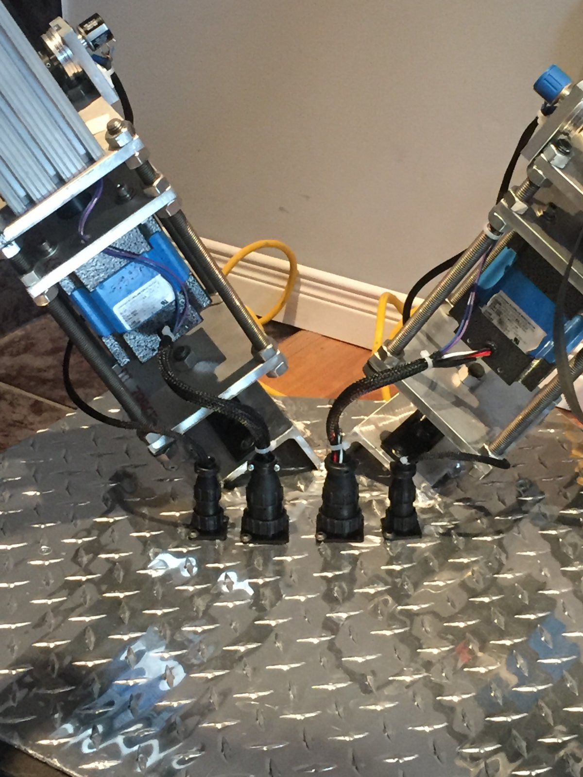

  8. SilentChill
    2,653
    20,661Coins
    +3,593 / 34 / -0
    Have you tried getting a 10turn hall effect to test ?
    https://uk.farnell.com/bourns/amm20b5a1clasl380/position-sensor-multiturn-42mm/dp/2292033?ost=amm20b&ddkey=https:en-GB/Element14_United_Kingdom/search#
    Thats what I am getting for my upgrade, they are rated at 500rpm which should just about cut it for these actuators
    edit: also how does the frame feel is there any flex in it ? i guess you cant tell until you get it all up and running properly :)

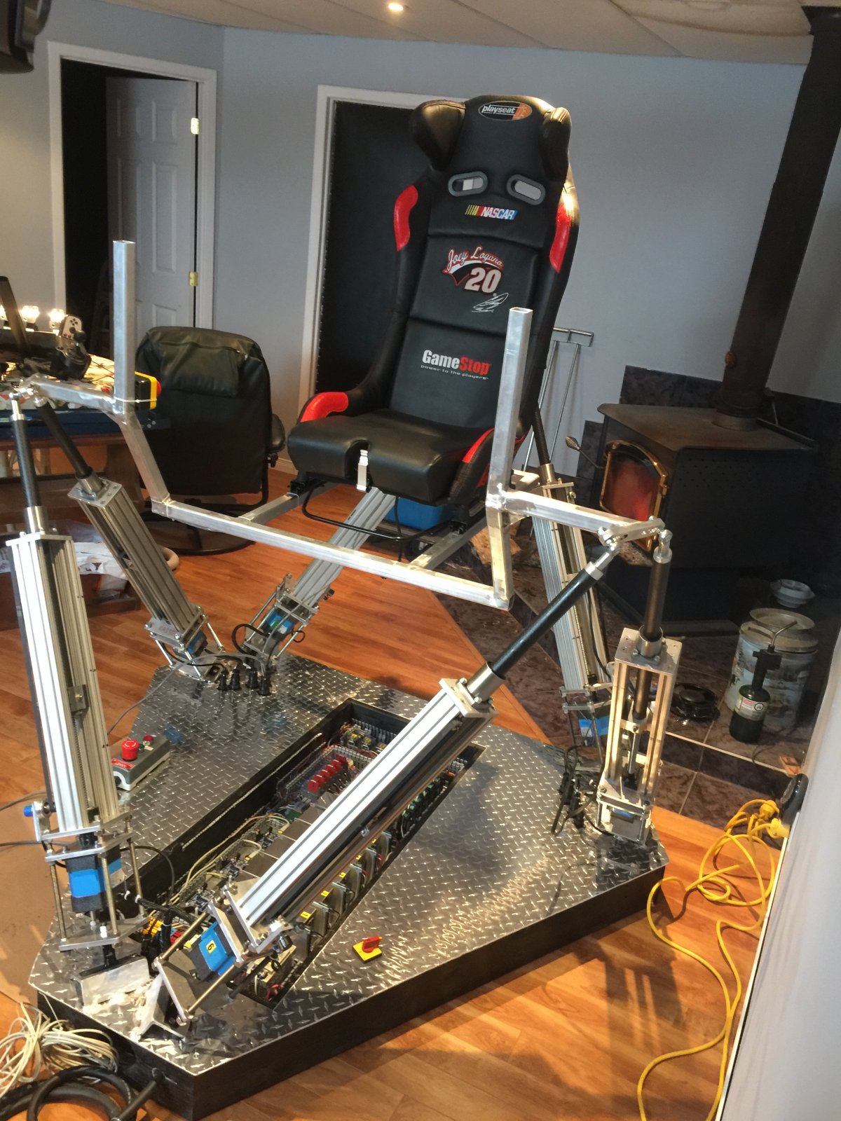

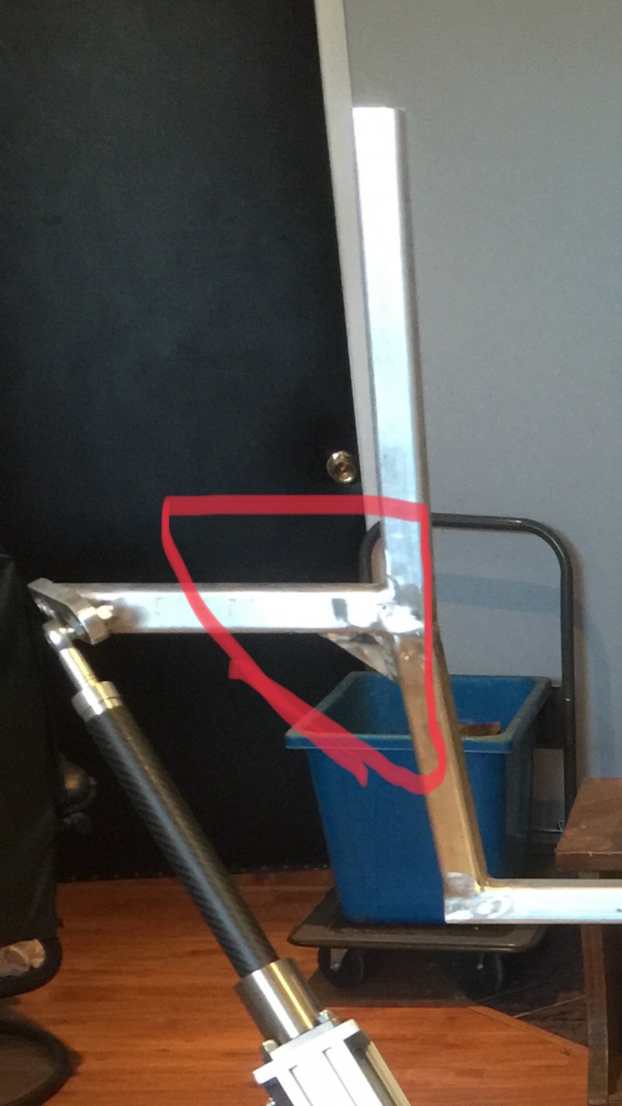

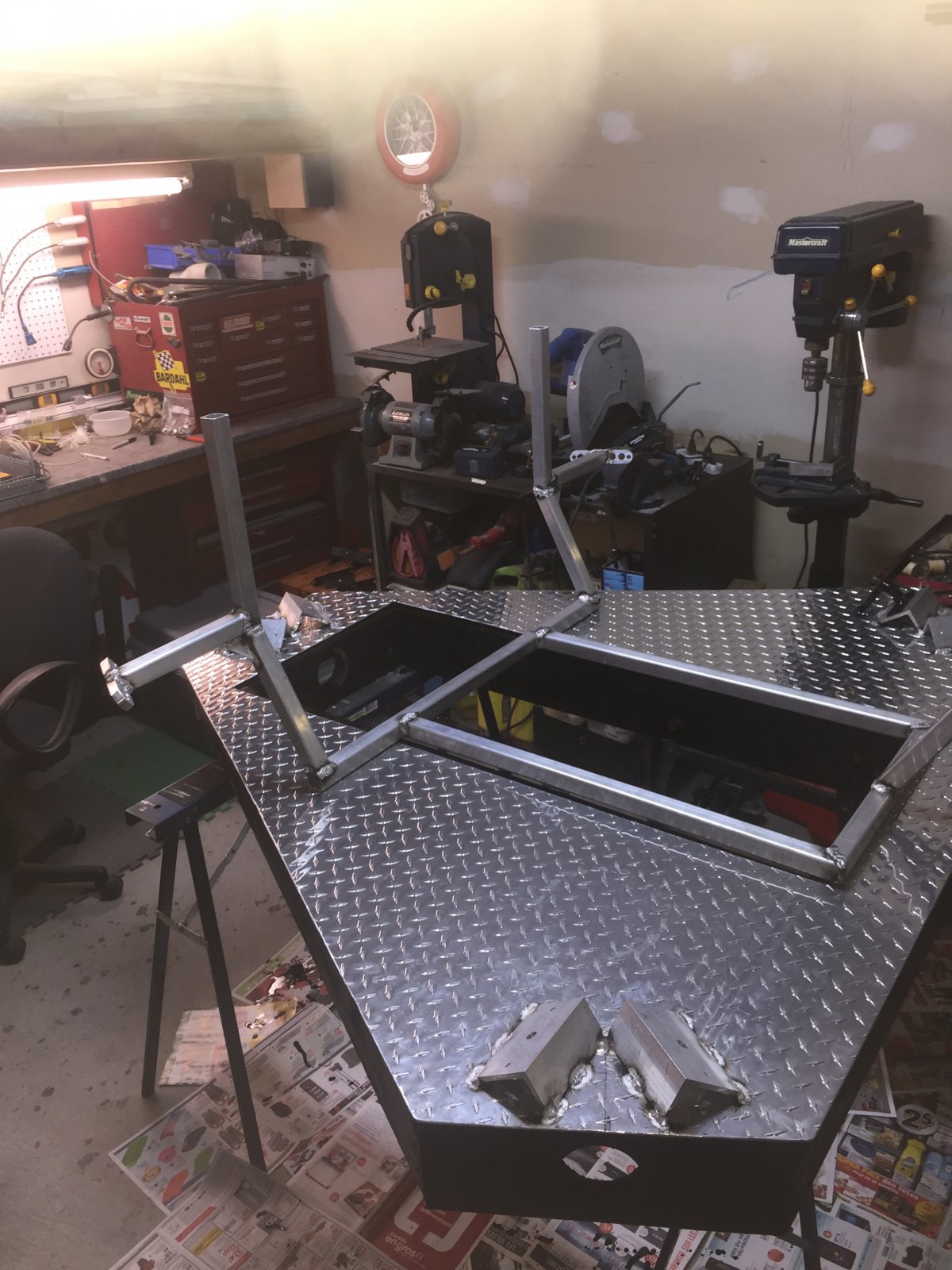

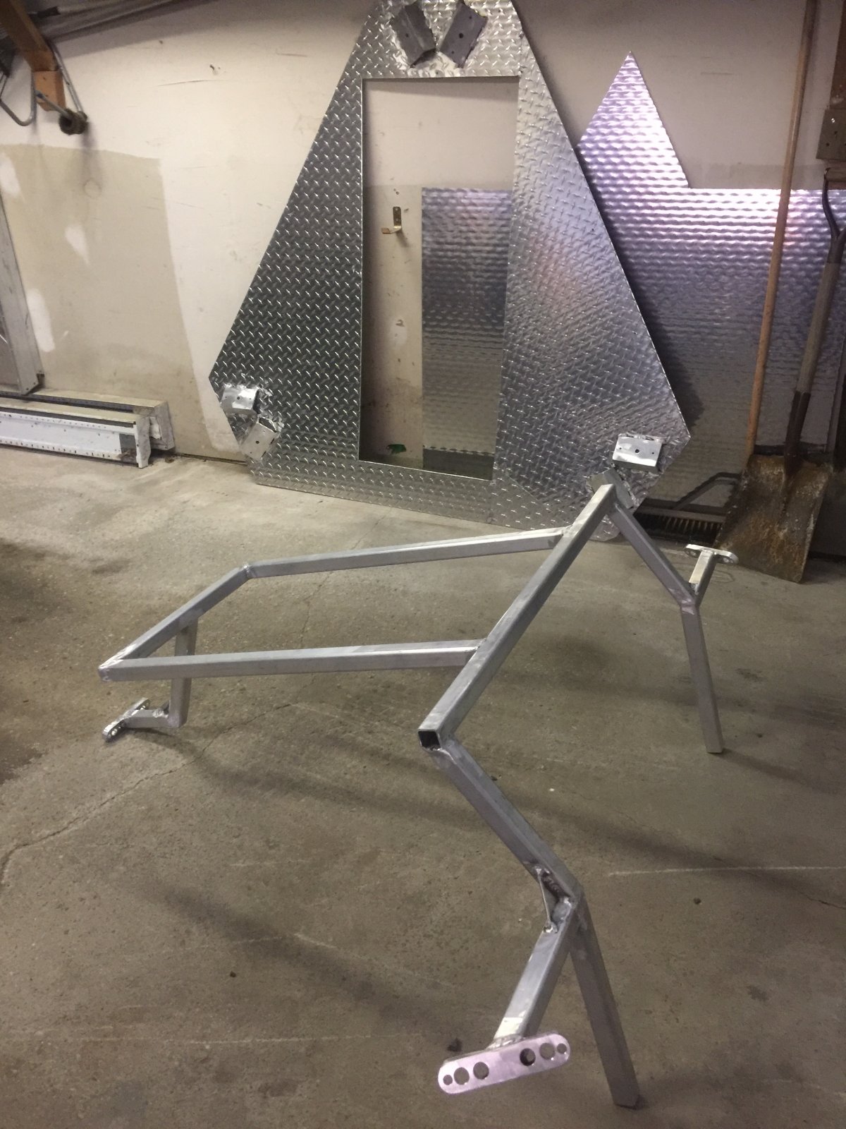

  10. SeatTime
    2,572
    +2,854 / 40 / -0

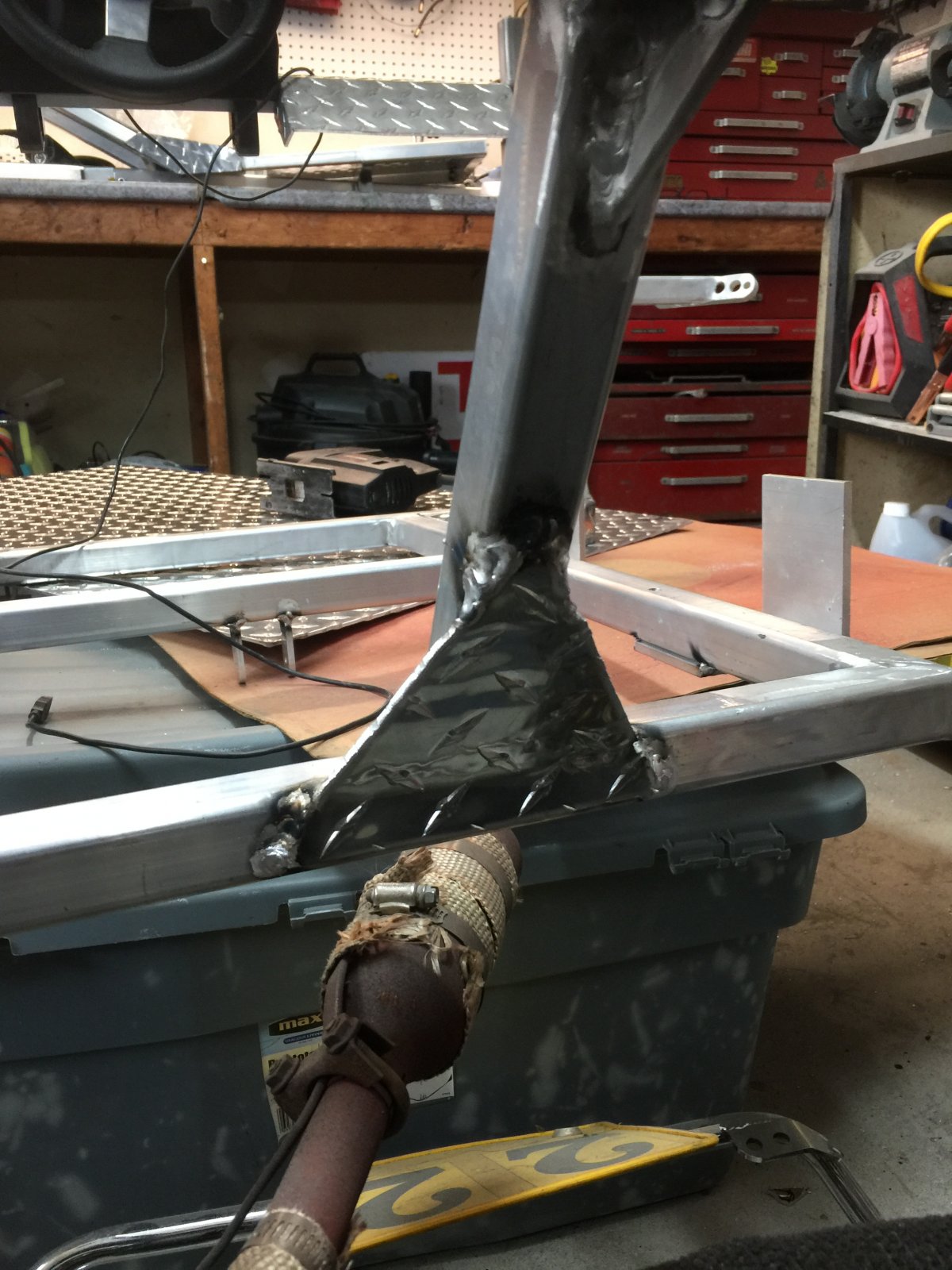

    Is that your final cockpit design? If so, I predict allot of flexing and then the metal will fatigue near the joint and fail just like this:
    You will then fall a good distance right into your electronics :eek:. Note: In the video the weld did not fail, it was the actual metal near the weld/joint - fixed with metal gussets.
    Recommend you put in a cross brace between the two front supports and then gusset all the main joints.

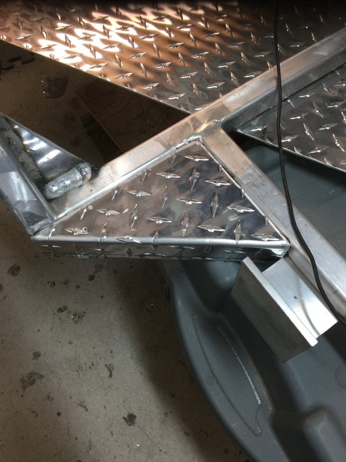

  11. Flymen
    May 19, 2018
    355
    Montreal, Canada
    2,503Coins
    +196 / 2 / -0
    DC motor, 6DOF
    Hi , that I did ! (see pics ) I will see if I need more at specific place after some run .
    Thanks a lot for your help !

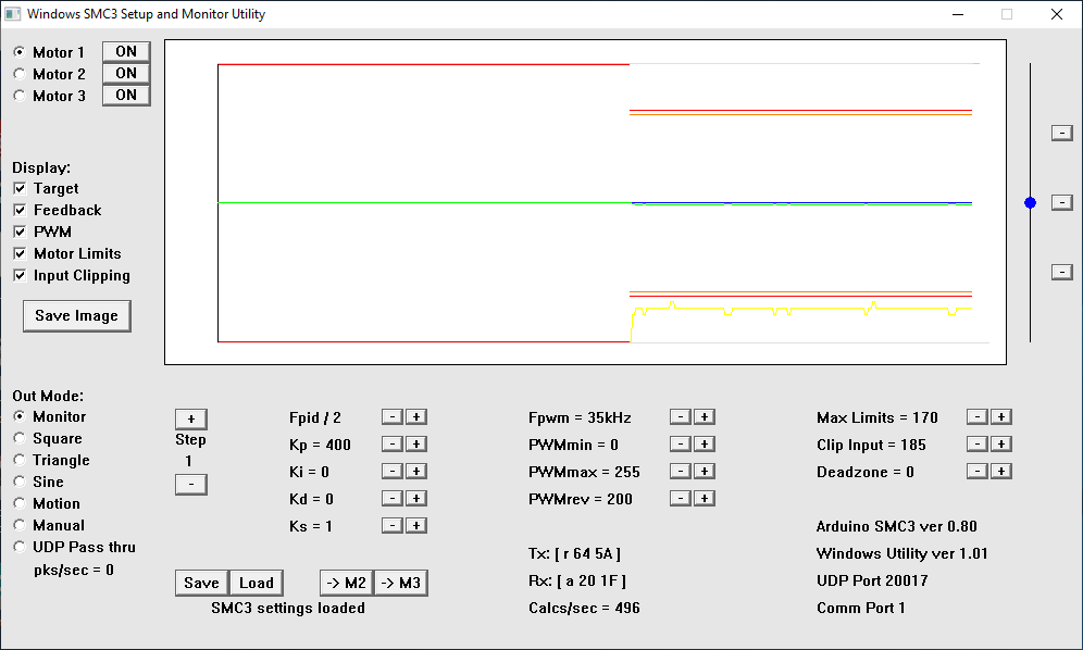

  13. pmvcda
    pmvcda aka FlyPT
    Nov 3, 2010
    2,288
    Portugal
    15,998Coins
    +2,742 / 18 / -0
    Was that movements only with the interface?
    If yes, you have so much tuning to make, it oscillates everywhere...

  15. Pierre Lalancette
    Dec 11, 2016
    1,012
    Tech Artist
    Quebec, Canada
    8,052Coins
    +947 / 6 / -0
    3DOF, DC motor, Arduino, 6DOF
    The first thing I would do is to check your smc3 values:
    I had choppy movement on my rig and I put Fpid at 4 or even 5 to smooth it out. I put my Fpwm at 25hz since it did not seem to change much anithing. Also, play with Kp. In a tutorial, it says that Kp was the value with most affect on the movement. Test it out from 350 to 500. To tell you the true, I did not see much difference with Kp, but change Fpid if its too low.

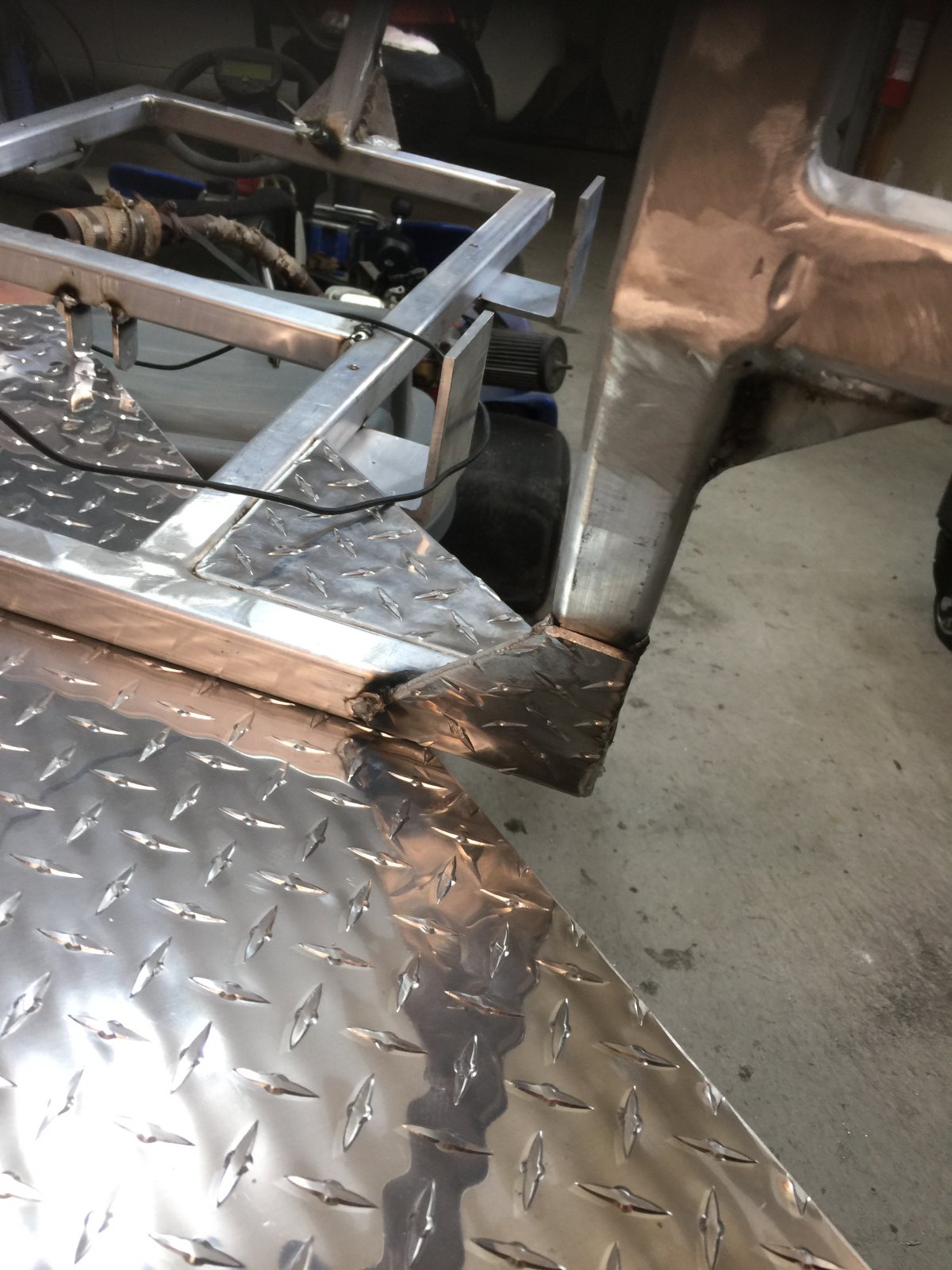

  16. Flymen
    May 19, 2018
    355
    Montreal, Canada
    2,503Coins
    +196 / 2 / -0
    DC motor, 6DOF

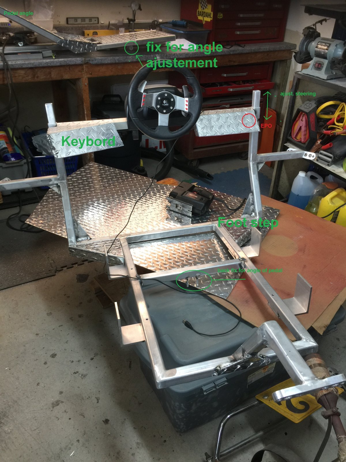

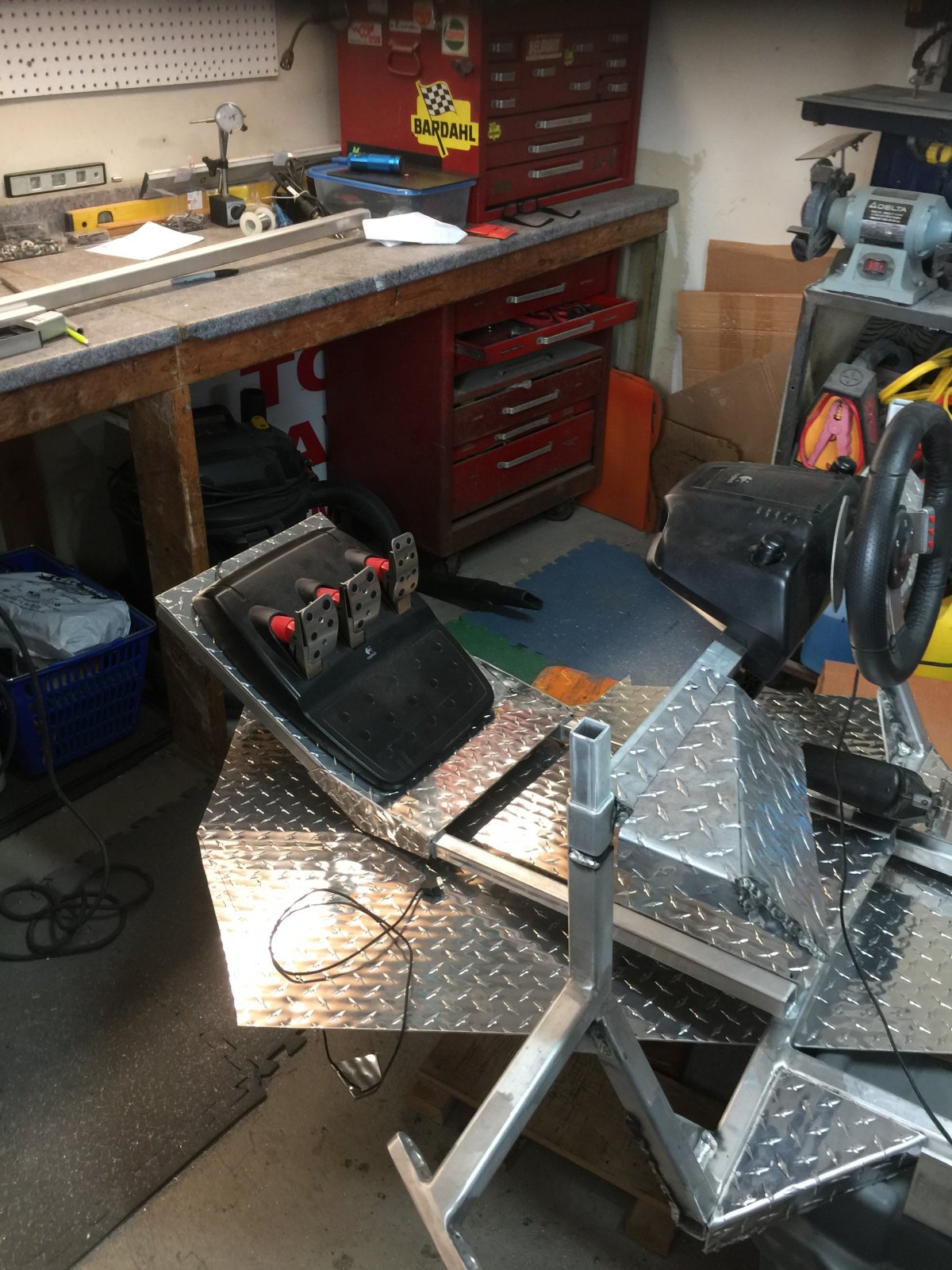

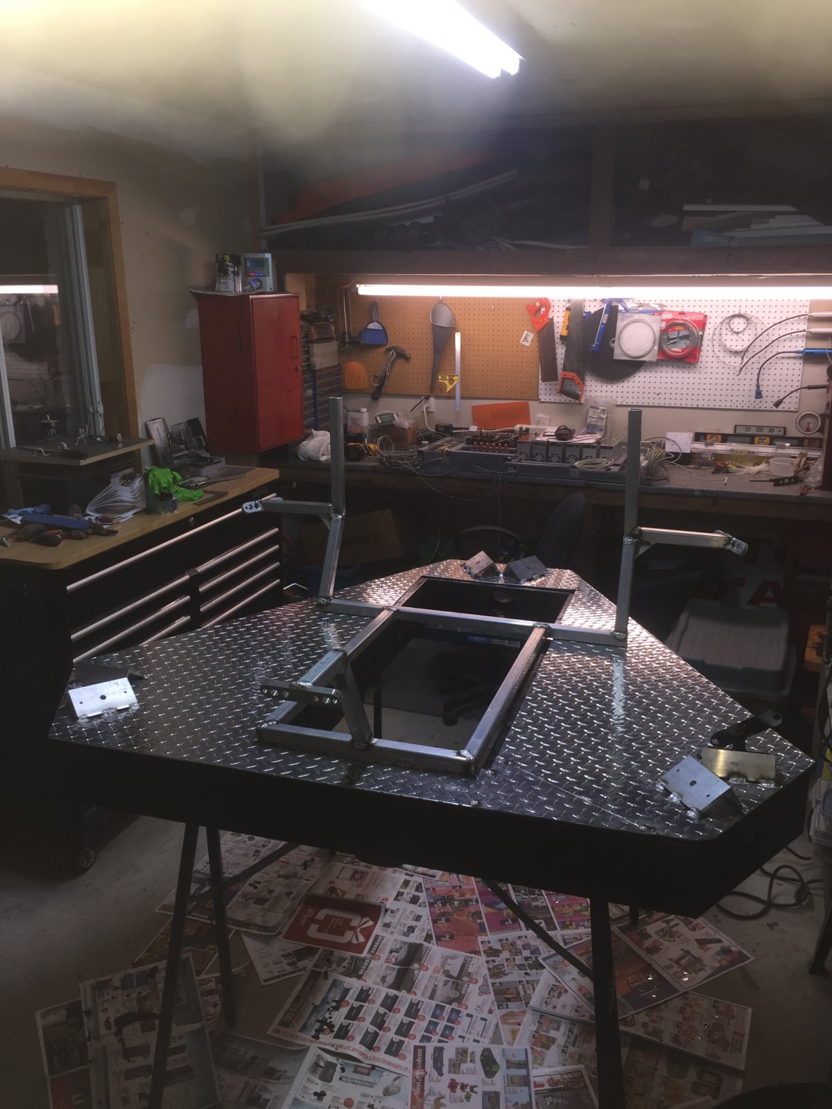

    After playing with my friends over 200 lbs who was able to do 3 rounds of No limits 2 without **dégueulé**:eek::blush, I saw the frame a little curve without damage. but friends them oufff ...f ..:cheers.
    New up date photos for the final cockpit design!

    Yep! Now your talking! That's a beast. I could even try it myself now.

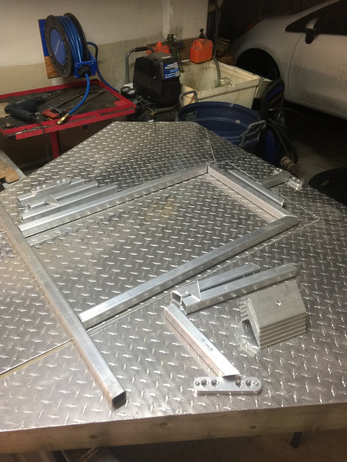

  19. Flymen
    May 19, 2018
    355
    Montreal, Canada
    2,503Coins
    +196 / 2 / -0
    DC motor, 6DOF
    You are welcome !:grin:thumbs:popcorn
  20. SilentChill
    2,653
    20,661Coins
    +3,593 / 34 / -0
    Nice work ! What size box Ali did you use for your frame , 40x40x3 ?
