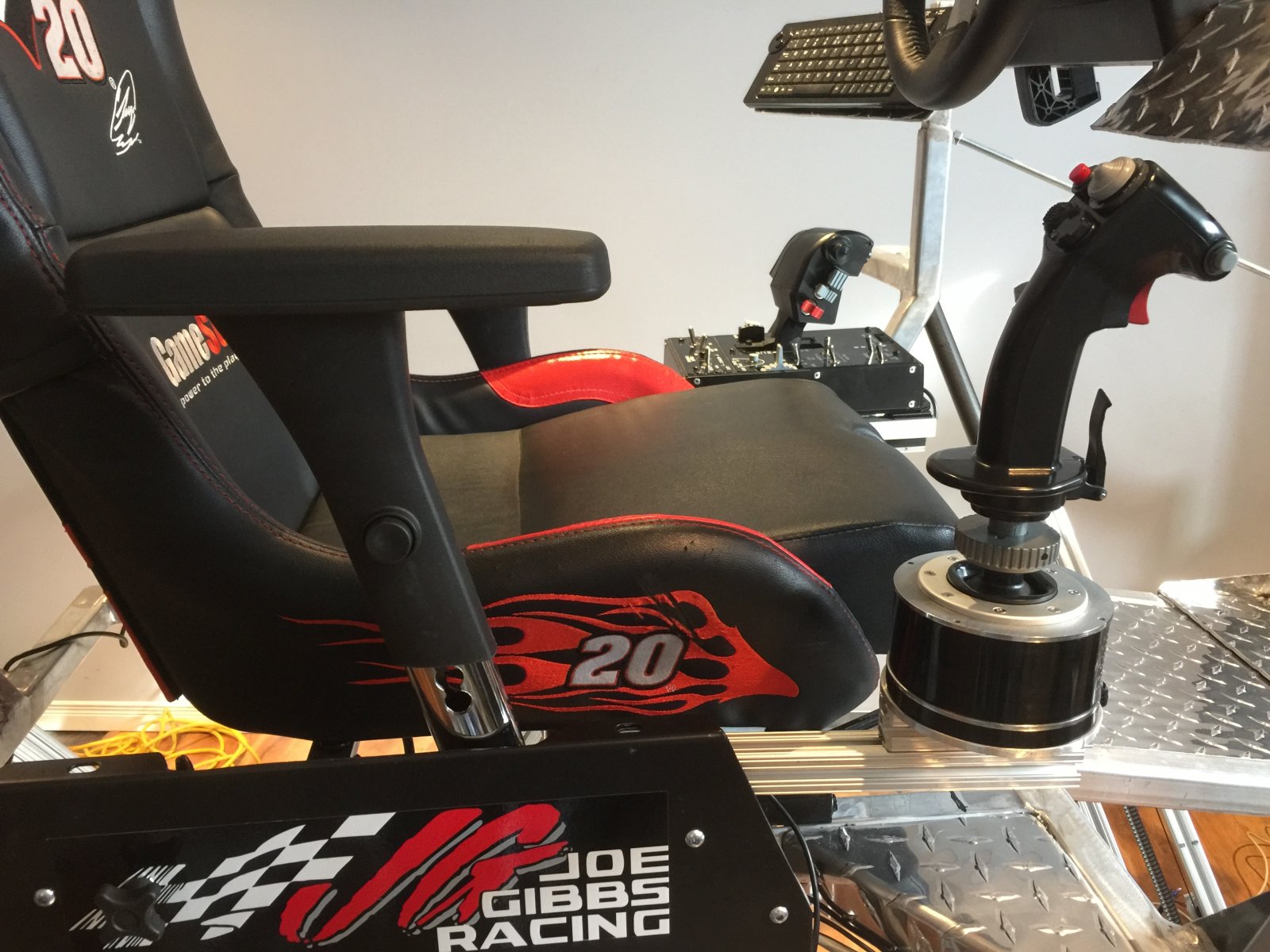

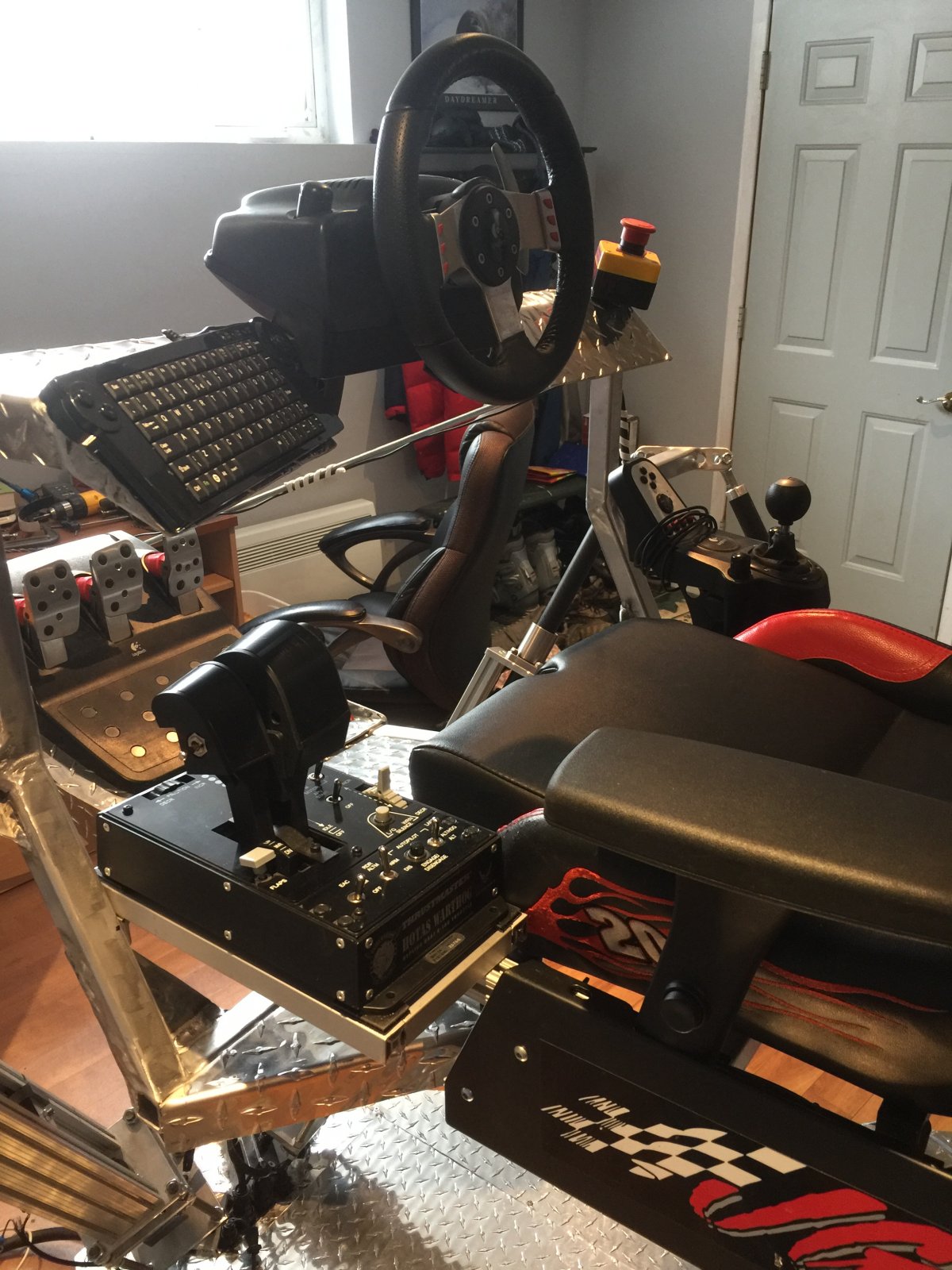

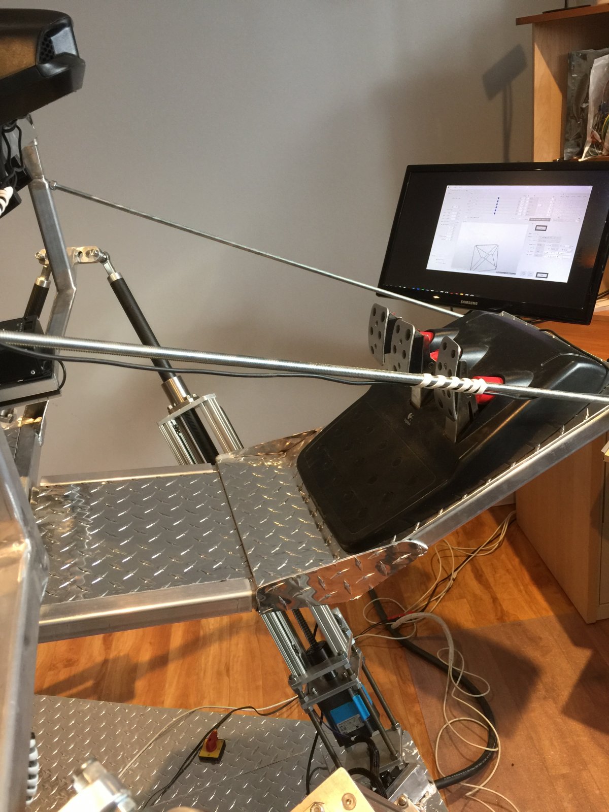

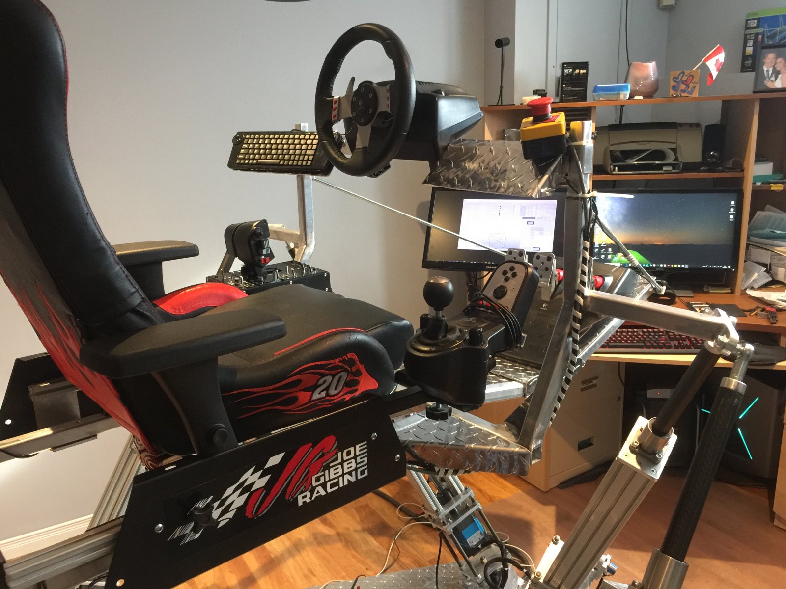

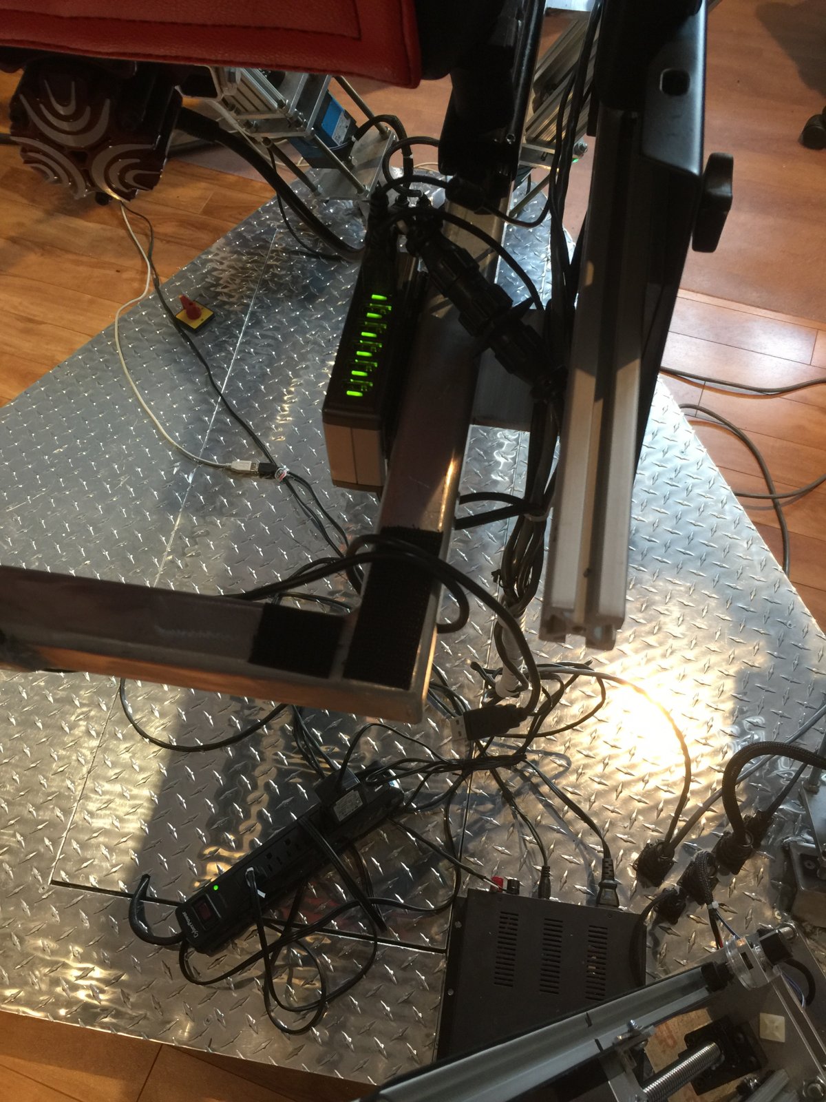

  2. Flymen
    May 19, 2018
    355
    Montreal, Canada
    2,503Coins
    +196 / 2 / -0
    DC motor, 6DOF

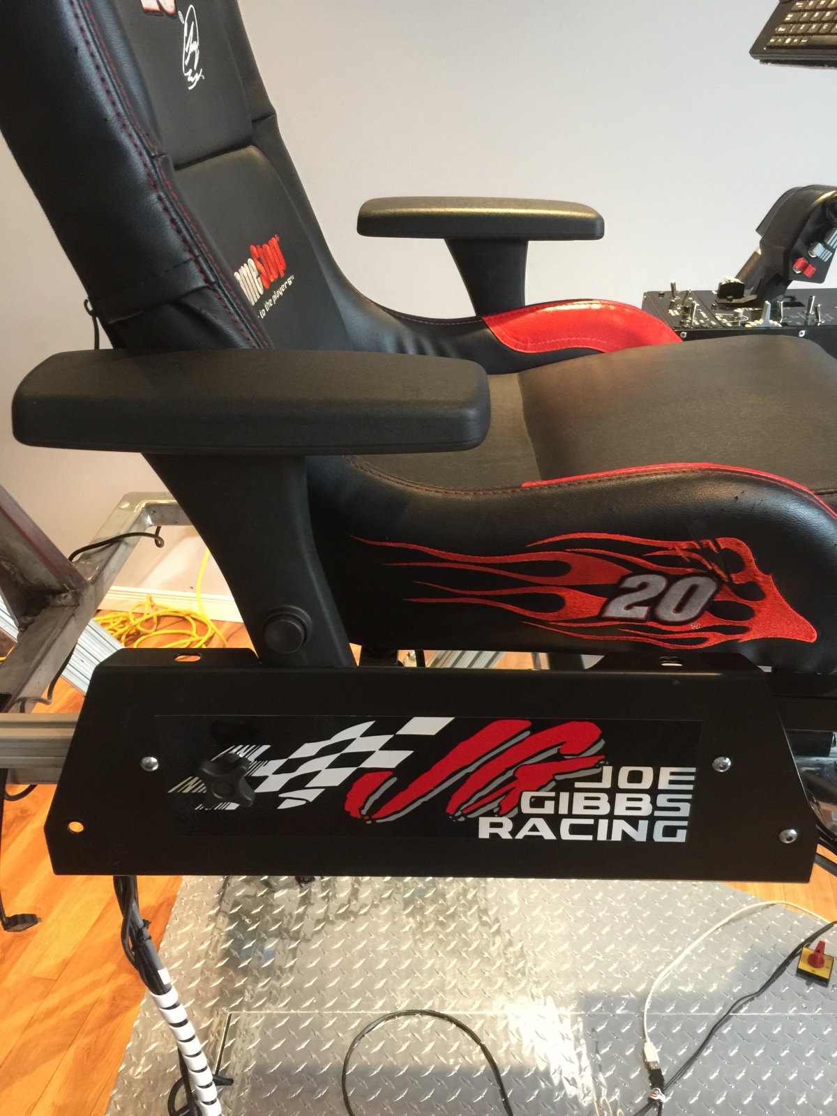

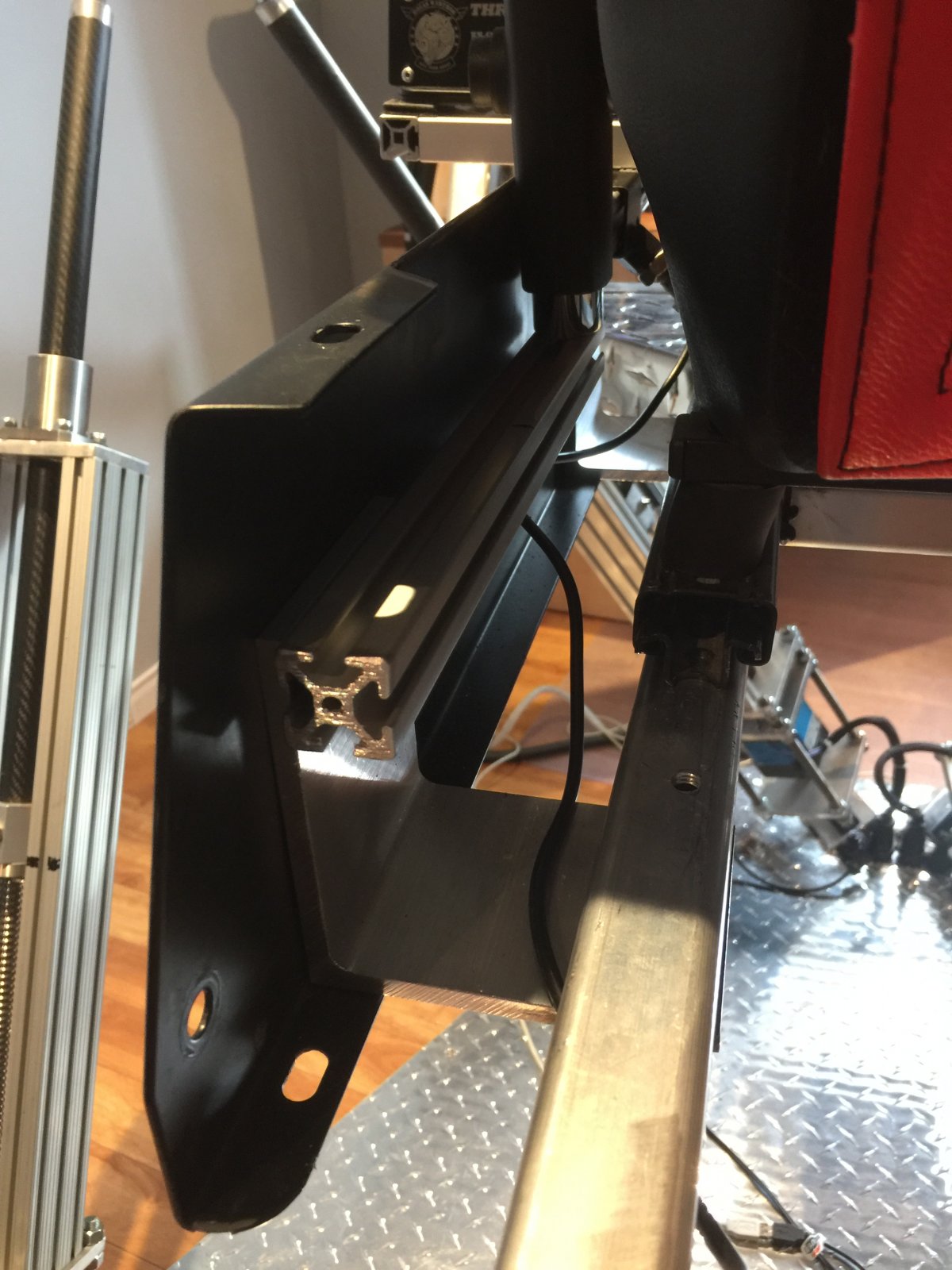

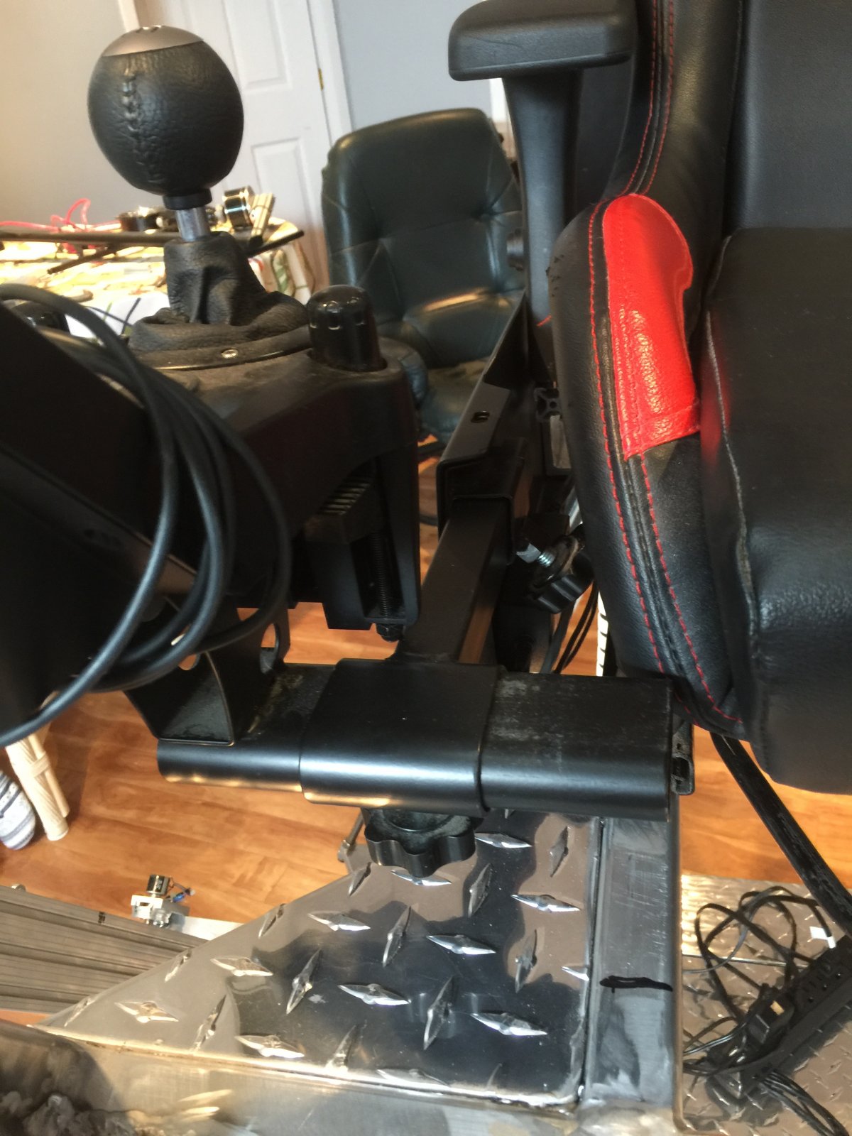

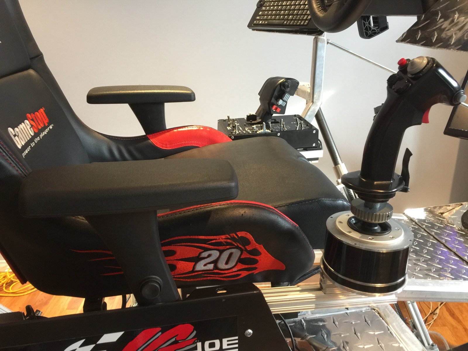

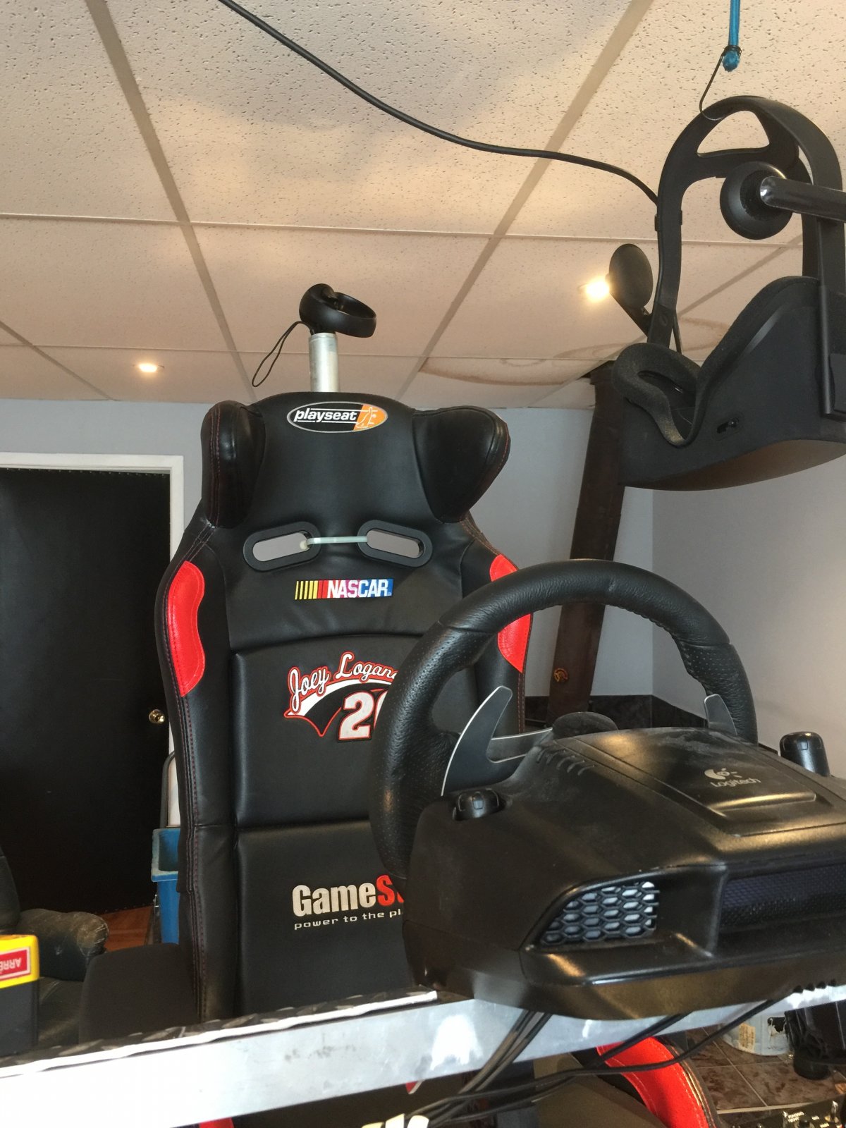

    New up date (see pics)
    When I go up on the simulator, I must move back up the bracket arm and remove the joystick if instead.
    * Next work 1 * I still have to make myself a step to climb on the simulator because it 's not enough low when he is at Lock in lowest position .( FlyPT Hex)
    *Next work 2 * I have still problem to set up the tuning ( oscillations), it's a lot better than before but need more work everywhere… I try to set up all toghether at same time up and down with* Heave pose* but also oscillate with other pose ..:thinkBut now with everything are in place the C.O.G will not change . Only the seat position can change the tuning . I will put next weekend 180 lbs of sandbag on my seat and See if I can do something With it

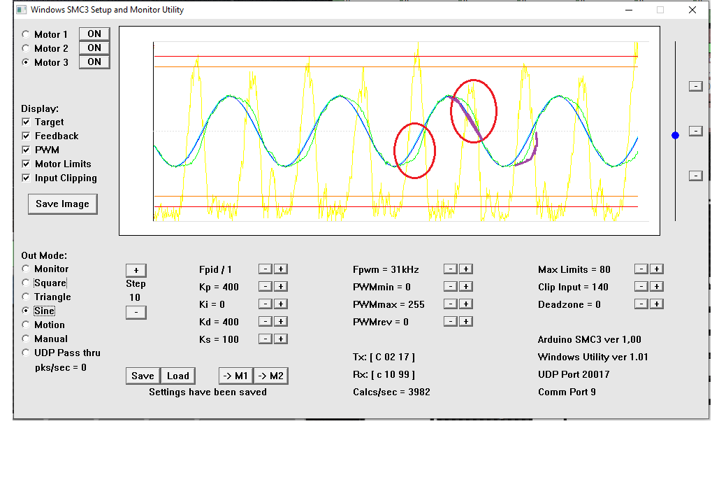

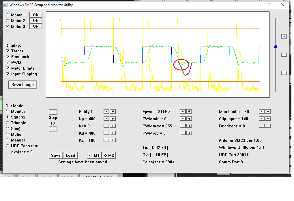

    With smc3 , when i use smc3 to change the motor power with the P.I.D, i don’t know why but the (kD) Dérivative does not work,and if I put 0 or 1000 , nothing changes !! maybe I don’t have the right version of smc3 !! or it does not work with the arduino card !! But all My oscillation problèmes seems to be from there !!!:sos

  3. Pierre Lalancette
    Dec 11, 2016
    1,012
    Tech Artist
    Quebec, Canada
    8,052Coins
    +947 / 6 / -0
    3DOF, DC motor, Arduino, 6DOF
    Man, it looks so cool.
    You are using Occulus, so I'm not sure how to do Motion Cancellation. I'm using Vive.

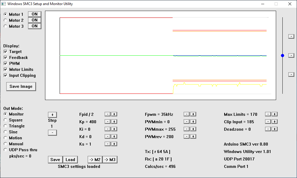

  5. SilentChill
    2,653
    20,661Coins
    +3,593 / 34 / -0
    Could you post a screen grab of your SMC3 utility settings so we can see if there is anything obvious :)

    Also, can you describe your occillation problem. I mean, my rig is never fully stable. The motors always turn half a turn in and out every half second. It's just not enough to be anoying.
    Another thing, I found out that testing the forces with simtools gives choppy movement most of the time. But when I test then into a game, they are much more smoother and direct.

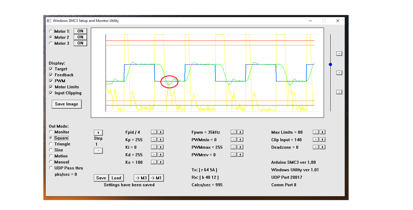

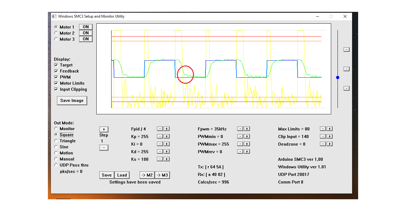

  7. Flymen
    May 19, 2018
    355
    Montreal, Canada
    2,503Coins
    +196 / 2 / -0
    DC motor, 6DOF
    I add color when I'm sit in the Rig ( with and without me ) , if I put Kd o or 400 , I can't see any diference ( 1 pic ) @SilentChill

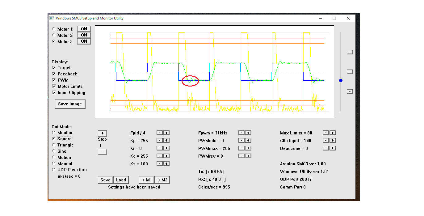

  8. Pierre Lalancette
    Dec 11, 2016
    1,012
    Tech Artist
    Quebec, Canada
    8,052Coins
    +947 / 6 / -0
    I think Fpid is way too low. Mine is at 4 or 5.
    Me and SilentChill has the Kd = 0 and Ks = 1.
    Here is SilentChill grab screen he posted on my thread.

  10. SilentChill
    2,653
    20,661Coins
    +3,593 / 34 / -0
    Yeah that's your problem I think try setting FPID to at least 3 with KI 0 KD 0 and KS 1
    That should help hopefully

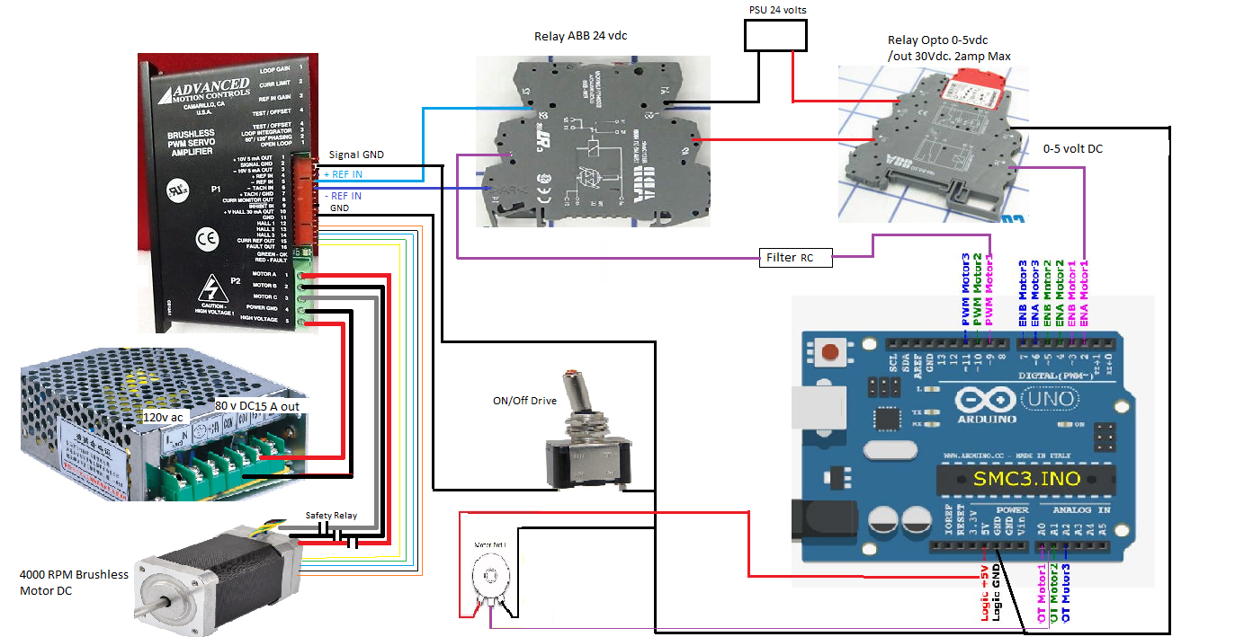

    Thanks a lot for your help but nothing change .
    The bug is still the same , only with Motor one I can control Kd …the rest I can't control Kd , or PWMrev with SMC3 / Arduino R3 .
    For all the rest everything work perfect !
    My set up for one actuator is with this mode : MODE1: H-Bridges , the only diference is that I use two contact relay to control direction of this drive from Advanced .( see pic)@gadgett
    @RufusDufus ,@yobuddy ,@pmvcda ,@SilentChill
    60005 smc3 port 8 no1.png smc3 port 8 no3.png smc3 port 8 no2.png advanced-motion-controls-b30a8-1-638.jpg advanced-motion-controls-b30a8-4-638.jpg advanced-motion-controls-b30a8-5-638.jpg

  17. Pierre Lalancette
    Dec 11, 2016
    1,012
    Tech Artist
    Quebec, Canada
    8,052Coins
    +947 / 6 / -0
    Unfortunately, I don't see any flaw in you scematic. Even though I am not sure how the signal to the aab relay 24v controls the motor via the amplificator. If all is connected correctly, I don't see why this would not work. Can't help you.
