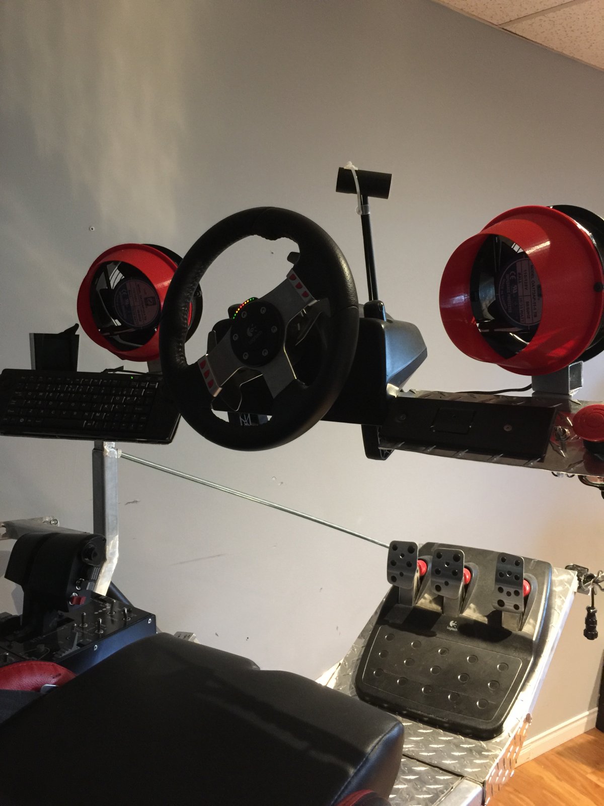

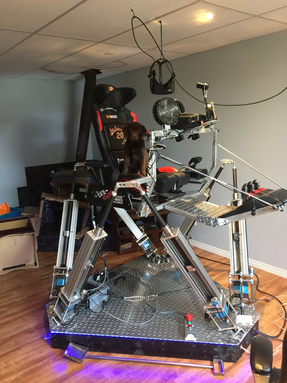

    Hello , new up date !!
    With those hot and humid temperature July and August I decided to put two fans. The dog is there for size reference. :) @Pierre Lalancette

    We have many problems here.
    First, the dog looks like is a puppy. How can we use it as a size reference if we don't know it exact age?
    Second, it looks like you had a spill around the chimney as your roof is spotted. You'll have to change those to have a perfect setting around your rig.
    Last but not least, one of the light is burned. You'll have to change it. I don't know if you have something around there that would be high enough to help you reach it?
    • Funny Funny x 2

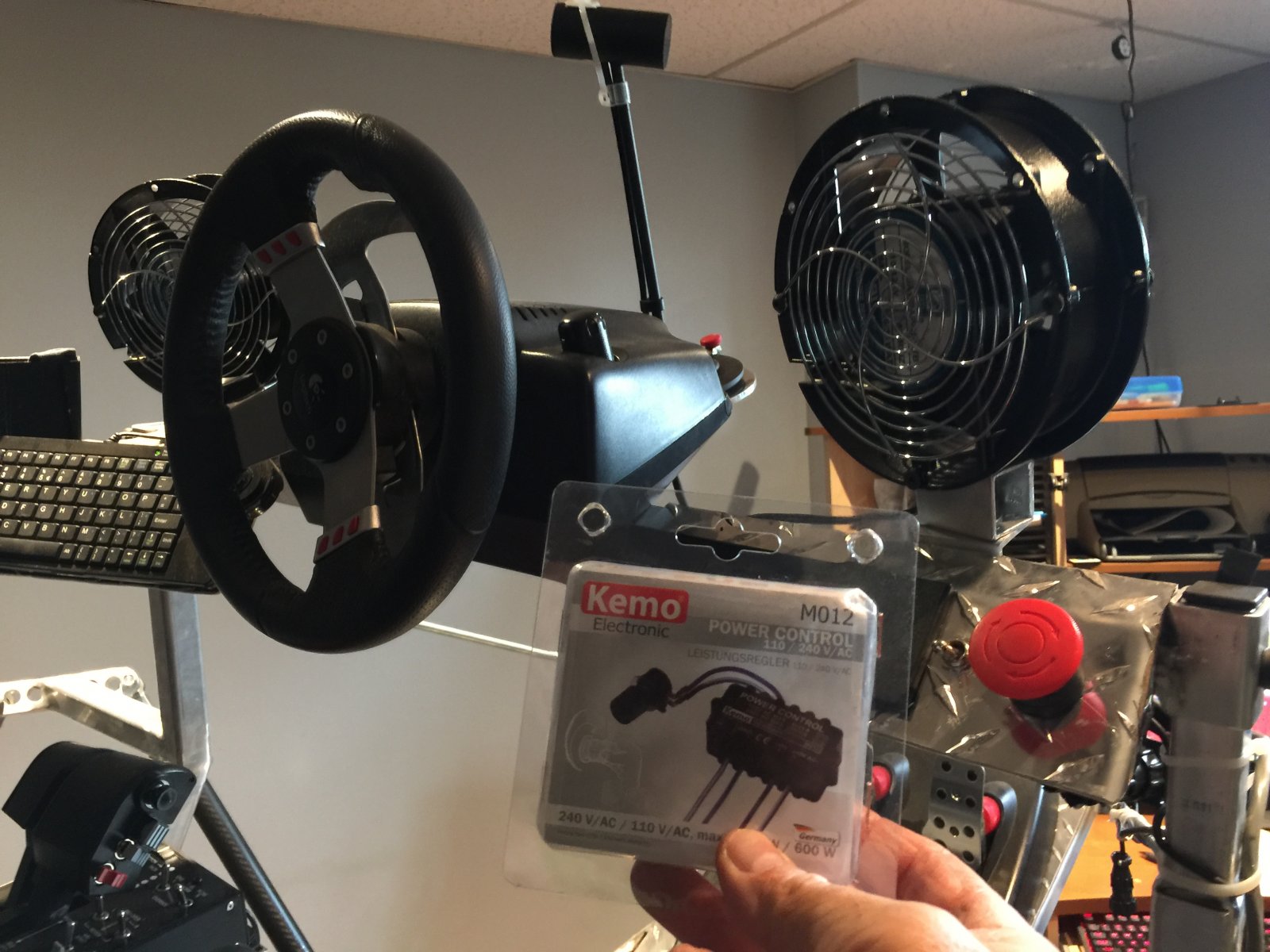

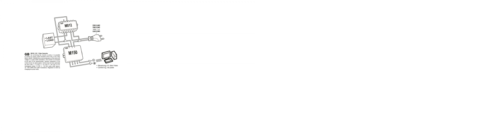

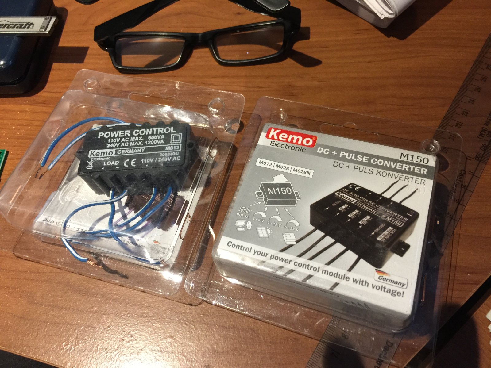

    I received this part today from ( Kemo Electronic M012) to control two fans with 120 volt AC , I will try to control this with Arduino uno , 0-5 volt DC with filter … more info soon !!!
    I need this too ( M150 module ) … to control M012 :oops:

  14. Flymen
    May 19, 2018
    355
    Montreal, Canada
    2,503Coins
    +196 / 2 / -0
    DC motor, 6DOF
    Too hot day for my Puppy , at 24 pounds it realy a dog now !!!:grin
    I will need a new control M150 finaly( see over) . May be just a fan 12/24v DC would did a job too but....may be with less wind !! I don't know
    I use this way because at my work I had a couple of those fans 120v for free $ but with the control it realy more expensive !!!
    For the moment, I have a single switch on my dash ( rig) where i can put on /off to eliminate some fogging in my VR headset !

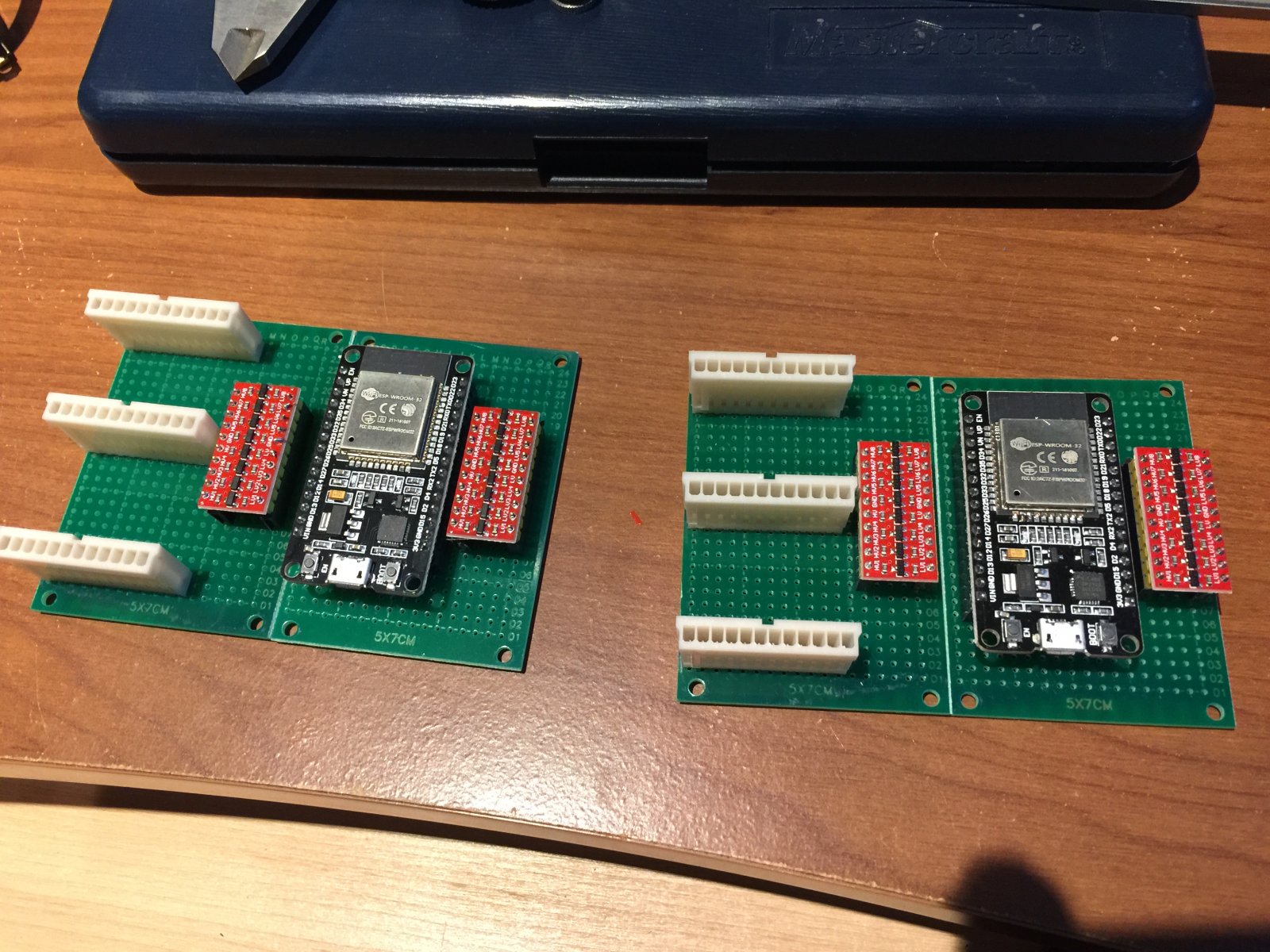

  15. Flymen
    May 19, 2018
    355
    Montreal, Canada
    2,503Coins
    +196 / 2 / -0
    DC motor, 6DOF

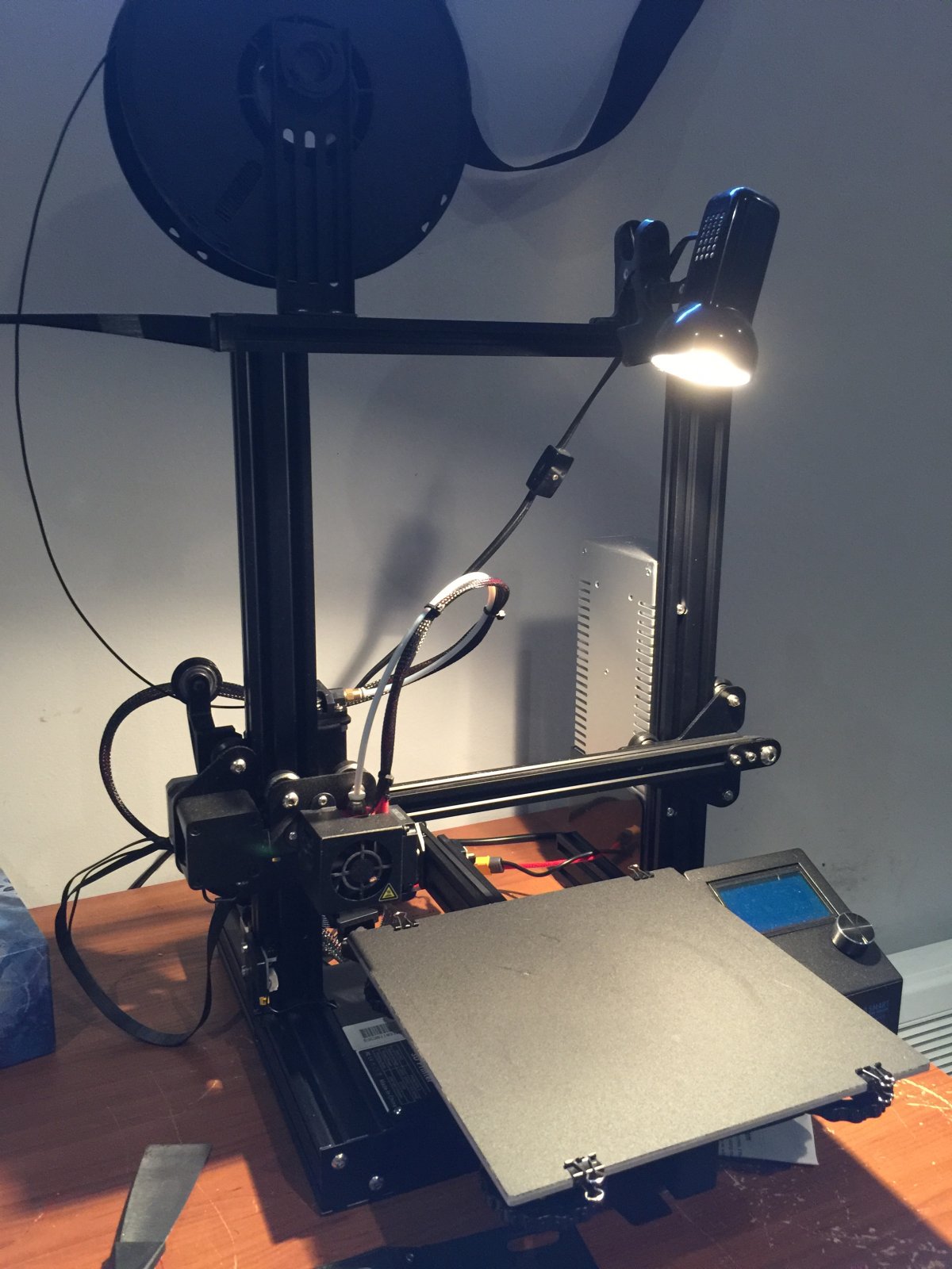

    I received the M150 for the wind project and my new toy ( Ender 3 printer ) :thumbs I have a list of print parts for her .. like my first one ( out put red cone ) on Autodesk Fusion 360 /Cura .
    Next step to change Arduino is on the way too ...ESP-WROOM-32 @pmvcda
    Finaly , lots of work for this winter ...

  17. Flymen
    May 19, 2018
    355
    Montreal, Canada
    2,503Coins
    +196 / 2 / -0
    DC motor, 6DOF
    Thanks , it's in my list !

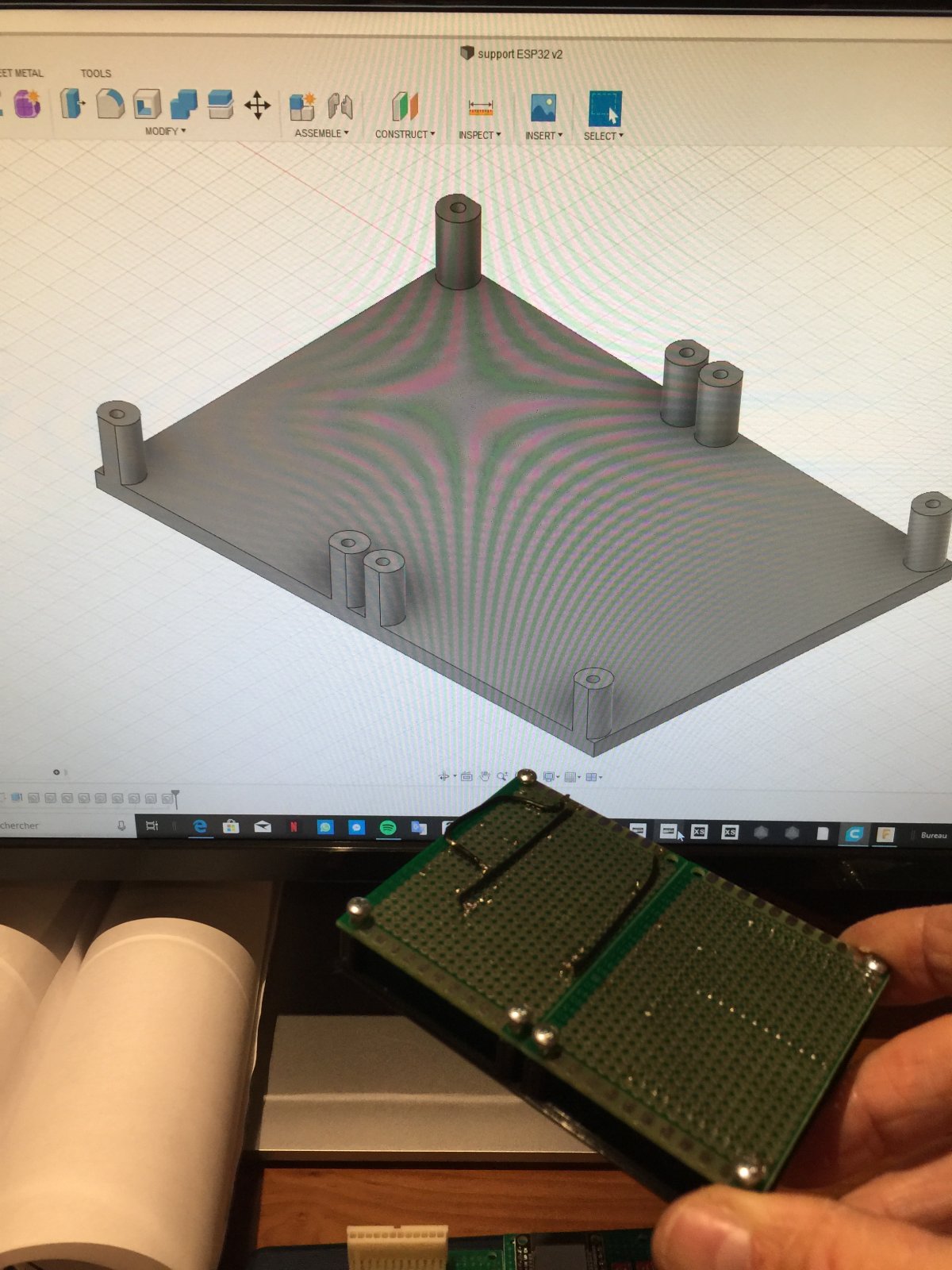

    This Printer goes very well !! I did a support for this card .
    I must be patient to put all wires correcly :roll

  19. Flymen
    May 19, 2018
    355
    Montreal, Canada
    2,503Coins
    +196 / 2 / -0
    DC motor, 6DOF
    Hi Pierre !
    Yes, it's two things . first experimentation and the wind is more concentrate on me .
    Those fans will be contrôle by two modules M150 and M012 ( see pic above) with Arduino.
    Salut Pierre !
    Cest deux choses , premièrement pour ma premiere experience et pour concentrer le vent plus sur moi .
    Les Fans seront controlées par deux modules M150 et M012 avec Arduino …. voir le shema électrique a l' une des conversations précédentes .

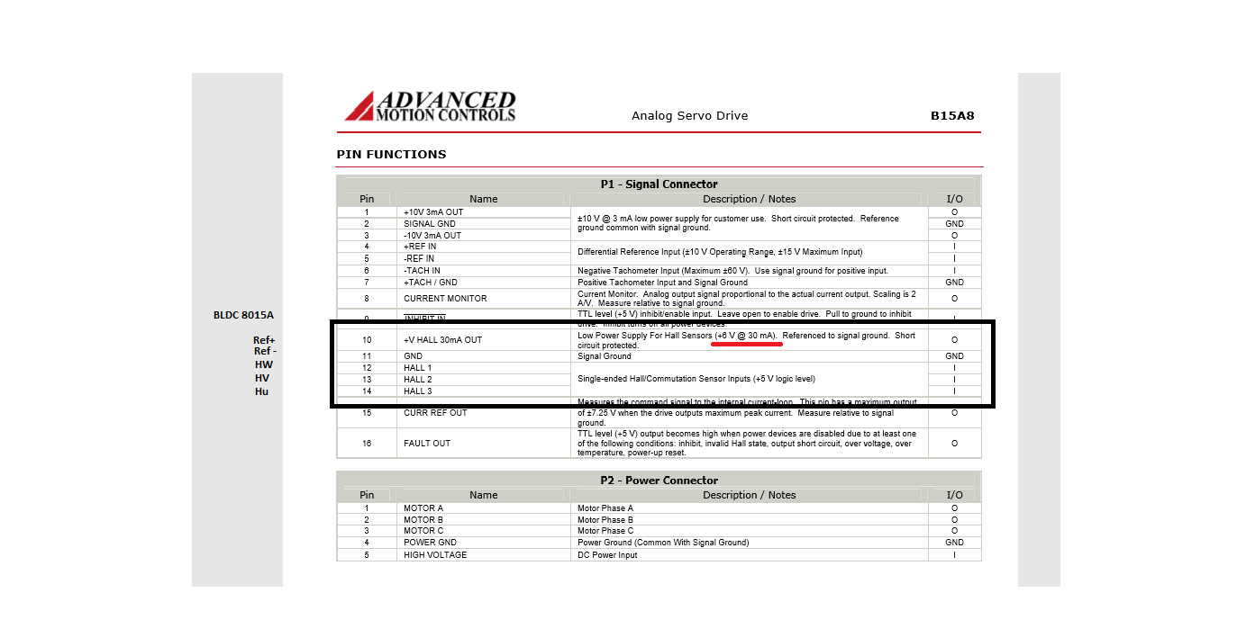

  20. Flymen
    May 19, 2018
    355
    Montreal, Canada
    2,503Coins
    +196 / 2 / -0
    DC motor, 6DOF
    @pmvcda Hi , I would like your idea on this .
    1- Your hall sensor are HW , HV and HU and my mine are : Hall 1 , 2 , 3. If I mix them it's not realy important on the boad ESP32 or the timing must be important ?
    2- On the pic you will see your Ref + and Ref - , and my mine are : + v hall 6 v, 30 ma and Gnd . The ESP32 give maximum 3.3 volt PMW and with level 5.0 volt right ?
    So, missing 1 volt and filter RC for controlling this ….:think?
    Thanks !
