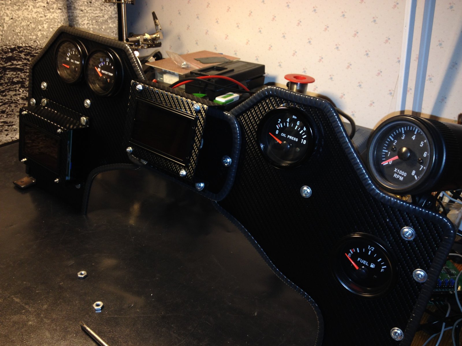

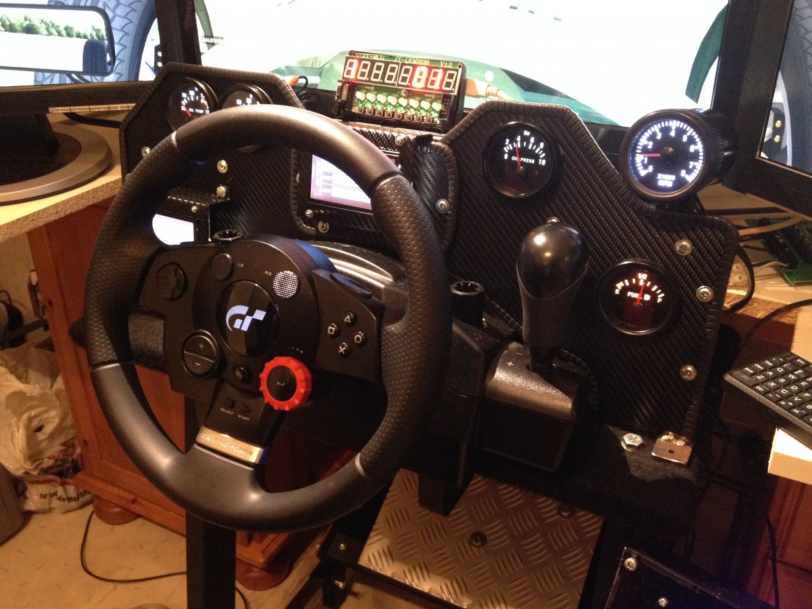

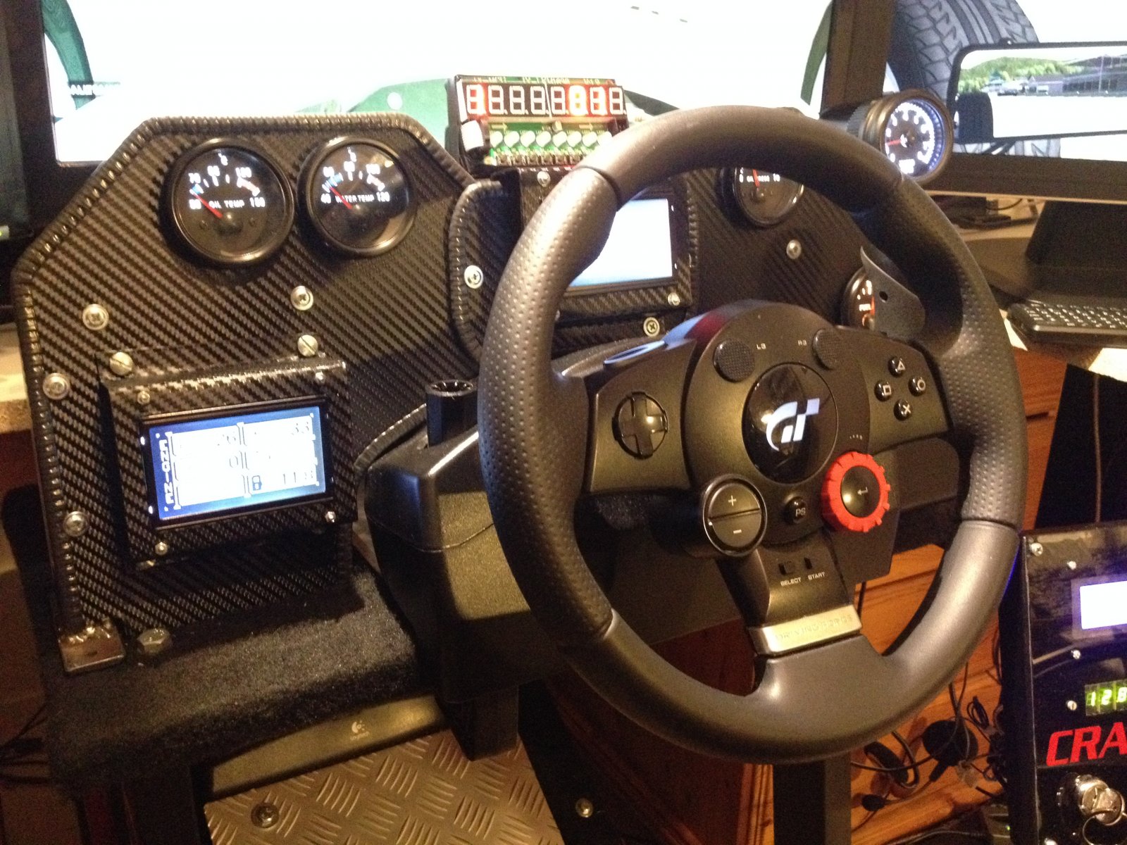

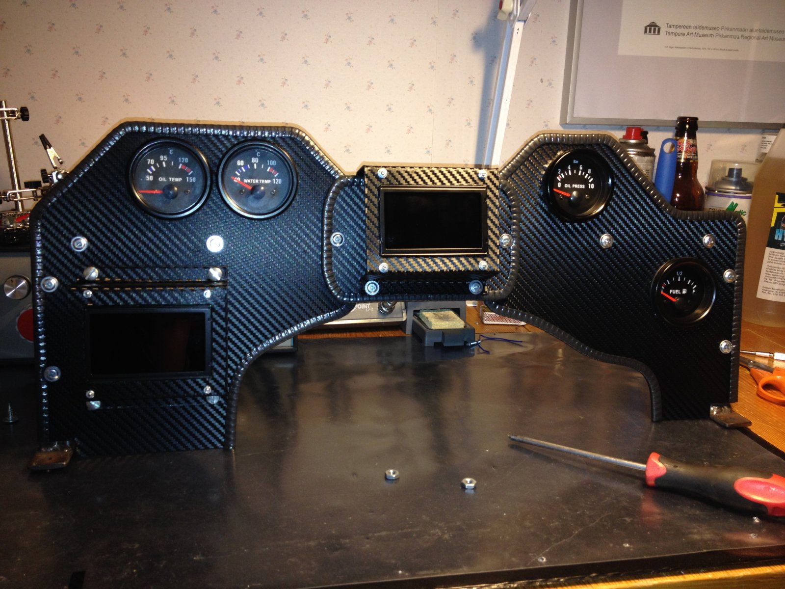

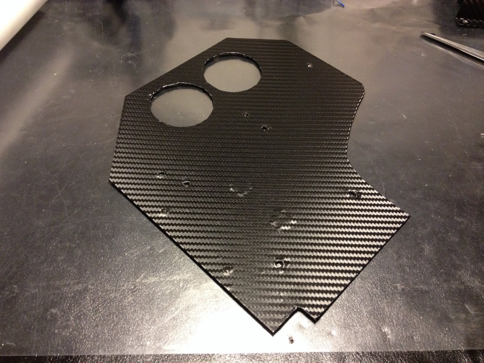

    Dash is almost ready. What is left to do is to cover tm1638 in a box and wire buttons to SimScreens. I'm very pleased with the end result with carbon fiber look alike, hard to capture it with the camera though :) Video coming soon.
    Edit. 13.11.14
    Added descriptions to pictures

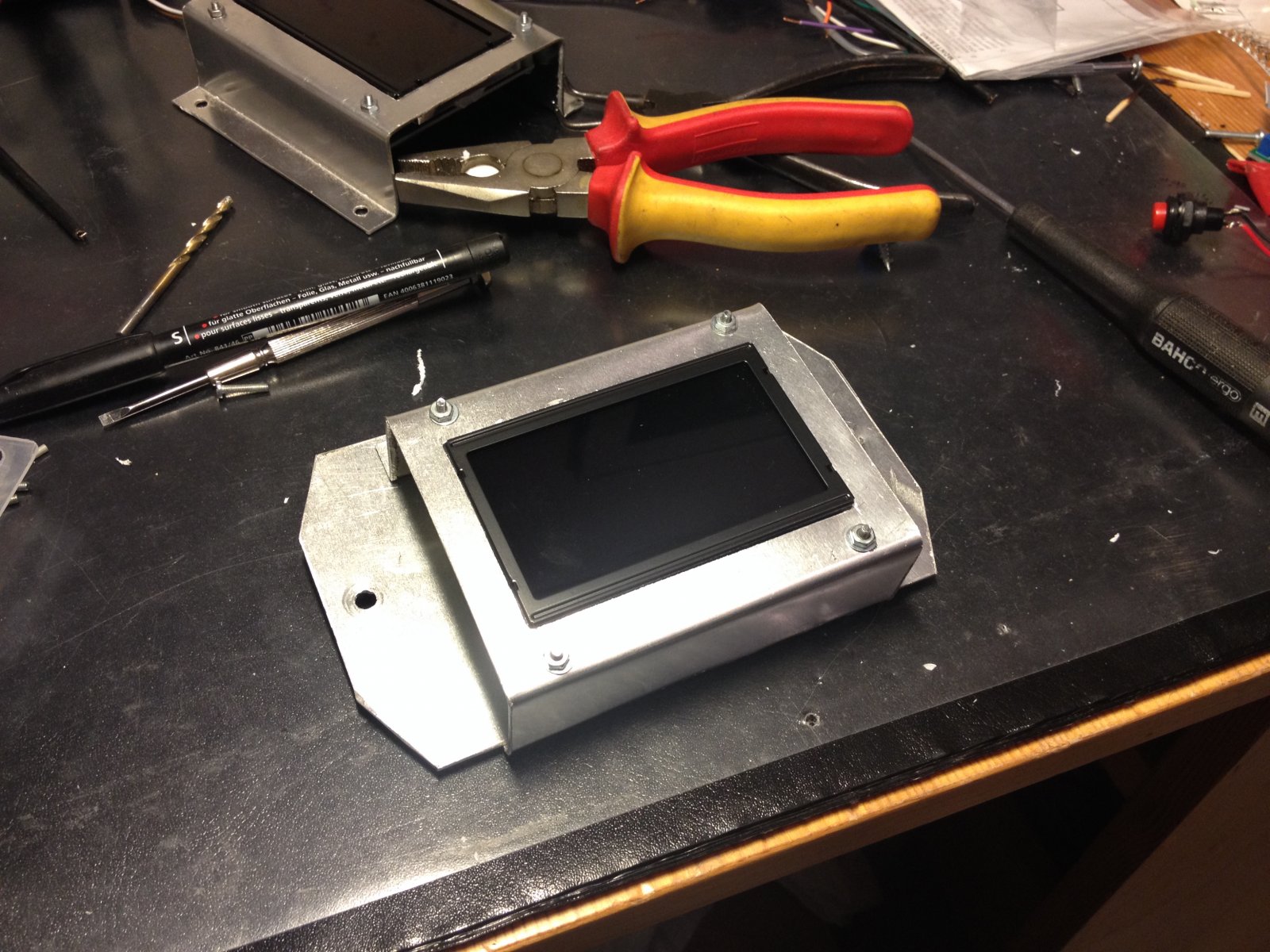

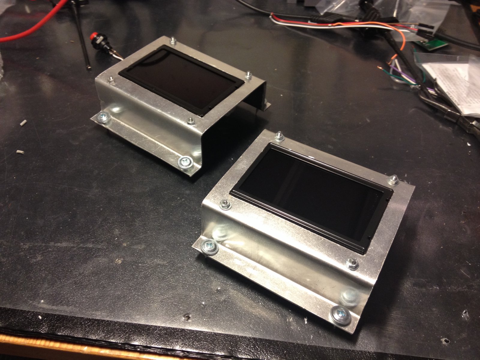

    Ok, making MFD supports. I used the same 0,7mm aluminium for these also and made square holes with the method described earlier post. This is so soft (good and bad thing, like said earlier, I suggest you to use atleast 1mm thick aluminium) that this can pretty easily be bent on a table edge and with some peaces of wood. Rubber hammer is a also a handy tool to make corrections etc.

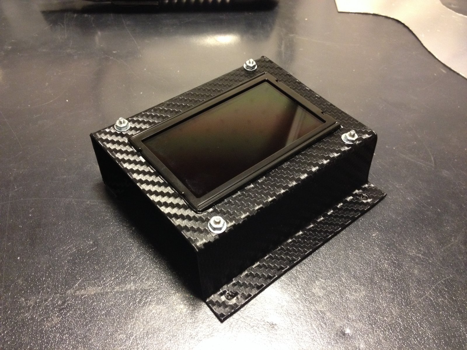

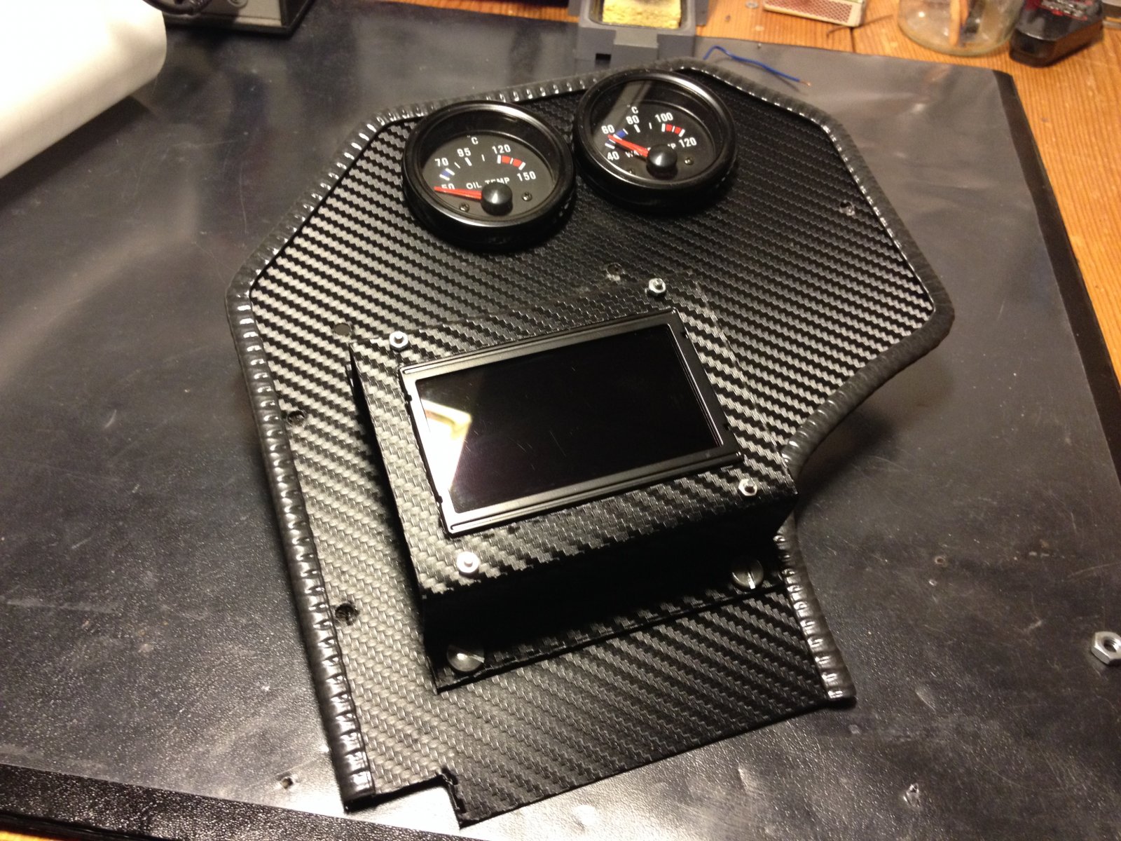

    Next part was actually the most enjoyable part in dash project: laying carbon fiber vinyl! When buying carbon fiber look-vinyl, make sure it is quality vinyl, not just a carbon fiber theme painted to a plastic, but proper 3d surface where different angles of light make the surface look different (Not sure is there other kind though, newbie talking here). I had never seen carbon fiber surface (fake or real) anywhere before this project, so when I saw this stuff at the store I was like whoo, this looks sooooo pretty! I'm sure real carbon fiber is not this cool looking :)
    Again, no pictures takeng during process, but it is very straight forward, just measure the area you want to cover with vinyl, add maybe 1cm extra vinyl to edges so you can flip vinyl over to back side of the panel. Make sure that every piece you cover is at the same angle when vinyl is aplied, so pattern matches with different parts. I mean if you have for example more than one panel side by side, it would look stupid if every piece has "fibers" in different angle.
    Don't wory about holes, just lay vinyl over them and pierce them afterwards. Here also leave 1 cm for flipping backside.
    I used "edge string" to finish edges of the panels. I'm not sure what it is called in english! It is rubber "seal" that locks to the edge of the metal sheet, without glue. There are different sizes and looks, with metal reinforcements and without. Somebody must know the english translation for this stuff :) It really looks good with fiber vinyl and even reinforces panels somewhat.
    IMG_1399.JPG IMG_1404.JPG IMG_1411.JPG IMG_1412.JPG IMG_1416.JPG IMG_1418.JPG

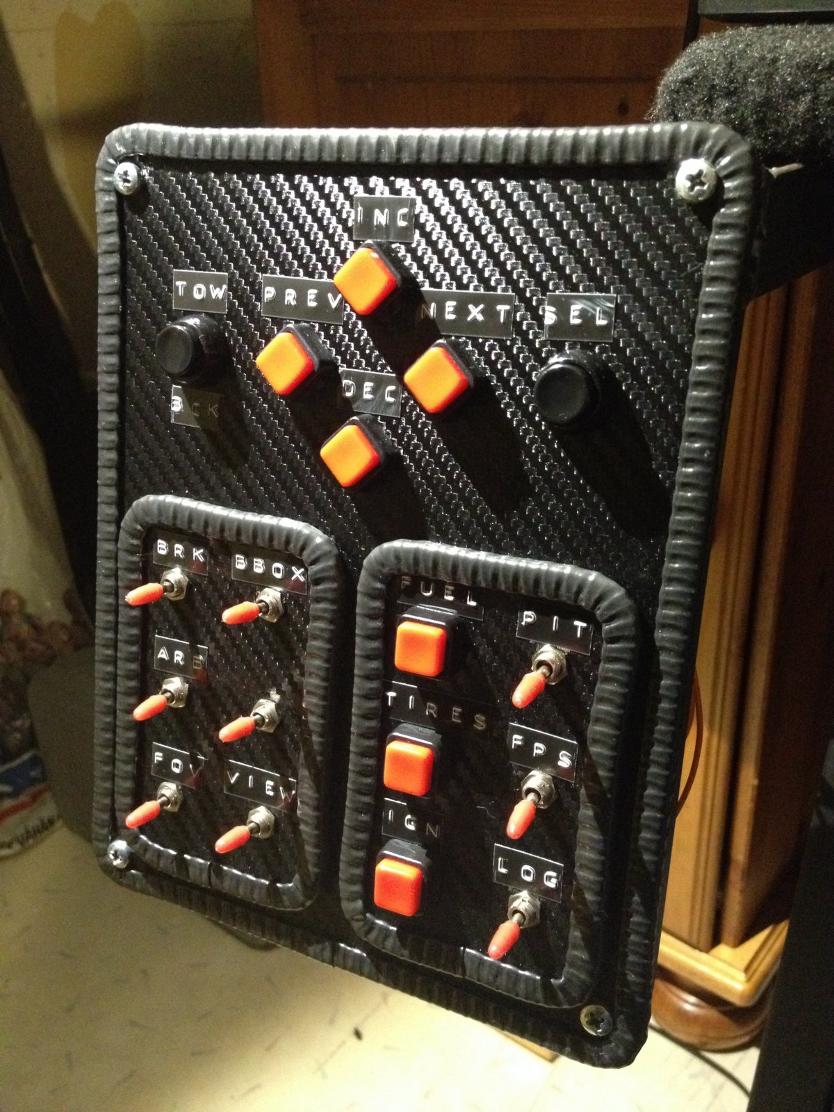

    Finished yesterday my buttonbox. It is using Symprojects jc-24 controller. For toggle switches to operate properly, I used free program called HIDMacros.
    Also designed multiple new custom screens for SimScreens. Maybe I finally am able to record some video also...

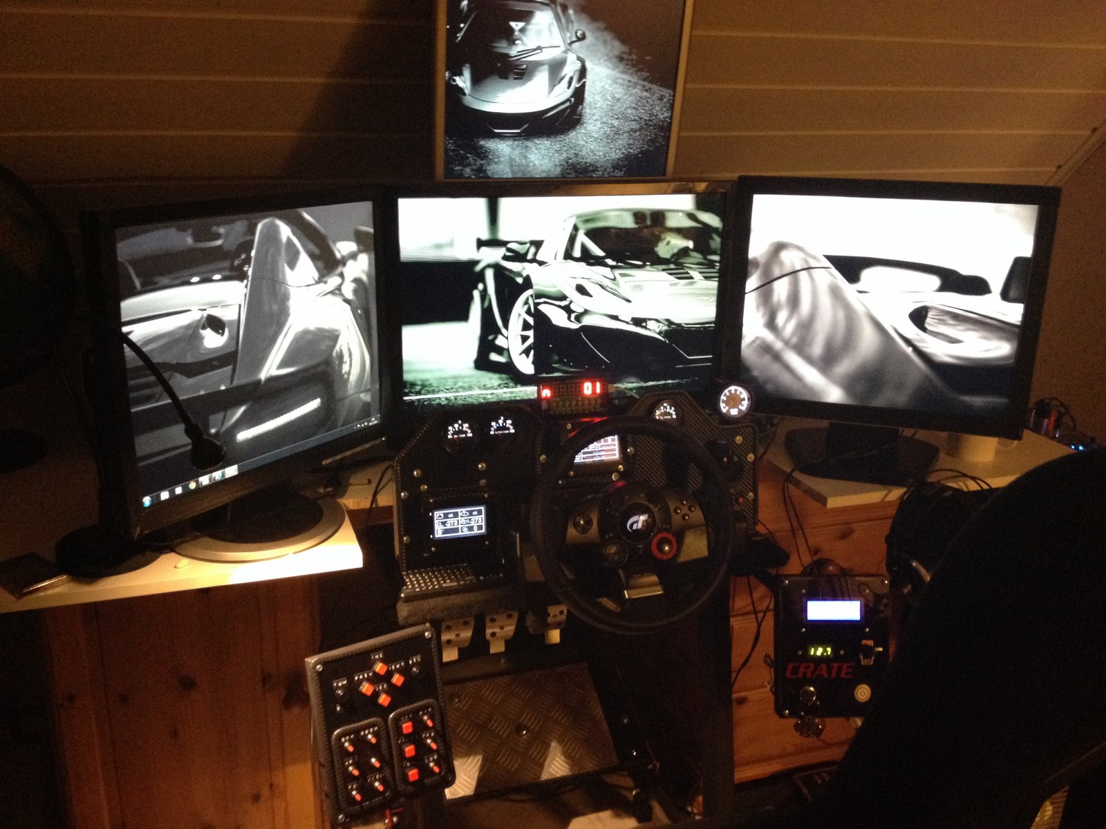

    Ok, finally I managed to record some sort of video of the dashboard in action. Here driving McLaren MP4 12C (iRacing), notice almost matching carbon fiber pattern with car graphics :)
    And @Lucian asked some footage of wiper motors in action:

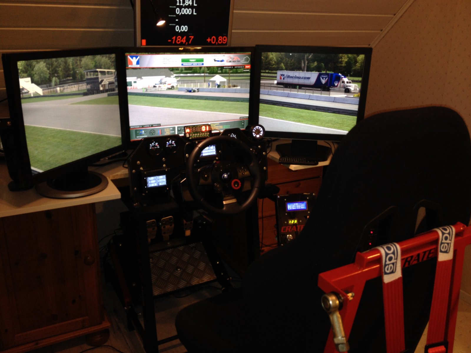

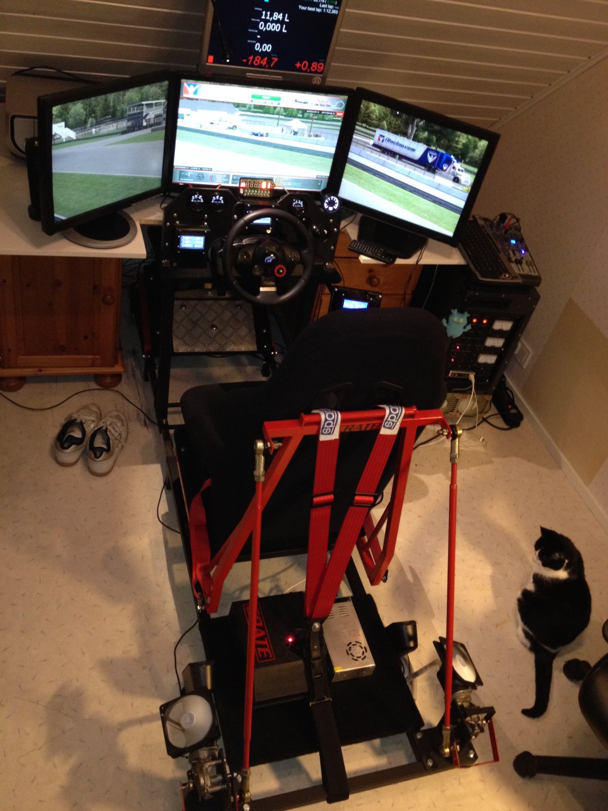

    I moved my rig in new place to save some space and now had a very good opportunity to shoot video straight behind the seat. So here it is, I drive at Watkins Glen a second or third time ever with Lotus 49, so driving is poor, but at the end there is quite spectacular crash :)
