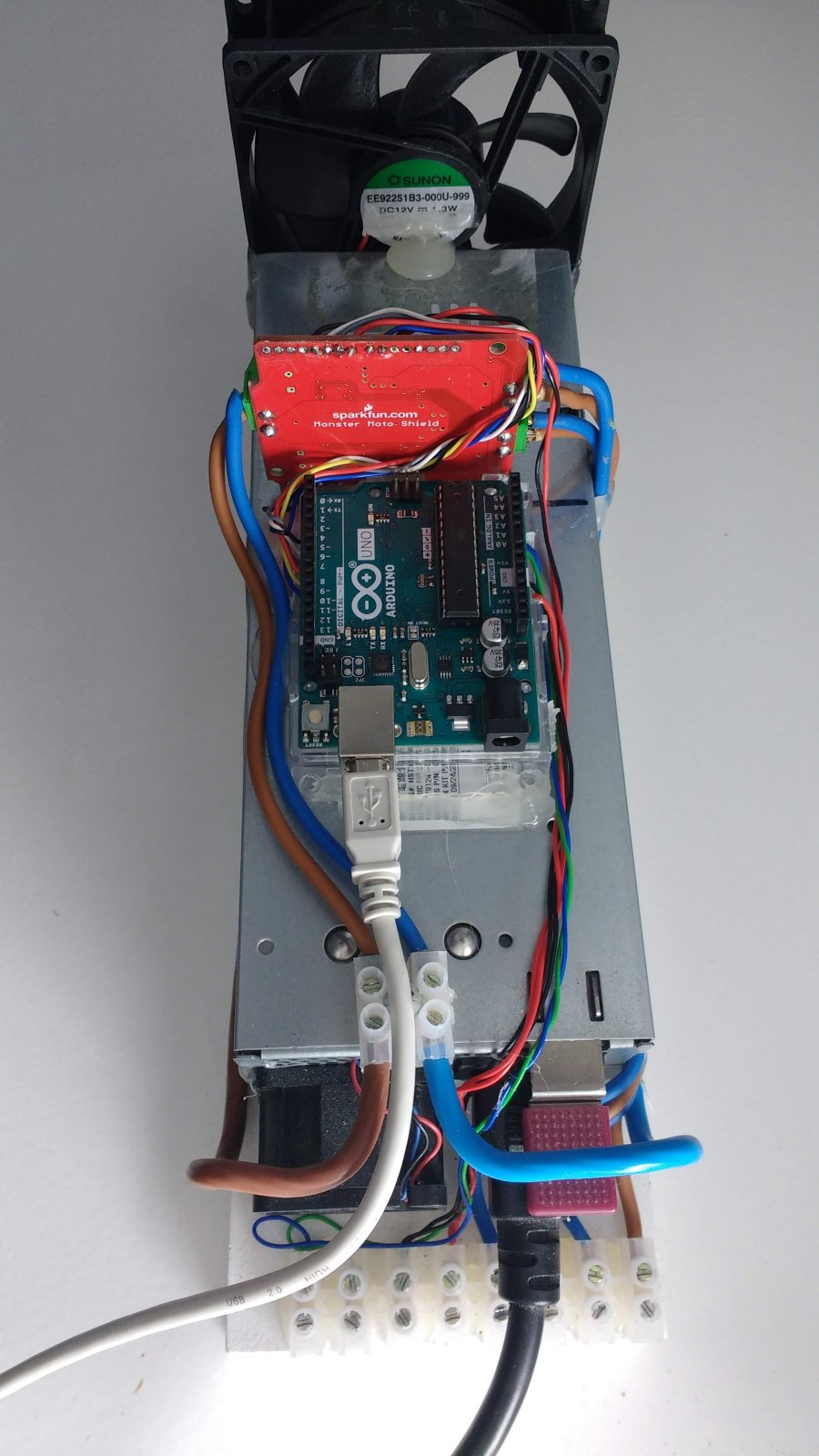

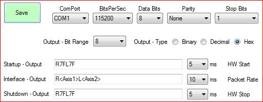

    i am not sure as i have never used this code but i think you are setting your interface wrong and must be like R<Axis1a>L<Axis2a> but as i said before have not used this code and i am not sure if this is the problem
    from here https://www.xsimulator.net/communit...-and-2-pins-direction-hbridge-motomonster.67/ photo is for simtools V1 so you need to add the a or b
  2. Brie69
    Brie69 Active Member
    Jul 1, 2018
    100
    Beverwijk
    2Coins
    +88 / 0 / -0
    Hi, @insanegr ! I've tried those Interface settings too but no luck...
    Do you use a Arduino Uno and if so can I try your code?
    Greets

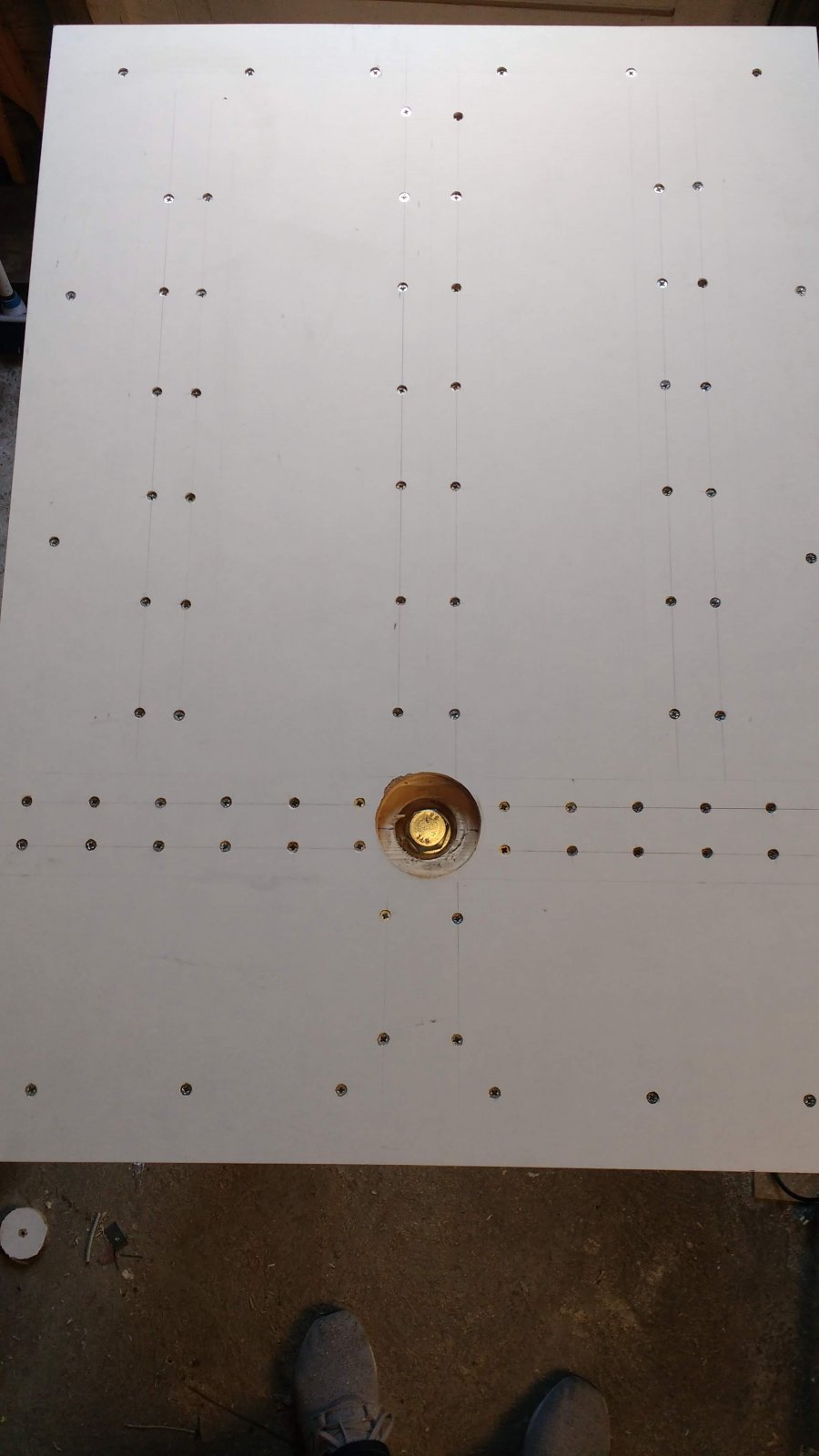

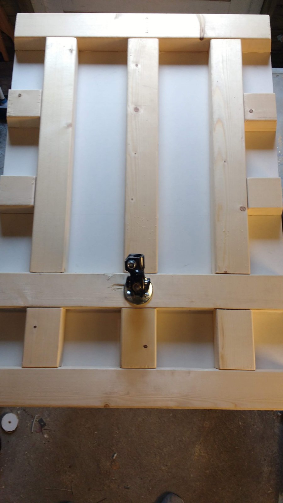

    In the meantime something else has been created in a small village in the Netherlands
  9. Brie69
    Jul 1, 2018
    100
    Beverwijk
    2Coins
    +88 / 0 / -0

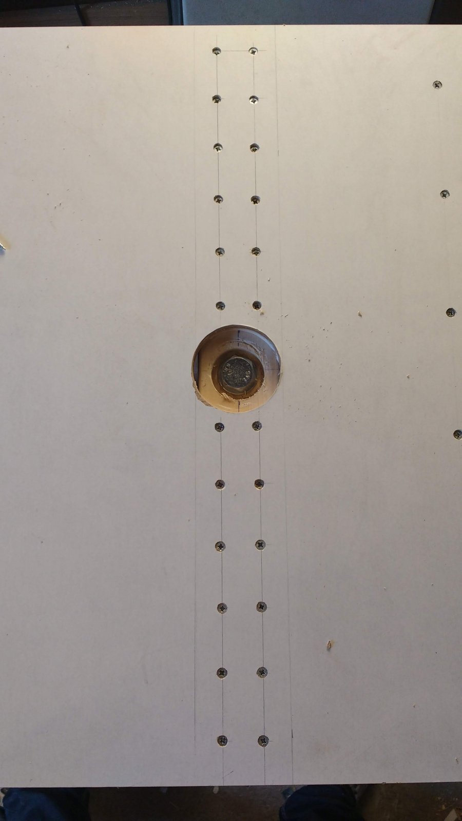

    Working on the baseplate... Screw it :grin

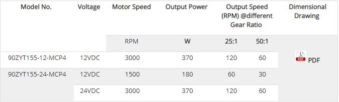

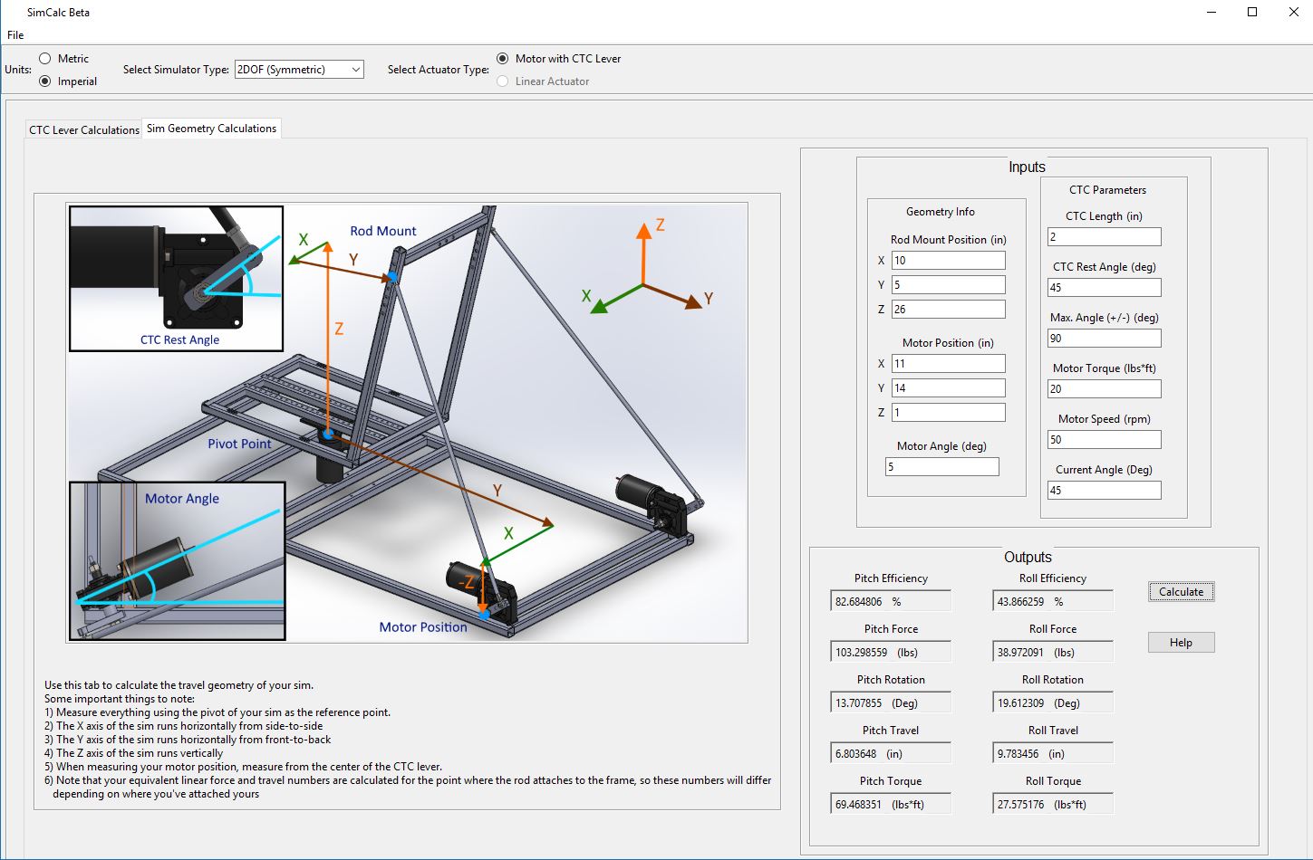

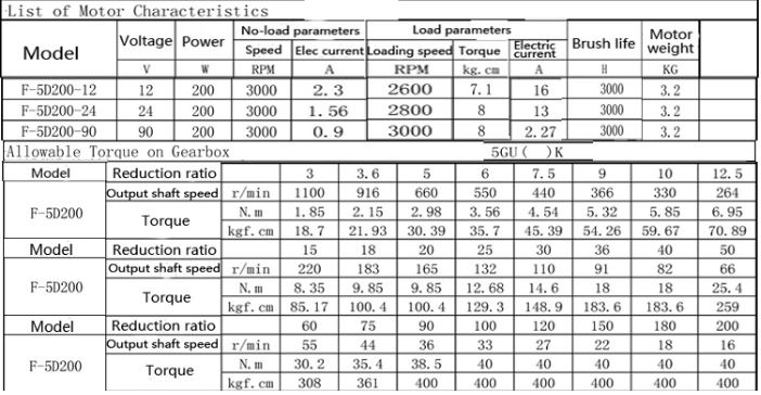

    Still searching for some motors and found some but I'm a little confused.
    Can someone help me with the right decision?
    When ordering I have to some pulldown menu's:
    Power, Voltage and Speed.. For power 300W?, Voltage 12V?, but then ?? Speed in rpm 10,20,30,50,100,200,300,400 and 600. Can somebody please help @yobuddy or @noorbeast maybe?
  13. yobuddy
    51,704Coins
    +5,204 / 19 / -0
    What do you need help with buddy?
    It looks like they are 200w motors.
    Chat soon,
    22,185
    154,750Coins
    +11,196 / 57 / -2
    Did you run the design and motor specs through SimCalc, as suggested?

    The engines that I have now have too little power. But when I look at the table, I really do not know which one to buy.
    cheers @yobuddy

  18. MarkusB
    Jun 30, 2015
    552
    4,215Coins
    +597 / 2 / -0
    If you don't mind using second hand gear, what about wheelchair motors? I did not check for the Netherlands, but at least in Germany you find them on ebay:
    https://www.ebay.de/itm/Rollstuhl-A...rentrq:cdfd464b1660ab45564916b1ffff7410|iid:1
    I also have a really heavy wooden rig (the moving part has a weight of more than 40kg), and the wheelchair motors don't seem to have any problem with this load.
    And since they are about half the price as the motors in your link, you can spend the saved money for replacing your Monster Moto controller with a Sabertooth. :)

  20. Brie69
    Jul 1, 2018
    100
    Beverwijk
    2Coins
    +88 / 0 / -0
    These 24V engines are certainly interesting. Could I also connect this to my MM without having to change it for a Sabertooth?
    My power supply is 1x HP ATSN-7001044-y000 Rev: M (12V-69.5A + -) and not 24V.
    p.s No wheelchair engines to be found in the Netherlands
