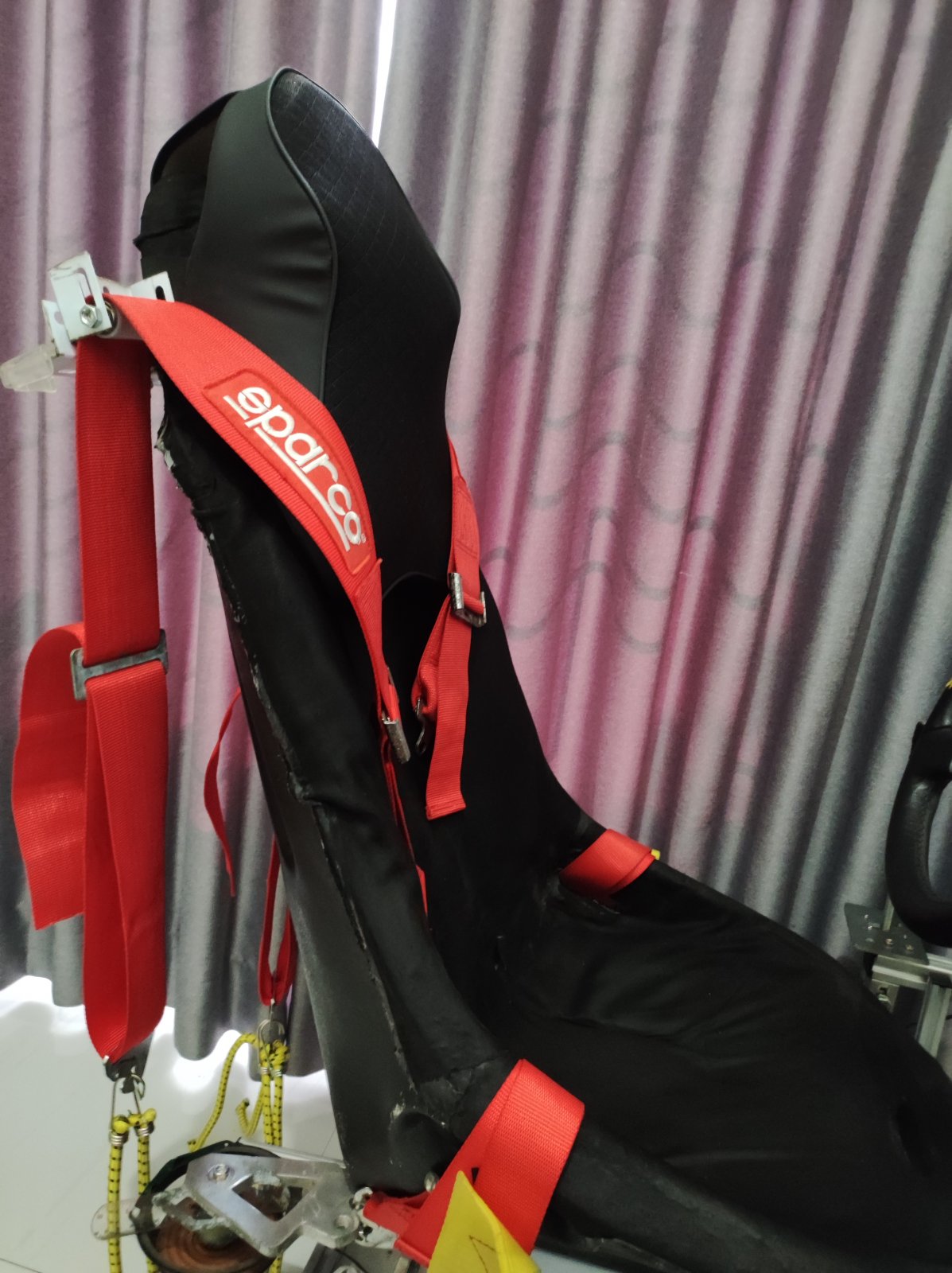

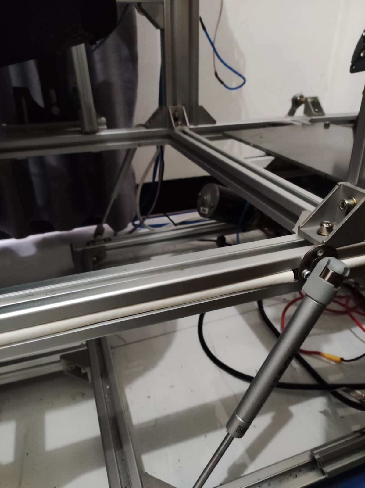

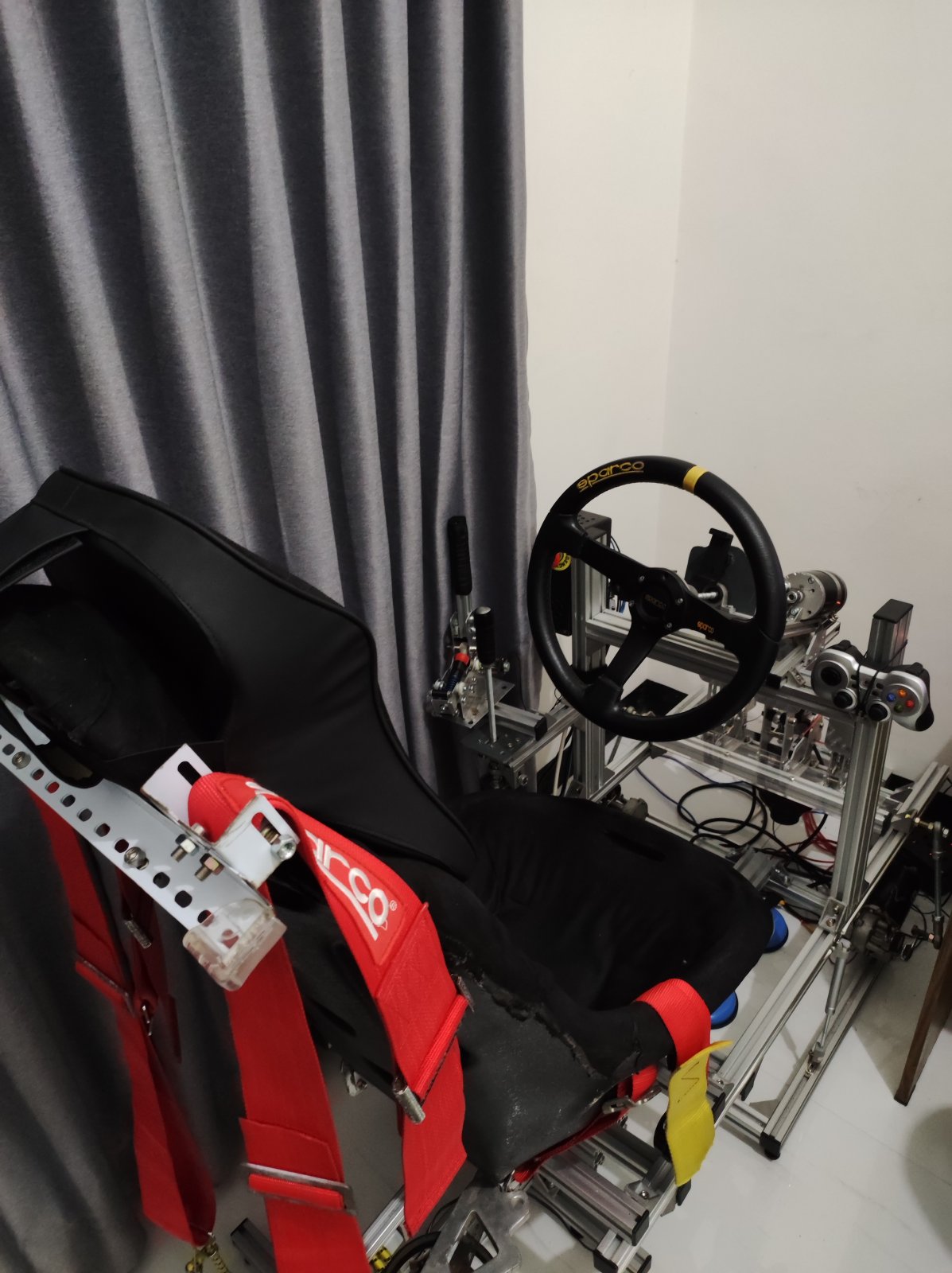

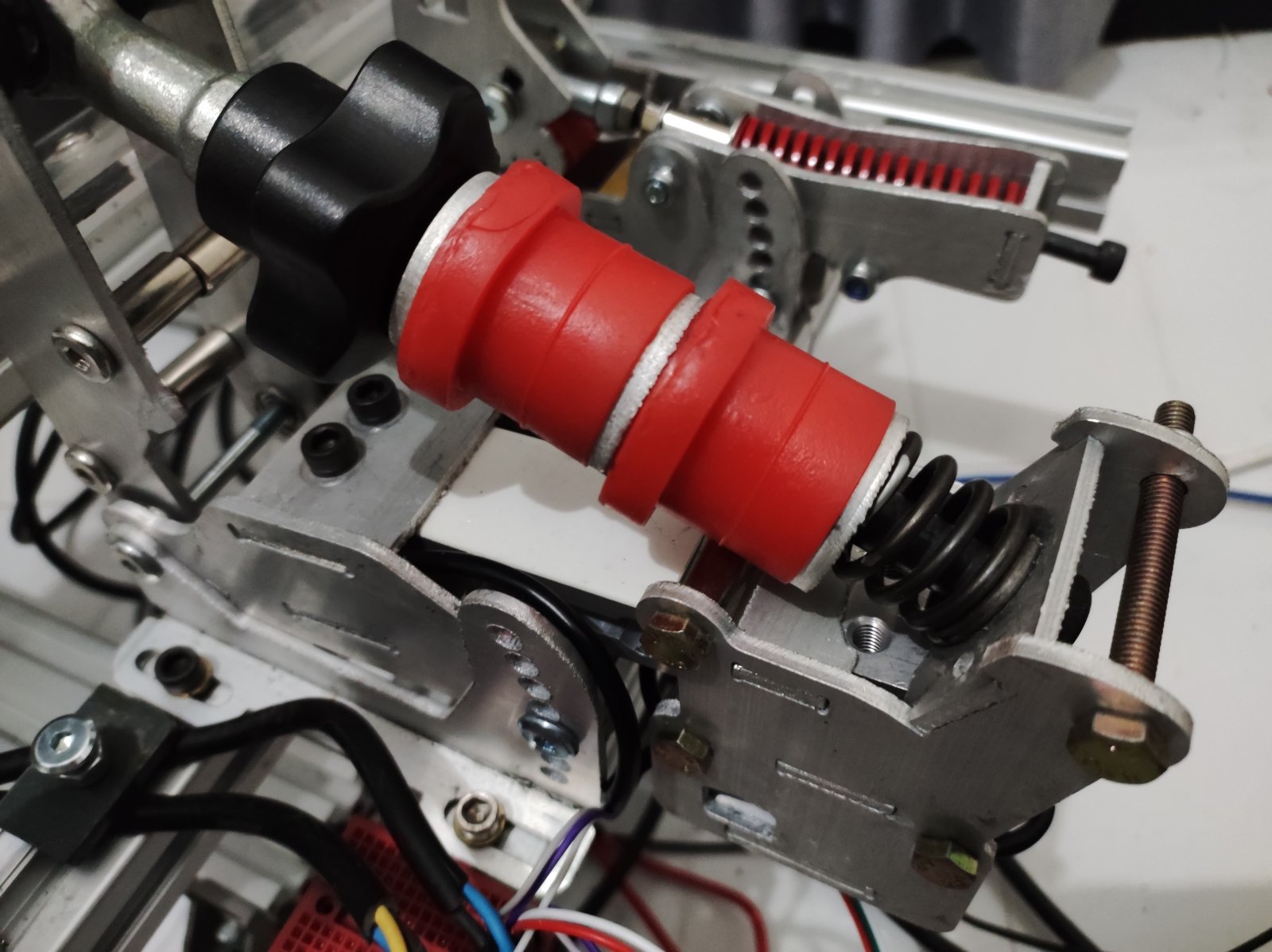

    Another update, add some damper and belt mechanisms inspired by @Captain Jack.

    Great simulator rig.:thumbs
    Can you tell me what type of dampers you are using (brand , force).
    or maybe have a link.

    yes 2 x 100N is enough for my rig to stay straight when the power is off.
    and give a little smoothing on the motion.

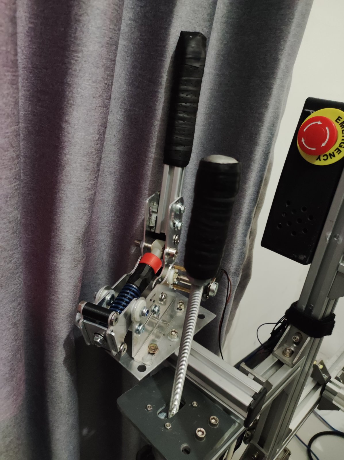

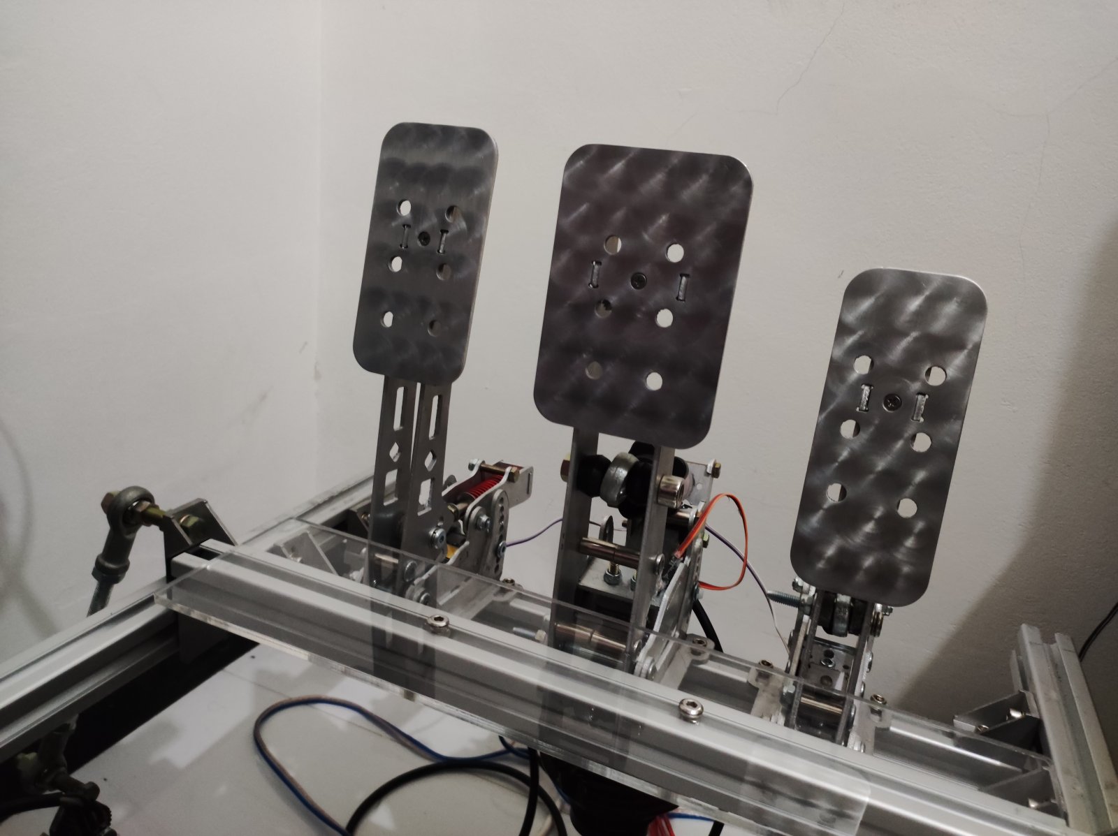

    Got an upgrade, I switch the DIY pedal and handbrake from pvc, to almunium material.
    Feeling great, because right now I do some hardcore playing with my rig IMG_20220418_231712.jpg

    A little update on my setup. with damper added before, I realize the motor is get strained faster. even thought its more smooth, I don't think it's a good idea to keep the damper on my setup. so I decide it's better to take it off.

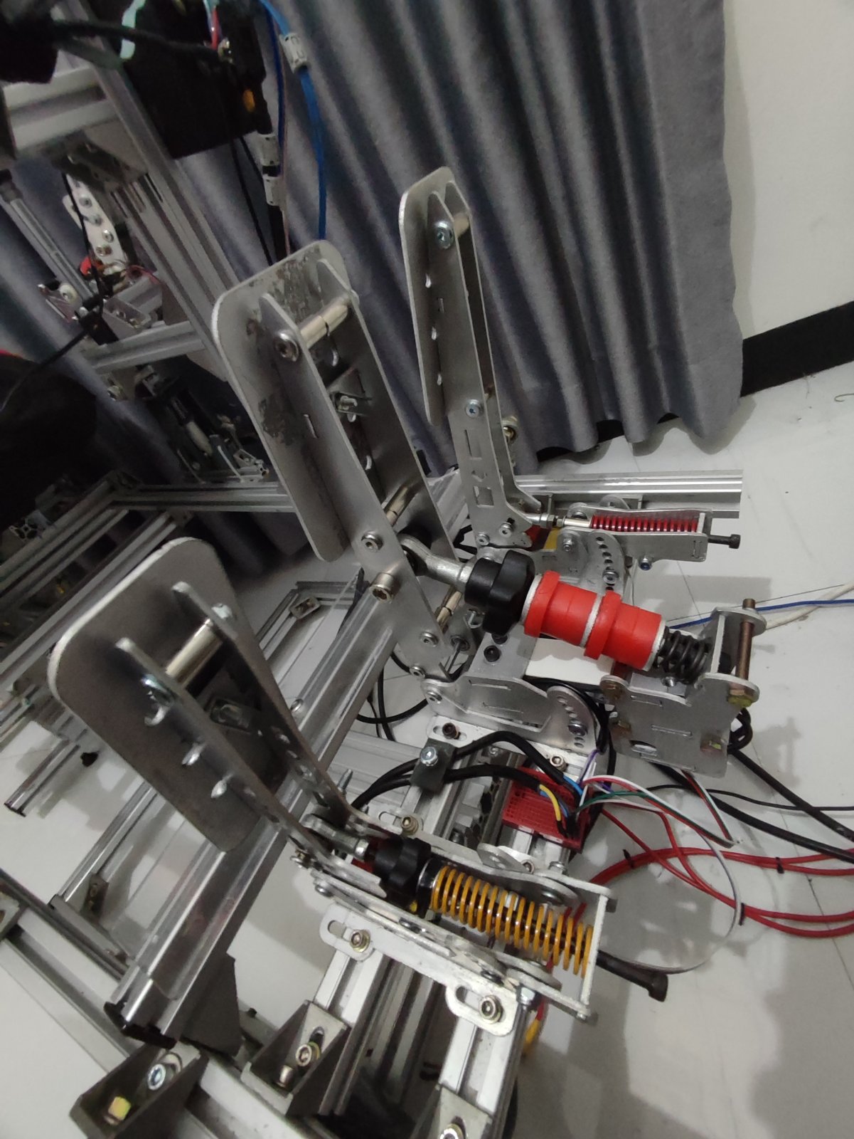

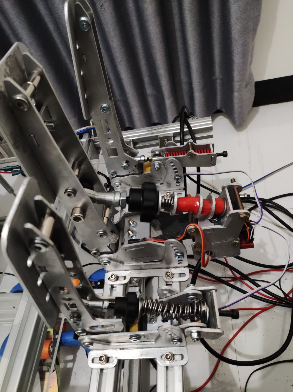

    Little update on my rig. Upgrade my pedal using 100kg loadcell on my break, and hall effect on gas and clutch.
    Pretty satisfied with the result.
    So reliable and no noise so far.
    For the motion, I really want to add a TL, but right now its enough for me. Wish I could upgrade to sfx150 platform.
