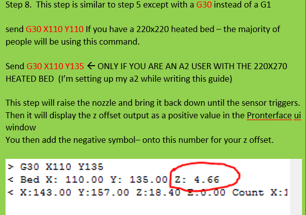

    Connect your A8 to your pc via USB and have Cura 15 running
    Start the Arduino IDE that comes in the Skynet zip file. Don't use the one on your pc if you have already installed it.
    Chose the configuration.h file you are going to use and copy into the main skynet folder
    Make sure the IDE detects your printer connected to a COM port
    Load a test cube .STL (not really necessary but ensures Cura is working correctly. You can get one from Thingiverse)
    Click Print from the Cura menu (this brings up the command window and the circular image to control the XYZ axis)
    These are the steps in summary but explained in detail in the Skynet documentation (case sensitive):
    Heat your printer up to your printing temperature and allow a few minutes for it to expand and settle
    Reset the existing Z-offset to zero: M851 Z0
    Home all axes: G28
    Move the nozzle to the middle: G1 X110 Y110
    Move the nozzle down so it is just gripping a piece of standard printer paper (use the circular interface on Cura)
    Mark this position as Z zero: G92 Z0
    Use the sensor to probe the middle of the bed (where we just set Z0): G30 X110 Y110
    Take the Z value of the bed from the screen and put a minus sign in front; this is the Z-offset. e.g. 1.23 becomes -1.23
    Set the Z-offset: M851 Z-1.23
    Store it to the EEPROM: M500
    As you can see once you have the IDE, Cura and the A8 are running/connected you can whiz through these steps in a few minutes if it doesn't quite turn out as you like. Uploading the skynet sketch to the Anet Arduino board takes about a minute. Tip: when I issued each command above in red, I had a finger on the power supply off button - just in case you screw something up and the hotend hits the bed.

    Then just follow what @SixDegreesOfFlight put. My process was:
    Send M500 to store new value
    Home all axes: G28 <--- Test your Senor before you do this with M119 - This will show you the "switch" states
    You want all to be "open" when they are, ..well... open and TRIGGERED when closed.
    Use the sensor to probe the middle of the bed (where we just set Z0): G30 X110 Y110 (NOTE THE G30, not G1)
    My offest was 0.57
    Set the Z-offset: M851 Z-0.57
    Ensure you add G29 into your Start Script AFTER the G28. Running a G28 will reset any bed level matrix configured by G29.
    Let G29 do it's thing (3x3 matrix) so nine probe points, and enjoy nice - level - prints!

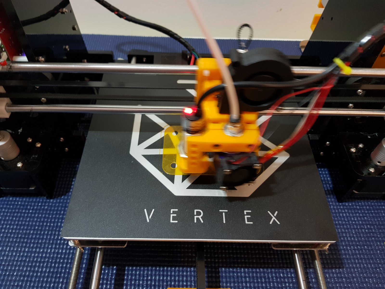

    Rather than start a new thread I thought I would write a short post on how the Vertex bed mat worked out. The mat is a replacement for the tape or glass that you use on the printer bed to make the parts stick. It is slightly bigger in one dimension than the Anet A8 bed so when you fit it a small strip needs to be cut off using a razor blade. The mat is adhesive on one side (peel off waxed paper) and on the top surface the plastic is slightly textured (think plastic shower screen). It is about the thickness of heavily weighted paper but not as thick as light cardboard. It cost $37 posted to Australia (from the UK). That was the cheapest I could find. Unlike glass which will last indefinitely, the Vertex mat has a limited life and will need to be replaced depending on how much printing you do. That is, you will eventually put a scraper through it.
    Fitting it only takes a minute. I cleaned the bed surface firstly with eucalyptus oil to remove the sticky residue left by the masking tape I was using. I then used glass cleaner to remove the oil, and finally Methylated spirits to give it a final clean. I peeled off the backing paper and started on the left hand side of the bed gradually working my way to the right, smoothing out any air bubbles as I went. I used a razor blade to trim off the 20mm strip on the right hand side.
    I run my PLA settings as 60C on the bed and 210C at the hot-end. I printed my first part a small plate for my linear actuator. Hmm - it was very very hard to remove it. I didn't want to rip a hole in the new mat so it took nearly 5 minutes of working my around the outside before I get the scraper underneath and remove the print. The second part I printed with the bed not heated at all and that was great. The printed part was still very firmly stuck but it only took around 10 seconds to get it off. I did not see any warping at the corners which is what I was getting when I printed on glass. It works great with my auto bed leveling sensor too!
    I also fixed the strange pause that seemed to start when I added my Bowden setup. Basically, the print would pause at some random point during the print and wait for a button press on the panel. Actually it wasn't random it was when the print got to 5mm high. So for low profile parts it never happened. Once I pressed the front panel button it would proceed to finish. What was causing this wait? Without boring you with my fault finding adventures, it comes from two plugins supplied with Cura 15 - 'Pause at height' & 'TweakAtZ'. I simply moved them from the Cura plugins directory to the desktop and restarted Cura. Problem fixed.
    Edit: The official name of the mat is: Velleman Buildtak 3D Print Bed Surface for K8400
    Edit2: I found that you still need to keep the mat clean of finger prints by using alcohol - I use methylated spirits - not sure what it is called in other parts of the world but it is nearly 100% alcohol with some additive to prevent it being consumed. The other thing I noticed is that for parts with very low surface area in contact with the bed you should heat the bed to help with adhesion otherwise the parts tend to come off. For larger parts leave the bed unheated.

    so, what about the vertex, does it worth what it cost, what do you think?
