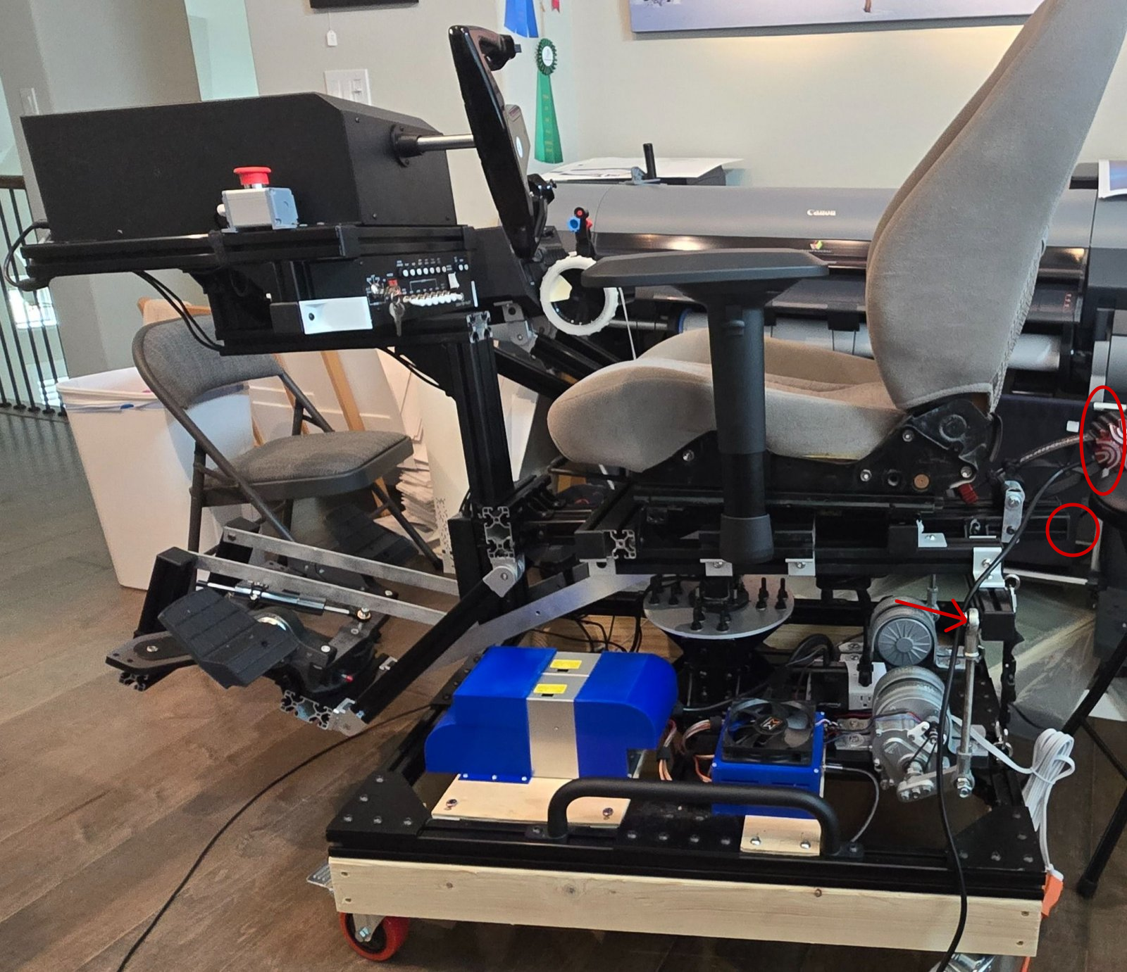

    Shortened the levers to 45mm and it's still quite rough. I can feel each single gear, if that's in fact what it is. I think I'll try to come up with some sort of dampener.

    I've disconnected the linkage and pot belt and let it spin at the slowest setting I could get it to go by adjusting the pot with my fingers and it felt smooth, but it was still quite a bit faster than what the flight sim would achieve in a gentle climb.
    If I was a good programmer (which I am not), I could modify the smc3 code to send a constant low pwm signal to have the motor turn at a very slow speed. That could be very informative. Any idea how I would do that? I have experience with python, but just basic stuff.

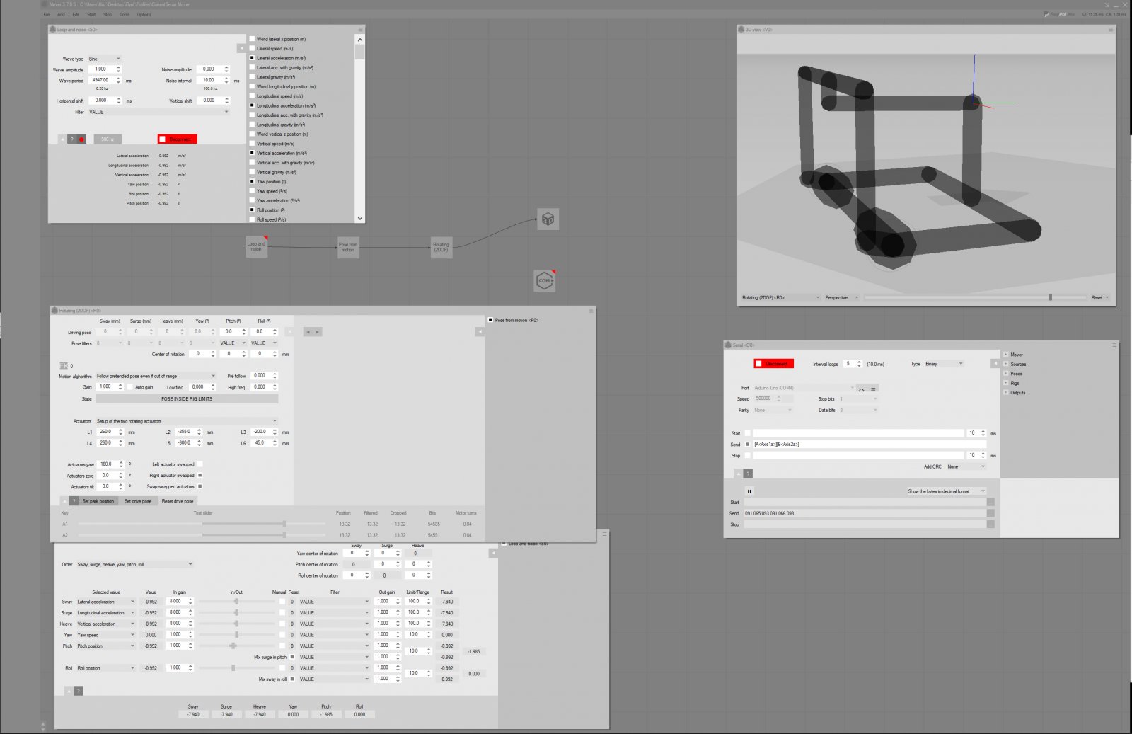

    IMHO I don't think what you're seeing is cogging. The movements look too rough. In my case the levers move smoothly I can't see any visible jerkiness. What I did feel was a series if micro-accelerations and decelerations, which I couldn't even feel in a not-sterile environment (in MSFS flight), not sop-and-goes as your video shows. that would be impossible to ignore.
    I also think that there is plenty of power with those motors, especially for a 2DOF.
    I see from your topic that you're struggling to get a slow movement for testing. It's easy with FlyPT Mover: just add a source of type "Loop" and choose Sine wave type, then just assign it to roll or pitch and you can control the speed and amplitude as you want. You can make it really slow.
    One other thought is IBT2s are notoriously unreliable with 24V, that's the reason I'm not using them in my 6DOF (I used them in 2DOF with 12V PGSAW motors just fine). It's possible that the issue has something to do with IBT2s as well. Many people operate IBT2s around 19V because of their tendency to burn out at 24v. If you're doing that, the motor may not have enough power to move properly.
    Also, your SMC3 calibration may be wrong. In theory, it can behave this way if it tries to move the motor too weakly and increases the PWM in steps until the motor finally moves to the desired angle...

    I suggest you start with a sine wave in FlyPT Mover, and completely unload the motor - disconnect the arm. See what the motion is like. If it's smooth, the issue is definitely not cogging.

    Thanks so much Ronan, I wasn't aware of that function in Flypt. I couldn't find ANY documentation on how to set it up however, other than the video that was posted previously here. I guess I need to start there.

    I'm making some progress, discovered 3d view and tool tips so I could actually create the rig. I've got a sine wave going to the 3d view of the rig, but I don't know how to connect the rig to the serial output? The serial output seems to be connected to the ard, but not sure.

    Ok, after much effort, I got flypt going and sent a slow sine to the motors without a load. Here's the video. I tried Kp from 150 to 300. I tried adjusting PWMmin from 0 to 40. I tried Fpwm from 15 to 30. Nothing made a significant change.

    Just an update. The new motors are brushless and way too low power anyway, so that won't work. I'll be sending them back. I'd really like to find a way to get these motors I have to work so I don't have to dump much more money into this project. I took them off the chair and cut all the wiring as I was expecting to replace them. I shortened one of the 4080 base pieces to reconfigure for the new motors. It'd be a pain to replace that piece if I end up putting these motors back on. Anyway...
    I took one of the motor gear boxes apart and cleaned out the excess grease. I don't see any damage or wearing. It all feels pretty smooth except for the minor cog vibrations. I also tried to assess the gear ratio and found that it is somewhere around 50:1 instead of the 5:1 that I thought it was. Which makes me wonder if a different 50:1 motor would behave differently.
    I hooked it back up and see no difference. There is a lot of low amplitude noise from the sensor but I just have the wires twisted together. When I pinch them tight, it improves. Unplugged in the PSU's does not change the noise.
    I know I could dump a bunch of money and build a couple of the DIY actuators for smooth motion, but I'm getting some heat from the wife already, and I don't really feel like rebuilding yet again. I want to fly, but I can't fly it like this.
    I have even been looking up using a cog and linear rail system which would definitely smooth it out, but those linear track blocks are expensive themselves for the larger ones. Or I could put an additional gear box on it to cut it in half or something. I feel like I've been researching for days and keep hitting dead ends.

    May I offer some possible areas for consideration, based on having an interest in and having built a compact design rig, long before some of the current options were available: https://www.xsimulator.net/community/threads/dx-compact-simulator.5866/
    First, some design related observations.
    The further away the pivot point is from the base of the seat the greater the strain on the motors, plus it introduces weird geometry: https://www.xsimulator.net/community/faq/universal-joint-placement.108/
    In a compact design maximizing the inherent design leverage withing the parameters of the chosen footprint will reduce the load on the motors. Your motor placement and upper arm connection do not do that, and it looks like around 200-400mm of inherent design leverage improvement could be made, without changing the fundamental footprint of your design choice.
    In addition, the upper heim joint should be rotated 90 degrees to reduce the chance of binding:
    On a compact rig, particularly a full frame design, it is particularly important to ensure it is properly balanced, with you and all peripherals on board: https://www.xsimulator.net/communit...-of-gravity-to-balance-a-motion-simulator.55/
    The longer the levers used the greater and more pronounced any inadequate effects, be they hardware or software related.
    With respect to hardware, IBT2s are cheap but known to be of variable and sometimes poor quality. There are other DC options, this just being one on the more budget end of the scale: https://www.xsimulator.net/community/faq/reasonably-priced-100a-motor-controllers.412/
    If you are considering swapping out hardware, motors and controllers, the modern option is to skip DC and go to the likes of the AMC-AASD15A servo motor and controller: https://www.xsimulator.net/community/faq/amc-aasd15a-servo-controller.351/
    On the software side, if you stick to DC the controls software, such as SMC3, needs to be fully dialed in and control things like overshoot, before messing with motion software:
    In addition, on the motion software side (SimTools/FlyPT), do be aware how it works, and what settings do. For example, with SimTools in the Tuning Center the larger the value the smoother the output, over a greater range of the allocated axis. For a flight sim yours look way too low, I would expect values likely in the 50-100 range for primary axis allocations:
    I hope these comments don't discourage you, but rather give some insight into areas you may want to reconsider, be they design choices, hardware used, or configuration.
