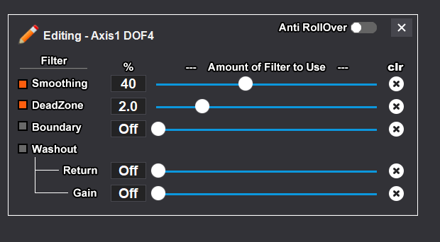

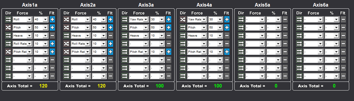

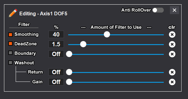

    Reading through you entire I thread I have learned you are 1000x smarter than I will ever be, that being said. I have been spending countless hours dialing in smooth movement on my platform for helicopters. Pretty much GA with all the wobble in the world depending on airframe.
    Going back to your post from Feb 25', you tried 100% smoothing, one thing I noticed with simtools "Filter smoothing" for super small inputs and movement... "smoothing" seems to add that stepping feeling, slower movements with more smoothing = less smoothness (for me) Maybe it's my platform, but what I found best for me was this combo. Pitch & Roll + Pitch Rate and Roll Rate as seen in my photos. The Pitch and Roll has a slow washout, and zero smoothing with the most "DEGREE" of movement, while the "RATES" added a quick response with minimal smoothing at 40%, but because their movement was 10% at most vs pitch rate and roll, with an added dead zone, the initial movement would line up with the aircrafts movement and then respond at once with the "rate" and fall into "degree" for pitch and roll. I then movement my intensity down from 100% to 50% and increased the sensitivity in the m/ax/min for those rates and degrees. The movement are seemingly one to one with what I see and feel to the sim. It's now smooth as all hell too. If this helps in anyway then I great. If this is useless to you then disregard and carry on. Good luck.

    Thanks! I'm actually pretty sure I'm one of the below-average-intelligence people here as I unfortunately don't know enough about electronics. In fact, I'm having major issues with this new setup and just burned up both power supplies somehow. But that's for another help thread I need to start after I get done writing this.
    Anyway, thanks for the idea. However, the smoothness problem lies outside of simtools and persists regardless of settings. I can recreate it in Flypt mover using a very slow and shallow sine wave, unlike the uncontrollable wave of SMC3. And it's logical too, these motors are not designed to move at 1 rpm, or even less, and only a degree or two, perhaps less, which is what the typical GA flight would consist of during straight and level. Fortunately, I think this new design will solve this as the motor is going to be spinning faster and further for those small, shallow movements.
