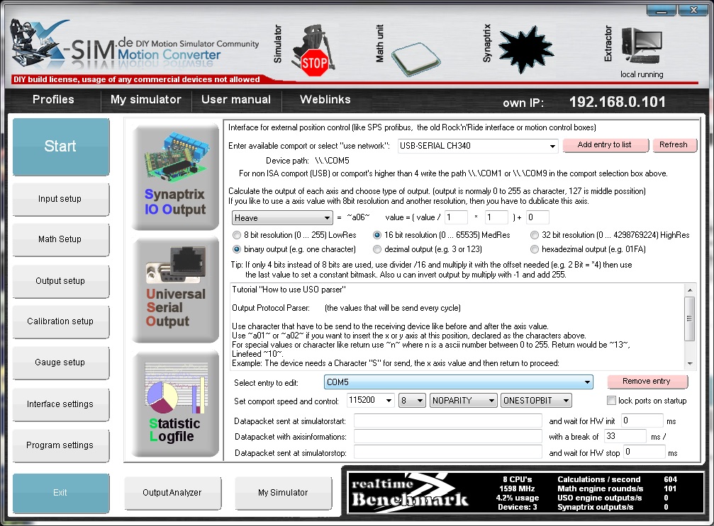

    This is my USO settings. I do not know what datapacket where I enter, but the platform with 6 servos works well.

    That's about half the information needed, the important ones are totally blank ie the datapacket statements.
    So it receiving a 16bit number on a 8bit output, lol.
    Ok for SimTools with the information provided so far the interface setting needs to be
    ComPort - the port its connected too - COM5
    BitsPerSec - 115200
    Data Bits - 8
    Parity - None
    Stop Bits - 1
    Output - Bit Range - 16
    Output - Type - Binary
    Startup Output - nothing provided ?
    Interface - Output - nothing provided ?
    Shutdown - Output - nothing provided ?
    Axis Assignments well you need to set 6 axis for 6DOF. Plenty of info on site for them.

    So we still need to know: Startup Output, Interface - Output, Shutdown - Output Am I right?

    Yes I know, my mistake, I had it set to another comport. (on Arduino)
