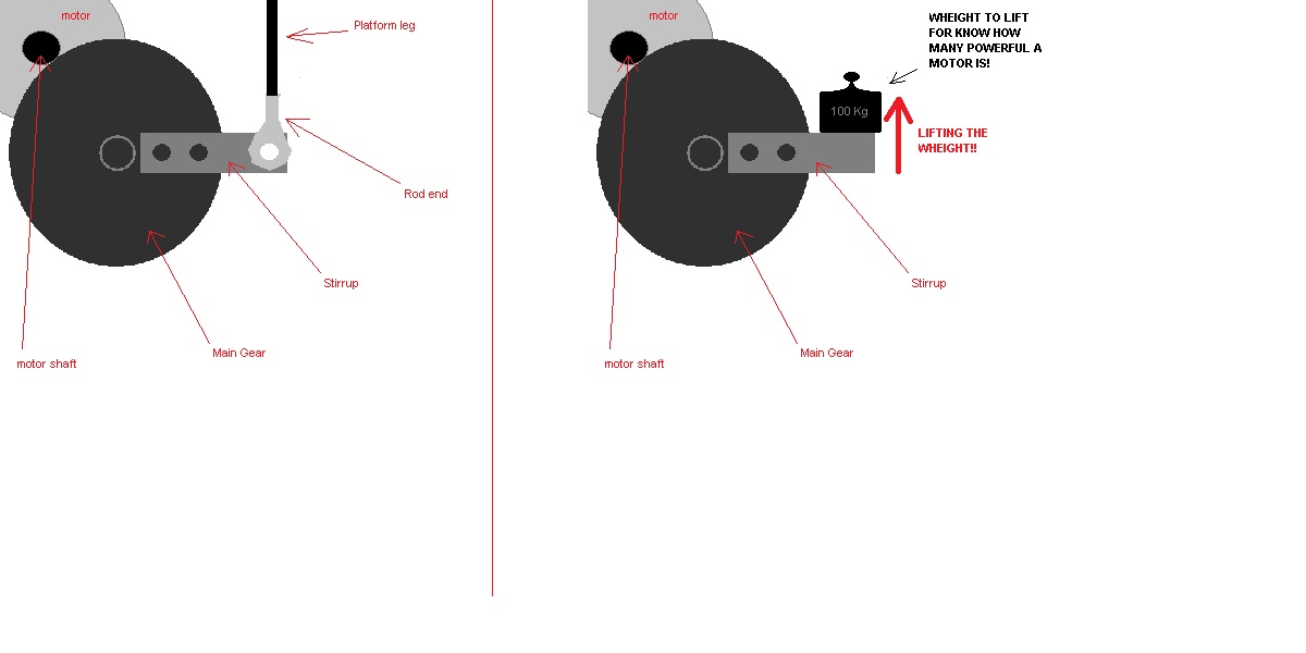

  9. AldoZ
    AldoZ Member
    Aug 26, 2010
    286
    Pc Shop
    366Coins
    +6 / 1 / -0
    Good thread here dudes! :cheers:
    @bsft: mmm I am really curious about the power of this motor!
    From my neglicence about motors specs, so I can use a very primitive but good example to understand the power of a motor :
    To look how many wheight a stirrup mounted in a motor can lift.
    Please look at the attached pic.
    The winch with 22.5 Amps can lift so and so 80kg with no particular problems.
    So, if you use this example to make me understand the power of your motor then how many wheight your motor can lift?

    It depends how long the lever is.
    The specs aren't clear on this, but if the motor/gearbox produces a torque of 20 Nm at 16 A, then it has a kt of 1,25 Nm/A. With a 10 cm long lever on the shaft it will then lift 1,27 kg per A max, or 38,26 kg at 30 A.

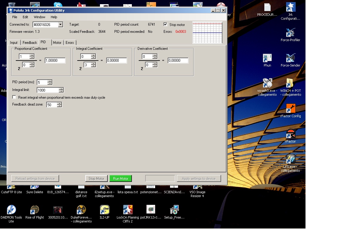

  16. AldoZ
    AldoZ Member
    Aug 26, 2010
    286
    Pc Shop
    366Coins
    +6 / 1 / -0
    The PID it's a really hard matter mate! :( Please refer here if you find some good PID trick! here my jrk PID configuration:
    PS: warning dudes! I tried 2 type of winches. The first was not good, it have a double way friction gear that don't permit to block good the gears. The second one have a only one way friction gear; this permit to me to tighten good the friction to have my gears blocked and stables. This is crucial if you making a 3dof. if I continued to use the first type of winch I should obtain a lot of bad problems.... Lucky I find the other type of winch (the shape is identical eh) that permit me to block the gears.
    Example : With a blocked gears I can obtain my 3 motors OFF but mantaining the wheight of the entire structure. With the first type of whinches so these can't mantain the wheight when they are off. Just when they are ON they can (with a lot of effort) support the wheight of the structure!

  17. tahustvedt
    tahustvedt Member
    Nov 23, 2011
    201
    62Coins
    +8 / 0 / -0
    I'm doing some experiments with PID now.
    You don't have to type in the fractions. Just ype in the result after =.
    Proportional.
    If I type in a high value as the result, say 60, you get very abrupt acceleration. 0,3 gives very smooth operation, yet is able to reach full speed.
    Integral.
    If I type in anything higher than 0, the motor will never stop completely. A low value of 0,1 gives a low minimum speed. A high value gives a high minimum speed. It can't be stopped before changing direction, but will change direction abruptly from speed.
    Derivative.
    Seems to make it stutter at low speed. Could be more sensitive to feedback. 0,1 gives the smoothest operation for my unloaded motor.
    Integral limit.
    A high value of 32767 (maximum) gives a delay and slow acceleration at direction changes.
    The behaviour is probably different under load. My motor is sitting on the desk and the feedpack pot is in my hand to check the response.
  18. bsft
    True there, you would better adjusting PID with a frame built.
    For wiper motors, I use 2/2 0/3 1/1, it worked well so I did not mess with it more.
    With the new big motors I had to use 17/7 0/3 6/12. The first set of numbers are high to slow the motor so as I do not put too much strain in the jrk. And also to slow the motor a bit overall, It has some fierce jolt at a lower p number. The i number I left as is, the d number I had to fiddle with to smooth the movement of the motor in relation to the p number.
    This is a BIG learning curve that even I a, still working out.
