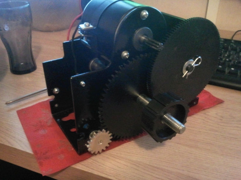

    I got the T-Max winch today. It runs, but is pretty noisy. I haven't disassembled it yet, I want to compare the noise of the drivetrain to the one you guys have been using first and will sell the one I won't use. The specifications state 227 kg @ 12V / 30 A on the first wire rope layer. If I use a 25 cm long arm this translates into 136,8°/second (465 mm movement per seconds) and 18 kg of force at the mid point. The strength will increase towards the end points of course due to the geometry og the arm angle, which is perfect since my sim will want to return to center, with a higher force the farther out to either side it goes. This should be strong enough and fast enough to move my rig. If I can push the Jrk to handle for example 60 A peak currents with heatsinks and a fan I will double the available peak force and reduce the speed to 110°/second (410 mm per second).

    Here's my solution to feedback. I used a 10x rotation 50 kΩ potensiometer and CNC-milled a 16 tooth module 2 gear that press-fits on the shaft. I then drilled an oversize hole in the appropriate position on the winch and installed, making sure the mest was right. This gives a 19,38:1 gear ratio from the output to the potensiometer, so 9,69 rotations on the pot for a half rotation on the actuator. I'll solder it together with some connectors and test later.
    If you're wondering where the clutch is, I swapped the output gear and the clutch gear. That way I save weight and reduce complexity. the output arm will be attached directly to the output gear, not the shaft.

    Consider mounting the potentiometer to the platform rather than the winch. If you later change the motor or the gear, you don't have to go through the hassle of calibration again.

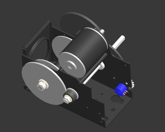

    I made a 3D model of the winch. I attached the model as a 3ds file for anyone else who wants to use a winch.
