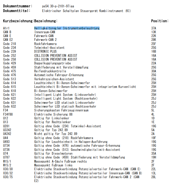

    @Jadran: i've ran a test: the needles shakes a bit and stop and no lights lighted... :(
    Maybe there is an anti-start system on the cluster? I have read that some cluster were hard to start because of that... Any pointer on this matter?

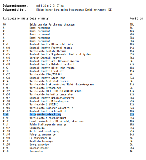

    @RacingMat this should be the lighting of the instrument panel

    @RacingMat Brightness control instrument lighting
  5. RacingMat
    2,234
    21,094Coins
    Good idea! maybe the brightness is too low indeed... i'll look for the rhesotat r1 and turn it :)
