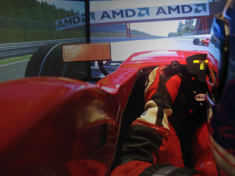

    the pictures are brilliant. looklike 40inch or 42 screens. realistic looking

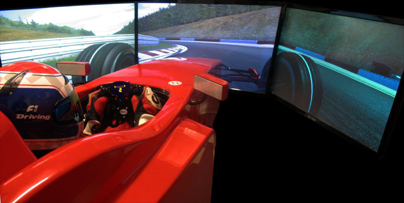

    Oh, I beg to differ on this one. There are several reasons why this is not just an immersion gimmick:
    * As a former racing instructor, one of the first lessons we taught was to look to the apex. Have you noticed racers turn their helmet before they get to the corner? On very tight corners (like a hairpin), this often means looking into the side screens.
    *Situational awareness is very important. If someone is pulling up on the inside of you for a pass, you want to know it. On a long oval, a spin can happen way down the track in a corner, but you will be up on it very fast. Many times, this happens on a side screen on our simulators.
    * In an open wheel car I like to be seeing the front tires for lockup. I do this in real life as well. With our correct FOV and proportions, the front wheel are in the side screens.
    Now this is highly dependent on the type of screen setup you are actually using. The screens on our Motion Pro II simulators are quite large and wrap into your peripheral vision. They are large enough and close enough that it means the the objects and relationships on the screen are close to 1:1 (ie, the cameras are lined up and the real wheel is proportionate to the on screen wheel to the driver). We spend a lot of time working with camera files, FOV and screen settings to make sure of this. This is the type of setup I am proposing here with the projectors.
    On small desktop screens, I can see this as more of a gimmick as the cockpit is so small, it's really just reference.

    Hey Chris check this out, i feel we all could learn a lot from the flight sim community. these guys are way more advanced in their setups and techniques. This is something that should work awesome for curved screen. It's home made but its very nice, and i like the mirror idea as well http://www.a340project.us/gallery10.htm
    Also, I think i found the best way to make the frex canopy screen on the cheap all by ourselves. We buy a 3 or 4 foot beach ball, depending on what size you want the screen, mark off where you want the actual screen proportions on the beach ball to be and put some plaster on it and make a mold.
    Then we buy some clear plastic sheets and make our own vacuum molding machine like this http://www.youtube.com/watch?v=e5CGfoxnKaQ
    apply this goo http://www.theaterthings.com/?gclid=CPj ... 5QodNGEHPw
    and we should have a frex style canopy screen
    there are a lot of videos of vacuum molding on youtube so watch a few, the results are very impressive and i plan on using this technique a lot in the future.
    also, i agree with the 3 screens, it add's so much, even my 3 19s are awesome, i could only imagine 3 46s lol.
    plus with the eyefinity we could link up multiple projectors and and have a seamless image completely surrounding our peripheral vision, built a little car around it and add screen's you'll have a windshield and the side window's perfect. that be sweet and on par with the flight sim guys :D
