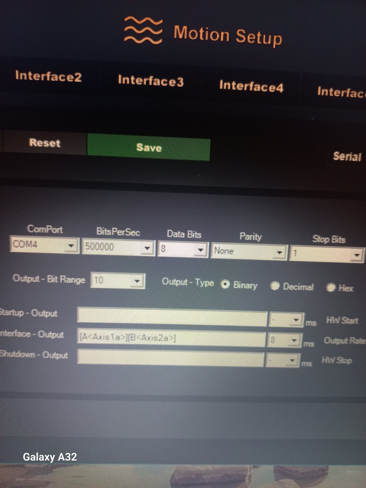

    This is not right because you need to have at least one motor inverted. The next step after setting these is to go into the test settings screen and make sure it’s smooth. This assumes that you have already used the test waveforms from SMCUtils to validate your servo settings.
    IMHO it’s easier to start with pitch and roll. Then you can go on the track and drive up on curbs and the like to make sure that the car tilts as expected.

    Hi Joe.
    Thanks for the correction. I'll make your recommended changes as soon as I get home. I'll give an update asap. I've uploaded a pic of my interface setup.
