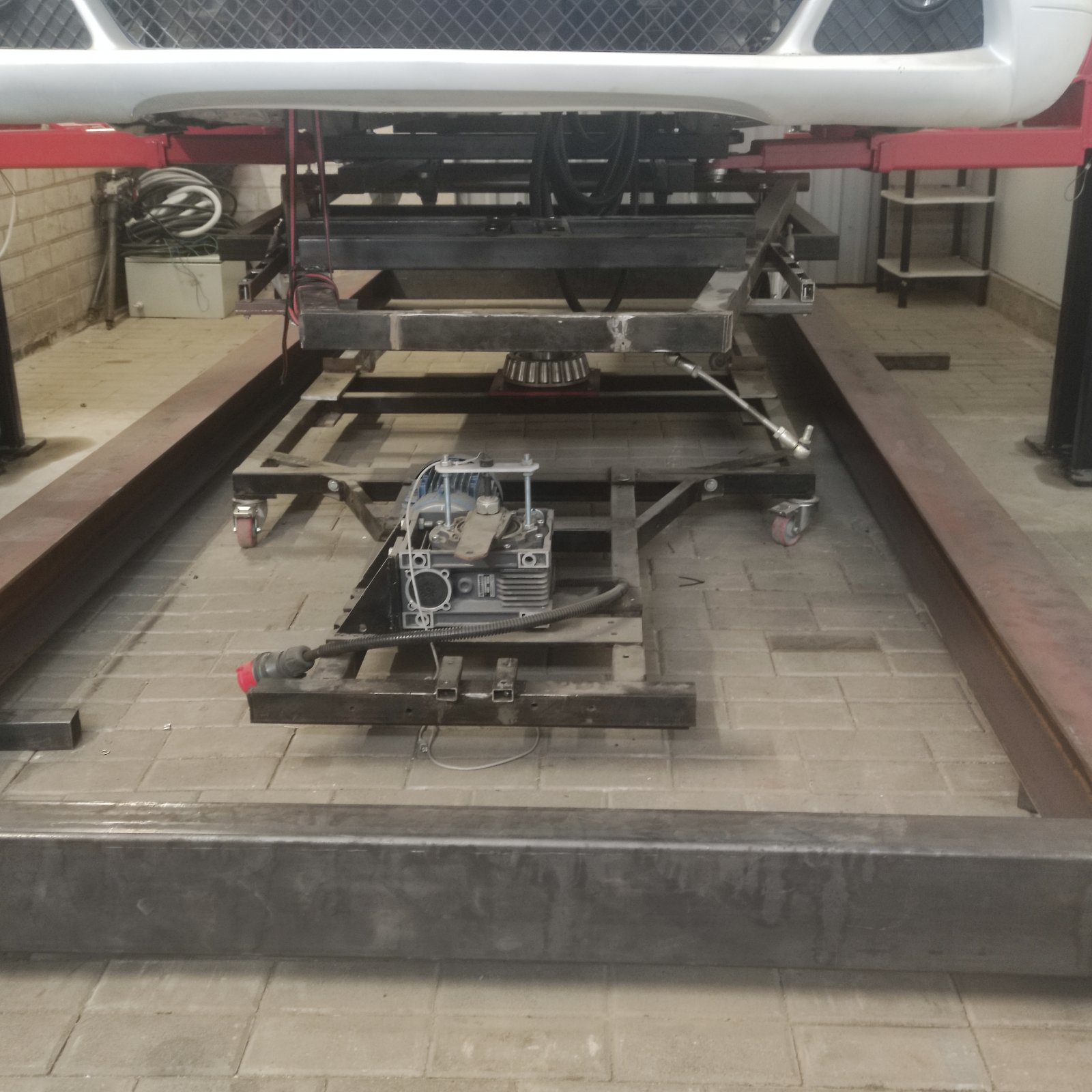

    i have read that backlash is imminent, unless precision gears or other type reducers are used.

    indeed, backlash got a little better going from 18 to 10 centimetera, but it still persistent. only way i can get almost rid of it is lowerint motor power to 40 percent, which makes movement not interesting.
    i'm looking into planetary reducer, but could not find much of them used in xsim.
    maybe you guys seen or tried it? how compared to wormgear is ot more stable?

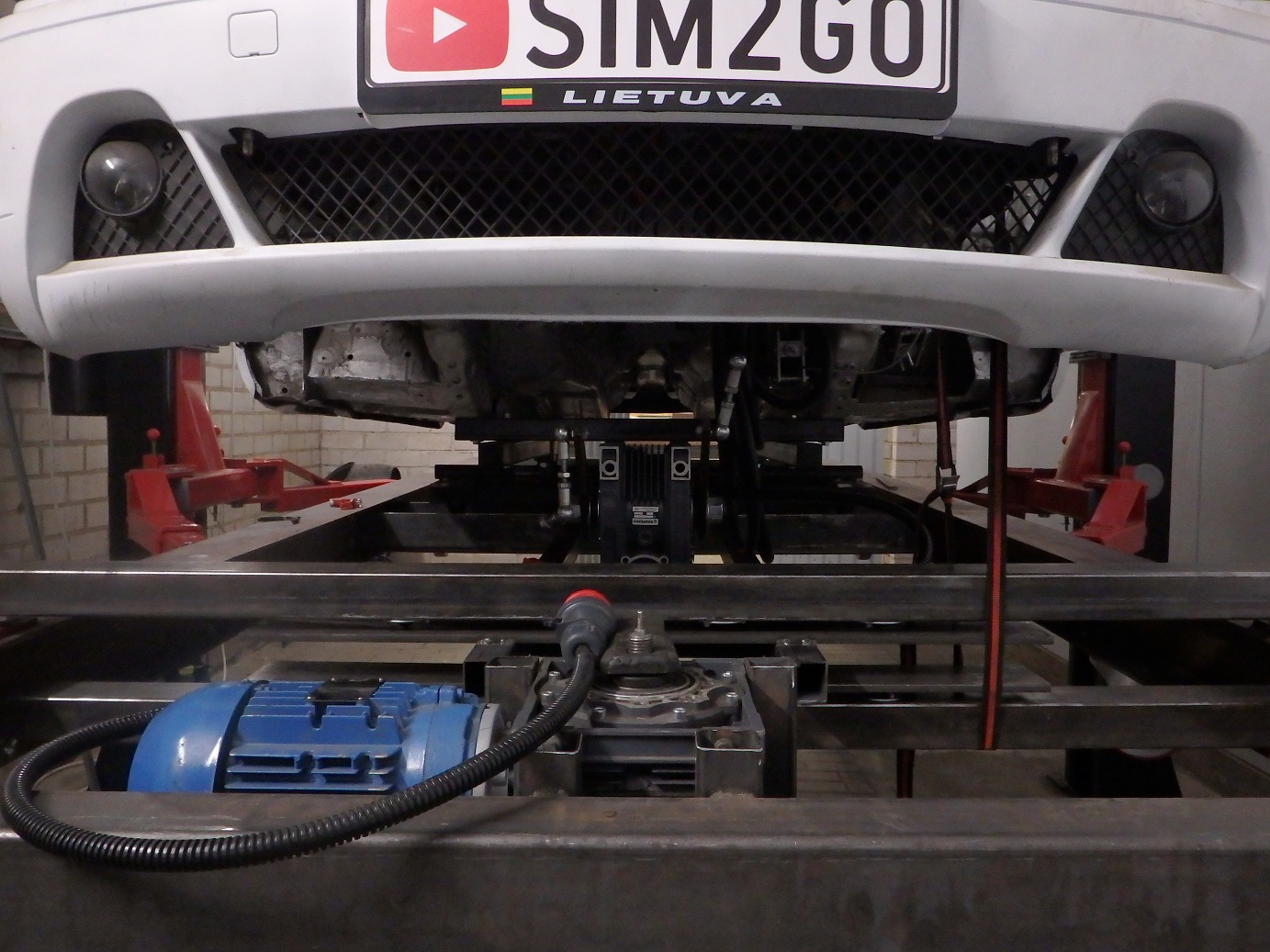

    Added two 100N gas struts. It helped to reduce backlash time. might play later changing theit position.
    if anyone have link to planetary reducer for ac motor (b14, m8 screws), please, hit me with it.

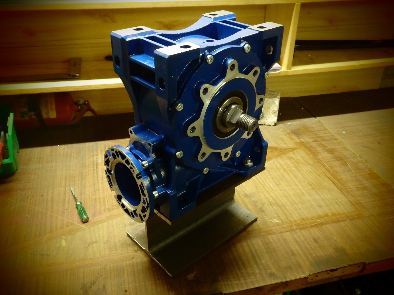

    Does anybody can tell what type of reducers are used here?
    l'm stuck on choosing the right, low backlash, type reducer for ac motor.
    For asking about using planetary reducer with AC motor got an answer that it should be used with servo motor instead.
    Do anybody have knowledge or some links about typea of reducers for this kind of situation?

    I guess these are planetary?

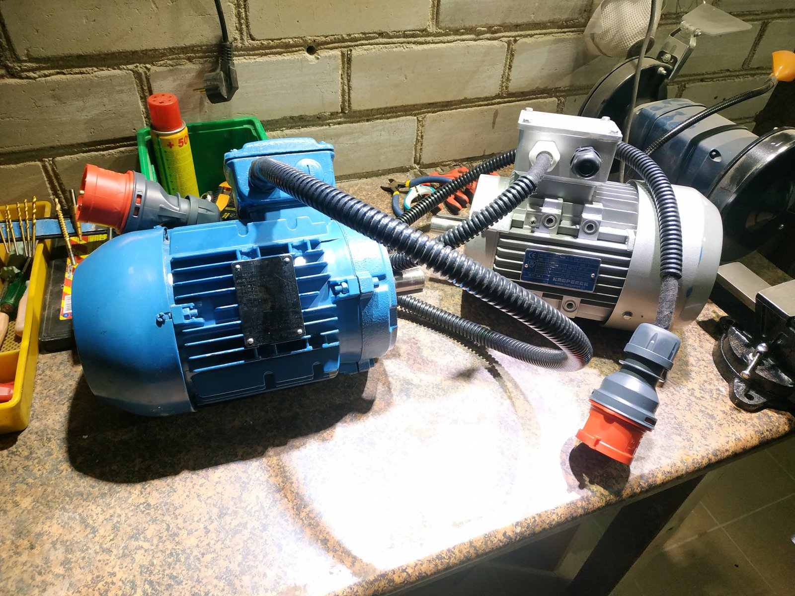

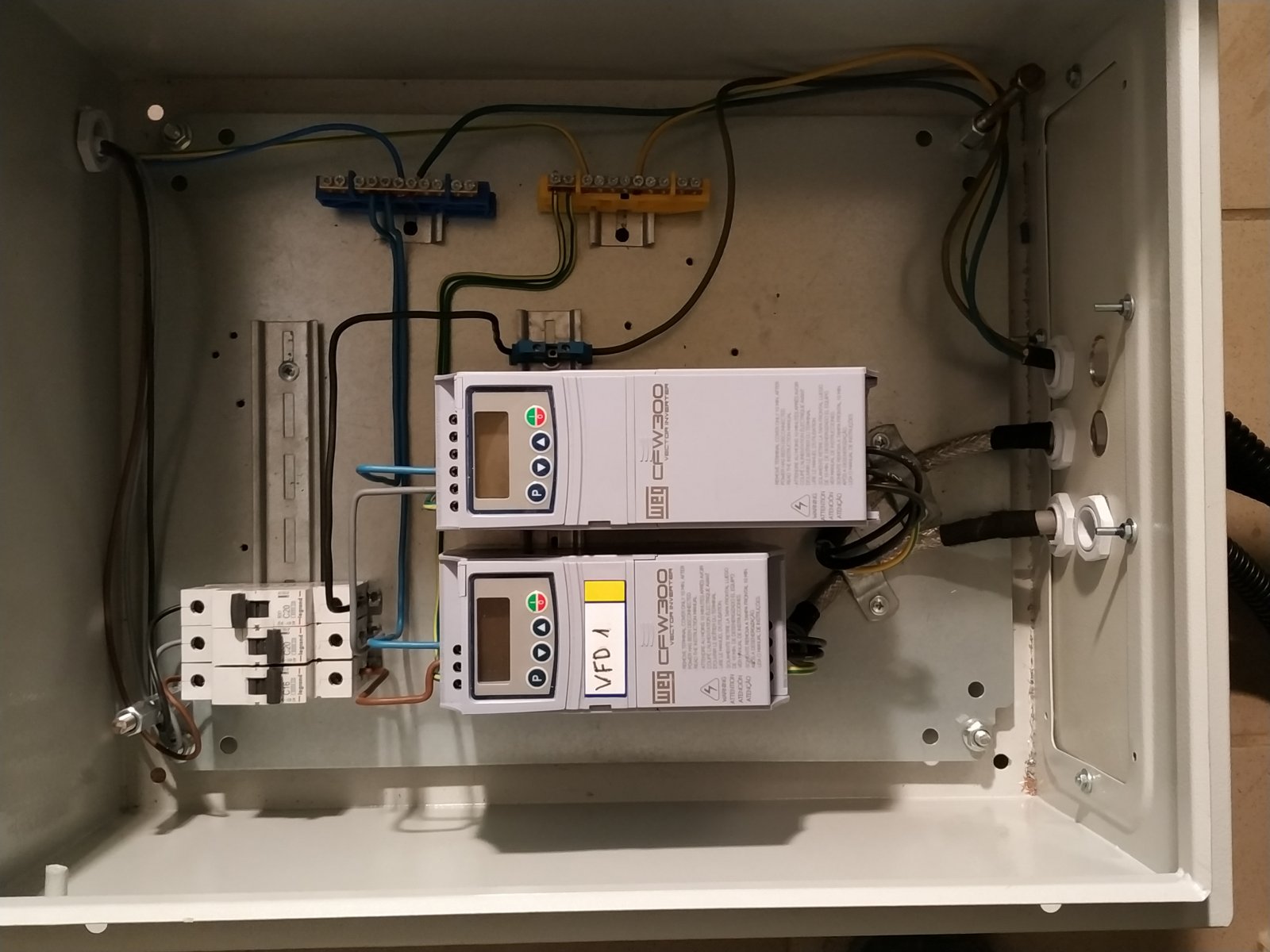

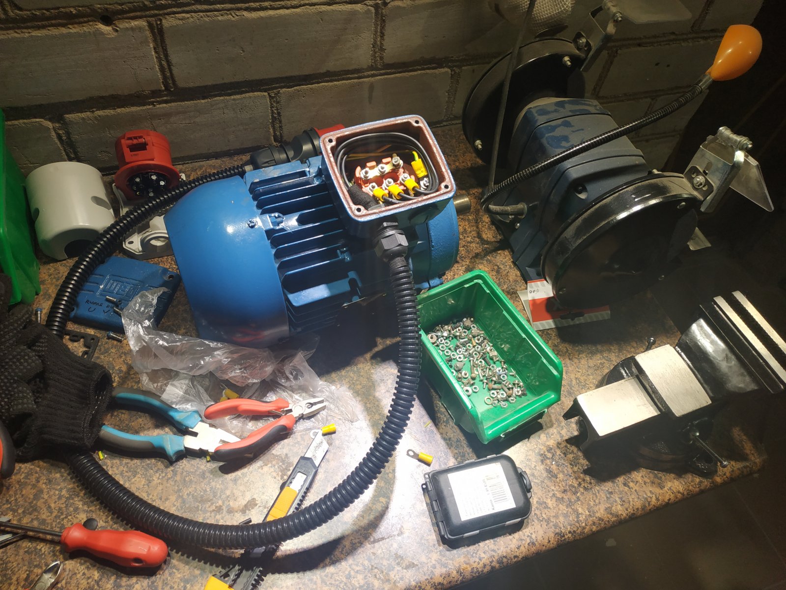

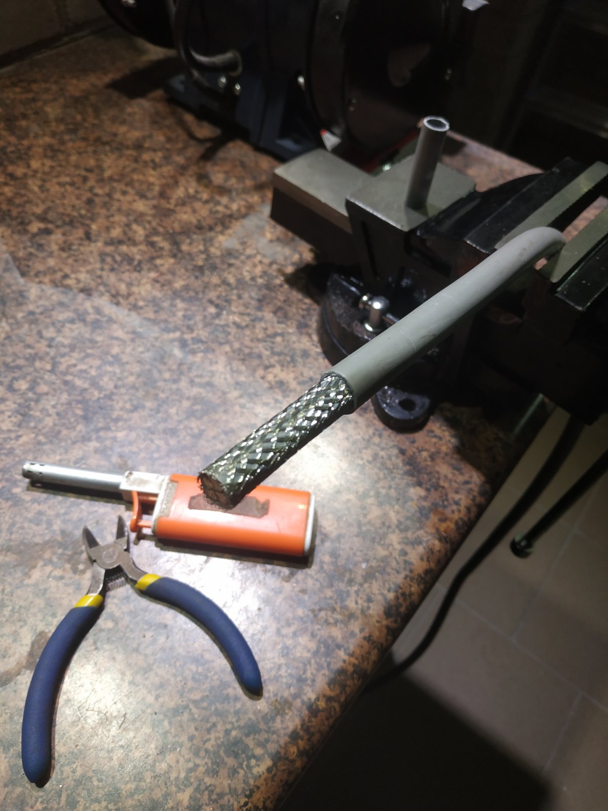

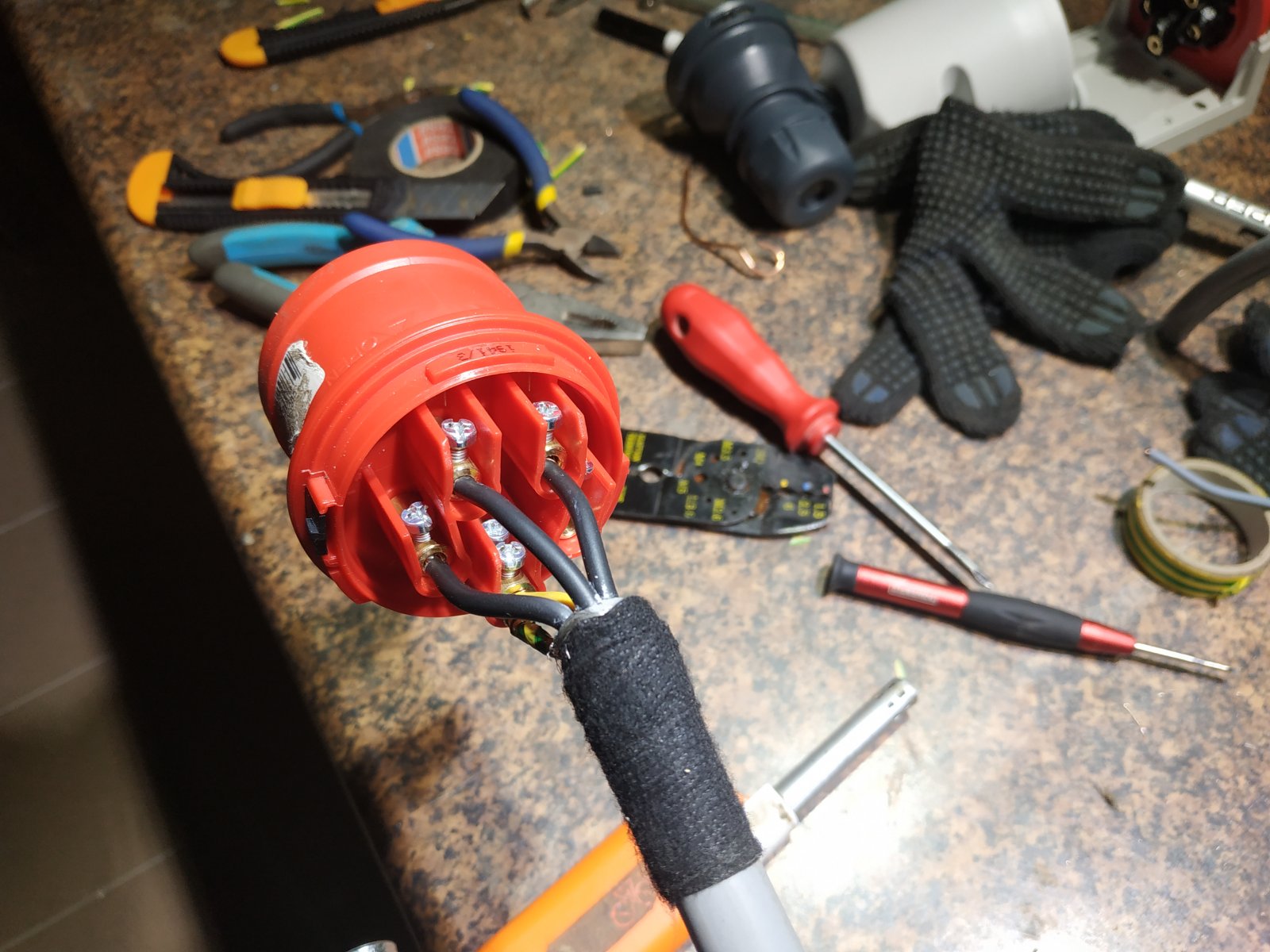

    Probably a mistake to make quick swap motors in vfd-motor line, but at least could see EMI problem better. Loaded brake pedal with x weight on it and unplugged motor while vfd was still on. The load cell - brake pedal slider went up a little as expexted and requires less weight to get more. Then unplugged vfd and while it was shutting down the brake slider went huge chunk upwards untill vfd compeltely went off. I made kinda decent grounding into chassis, got shielded cables for motor power and vfd, ferrite rings on usb usb cables,but main problem seemed to be vfd emi all along. After doing quick search found that emi filter and ferrite ring and distancing cables should be right things to do. Wondering what emi filter to choose...

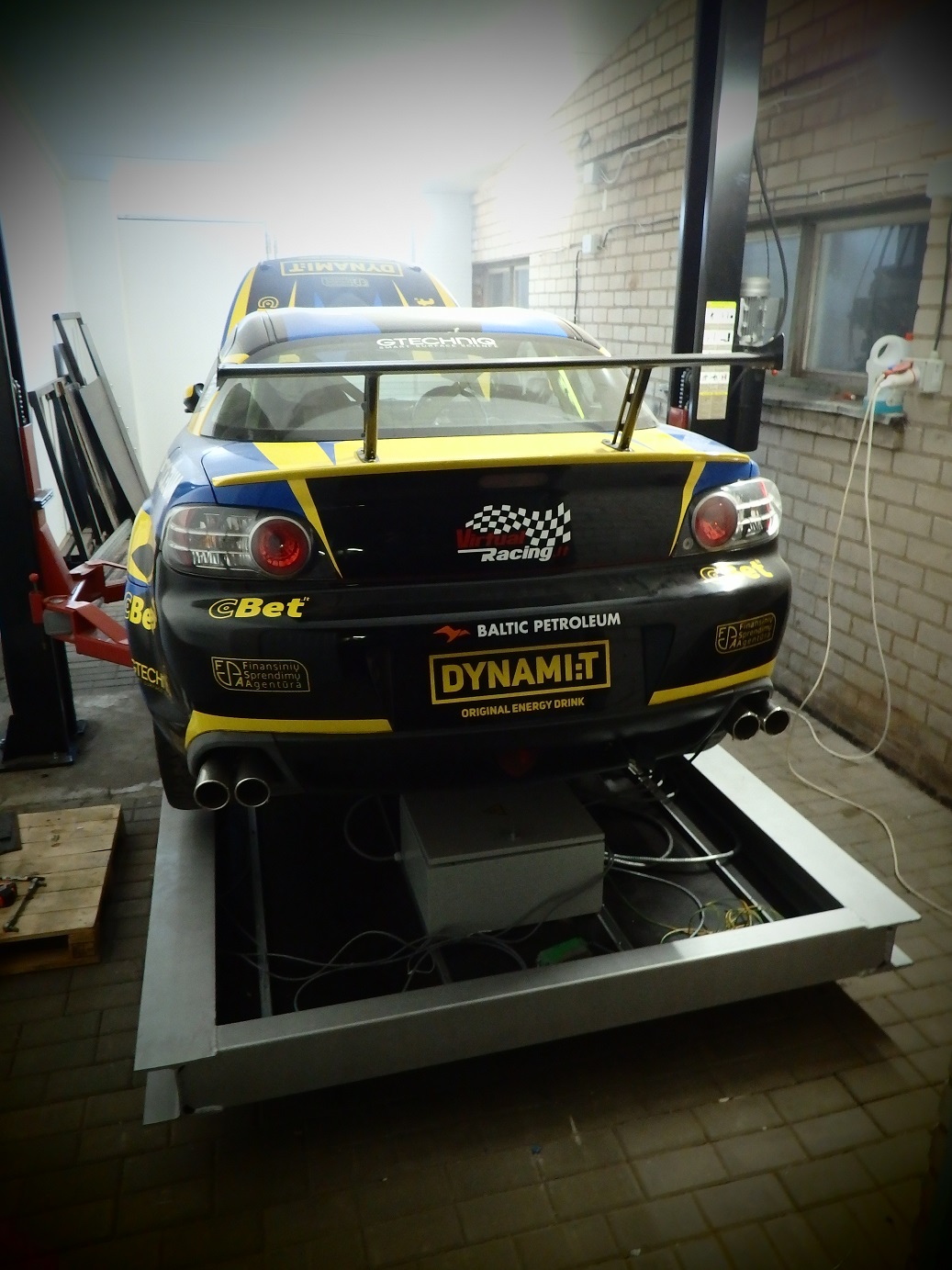

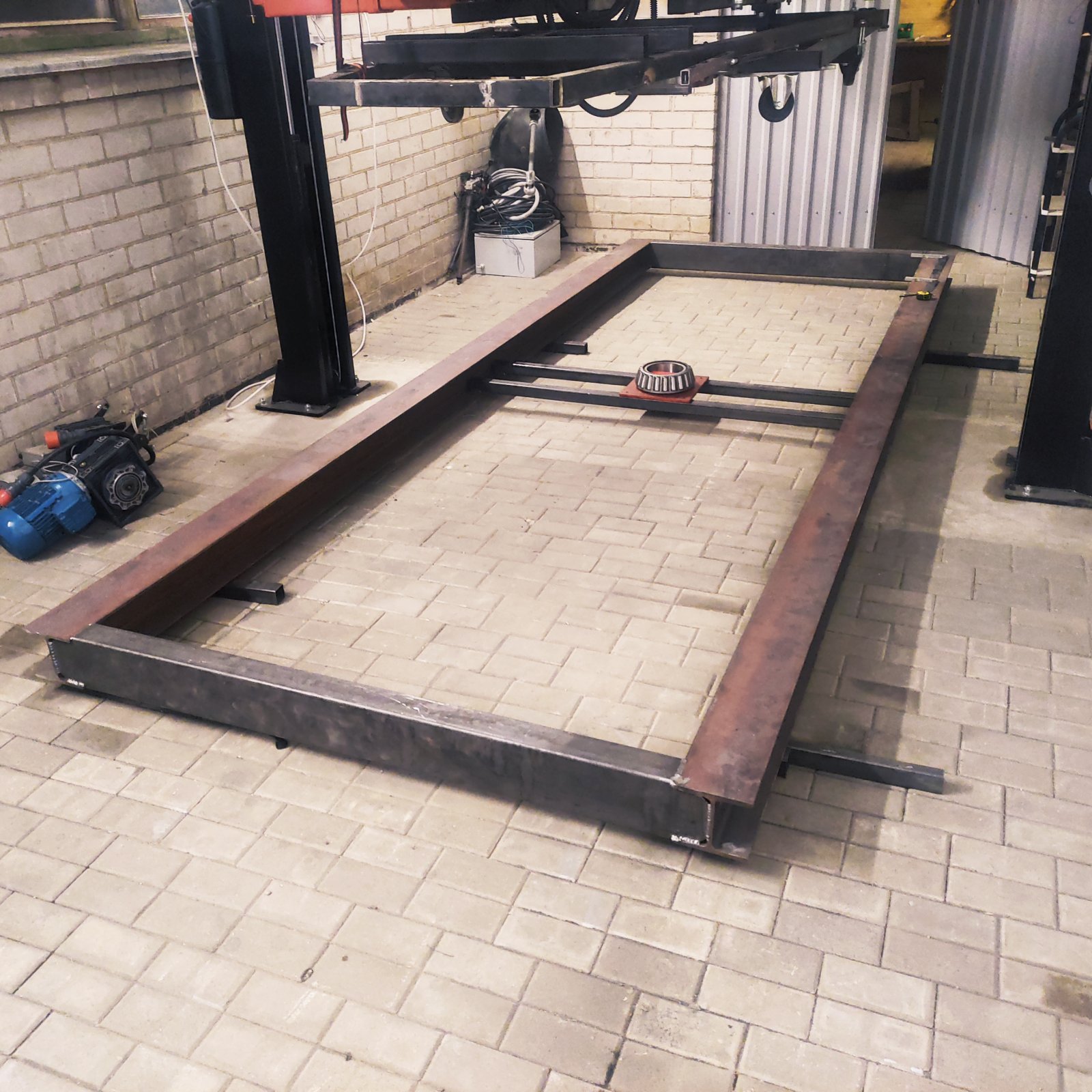

    Last stage of this sim will be making it mobile. Hoping to finish this and make it to local IRL events (rally / racing ).

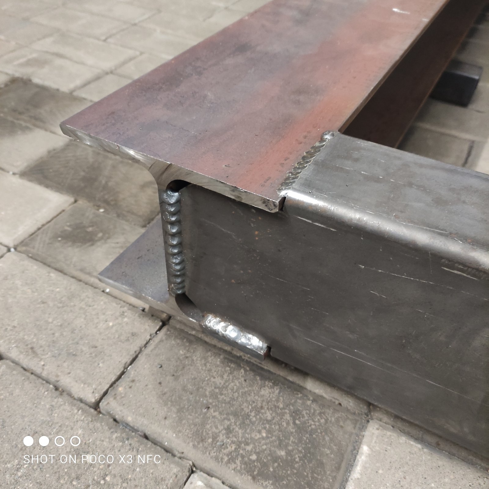

    Using HEA 160 and some 160 tube for whole thing. It will be easy to attach roof/tent/projector screen.
    Still first co2 balloon on MIG welding. Guessing it will hold the thing together. Total project weight will come something like 1000-1100 kgs. Heavy bottom solves anchoring.

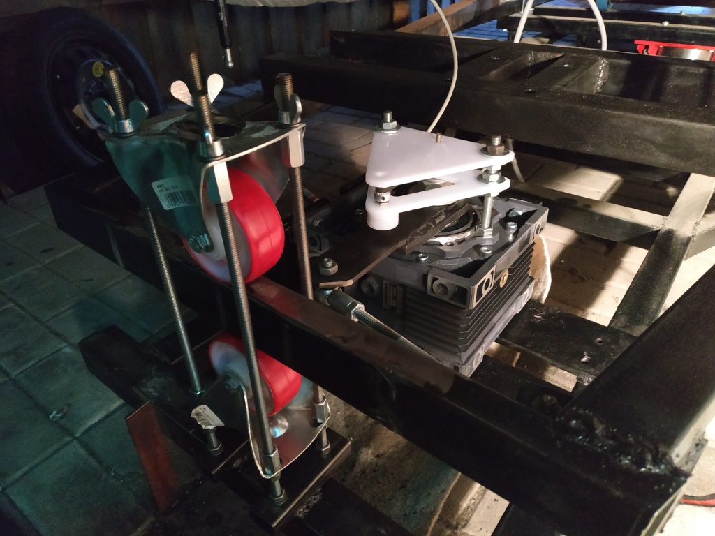

    +57 / 1 / -0
    2DOF, Motion platform

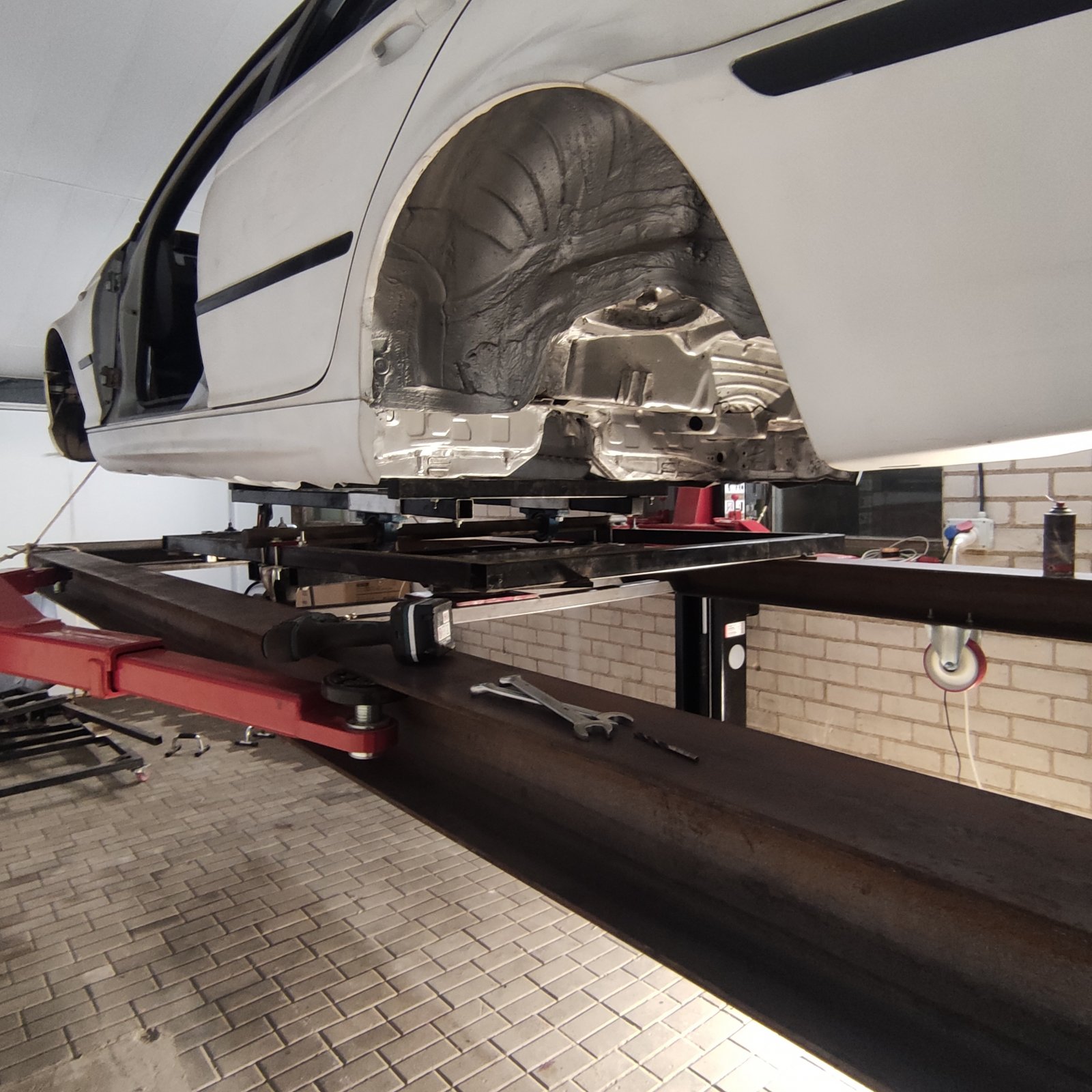

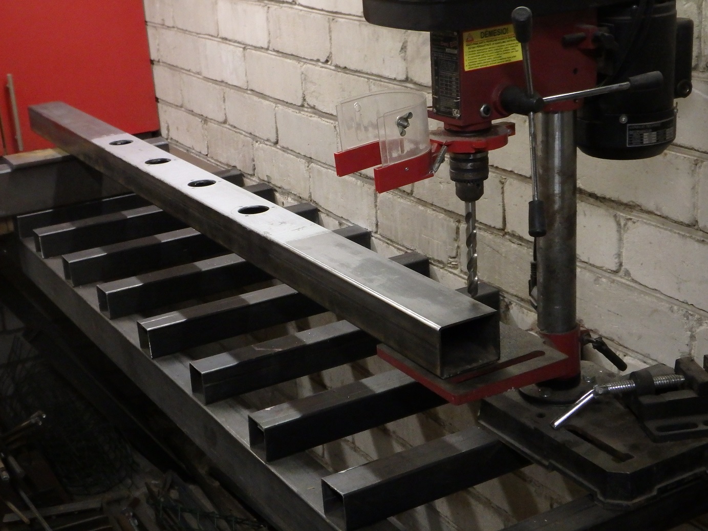

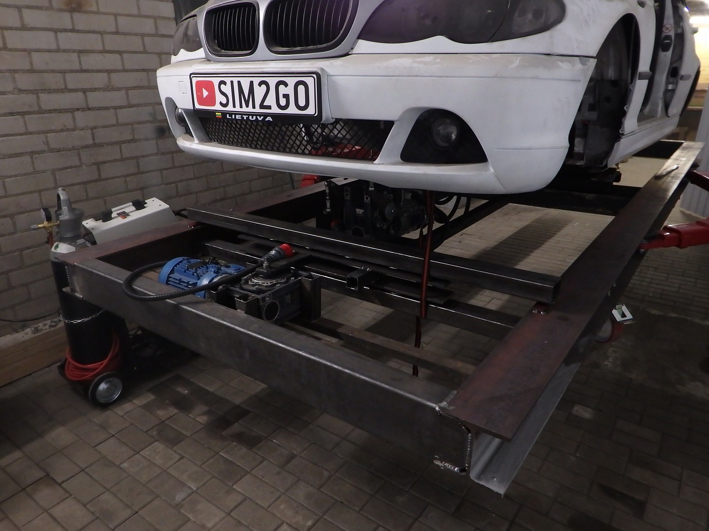

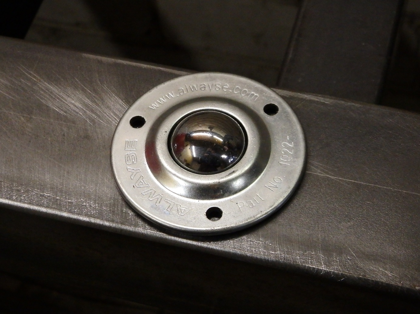

    Received 4x300kg wheels to move platform around in garage to be able use car lift for other purposes. I mean they are huge compared to what i've used. Also ball bearings for stabilising sandwitch layers. It'll be kinda expensive to drill such wide holes, instead I'm thinking of getting pipe with thick walls.
    Two 50x50x4 tubes is not enough to hold whole chassis weight and has slight bent to it, will add support.

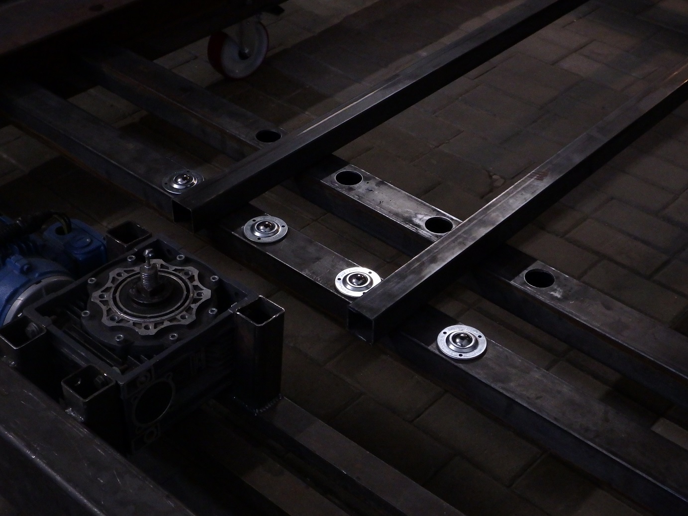

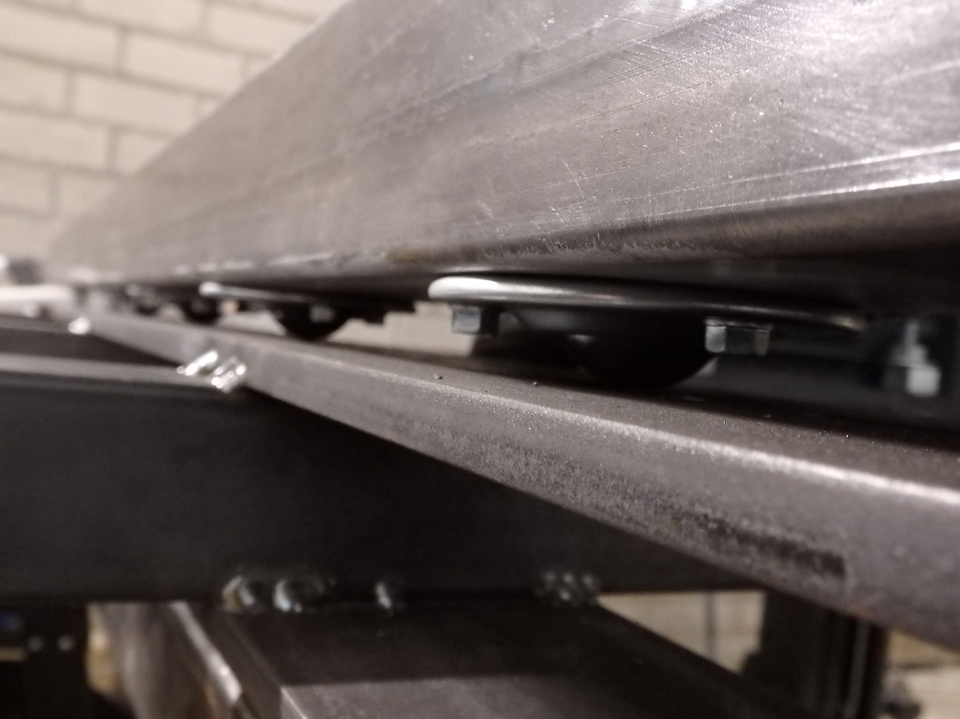

  18. sim2go
    sim2go Member
    Mar 1, 2016
    43
    Operator
    Lithuania
    343Coins
    +57 / 1 / -0
    So instead of cutting pipe with thick walls decided to pay for 8 holes drilling (30e really for same day pickup). It would've been pain getting 4 same height pipes.
    For upper layer two additional holes for screws to adjust height. Bottom height welded permanent.
    It was luck to manage get all balls to get contact, at least at center position.
    When moved around one or two balls sometimes lose contact, but no worries as it will need readjusting after some time of use.

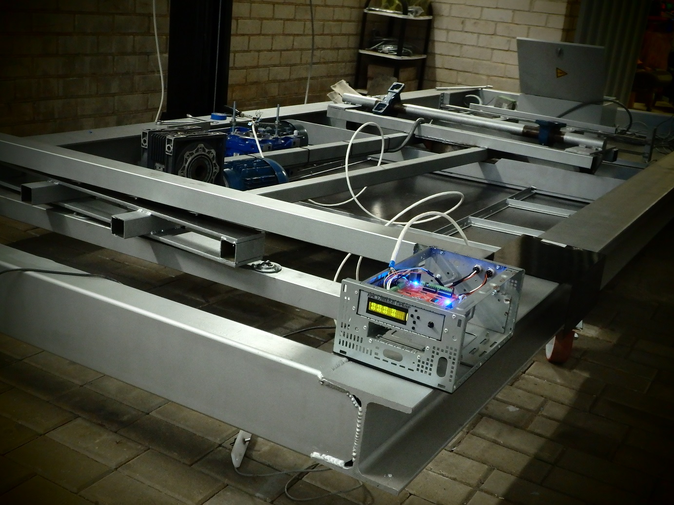

    Now to get old system running need to place gas struts and connect reducer arms/levers. Also get cables going. For sensors instead of hall sensors will use SSI contactless, should help dealing with slight movements in construction.

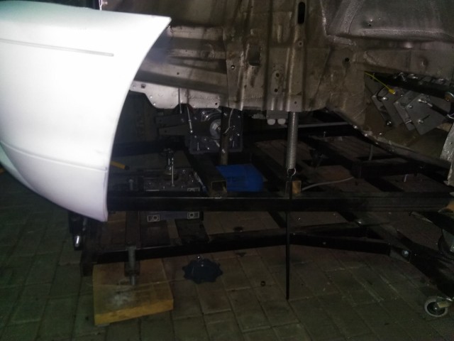

  19. sim2go
    sim2go Member
    Mar 1, 2016
    43
    Operator
    Lithuania
    343Coins
    +57 / 1 / -0

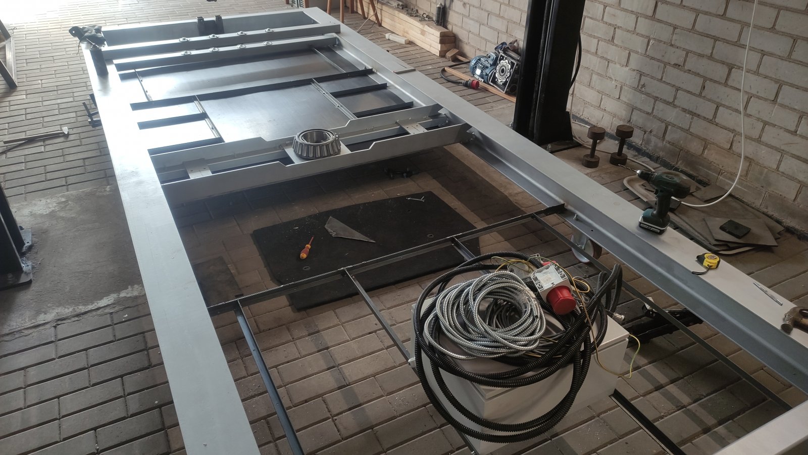

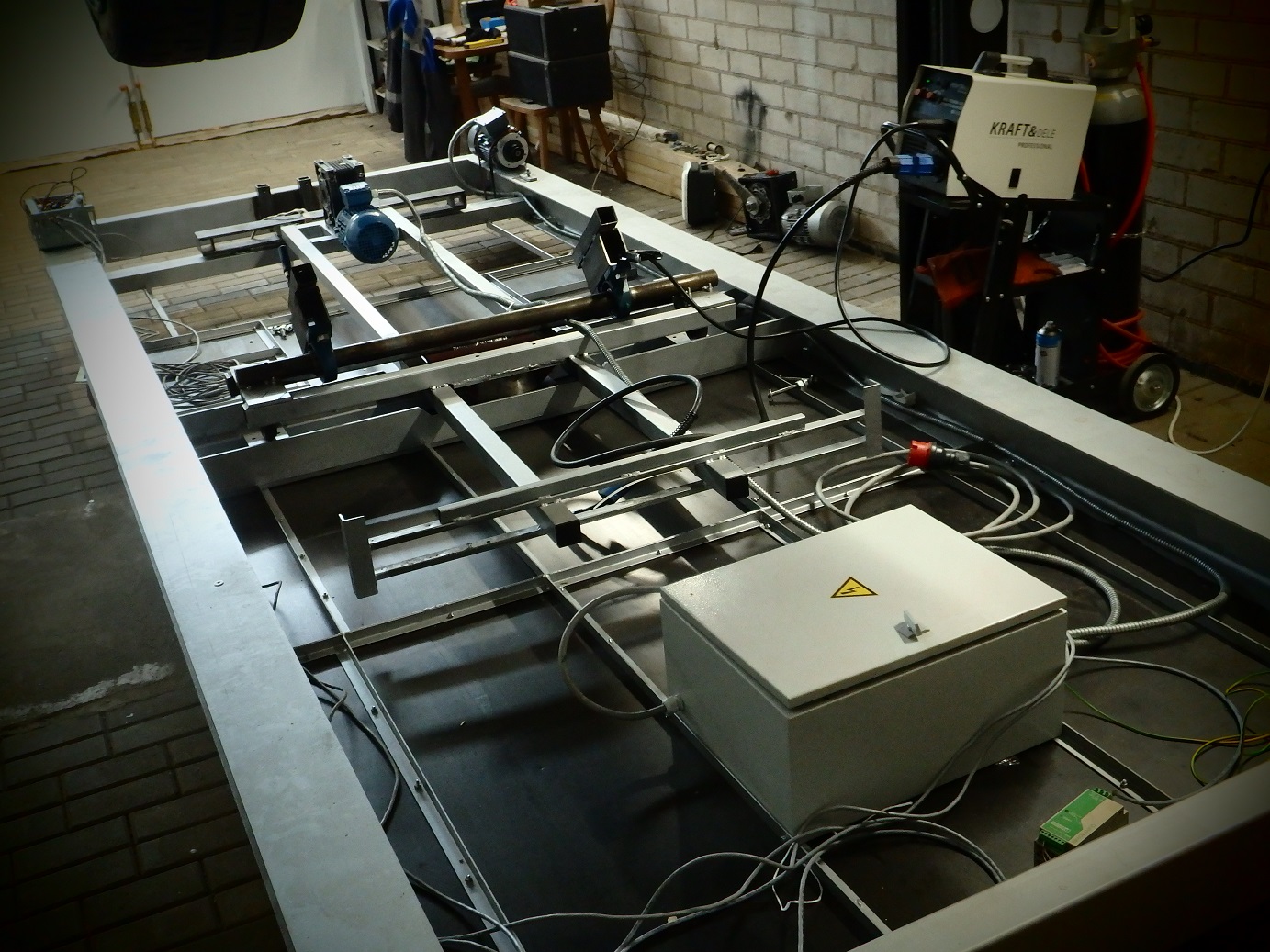

    Covering platform bottom. After doing it will go for wires, cannot continue work with motors/reducers without them.

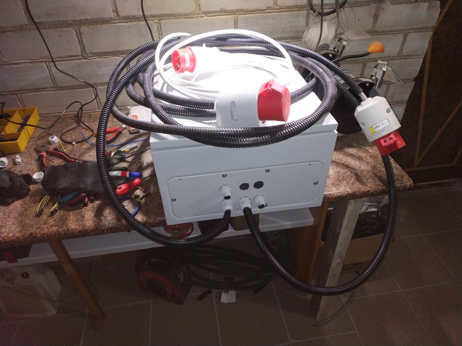

  20. sim2go
    sim2go Member
    Mar 1, 2016
    43
    Operator
    Lithuania
    343Coins
    +57 / 1 / -0
    Things are going well. Most of the re-welding thing is done.
    for yaw axis will use 60:1 instead of 50:1 this time. thanks to colleague pointing out serious mechanical error in my pulling mech, should do right this time.
    this time using SSI sensors. sadly still getting a little chirping in VFDs between "rdy" and "0.0hz". will solve on or another way.
    sorted out distances, now will properly wire up tech.
