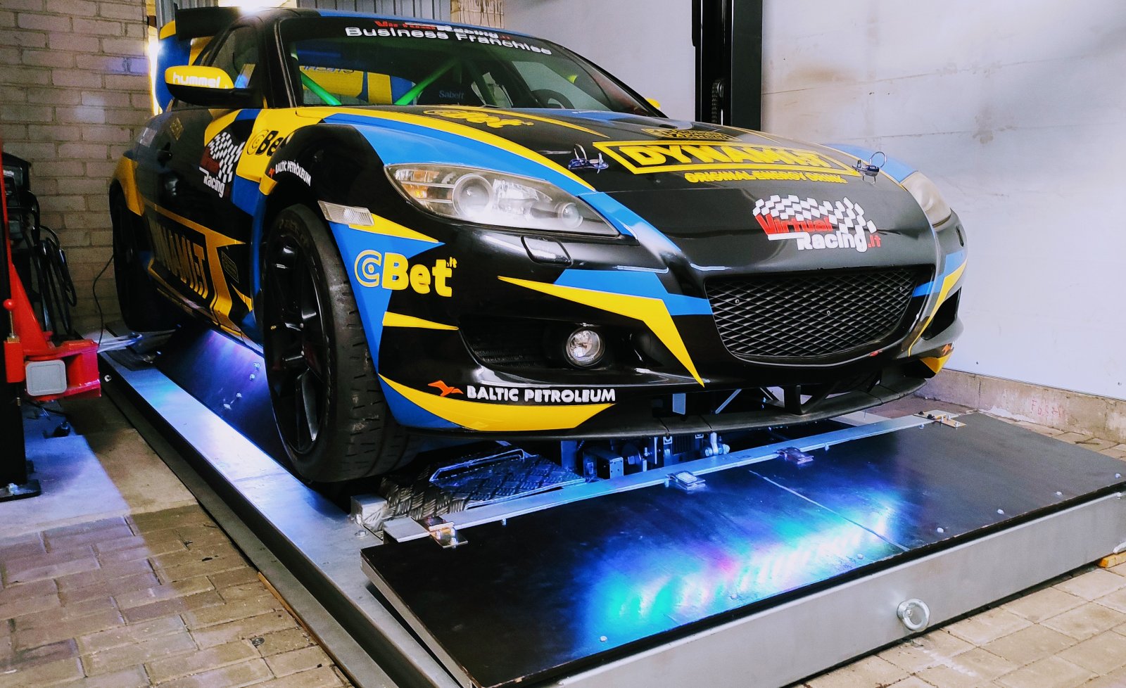

    Coming out as pretty minimalistic motion platform.
    I think next project combining shipping container as motion frame base will come out much better and much faster

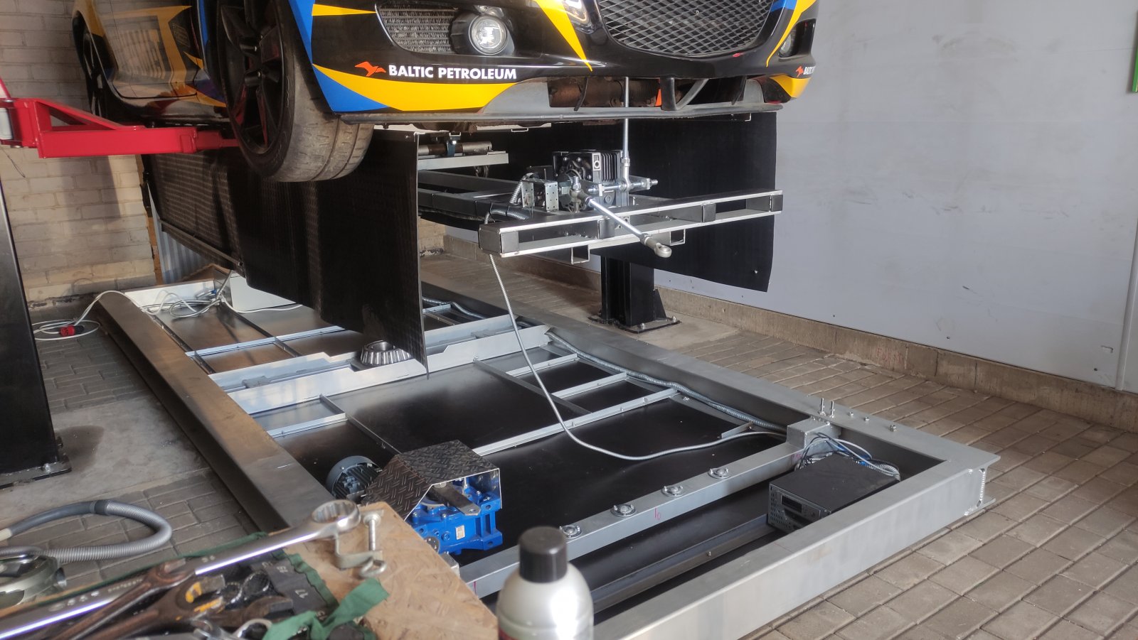

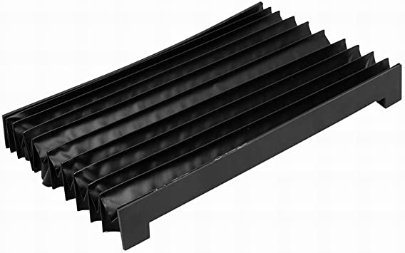

    Logical way to go would be with
    but it takes time to make, can't find any producer in country.
    Playing around with 3mm thickness rubber.
    Previously used gas struts to smoothen out backlash, these gave even better effect.

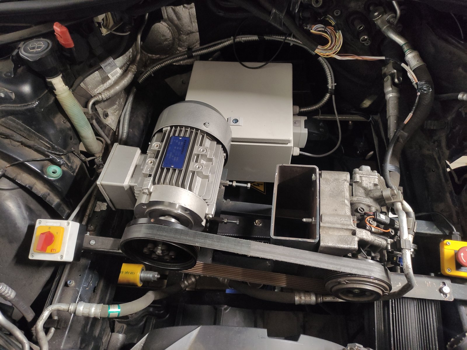

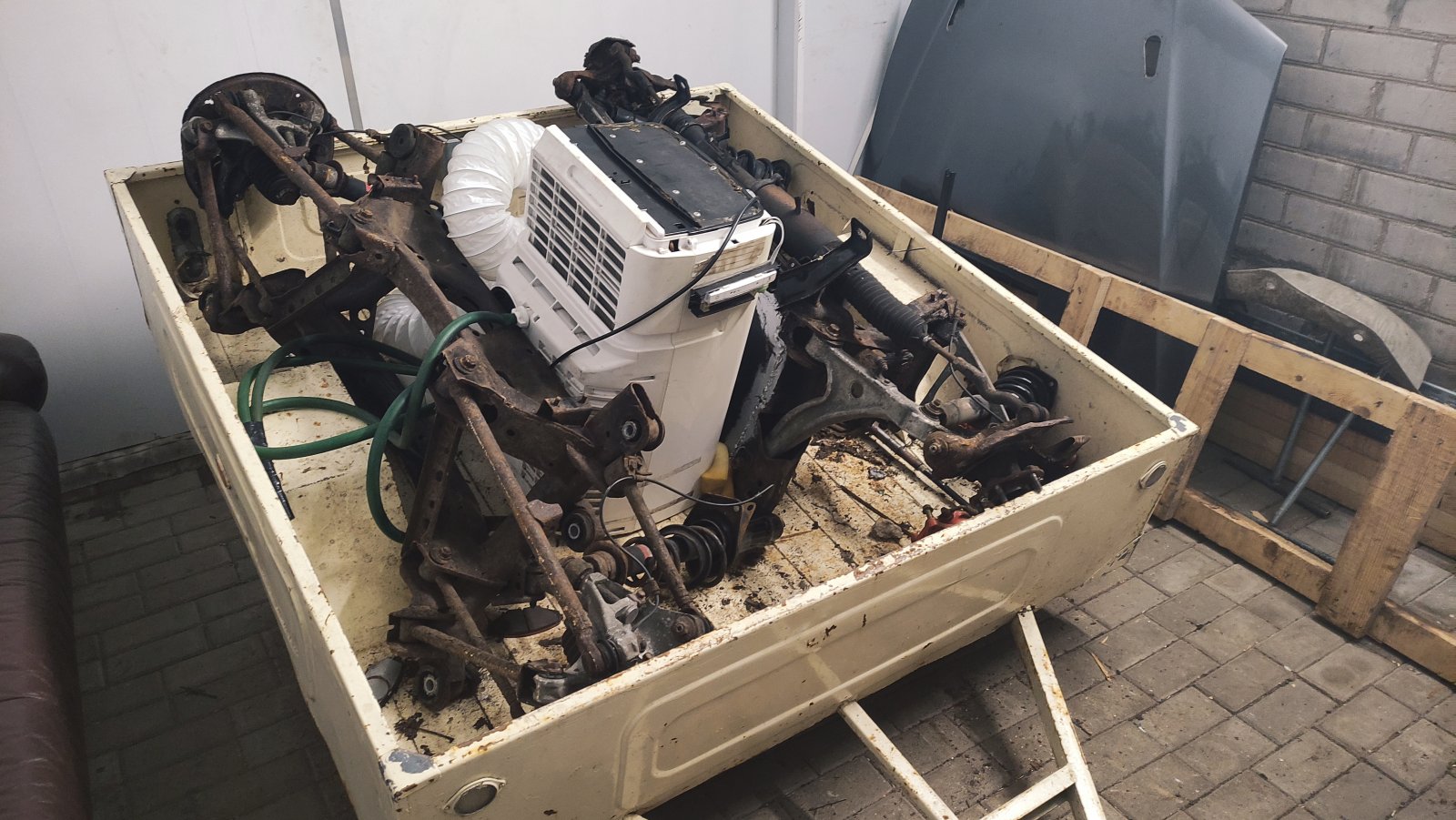

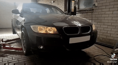

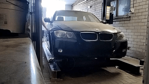

    Got rid of axles, moved wheels to yaw axis.
    It looks different with wheels moving with yaw only, but I'd say not for worse. 40kg of conditioner gone for now as well.
    PID for both 10/0/1 for now.
    Something like minus 200kg

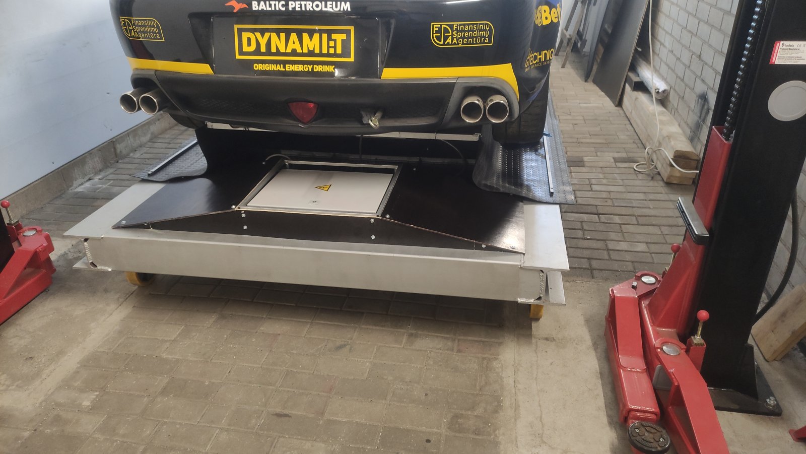

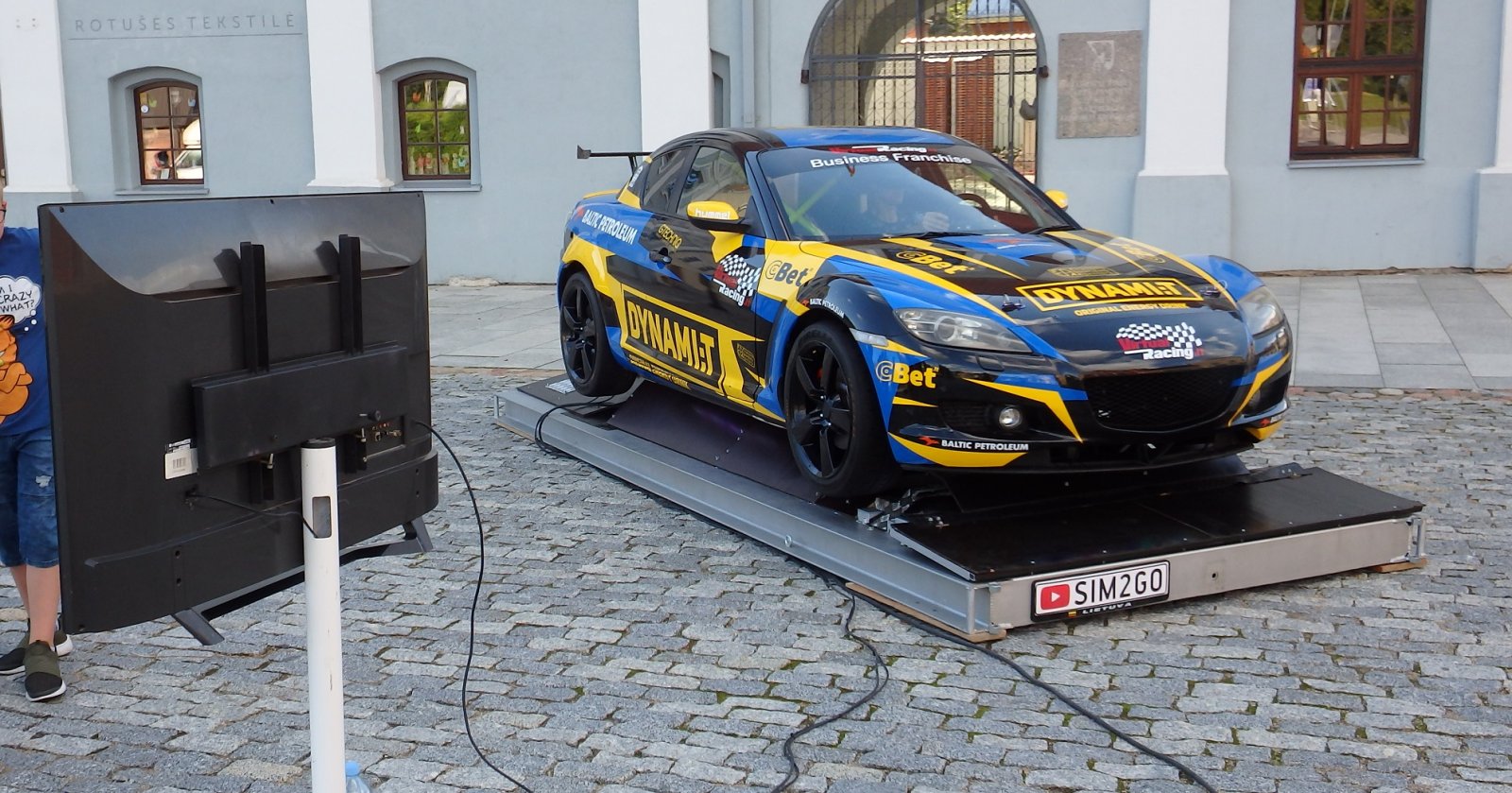

    Had to cover sides with plywood, previous attempt with 3mm rubber didn't workout, because of its weight and it becoming less less flexible. Whats left is to cover front, where reducer levers are seen to prevent children interests at some level and some isolation for sandwitch wheels to avoid sand particles.
    Previously used 10m usb cable to connect AMC1280 to PC, had random disconnects ending up as SimTools Engine software crash. Swapped it with 3m USB cable -> Active usb hub 5m cable -> PC. It solved the issue.
    Looking for router for making local host connection to make pc and android phone talk eatchother. Will add streamdeck controls to make everything easier and adjustable for people likes, like setups, wheel strenght, timers, etc.
    As it is platform cost isn't as high as one could think. Very roughly its under 5000€.
    Hopefully soon to make short journey to some local park, to test how things are going - transportation, loading/unloading platform, leveling it, energy connection. Will try to get some shots :)

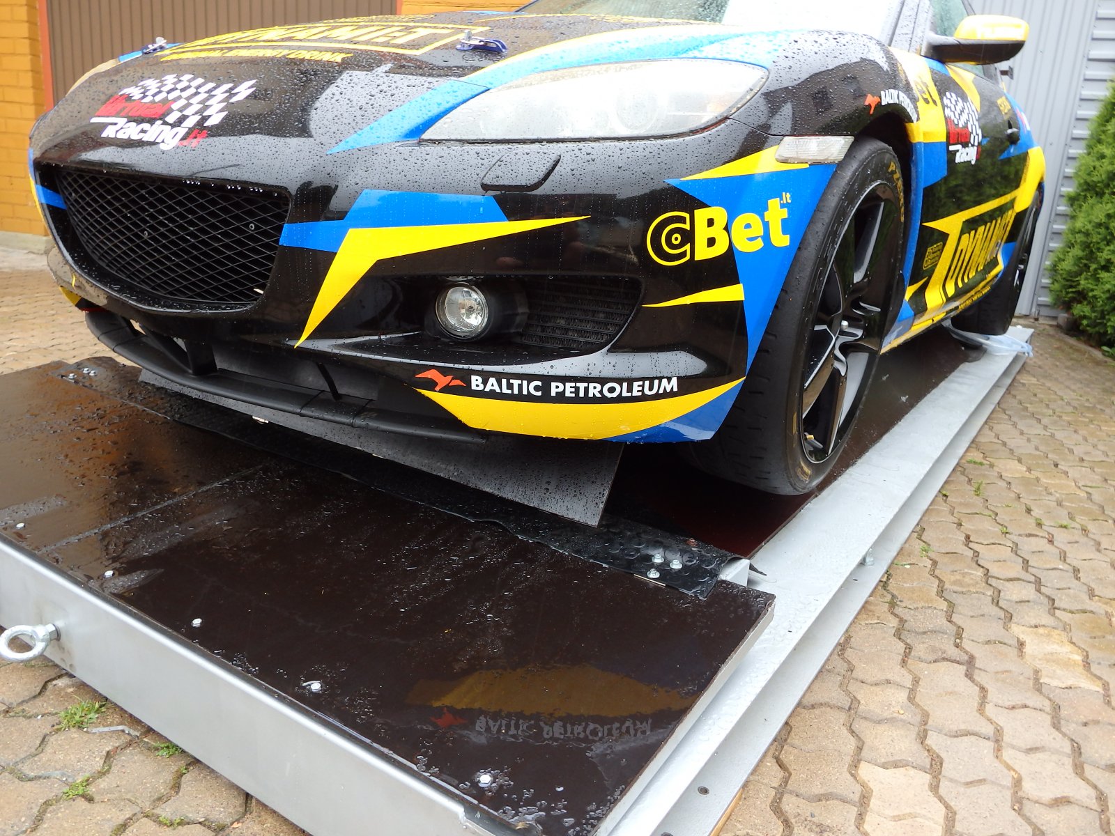

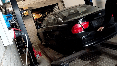

    Went trough 6 hours of rain. Causes small issues like plywood arching, some rust. Drilled extra holes and left ways to water get out. It was silly me sealing all the cracks and after realizing it would make great waterpool.
    Did first free of charge event in my hometown at evening till midnight. Around 50 people tried it out, they liked it. Met few simracers or those who show great interest, talked about it, maybe some more enthusiasts will show up :)

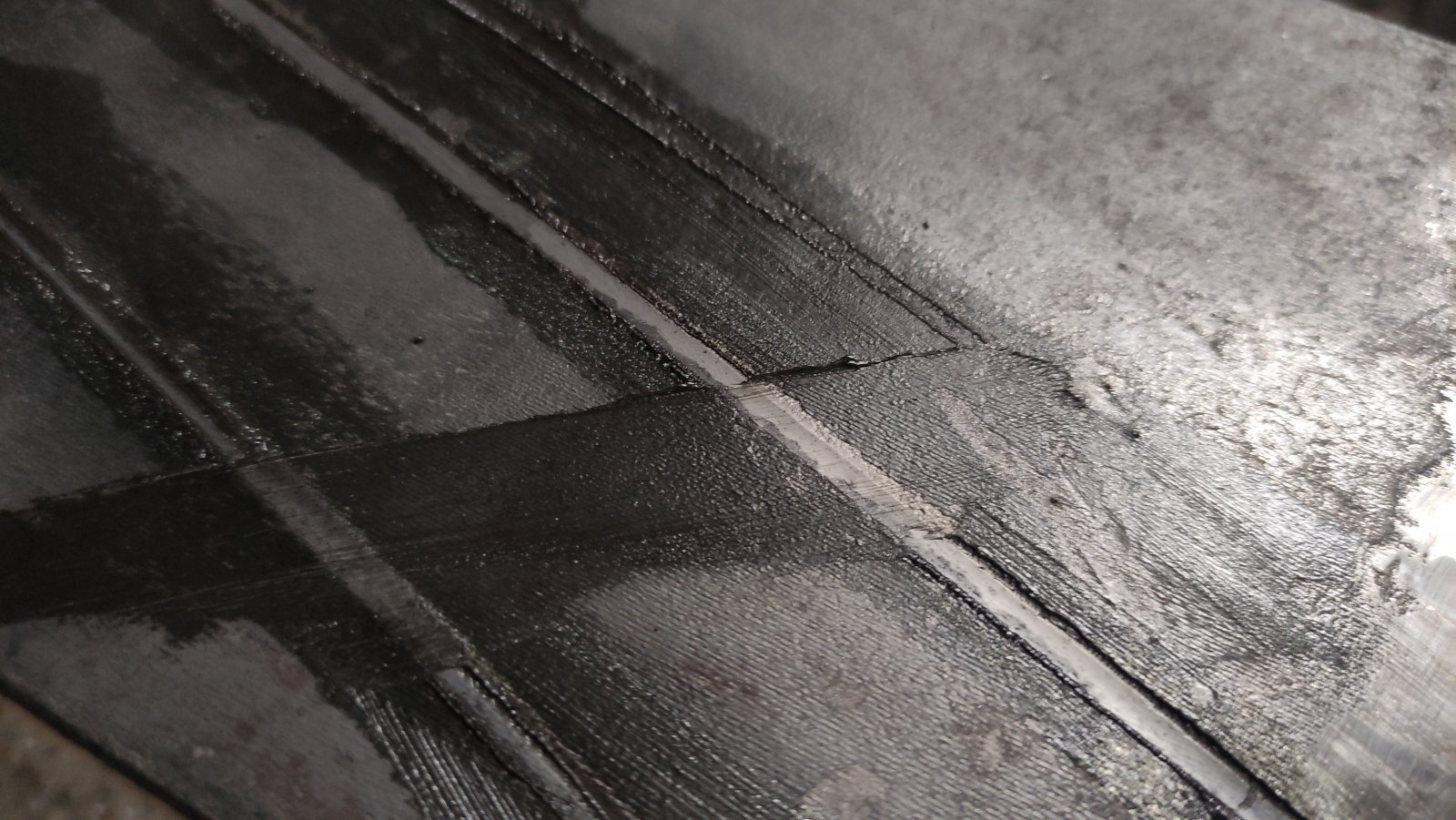

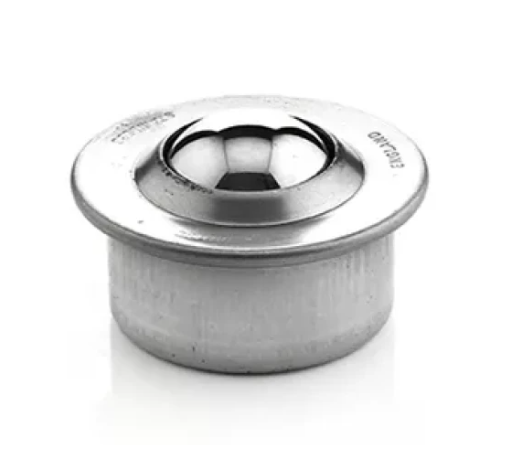

    For traction loss I use alwayse 5030 300kg ball bearing, 6 of them 3 each under U beams.
    Beams has some bending in them and ball bearing plate tilts and does not give each ball same stress.
    After finding way distribute weight better planning to change contact H beam which is S275 to harder metal plate.
    What is optimal metal surface for these kind ball bearings? Do you have to play precision game or let metal deform and let bearings to even out?

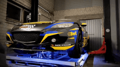

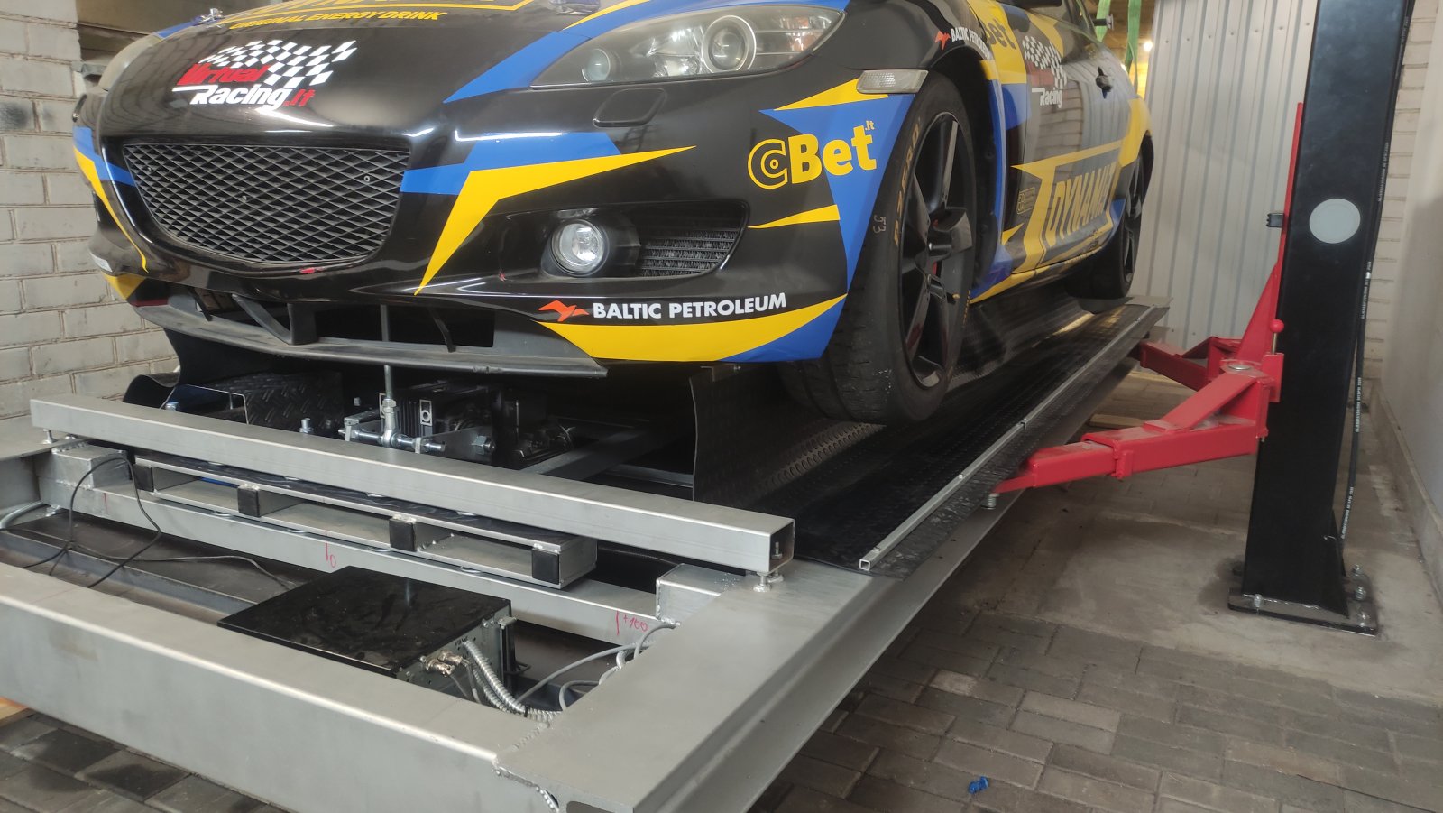

    Replaced metal ball idea all along and rewelded platform all together. Now front and back sliding is done on forklift wheels. Back ones are on hard rubber blocks to absorb metal bending to keep wheel in contact with surface to prevent it from tilting and cracking. Added watts link to the prevent car shell from rotating from air springs when actuator is at work. Still saving bit by bit for actuator set, 4x 750's should be more than enough, not sure for TL.
    To keep logistics one of actuator ends will have to quick detach to not absorb shocks.
    Also looking at 10R wheel sized trailers to avoid mounting/dismounting car from and onto. Towing thing to few day festivals would make more sence and be enjoyable.

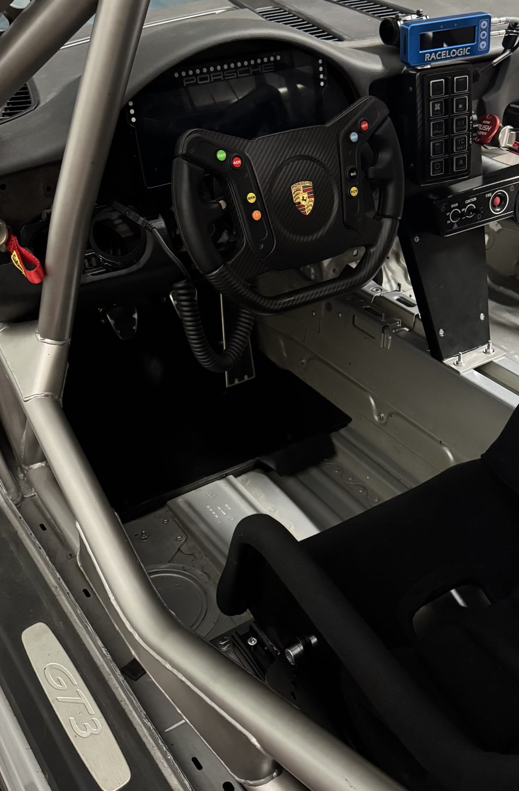

    Steering wheel, pedals are solid and kept stock position. Great feeling having quick oem wheel and chair adjustability. Not so much solid fanatec shifter, might keep holding for some time.

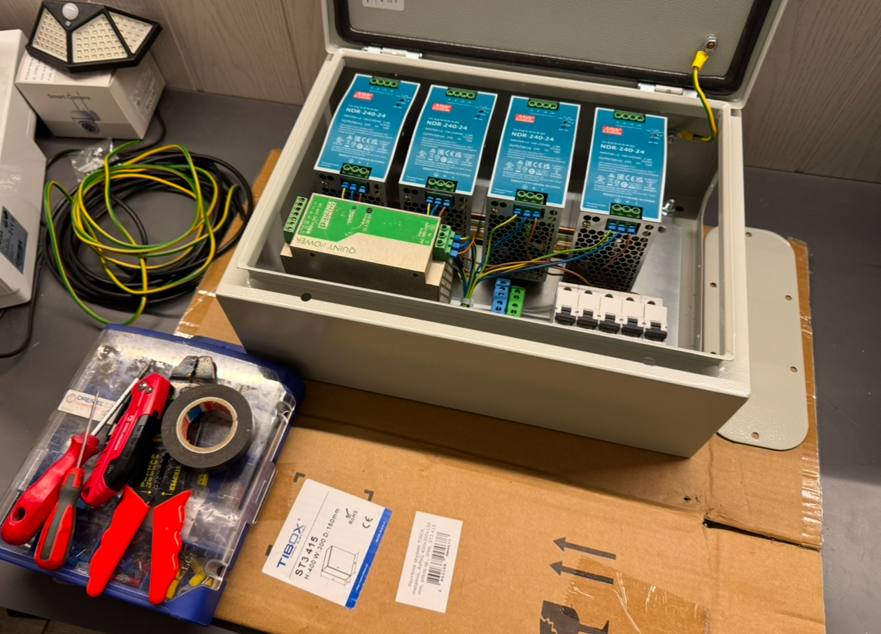

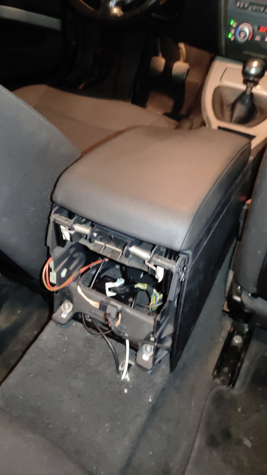

    Keeping platform and body electronics apart, so having two shields. ATM 6bolts and one plug are holding two together.

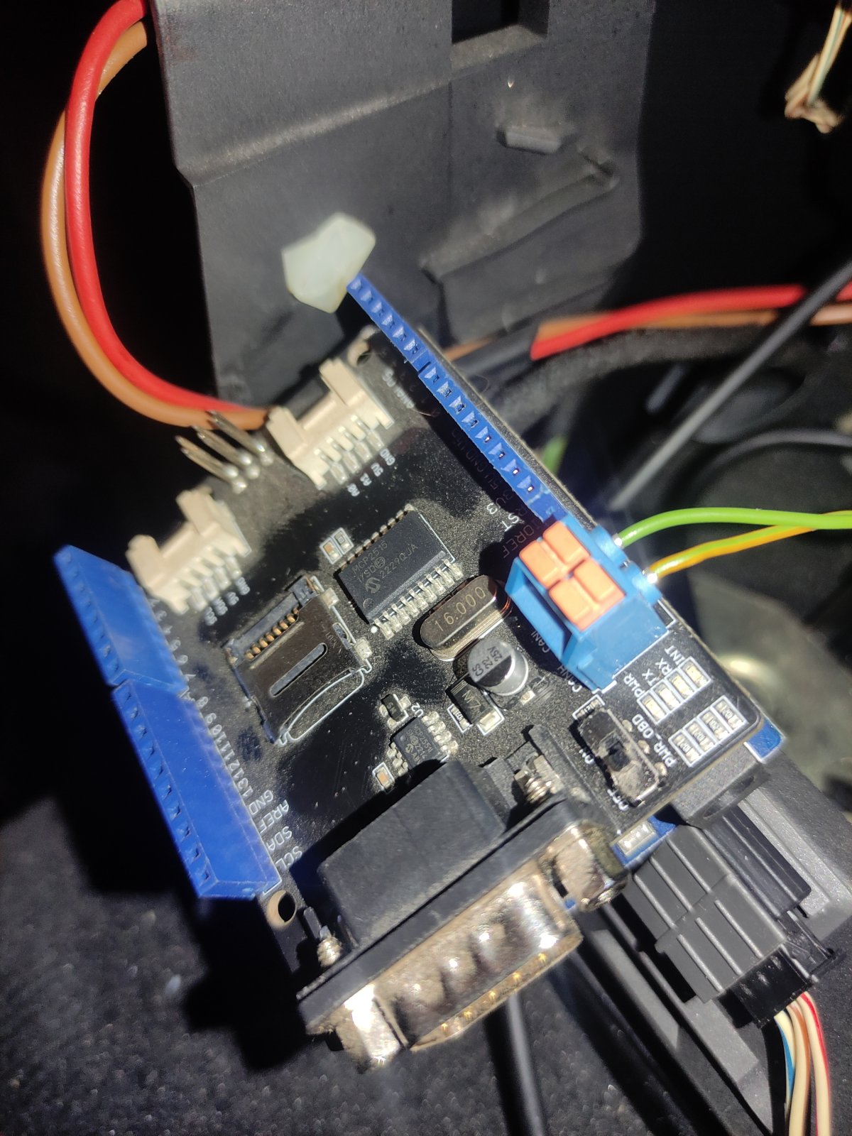

    Most of interaction things are completed. Getting it on cluster canbus trough aigbag module wires. Having ECU gone and not sending signals to cluster makes harder to make AC compressor work, might have to add relays for clutch and vent to start on a same button it stars the mottor to spin.

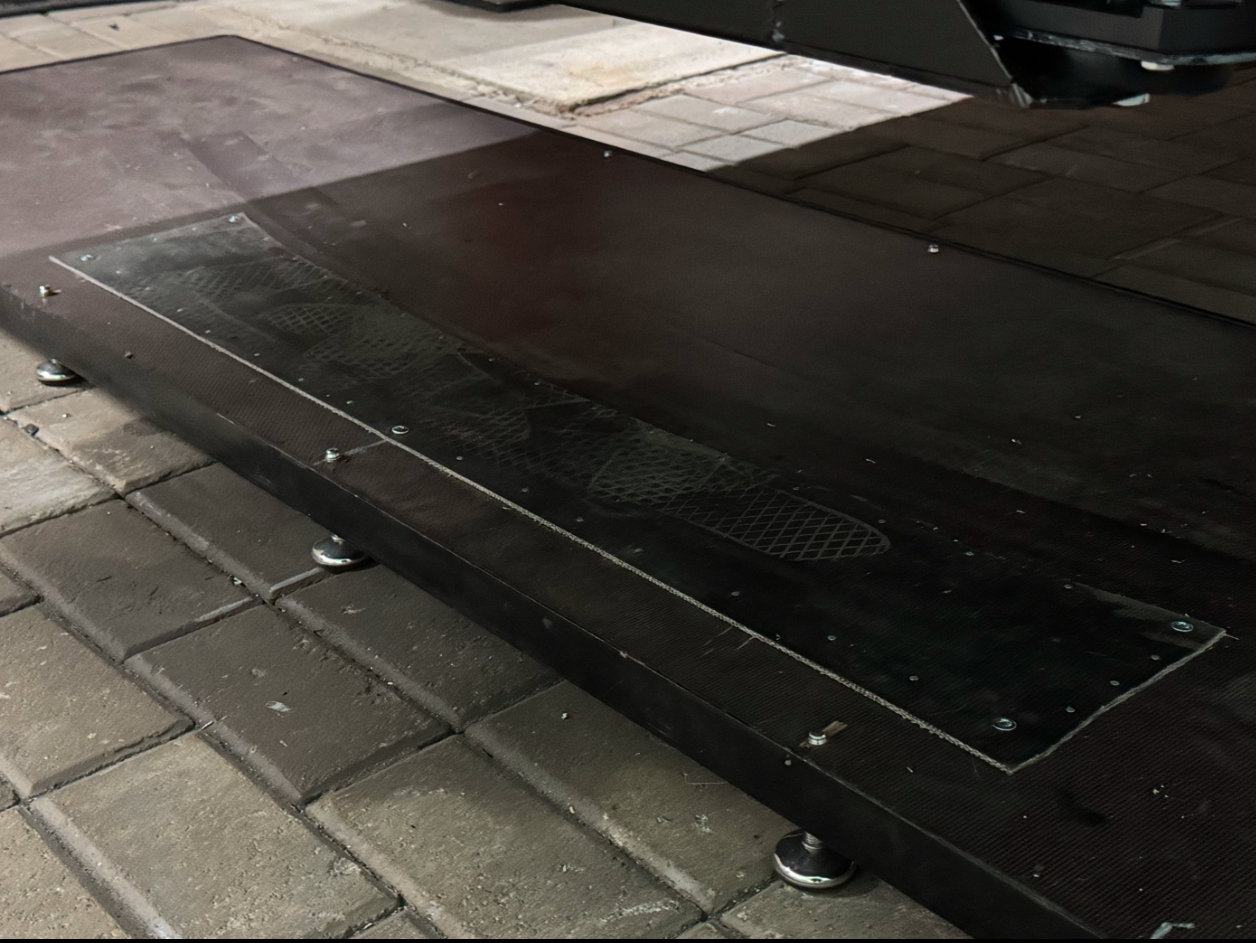

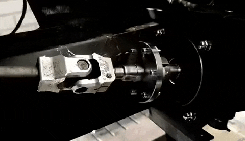

    Having side plate mount and angles it ate always gave squeaky noises. Some time passed and bolts came loose and bruises appeared.
    Swapping it to the end point mount hopefully get rid of them problems.

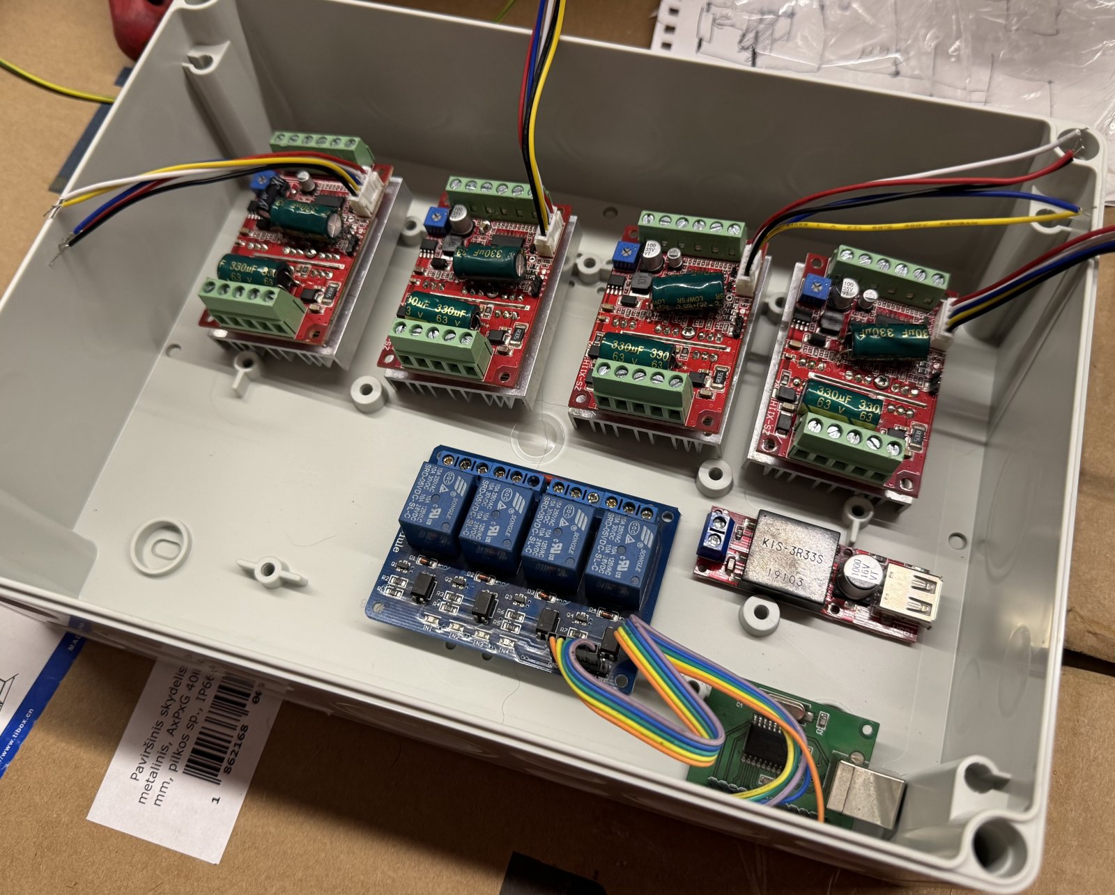

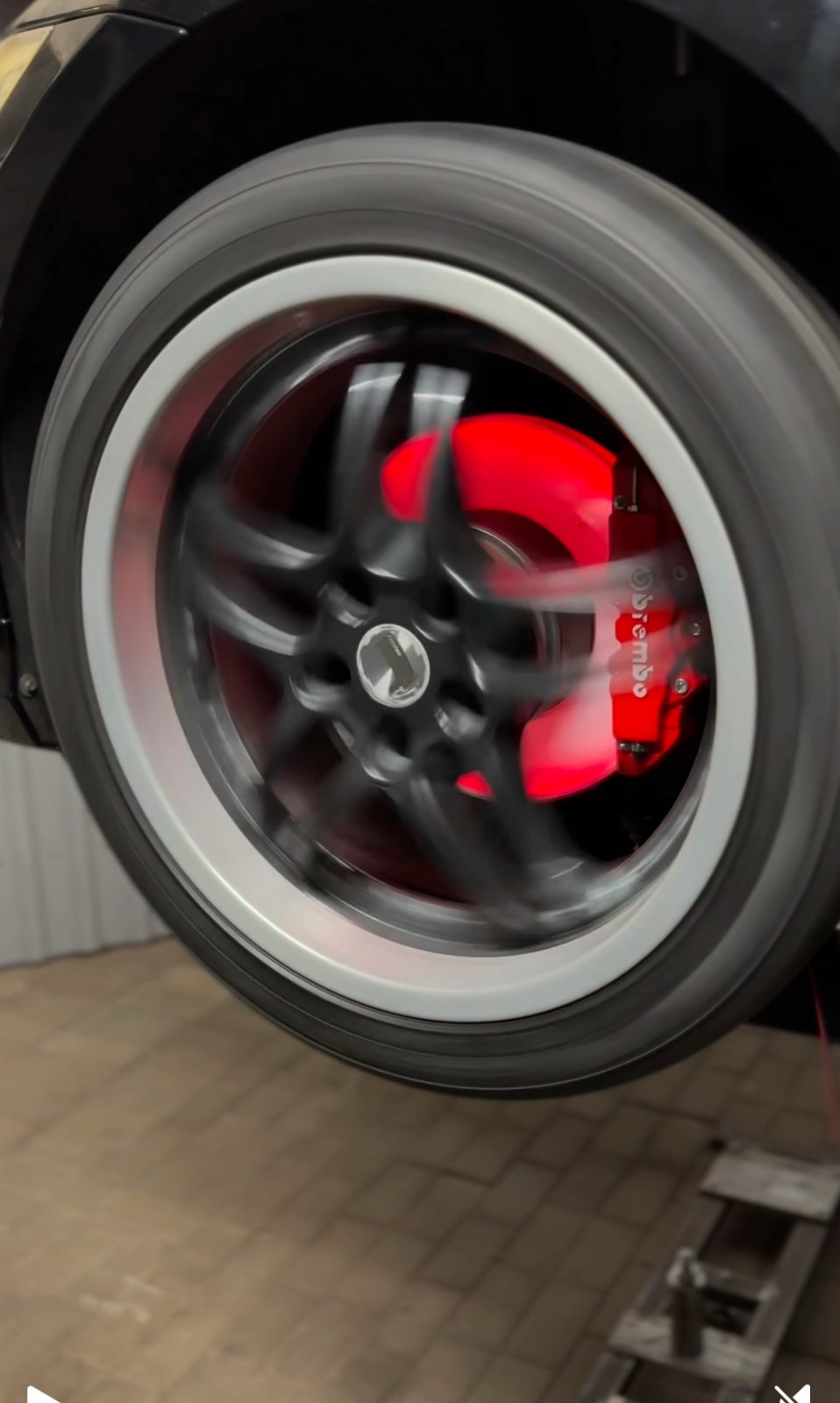

    To finish up things some animatronics for eye candy - wheel spinning and glowing discs. 52 wires + usb coming to control box

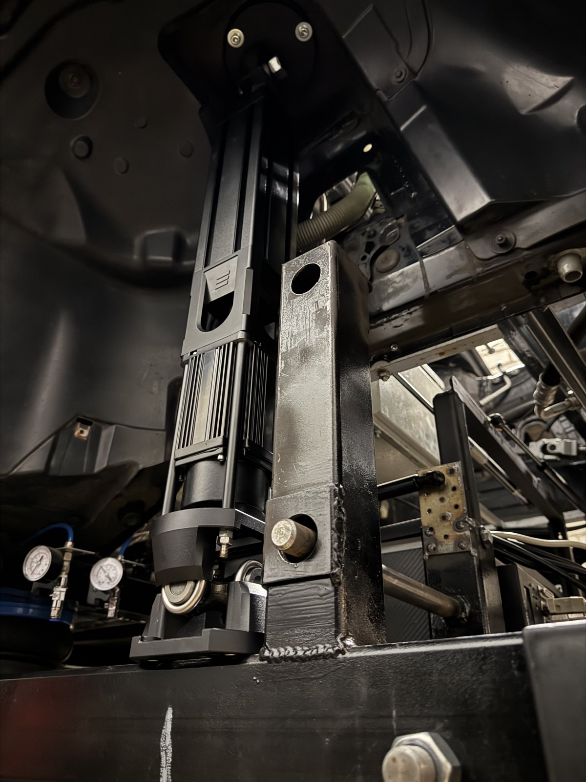

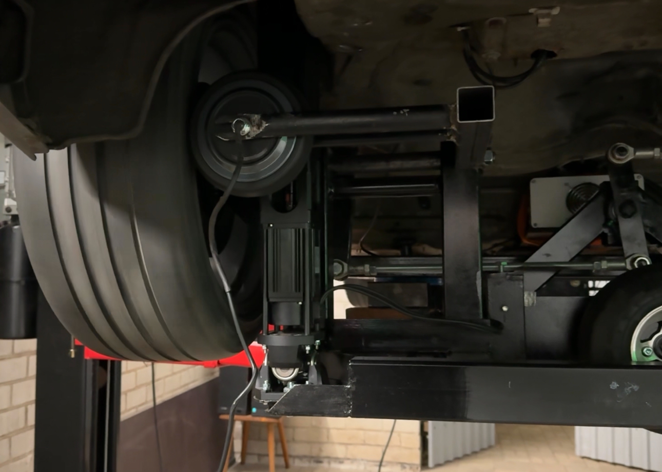

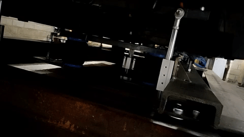

    Actuators mounted this way seem to work much better.

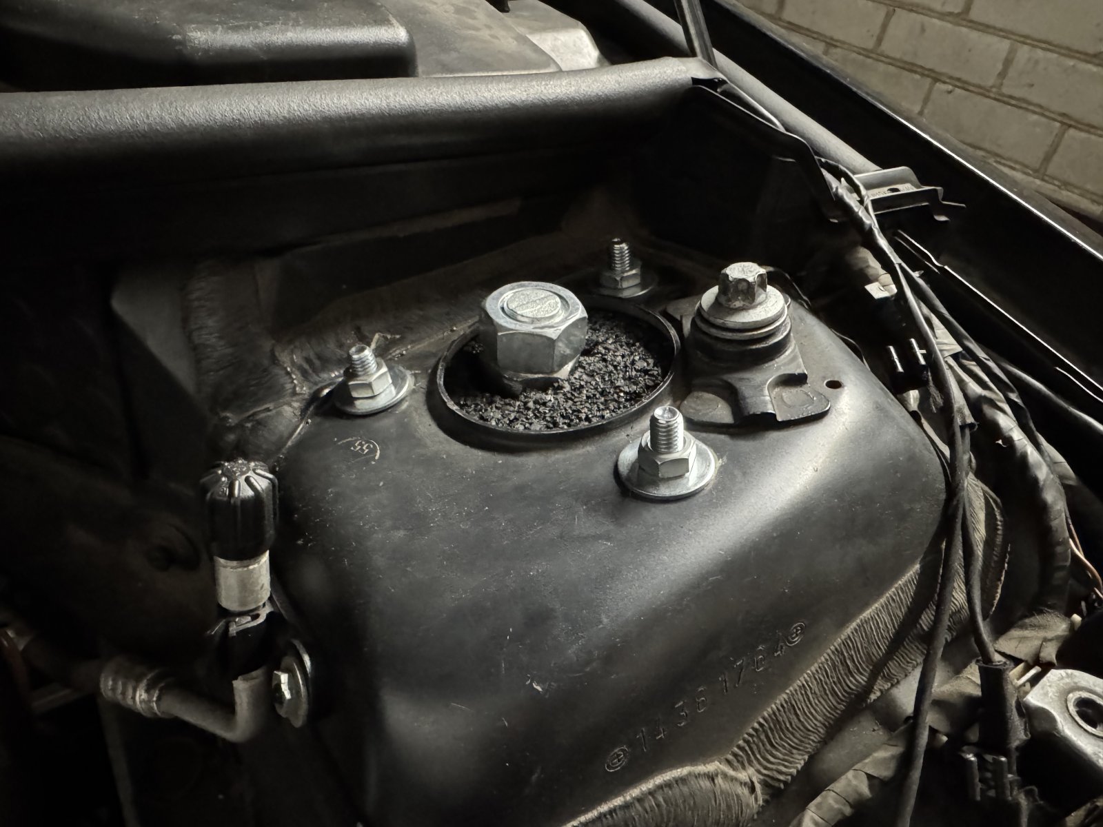

    Still can’t find sweet spot where it feels good inside and looks good outside. I’m thinking of selecting 3 cars with softer suspension and try to find it there.
    For video purposes added TL-sway and not TL itself since AI can’t drift and roller needs some work on itself. Roller wheel have benefits of long travel distance, but issue is with slipping. Thinking of making some rubber to rubber contact pad to increase its speed.
    Over the top thing would be to build a bridge between AASDs torque digits and air spring pressure. Took a little into Festo products and cost of electrical valves for 4 springs adds up quickly. Idea would be to let springs adjust themselves (inflate/deflate) individually after people get it, to give least amount of work to actuators to deal with.
    besides that Im just happy it works as it is right now :)

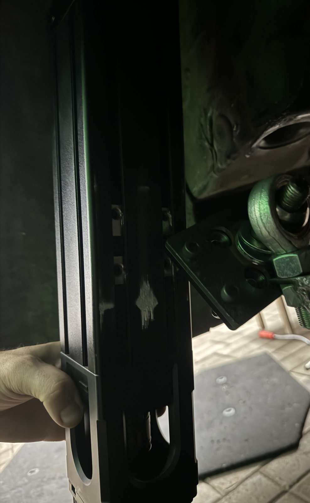

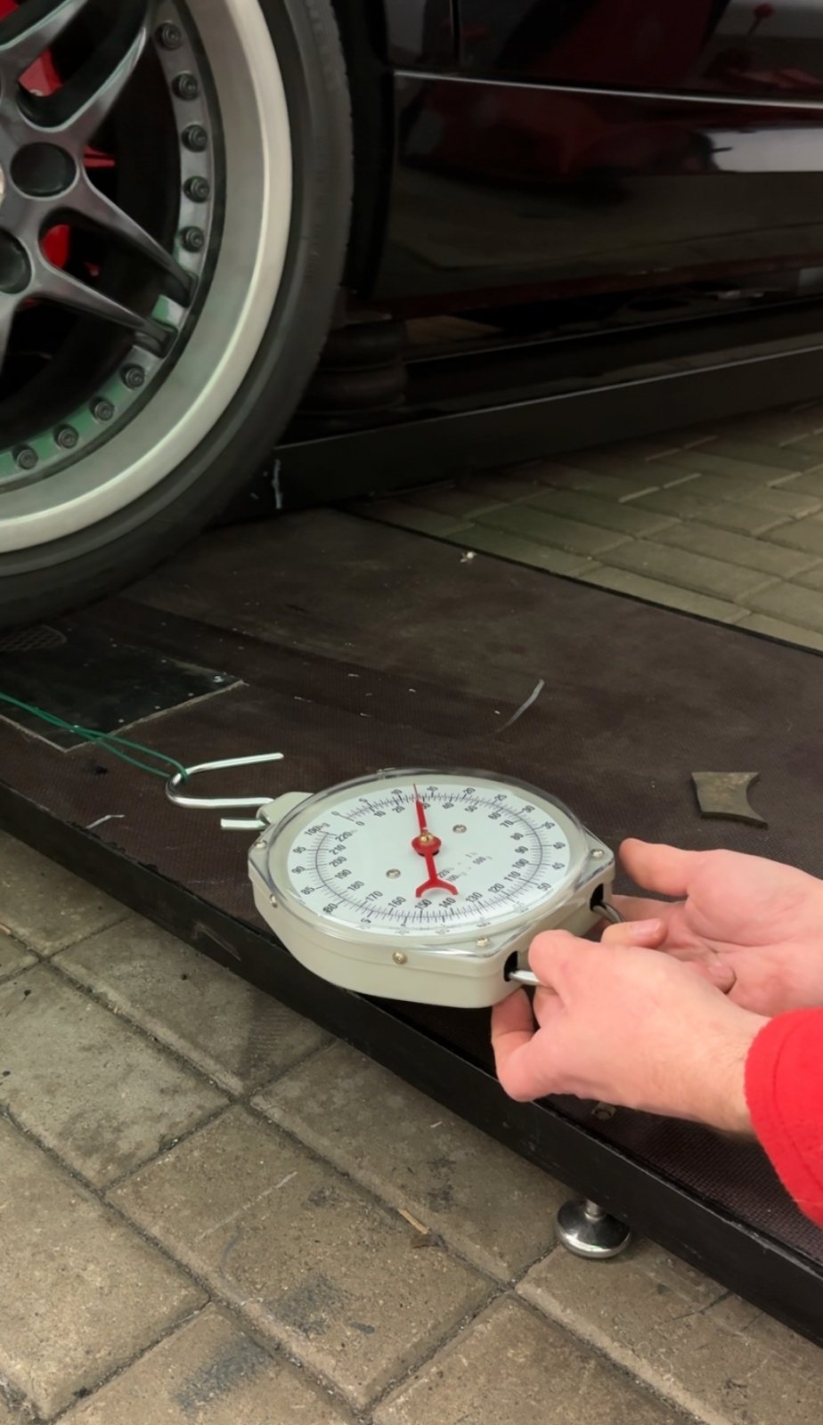

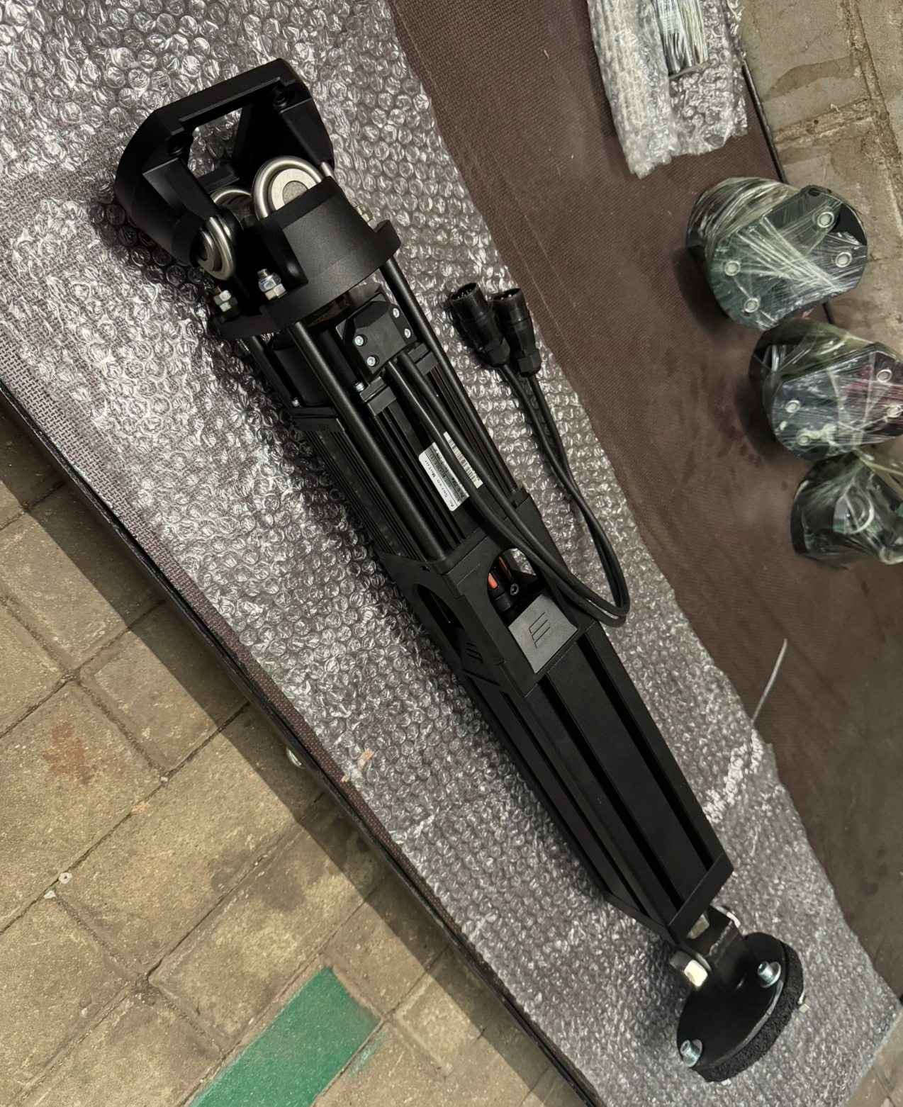

    After adding rubber pad and pushing wheel as much as possible contact was certainly increased. But there are two other problems.
    One is rubber to rubber contact getting even the tiniest slip produces really loud noise.
    Second - moving actuators gives platform base kinda oscillation, because tyre full of air cannot hold a position. Even when parked at zero TL dances around and driving feels like back of the car contantly-ish sliding due to tyre deformations.

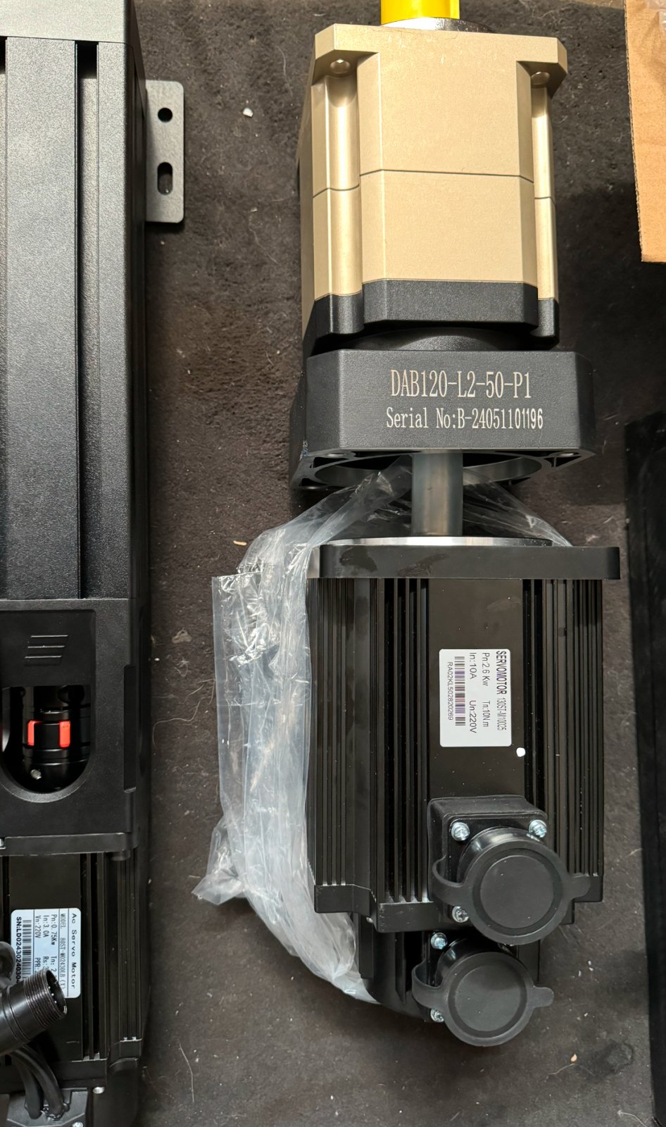

    Before trying something else, like actuator for TL, I’d like to try what I have - 2600w 10Nm m10025 and 1:50 reducer with lever on it.
    Here i come to the problem of measuring anything that could help to determine what loads gearbox will experience. I’ve measured friction F and it shows approximately 20kg at the point where gearbox shaft would be.
    The back of the car is on pivot wheels (yellow).
    Car itself is massive (800-1000kg), with approximately 60% of it at front and rest is at the back.
    I was optimistic at the beginning and envisioned 12 inch lever, but probably should start at .. 6?
    Is there any other way than trial and error to estimate lever length (asking due time consuming process placing gearbox)?

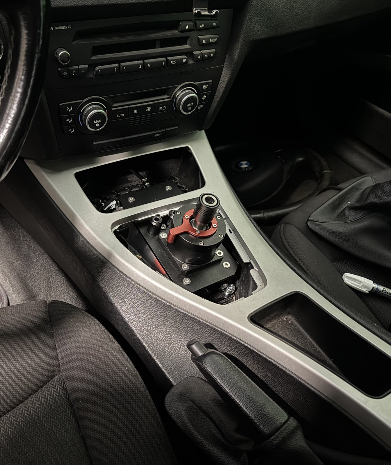

    Beamer got a shifter upgrade, happy for what it came to be. Its simvertex v7. Unlike fanatecs shifter this one fits inside for sacrifice of ashtray internals. Therefore it does not require extension and is easy to access to lube it up.
    There is plenty of adjustment (had fanatec all the way up in resistance, still was missing some).

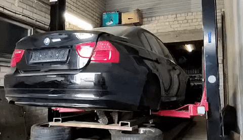

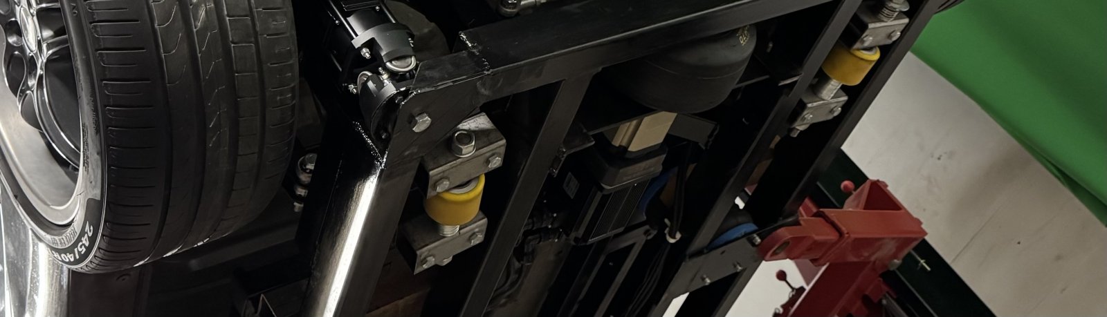

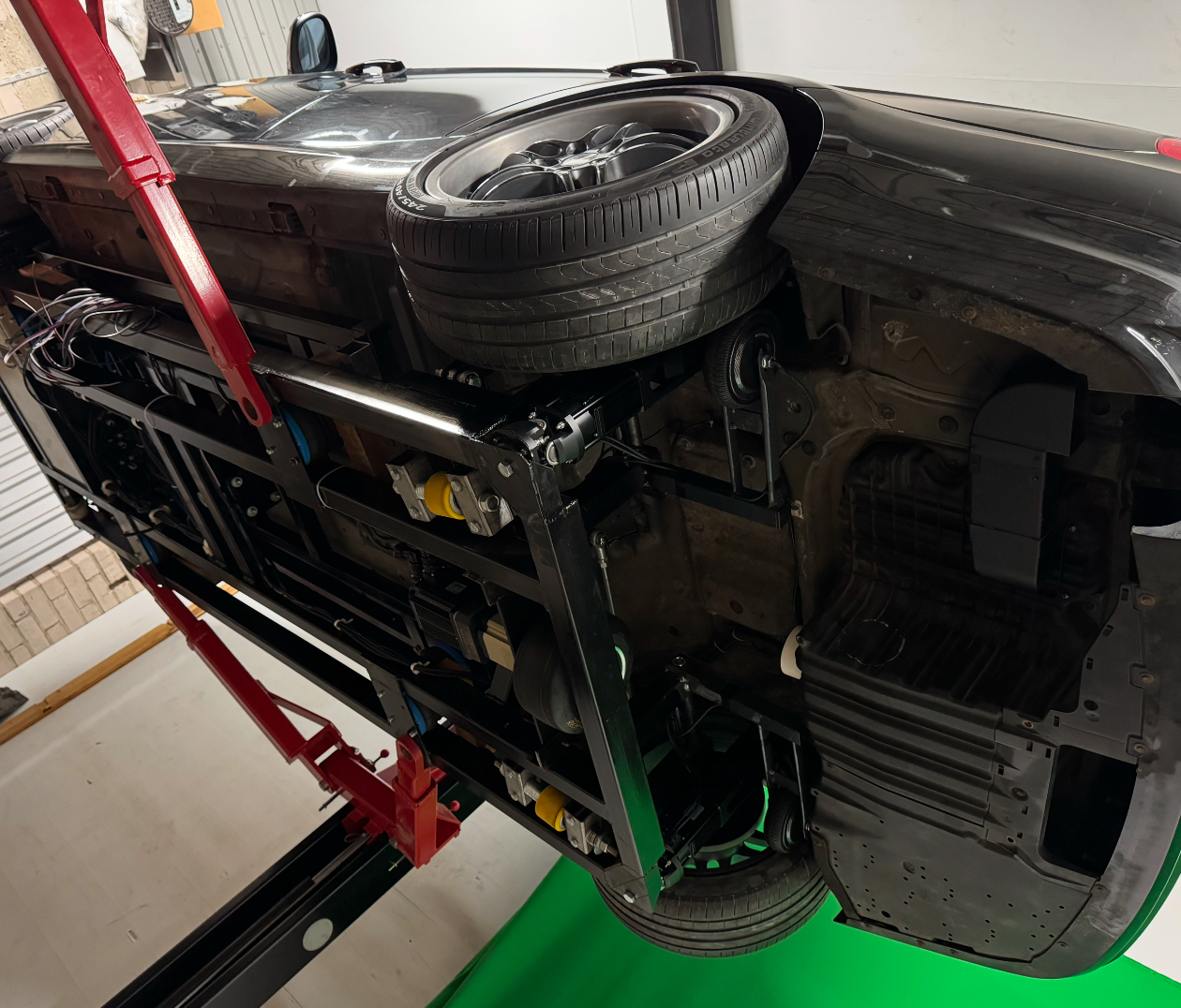

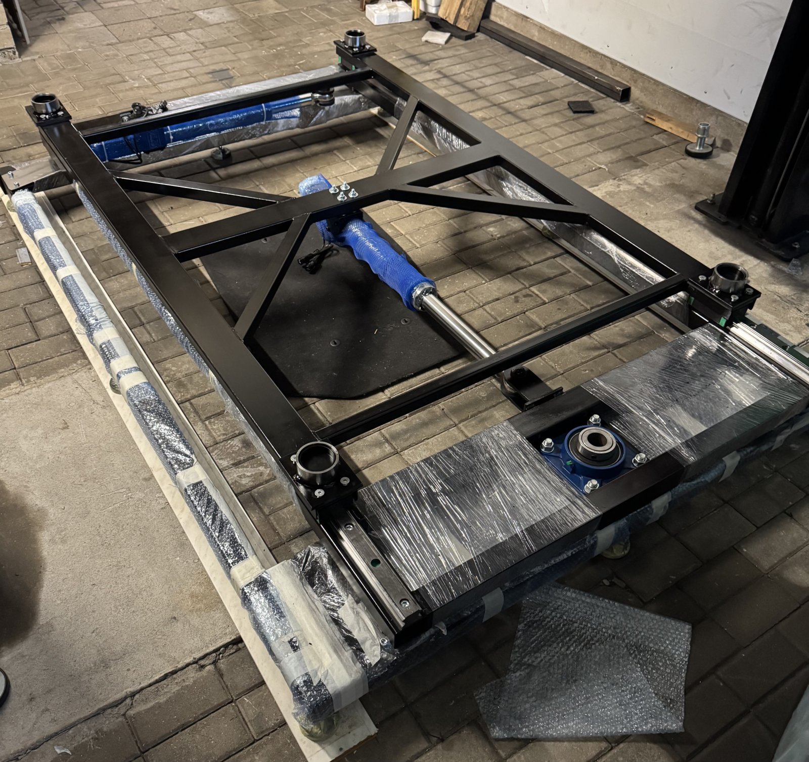

    Had a chance to weld up some frame for PTs 4+TL+Surge. Body already had legs mounted, most of the parts was handed, just enjoying process.
    This body is cut up and much lighter (+\-300kg) compared to full. TL moving resistance is 6kg compared to 20kg. It seems actuator has no problem whatsoever moving this weight quickly.
    Probably hardest thing here was keeping linear rail parallelism. Carriages requiring least amount of precision in their class helped but still it a lot of time time to get precision fit. Metal guy refused to weld some frames and learned quickly why so - welding warps pipes. Its either getting welded frame to some large mill to shave warps off, getting all pipes on bolts and shims or in this case, playing long game with heat. Despite some tension left, I think it turned out great, top layer gets on carriages, screws go in easily and it does not add no resistance to movement.

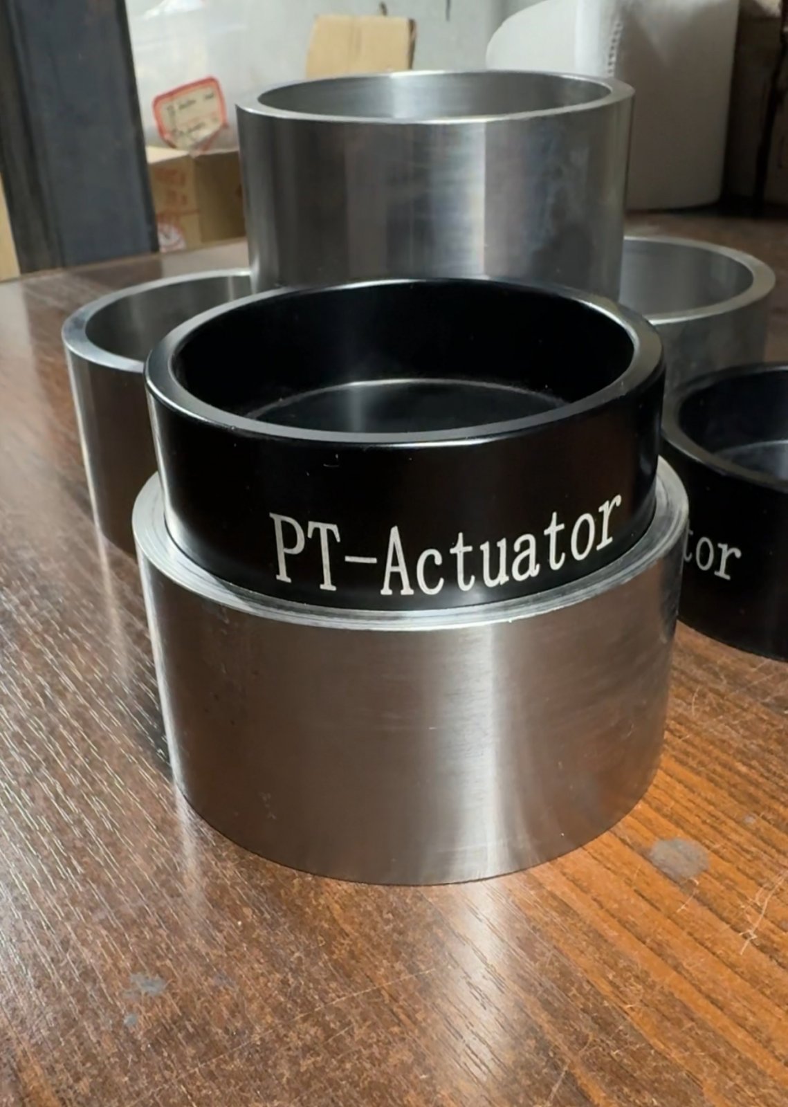

    Cups went into rings and was welded on plates when legs were already resting at center. All legs has some drift off center (.2-.7)and I bet its incredibly hard to get them at perfect center +/-0.1. Due to this total travel will be reduced a bit just to play safe.
