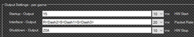

    I'm running the game dash with PCARS as game (well patched) game dash is showing values for dash #1 to #6 (almost).
    The display shows parameters such speed multiplier, number leds activated or selected state for display but it seems it never write values to tm1638..
  15. vthinsel
    vthinsel Well-Known Member
    Feb 20, 2015
    439
    FRANCE
    6,050Coins
    +569 / 2 / -0
    Arduino, 4DOF
    Check your serial output settings (port, speed) and the output settings
    You can also use the arduino serial console and send data such as :
    The command will be processed when a new one starts. For example, RPM will be updated on the module once a new command such as S will start
    Serial data to start with max luminosity set (5), speed=95, RPM=4250, gear=2 (last caracter is to finish processing of RPM, can be anything except a digit)
    Y5S95G2R4250R
    If display is not updated using the console, it probably wont with the game launched either.

    I tried to move the wires with my hand to be sure there are no false contacts but nothing happens.
    Also, I tried to send packet through Arduino serial command and also nothing happens (the display still displays left & right selected state and parameters)..
    Here is really what's happening (yes, I've the 3641AH with red leds but updated the for loop with code shared previously).

    Arduino/TM1638 links look good as the display is updated with cardashx text. Good. Are you running a race or a practice session ? We noticed that the current plugin works only in practice session. I'm currently working on a new plugin based on UDP data sent by the game (PC/PS4/XBoxOne)
    Beside that, if when using the arduino console nothing is updated this means the problem is somewhere else. in the arduino code, uncomment the #define DEBUG line and upload the sketch. Then the console should be more interesting. Please note that running a game (PCars) with debug mode will fill the RX/TX buffer making the display behave strangely. DEBUG is to be used only with arduino console
