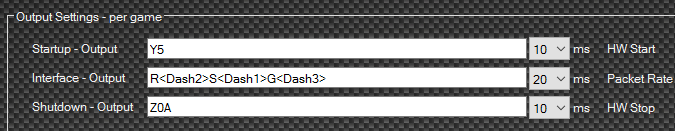

    thx this i have make but the problem iss the same.
    in the game dash tool i have signals but it comes nothing at the arduino.
    and i becomm the skript not load on the arduino

    Gamedash setup looks OK, I see you are running Practice mode (in Race the dash is not working).
    Do you use Simtools only for dashboard?
    Do you have any Axis / Motors set in Interface tab in GameEngine?

    I got this issue once. You must have GameEngine fully working with interface settings / axis assignments fully working. Does tuning center report values ?

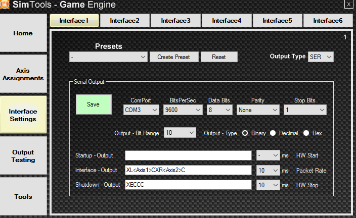

    I was actually in quick race mode. I'll try in practice mode as soon as I can.
    Yet, I use only SimtTool for the dashboard but I achieved to get it working with another ino code.
    I have 0 DOF but configured Interface 1 like this :

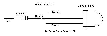

    Are your leds single color or dual color ? My code handles dual color.

  12. insanegr
    insanegr !N$@n€
    Jan 14, 2014
    503
    Athens
    16,726Coins
    +499 / 1 / -0
    dual colors LED have three pins and single color LED have two pins.look at the backside of the TM1638 to see how many pins you have and will see if they are single or dual color LED

    I get something to display only when writing command DATA through arduino console with 115200 baud rate set.
    If something different is selected as rate, nothing appears.
    So this parameter let met think that the problem could be GameEngine parameters so I changed to 115200 too but no more...
    Maybe Game Engine parameters have to be set with some data specific?
