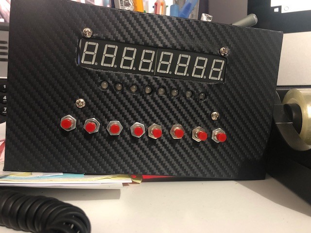

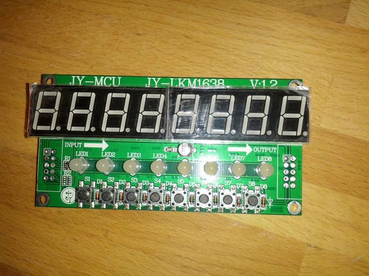

    hello, I like this project I have the display JY-LKM1638 I made the connections in my arduino nano, install the sketch to this point all right, in the simtools game dash I put the configuration as such as detellan in the tutorial, the display starts showing well cardash in the 7 segment displays. when i enter the game pcars2 everything in simtools works but the display stays off. I need to know if there is another configuration to do. I hope someone helps me.

    Hi. Have you configured properly gamedash settings and enabled it in the game plugin settings ?
    You can use a terminal to send Y5S95G2R4250T5000L3P12R for example to make sure that everything on the arduino side (if you get cardash displayed, chances are everything is OK but you never know).

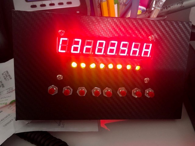

    when I connect it starts normal it presents this screen that says CarDash as in the photo.

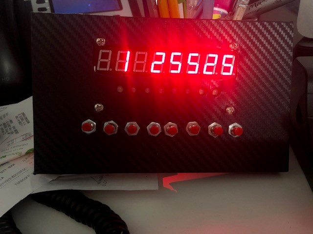

    then it appears on the screen 1 25525 as in the picture I sent you.
    When I start the project cars or the code that you sent me, the displays turn off as in the image

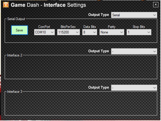

    I sent you photo of the gamedash configuration
    I hope you can help me with this topic. I did a test from simhub and it works fine. 3.jpg 1.jpg 2.jpg 4.jpg 5.jpg

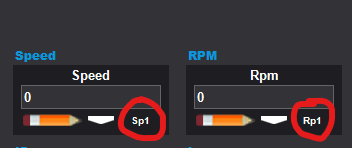

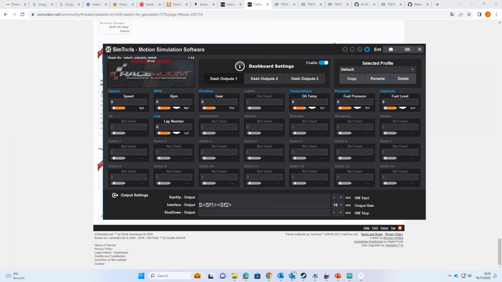

    thanks but Dash in V3 has different commando's in the interface output settings, right? This the screenshot for Wind simulation.
  17. vthinsel
    vthinsel Well-Known Member
    Feb 20, 2015
    439
    FRANCE
    6,058Coins
    +570 / 2 / -0
    Arduino, 4DOF
    The command name may have changed, as the v3 plugins are a full rewrite of the v2. except the names, everyting is the same

    @yobuddy @value1 what are the new command names for Rpm (v2 v.s. v3) thanks Hans
  19. vthinsel
    Feb 20, 2015
    439
    FRANCE
    6,058Coins
    +570 / 2 / -0
    Arduino, 4DOF
    The names are displayed here:
  20. hansvdm
    hansvdm Member
    Sep 21, 2023
    57
    Freelance
    leiden Netherlands
    111Coins
    +11 / 0 / -0
    yes I have tried but for Speed it is Sp1 but that is not working you have to use Sf1. Don't ask me why it is Sf1, saw it somewhere in one of the other posts.
