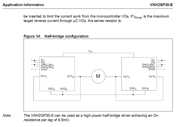

    Oh.. And 2 of them catched fire.. Yay :grin

    Hmmm, I going to sound like a nay sayer but here you go....
    The MMs aren't designed for heavy and sudden reversals, most commercial/industrial h-bridges are designed so it brakes or pauses the motor before reversal
    Doubling up a MM will NOT allow you to control 60amps, it will however half the combined RDson resistance.
    The big drawback is that not all mosfets will turn on at the same exact time, there will be some difference in turn-on time.
    When one mosfet turns on before the other that single mosfet will take the FULL load, when the second mosfet turns on it will share the current but only if the first mosfet has not tripped the overcurrent and shutdown. If the first chip has shut down and the other mosfet turns on it can't handle the current either so it shuts down the second chip or if the first chip comes back on in time it will share the load. Best case sceniro is both chip's mosfets turn on close enough that it will share load without tripping.
    Why does RDson resistance halve? just like putting 2 resistors in parallel it will halve the resistance but not double current due to the above switching mosfet scenario.
    What is the advantage of halved RDson? well the heat generated by the mosfet is due to the mosfet's gate resistance called RDson, each H-bridge has 2 mosfets, a high side and low side. ST state that the VNH2S30sp has a RDsHon as 28miliOhm and a RDsLon of 10miliOhm, as I said above bridging 2 chips halves RDson resistance which translates to sharing the heat load making it easier to get rid of the heat in the chip as it is idealy shared by 2 chips
    How much current will 2 chips are bridged? thats a bit of a curley one, it mainly depends on the gods and the MAX current one mosfet can really handle till the second mosfet turns on. It will NOT be anywhere close to double amps as you have to get rid of the heat generated in both chips.
    Bridging 3 or more MMs together is a very bad idea, why? Well now not only do you have slight differences in mosfet switching you will have the added signalling delays due to slightly different lead lengths and be certain that one mosfet will not handle 90......120A.

    I suppose if you go and try many different MMs you may get a combo that will work but its a trial and more error thing.
    Also, soften up your profile enough so hard reversals and acceleration don't overload the MMs
    @OZHEAT why would "ST" say to use them as a full half bridge in the spec sheet if there were problems with mosfet timings ?
    They be like "Yeah use it as a Full Bridge but ya takes ya chances with it blowing up"[/QUOTE]
    Hmmmm, lets see what ST say in their VNH2sp30 data sheets.
    Look at the note in above pic. Although they use their 25degC ratings of Ron(Hs) 14mOhm and Ron(Ls) 5miOhm giving a total per leg of 19mOhm. Bridged h-bridge gives 9.5mOhm which is exactly HALF.
    You seem to think it is a viable thing to counterfeit the VNH2sp30 chip, how many do think they sell?
    These h-bridges have a very, very limited market compared to consumer goods.
    It is however viable to just buy the real chips from ST and produce a pcb board. I do take note that you say it cost YOU twice as much for a VNH2sp30 than you spend on 2 MMs BUT manufacturers don't buy in single quantities, rather they would be buying reels and reels of them and that would bring the cost per chip down to 30-40% of the single piece price.
    If anything it would be the construction of the MMs that may cause a fault, mainly the thermal transfer pads may not be fully soldered between the chip and pcb.
    As a final note Pololu don't rate their VNH2sp30 carrier boards as 30A cont like sparkfun. They rate their VNH as a 14A cont, 30A MAX pulsed.
    Have a look at this page by pololu https://www.pololu.com/product/537
    cheers

    @OZHEAT oh my, where have you been for the last 18 months.................
    "If anything it would be the construction of the MMs that may cause a fault, mainly the thermal transfer pads may not be fully soldered between the chip and pcb."
    Really ????? finally we agree on something, however internal shorting of the chips has nothing to do with heat pads or resistance per leg , the problem is the chinese either cloning or buying b-grade chips.

    @SilentChill Chips shorting is the symptom has EVERTHING to do with the RdsOn, current and the heat of the mosfet's junction.
    If the chip can't get rid of the heat caused by the mosfet's junction resistance it will get to a point it will overheat and start smoking.
    B-grade chips? why would ST sell faulty/subpar chips especially when they have their logo on it, wouldn't that run the risk of getting a bad rep for dodgy chips... get real.
    Look at the VNH2sp30, its design is to get rid of most if not all of its heat through the thermal transfer pads and anything on the case is supplemental.
    If you don't think the pads are important, think of it this way. what transfer heat better, plastic/epoxy or continuous metal leads/pads?
    Add to that the copper track/pad of the board used as a heatsink/heat spreader.
    I can see how soldering the board being difficult and looking at you pics they do kind of look cold especially the transistors.
    Soldering the chip wouldn't be the same as most surface mount due to the thermal pads and heatsink copper taking a lot longer to heat than the leads and other components.
    Maybe reflow the boards adding a little solder paste to the pads best you can and preheating the pad area of the pcb with a heat gun before placing in the oven.
    As for my experience with these boards is NIL but it doesn't take an EE to see in your pics that what is happening to the chips. Blown mosfet junctions and arcing.
