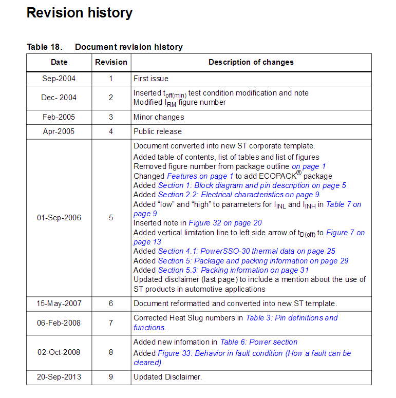

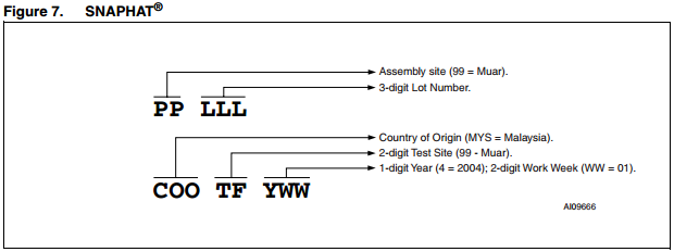

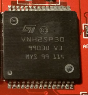

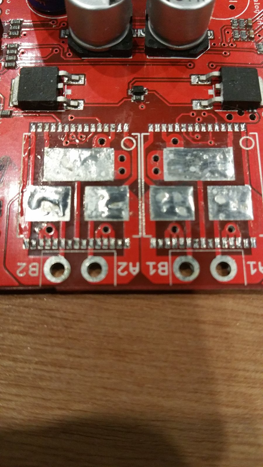

    So a little further investigation I have found how ST can trace the chips with the codes.
    So lets look at this chip
    So we can see from these chips they were assembled at 99 "Muar" and the 3 digit lot number is "03U"
    Country of origin MYS is "Malaysia" and the test site 99 was "Muar".
    Now this is where I'm kinda lost, the year says "1" which I presume would be 2011 not 2001 however the chip didn't start manufacturing until 2013 that I can gather.
    The week number is "14" which makes sense.
    Now am I just being dumb or have I missed something so simple ??

    I think you have it right except the chip started manufacturing around 2004.

    Ahh nice work @BlazinH, I was just going from the date of the last datasheet. So they did manufacture the one above in 2011 which would make sense, however it was sat around for 4 years until it got into my hands.

    I have removed alot of the chips and I have reflowed them myself seems around 240-250 degrees is just about right for me. I have removed solder and added solder which ever the chips need.
    I also have run the iron over the pins too to make sure they are all nicely joined. pain in the arse but seems I'm getting somwhere.
    I have to disagree that the chips aren't faulty as I have quite a few which just short internally or don't put full power through 1 way replace the chip and the board works fine.
    I've found some with no solder at all under some pins and on the heat slugs. the quality is just terrible on some of them and it does seem like they are done on purpose sometimes.
    I have now added heatsinks to the bottom of the boards aswell as on the top of the chips. try and get rid of a few more degrees.

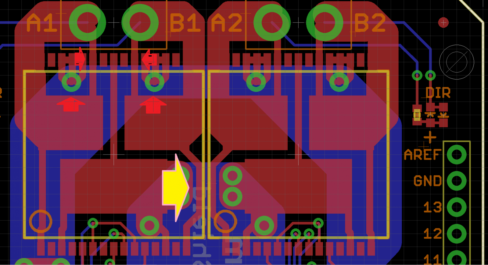

    Oh I forgot, I did look at the board layout and put arrows at high potential locations of the board where shorts could occur.

    hmmm, pic didn't post and I can't find the upload button editing my last post.

    Sorry your shorting points are wrong as the traces run under the board they are not open to contact. I will take a picture for you here
    So again because you don't know what ya talking about your wrong.
    Also different boards have different designs and traces so not all are the same.

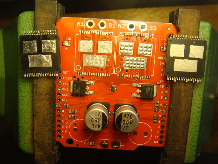

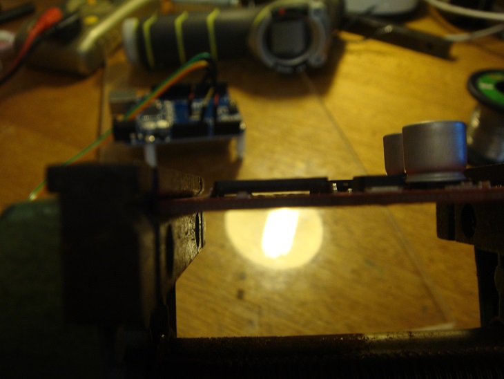

    FI - Some of my old findings in actually investigating faulty MMs are below:
    First image shows how the main pads on the driver chips had not even been flow soldered - looked fine from the outside.
    Second image shows a different board and how some of the chips had not even been placed properly on the board.
    Repaired - it then worked perfectly. Believe me I too looked for a different solution due to the suspect quality control of these boards, but it still turned out cheaper for me to swap out serviceable chips from other boards and I did have a better run of serviceable MMs than @SilentChill. As I have stated before, If you don't have the expertise to change out the chips then I would go the Sabertooth route. More money, but likely less hair pulling for the less technically experienced. Although one thing that I do not like about the Sabertooth driver is that I cannot easily tap into the control signals which I use to feed my actuator limit switches.

    This is for anyone who would like to test their Motor monster "clones".
    It is no secret that the fault rate of these h-bridges is very high.
    Expect to have to rework the board.
    This is a some things of what I would do, hopefully you will adopt some or all.
    1- Fresh out of the packet before connecting any wires inspect the board. the most low level test is using your multimeter on continuity/buzzer setting.
    Test each output A1, A2,B1 & B2 with VCC(positve supply), board ground( top layer) & switched ground(available near each output).
    There should be No continuity between any of them, if you do, you got a short.
    2- If your satisfied your ok, next would be to take baby steps in power testing.
    A small low power dc motor or maybe a car taillight globe for a load.
    For motor power supply, either 5 or 6 AA batteries in series or a light globe between your power supply and VCC, this is so you limit current to the board. You don't wan't to put whatever amps you power supply can handle through a short unless you are intending on sending it back to seller.
    3- The board provides some "features" namely Current Sense (cs1 & cs2) en/diag, use them. If you look for add ardinio libraries search vnh, it will display vnh5019 by pololu. Besides 1 extra pin that the vnh2sp30 doesn't have (cs disable) they are very similar. The demo.ino will ramp each motor back and forth, monitor average current and tell you when a fault is detected reporting to the ard com port. Hopefully someone can expand on the fault report by displaying the states of the different pins instead of just "motor1 fault".
    cbfa ....
    if it tests early on in your testing, rework it. Don't keep going and torture it just to prove it is faulty. maybe a few more chips will survive.

    OK @OZHEAT I had 6 more MM's arrive yesterday and in total 1 board fully worked and the other 5 only one chip out of 10 worked in both directions. There were no shorts on the boards everything checked out as soon as power connected everything checks out ok forward and reverse LED's nice and bright, connect a motor and it shorts out either not working at all or just driving the motor very slowly and the chips overheat incredibly quickly.
    Explain that to me if they are not faulty chips ????
