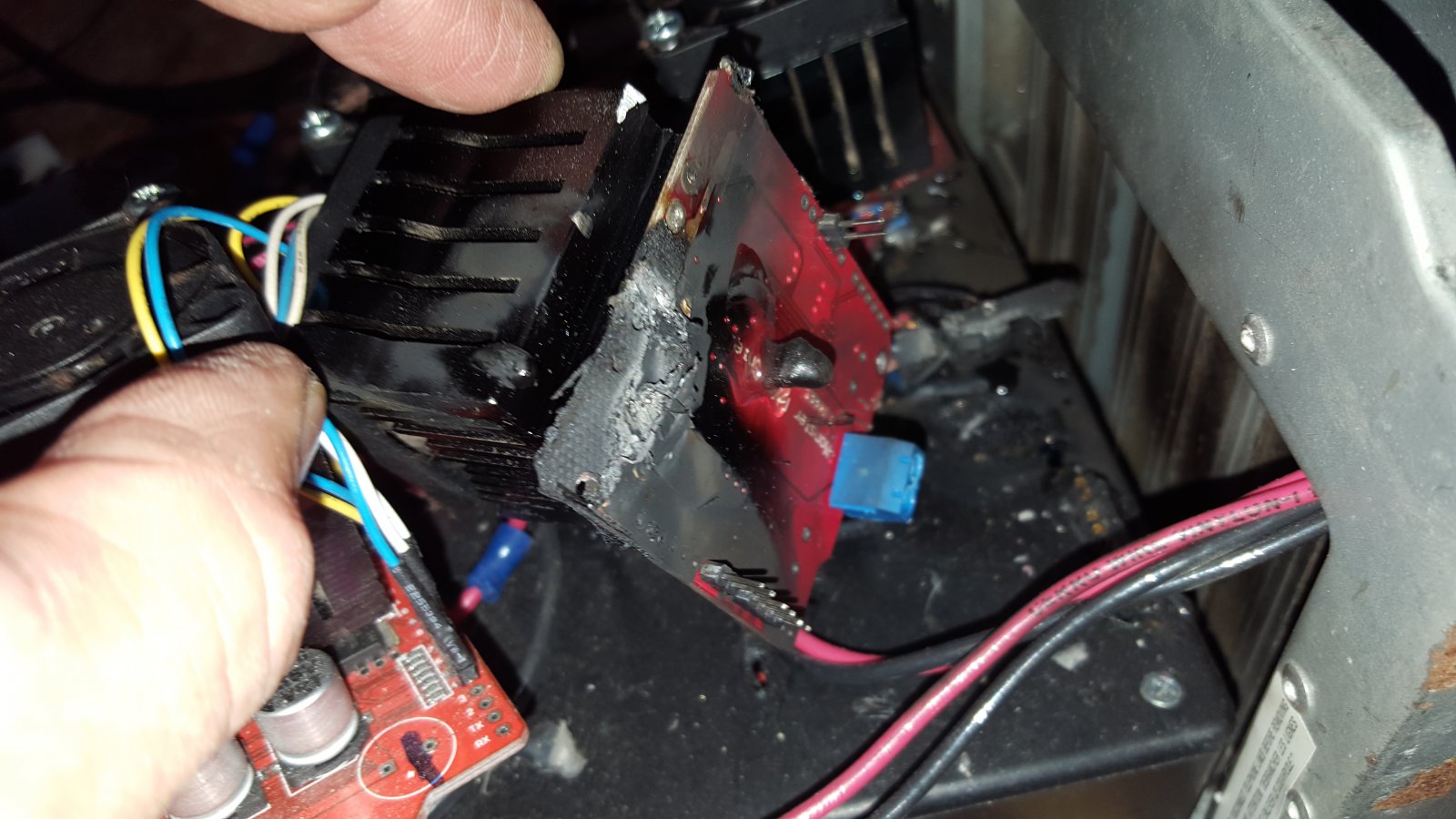

  11. bruce stephen

  12. noorbeast
    21,728
    152,081Coins
    +11,065 / 56 / -2
    Ouch!

  13. BlazinH
    BlazinH Well-Known Member
    Oct 19, 2013
    2,145
    Oklahoma City, USA
    16,665Coins
    +1,839 / 32 / -1
    Did Samsung manufacture that one? :D

  14. bruce stephen
    Jun 7, 2015
    1,286
    general contractor
    michigan
    9,115Coins
    +1,243 / 9 / -0
    maybe just needs a new IC is all. A little reflow and good as new.:eek:

  16. bruce stephen
    Jun 7, 2015
    1,286
    general contractor
    michigan
    9,115Coins
    +1,243 / 9 / -0
    I run 12 cheap Chinese copies with no problems. This was caused by a disconnected wire........
