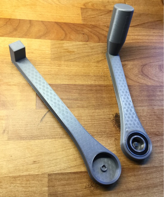

    @Archie - on this subject I'm working on a throttle quadrant at the moment. Its going to be well engineered using good sealed bearings. I can handle the rotation and the hall sensor stuff fine. The problem I have is how to introduce some friction. I did a flight stick and there's no problem there - bit of bungee for self centring, but everything else I want to build needs some friction.
    There's a bearing and a magnet/sensor in the middle of this, so I can't put a tightening bolt in the middle. Maybe a brake shoe type thing with a spring, but there isn't much space below and its getting fiddly. If I do go with the brake shoe idea, any thoughts on a material for it?

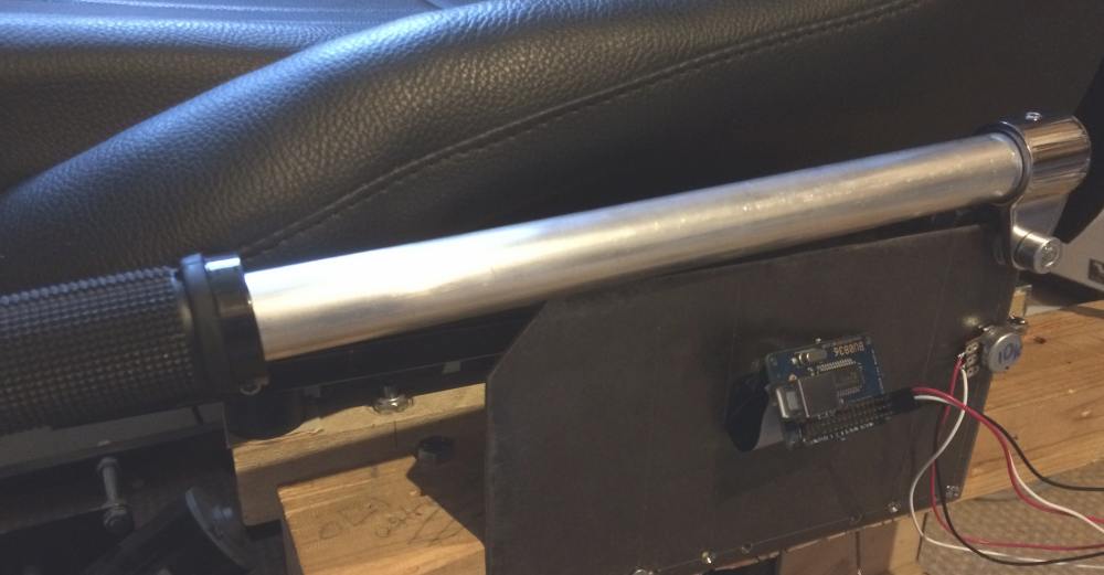

    1. What's your experience with the diy collective so far? Working properly on Sims (like DCS, Xplane...)? Is it really Plug&Play with the Bodnar-Board?
    2. Aren't the nuts/screws of the mating point loosening after a while?
    3. Is it sensitive enough to use a pot instead of hall sensor?

    1. Working properly? Absolutely but I've only tested on FS2. I have x-plane but haven't tested it yet
    2. nyloc nuts. No problem
    3. Very happy with sensitivity, but if I was doing it again I'm now a hall sensor convert and would go that way

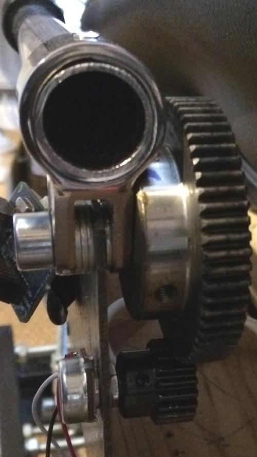

    Thanks for your quick answer. Thought about doing the same with hall sensors myself. But how to fix the magnet to the smaller gear wheel. Would some hot glue just do the job? And would I need plastic gear wheels instead of the metal stuff you used or is that no problem with the magnetic field?

    I'm all about 3d printing now. No need for gear wheels. 45 degrees of rotation of a 5mm3 magnet with sensor held 1mm over it gives plenty of detail with a leo bodnar. Design a 5mm slot for the magnet and print "external perimeters first" and its a snug fit.

    Wow, so you're not using gear at all? Just the magnet fixed to the pivot point and that's it? I'm still not sure about all the metal parts so close to the magnetic field. Don't have any experience with hall sensors. But I'll give it a try. Thanks.

    I got mine for Christmas. My wife likes it. Instead of spending hours in the man cave I spend more time with her on my laptop designing stuff in Fusion 360. Then you set it printing overnight and rush to see the result in the morning like its Christmas. e.g. Spitfire throttle and mixture handles - see where the magnet is.
