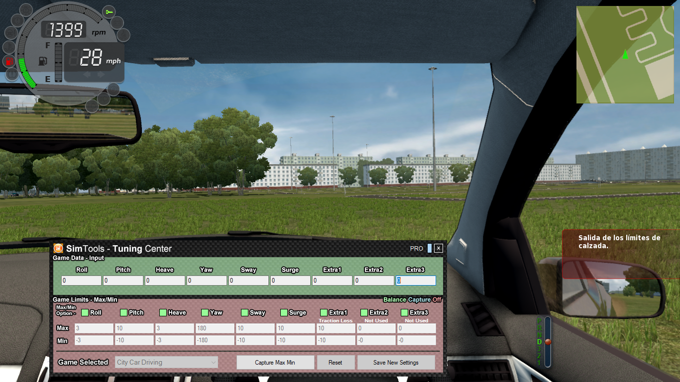

    Hello BrazilianGuy !!!. It seems that they did some update and the plugin does not work, any ideas about what it can be? the manager recognizes the game and turns it on, but I have no movement reading.

    I have exactly the same situation. Repatch and restart doesn't help.

    Great job. Thanks, just checked, everything. Not working Pitch and roll

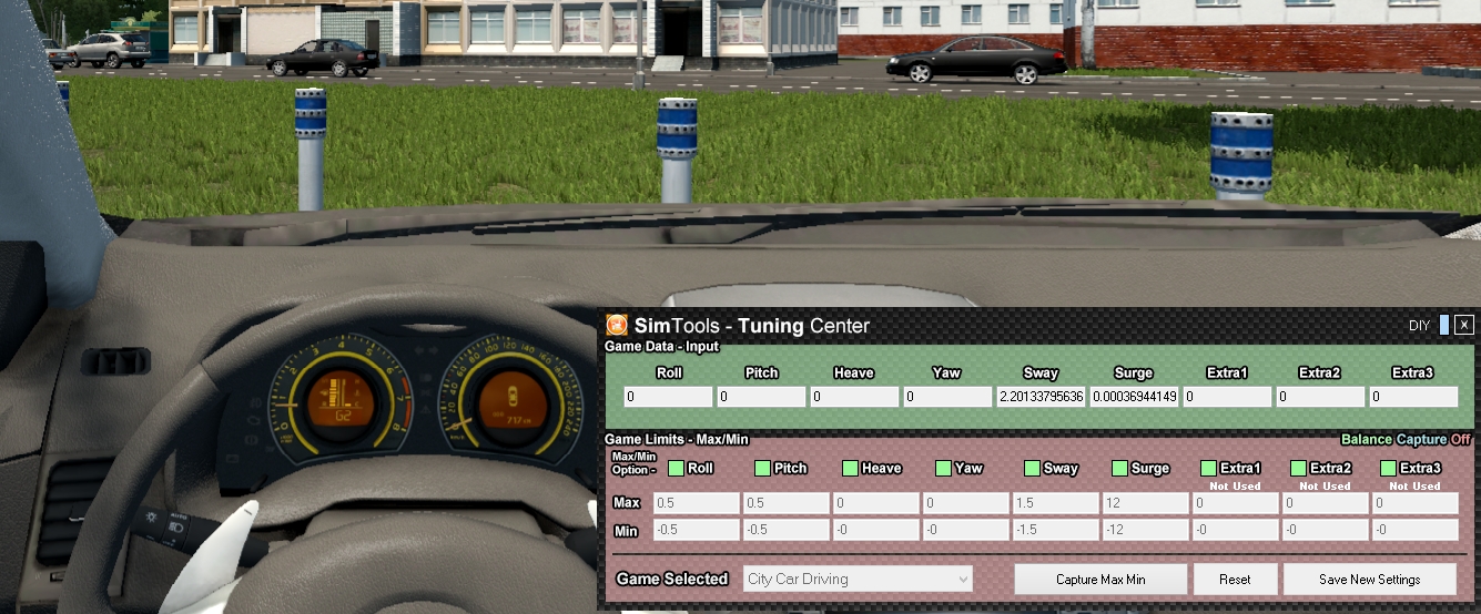

    I have just installed the plugin and I’m only receiving Sway in Tuning Center. Is this still working normally for other users?

    I’ll try the link you gave me to be sure I have the most recent version. I am using that “Brazilian Guy’s” version though. I’ve been getting most of the other plugins working reading back through the threads of each one but this one is fighting me.
    when I select capture settings it is only giving me sway telemetry.
  17. noorbeast
    22,211
    154,729Coins
    +11,213 / 57 / -2
    If only sway telemetry is available a game update has likely broken the plugin pointers and @BrazilianGuy has already indicated he would not be doing ongoing updates.
