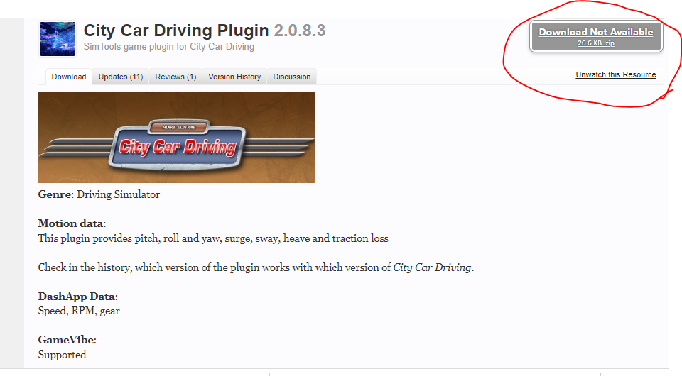

    If @BrazilianGuy or someone else wants to update the plugin for CCD, I have recently found some addresses in the game (Steam version v. 1.5.9.2):
    - sway (should be the same address as BrazilianGuy)
    - surge (seems to work)
    - RPM
    - Speed
    Here is the (human readable) Cheat Engine file.
