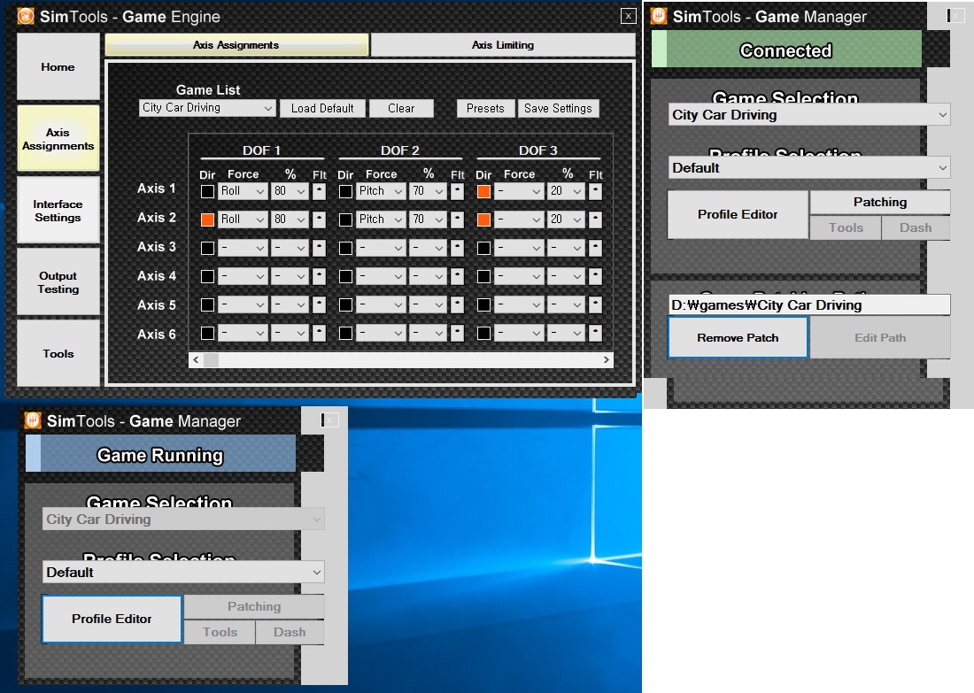

    hi.. mine is v1.4.1 but not work.. any idea?? in tuning center, no data is coming.. but it says game running..

    Have you patched for motion?
    Please post pictures of all your settings.

    here is my settings.
    of course, I did patch, but did not get the message "patch successful?"
    thanks for your "service" in advance

    There are likely a number of issues at play.
    From you settings picture it seems you have the DPI issue, which messes the rendering layout of SimTools: http://www.xsimulator.net/community/faq/game-manager-dpi-fixes.123/
    Second, from the non standard characters in your patch path it is likely you need to change the language settings of your computer: http://www.xsimulator.net/community/faq/language-setting-bug-change-to-english-local.233/
    I can't recall with CCD but for some games Game Manager has to be run as Administrator for patching: http://www.xsimulator.net/community/faq/when-how-to-run-simtools-in-admin-mode.201/
    And last is this a genuine copy of CCD? If not then motion may be a problem.
