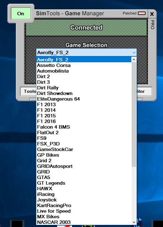

    Hi guys, I have a problem with CityCarDriving_Plugin, basically I installed it with the tool normally and manually, but I do not see it in the game list.

  8. -kevin-
    -kevin- Fast e Furious
    Apr 6, 2012
    249
    Termo Tecnico industriale
    128Coins
    +175 / 1 / -0
    2DOF, 3DOF, DC motor, SimforceGT, 4DOF
    Thanks for the new plugin @value1
    With the new version 1.5.4 I solved the problems, but I only find these values and normal?
    Question: City car drive plug-ins only work with steam versions?

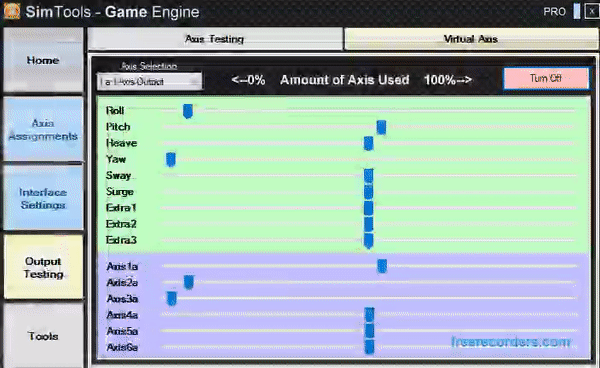

    Hello, how are you
    Can someone help me?
    I tried, several more things here do not move you

    Are you using the Steam version?
  18. value1
    Jan 9, 2011
    2,192
    Zug, Switzerland
    14,294Coins
    +3,363 / 13 / -1
    There just was an update on Steam. This might have crashed the plugin :(

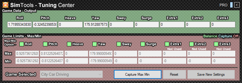

  20. value1
    Jan 9, 2011
    2,192
    Zug, Switzerland
    14,294Coins
    +3,363 / 13 / -1
    It actually works here with version 1.5.4.5 (build 13619)
