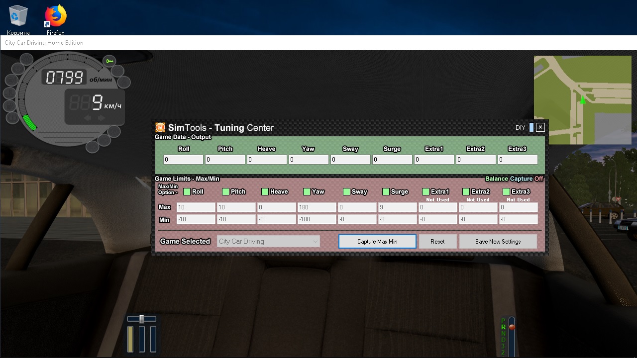

    You can see in the capture,
    everything works, but there is no movement
    Yes it's the same version, which I have
    do not understand!
    pcars, assetto corsa, nolimits everything works

    Hello, I have just updated my city car driving to 1.5.5 but seems its not compatible with the plugin for the 1.5.4.
    Please. when will there be an update for the 1.5.5 version?

    I am guessing it may be a little while before @value1 gets around to an update, because of the festive season and other updates that will be needed for Game Vibe support.

    I just tried un-patching and then re-patching. and that seems to bring it back to life.

    Hi value1, I just changed my system for simtools 2.2.5 because of new CCD 1.5.6 which provides better support for oculus cv1. On simtools 1.3 and CCD 1.4 the old plugin worked but now the last plugin version is not even picking up data from the game (all zeros). Patched/unpatched several times and tried all four v.2 plugins. I am using a russian non-steam 1.5.6. build 16396. "English location settings" bug isn't relevant. Pcars works perfectly. Maybe you can have some suggestions on how to run these new things ? Thank you in advance.

    My guess would be that the russian non-steam 1.5.6. build 16396 likely has different pointers than what the plugin was built against, which is the Steam version.

    Probably...how to fix it? find new pointer and write new plugin?

    Correct, it would likely need to be a new plugin for that version, though the reality is it would be easier to just swap and use the Steam version unless you want to create a custom plugin yourself.

    Thank you for reply. Steam will be not that easy to get because of some conflicts with original oculus software and steam vr (much resourse usage and lagging). Is it hard to write a plugin for a game? Is there any open samples on previous plugin versions here on forum?

    Thank you for help, switched to Stream version - telemetry started to work. Steam VR is not required for this game, by the way. I run it with oculus original app - no lags. Here is another thing with either simtools game manager or the plugin. Processor load of Game Manager while playing Project Cars is 2-3%. But when it comes to CCD the load rises up to 26-27% and this leads to huge lagging in CCD. Tried to decrease priority of Game Manager - same thing. Processor is i5 7300hq (up to 3.5 ghz), gtx 1060 6gb, 8 gb ram. Tried also with No Limits - no load. What can I do here?
