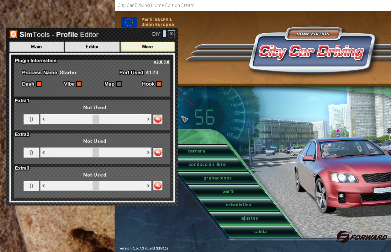

    I have version 1.5.7.3 and I see that in the profle editor uses port 4123, maybe you have to edit that port in the game? Does anyone know where it is edited?

    The challenge is that that the pro version of CCD actually has telemetry support, but the consumer version does not, hence the only way to have motion is via the hook method of plugin, which breaks with game updates.
    The basics for learning plugin skills and the tools needed are in the FAQs, but it takes a fair bit of effort and commitment to master and become proficient: https://www.xsimulator.net/communit...lugin-for-simtools-2-0-api-documentation.131/
    It would be possible to implement the same sort of process that is used for Elite Dangerous, where an offset file can be updated with new pointer values, rather than the whole plugin. But there still needs to be a strong commitment and skill to keep it updated.

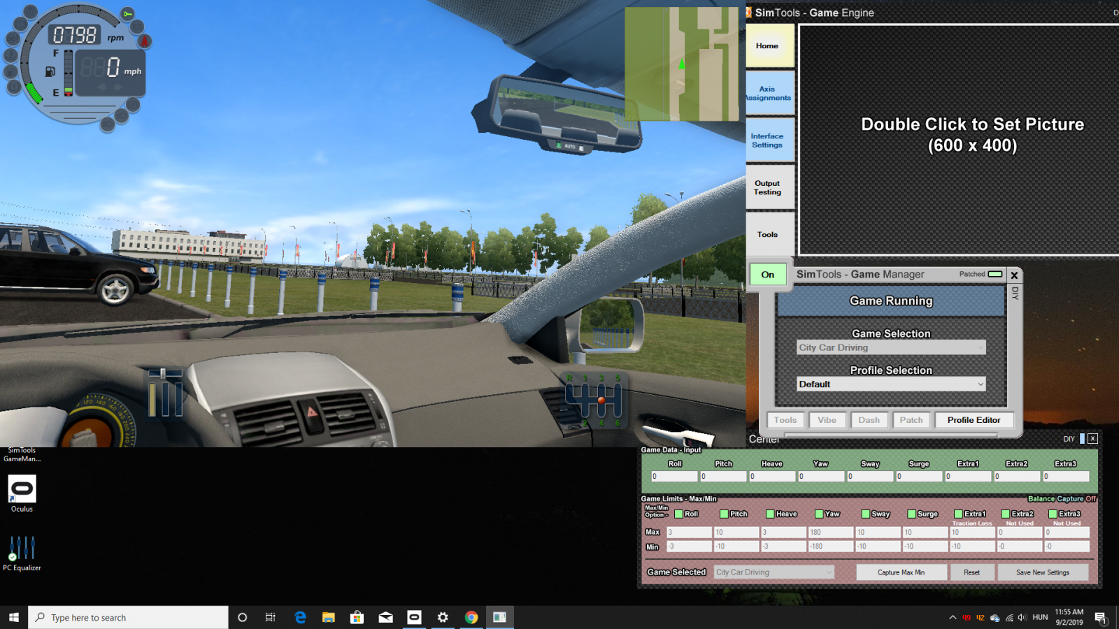

    Hi!
    I'm running Simtools 2.4 Diy.
    No telemetry data coming from the tuning center.
    I've got City car driving home edition / Non Steam 1.5.8.2
    Please help me!!
    Thanks, Krisz

    Thank you for your reply. I am running in admin mode but no data coming .. :(

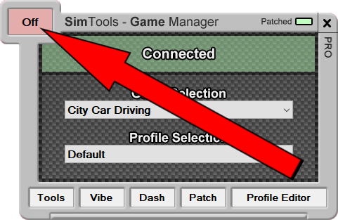

    Can you please try this:
    1) When SimTools and CCD running, turn off and on SimTools with the On/Off button on GameManager
    2) Only start SimTools GameManager and GameEngine after CCD is already running.
    Thank you for a feedback!

    Thank you very much! It works! hug:
    The joy is not full, because after a while, great impulses come from the game and I leap everywhere! Off and On Sim tools must always be turned on because they are going crazy.:confused:o_O:eek:

    Can someone help why telemetry crashes? The plugin is bad or the CCD is intentionally wrong, does not support the home version because the commercial version should be purchased ?? Is it working well for someone? What is true?:think
