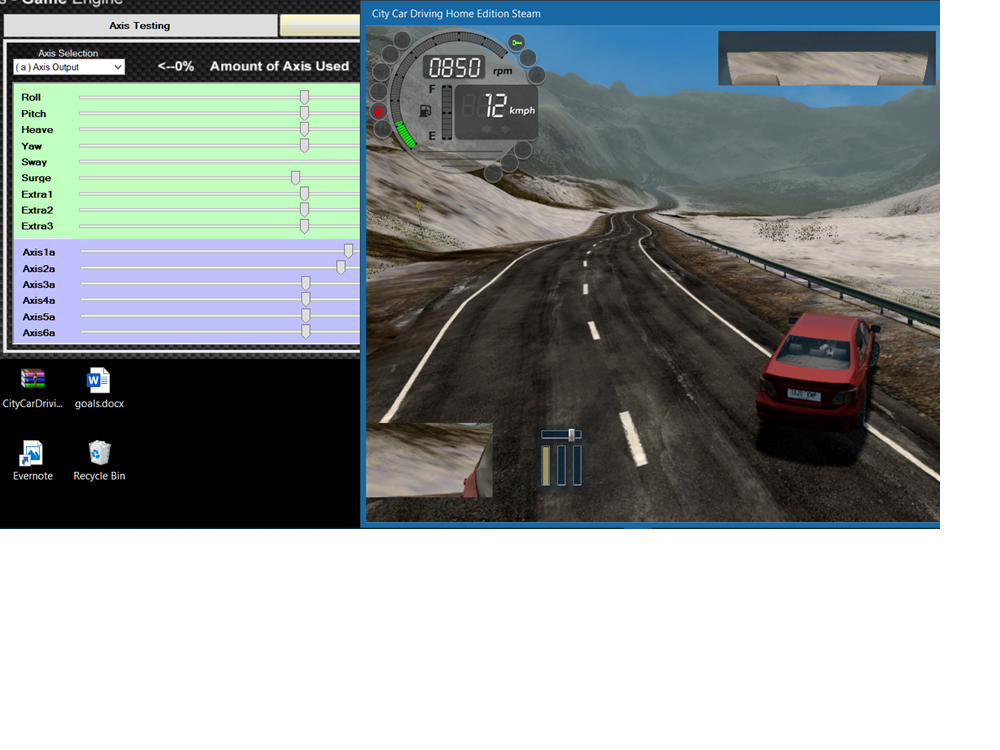

    Hi Guys. I have a working plugin for the new Steam version!
    Some words upfront:
    1- This is my first plugin ever, so try it on your own risk.
    2- The game does not make it easy to find the memory variables. The pointers I could find have seven levels of pointers to pointers....
    3- It can be jerky when you reset your car or crash. Be a bit carefull with that!
    4- It might need some adjustments in the Tunning Center, I myself could not find nice adjustments for Pitch and Roll yet (the game is almost flat always)
    That beeing said, the plugin works for Steam Version 1.5.9.2 and supports Roll, Pitch, Sway and Surge.
    Let me know if works for you guys.

    Hey presto! It works on my Steam Version 1.5.9.2 and I am enjoying the Sway and Surge for the first time on CCD!. Important thing to do is to run the game first and then launch the SimTools. I have traction loss as well on my Axis Assignment, but doesn't work. May be I am asking too much at this stage.

    Hi @BrazilianGuy, I have noticed that whenever I activate "The Next Camera View" button, the "Surge", surges ahead; the amount of surging seems to be proportional to the speed of the car. Happens while driving in forward or reverse, but not when stopped. Apart from this, this Plugin is really good.
