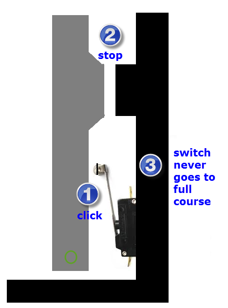

    nice handbrake! @Cluclu
    it seems that there is no mechanical stops behind the switches... I'm affraid your switches are not desgined to act as a mechanical stop
  5. Cluclu
    Cluclu Member
    May 26, 2015
    56
    443Coins
    +28 / 0 / -0
    Thank you , the switches are very strong is what I use in my job. If indeed there would be a concern I would add a stop on the lever to prevent damage to the switches
  6. RacingMat
    2,237
    21,047Coins
    something like this
