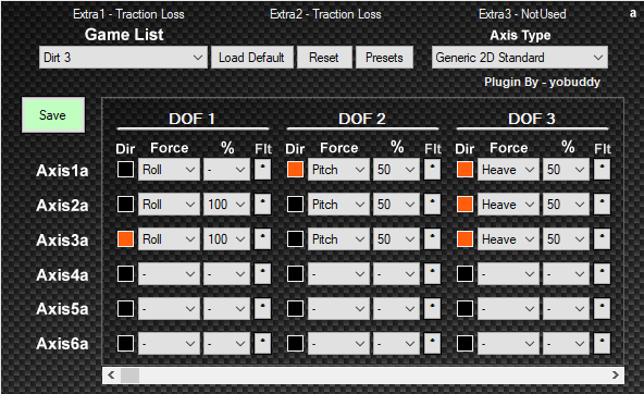

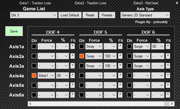

    Guys, when you look at the following settings for my 4 axis, would you recommend any change? Is it ok to put 100% for Roll although this DOF is shared with sway? Should I put 50 for each instead? I also increased the Main Level intensity to 100 % in Game Manager to have stronger force. Thx

    As I already pointed out Axis Assigments of 200% total are way too high and you need to refine your motion profile following the steps in the already provided link: https://www.xsimulator.net/community/threads/codemasters-dirt-3-plugin.4763/page-3#post-153479
