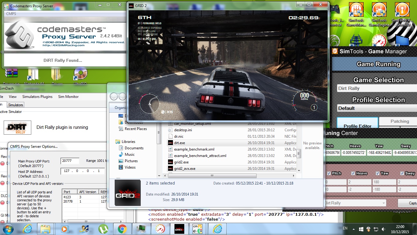

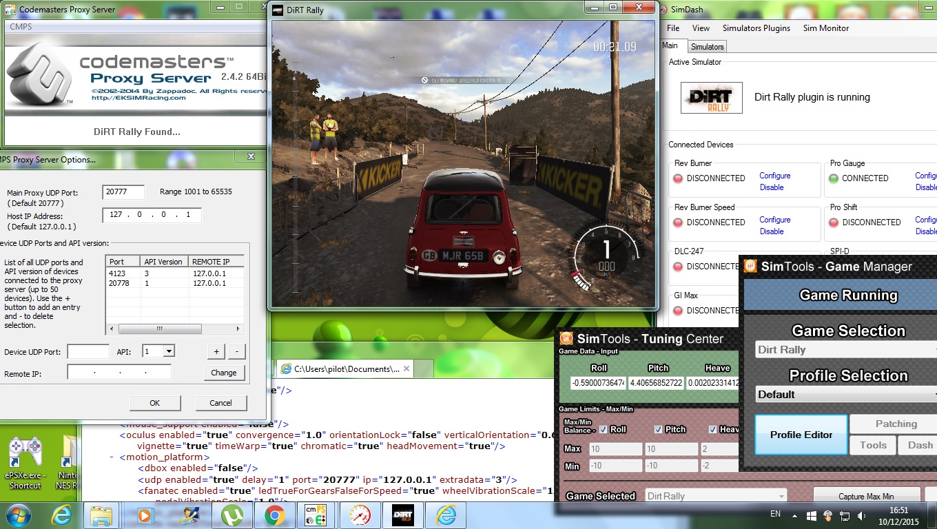

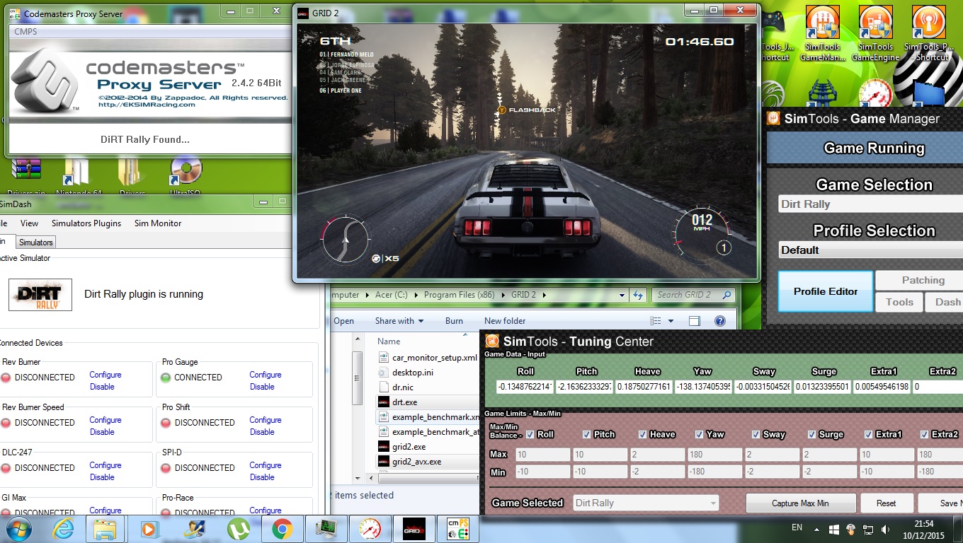

    hi every one again
    i managed to make codemaster proxy server work for simdash and simtools to give motion and dash reading
    but that work in dirt rally but only
    its not working in grid2 or any other codemaster games
    is there some thing i have to do with the plug in or it needs to be updates
  7. tombo
    tombo Active Member
    Oct 5, 2013
    283
    1,969Coins
    +249 / 2 / -0
    DC motor, Arduino
  8. puresound
    puresound New Member SimAxe Beta Tester Gold Contributor
    Jul 20, 2014
    12
    43Coins
    +5 / 1 / -0
    AC motor, 6DOF
    @tombo thank you so much for your help
    i find a way to make all codemaster games work with one plugin
    i choose dirt rally plug in because it support simdash and simtools
    by doing simple thing :)
    Example :GRID2
    copy the grid executable (grid2_avx.exe ) to your desktop
    then rename by (drt.exe)=DiRT Rally.
    return back the file to the folder and execute it
    all of CodemastersProxyServer_v2.4.2a + simdash + simtools will see the game as DiRT Rally
    all the best

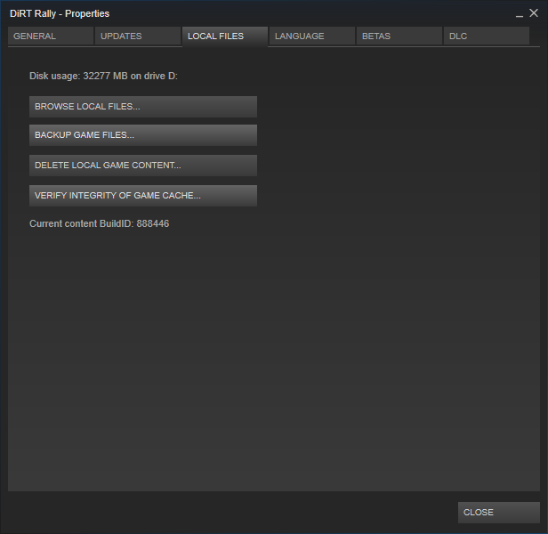

    Or
    • Unpatch the game in GameManager
    • Delete the files in C:\Users\User\Documents\My Games\DiRT Rally\hardwaresettings.
    • Delete the file "hardware_settings_config.xml" in C:\Programs\Steam\SteamApps\common\DiRT Rally\system.
    • In Steam select the Dirt Rally properties Verify Integrity of Game Cache…
    • Run the game once.
    • After closing the game patch it in GameManager and enjoy!

    I also tryed:
    <udp enabled="true" extradata="3" ip="127.0.0.1" port="4123" delay="1" />
    <udp enabled="true" extradata="0" ip="127.0.0.1" port="20777" delay="1" />
    But Simtools game manager stop work
  20. gigi
    gigi Active Member
    Nov 16, 2013
    467
    920Coins
    +141 / 1 / -0
    2DOF, JRK, 4DOF
    in C:\Programs\Steam\SteamApps\common\DiRT Rally\system. the udp string is <udp enabled="false" extradata="0" ip="127.0.0.1" port="20777" delay="1" />
    I didn't change it after Verify Integrity of Game Cache…
