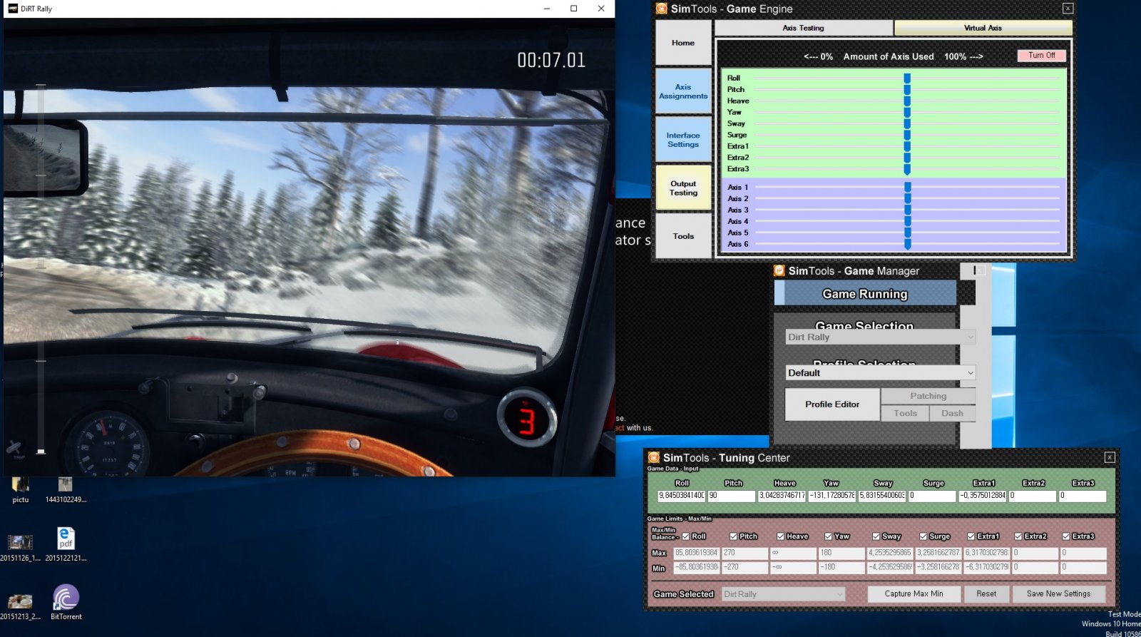

    no motion... any idea?? uhm...
    simtools seems to get the telemetry data from the game but no motion... refer to the attached screenshot.
    please have a look.. your help would be appreciated..

    It seems pick up wrong data. I do not know various version exists? Depend on OS Language or STEAM version. It happen on other Codemasters game Dirt3 too.

    Back when I found this bug I noticed that it only happens while you are in windowed mode. It also does the same thing in Sim Commander so it is a problem with the telemetry coming from the game rather than a Sim Tools bug.
    As far as I am aware the bug still exists, I am currently building my new PC so I don't have my motion simulator set up so I can't test it again.
    Try it in fullscreen and it should work fine. I have some videos of the problem in the link that @prodigy posted

    No success with full screen too.Change a little when I set the delay="1" to 2 to 20 values. I aware this Dirt Rally supports Oculus Rift natively WOW, need a motion seat to avoid VR sickness.

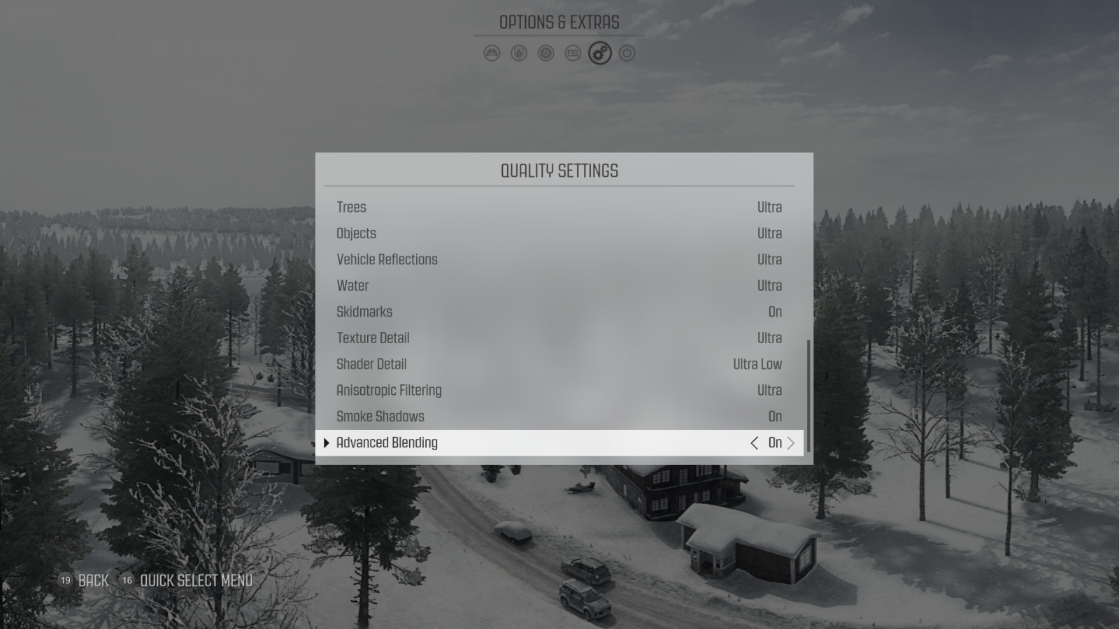

    There is also some kind of Blending option, don't remember now whats called, but I've found it's taking good amount of FPS.

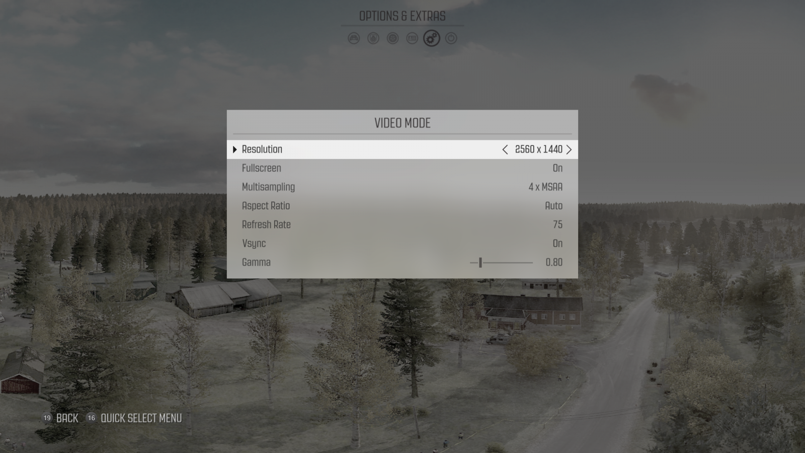

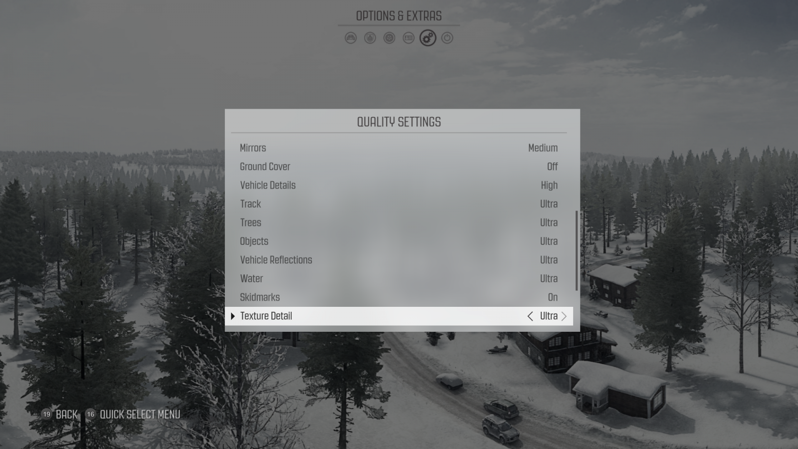

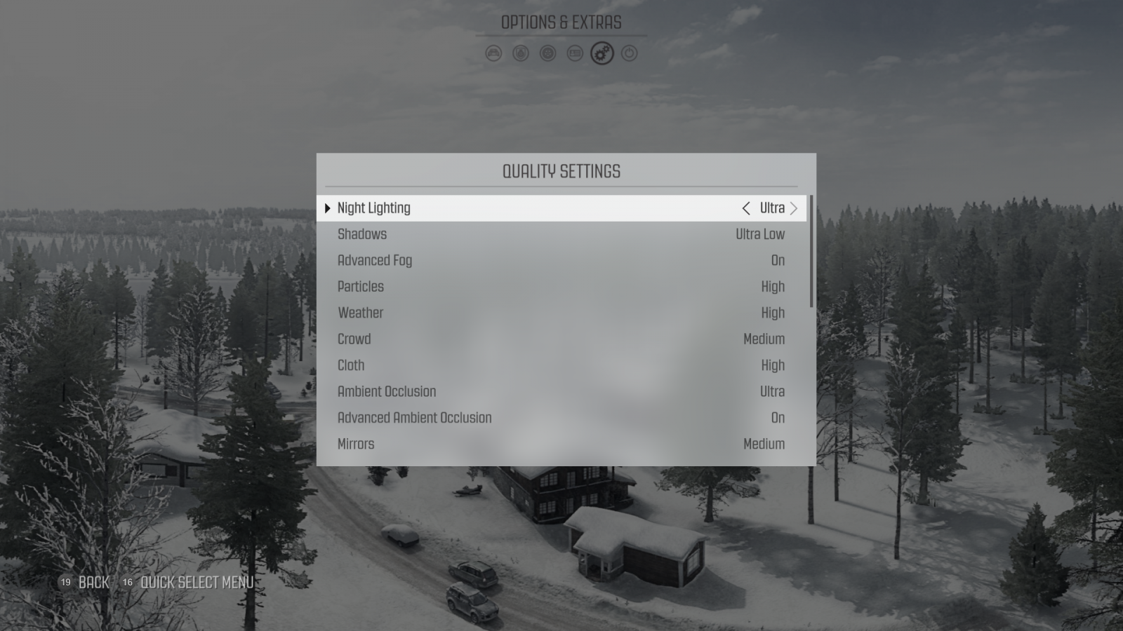

    Best advice I can give is to run it at 2560x1440 at 4xMSAA. Make sure you are in FullScreen always !!!
    Turn Ground Cover - Off
    Turn Shadows - Ultra Low
    Turn Shader Detail - Ultra Low.
    I have everything else set from Ultra to Medium I get a steady 75fps on my GTX970 no judder at all.
    With your setup maybe you can increase things I would think, but I would just try those and see what you get and take it from there, but ground cover and the shader kills mine its judder and ghosting city.

    ALT+ENTER = FULL SCREEN
    or you can go into the menu as above ^^^^^^^^ in the screenshot and select it.
