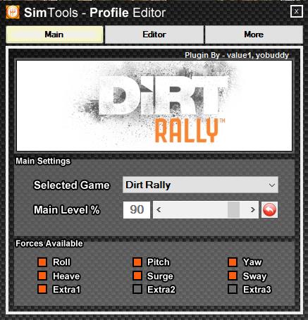

    Finally today I feel I got some normal motion from it by turning the main level in the game managers profile editor down to 90% ( I played with 95% - 99% all still had weak sway caused by the overwhelming jitters)
    At 90% the sway/surge effect aren't removed by the constant jitter, you can feel the movement of the car and the road surface again and still have a heave effect that relates well. Give it a try and see if that helps, I've yet to play around with it much more since first trying these settings.

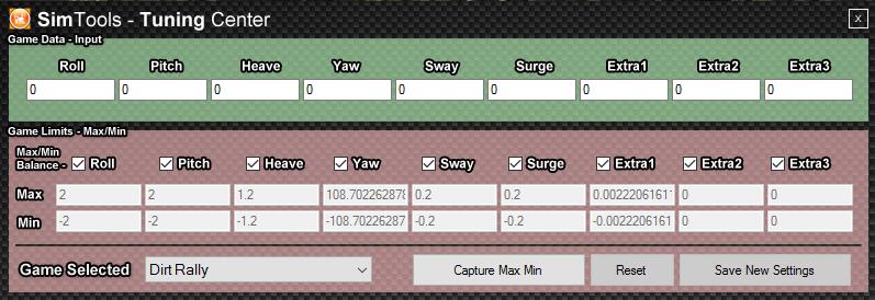

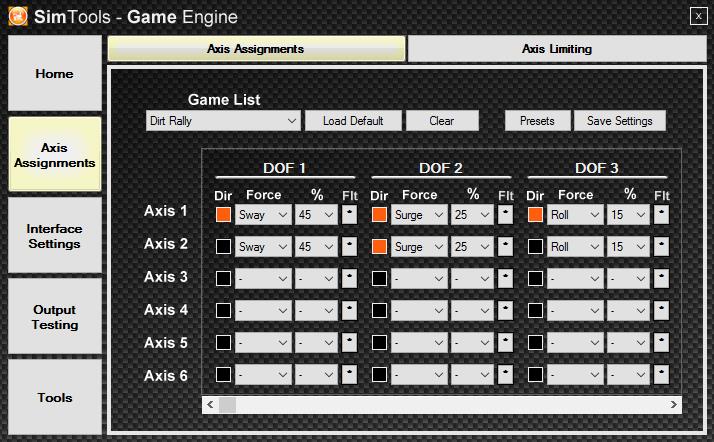

    So I reset all my tuning numbers and started again to test out the 90% level , these are the axis settings and tuning numbers. A lot lower than before on the tuning numbers and I added a bit of sway in the axis assignment. But the movement was really good, seat wasn't shaking like crazy on the start line and moves around nicely with sway/surge & pitch/roll all clearly present. Road surface is still bumpy as expected, but if you stop the car then it feels like normal engine idle motion rather than previous when it was all over the shop no matter what.

    You had the same issue as me @Goatboy and @Tim McGuire
    I found I had tuned my Sim too well. What I normally do to tune my Sim (after I have the axis set) is turn my main level down to 10%, then set my Tuning centre values to 0 and then go for a drive and try not to crash, while I am capturing the values in Tuning Centre. Then I save the values, turn the main level back to 100% and fine tune from there.
    (If you try this method, make sure your main level is 10% (or lower) before you reset the value in the tuning centre to 0!! - First time I did it this way with main at 100% I got shaken so hard I struggled to reach my emergency stop!!)
    What I found in DR was that the values are always moving and I had tuned them too close, so at the start line my sim was still shaking even before the car set off. Once I upped the values in the Tuning centre and increased the Axis %, I was getting much better movement.
    My resulting values are very similar to what you have found. The actual output for the game is in the fractions on some of the values, heave for example can go between 0.0054 and -1.xxxxx, so of course the closer you try to get to those numbers, the more "sensitive" the sim will be to large jumps in those numbers.
    I was trying to be tooooo fine. Clearly....

    To me, it's as if the signal clips once main level is turned over 90%. I tried putting higher numbers in the tuning centre but it would only completely wash out the desired effect and just leave the jittery effect as if you were driving a solid suspension car down a cobblestone road. Tuning it further today, a test would be at the start line, if I rev the car the seat motion should settle, and the motion when the engine idles shouldn't be excessive. I wasn't able to achieve that whilst main level was anywhere between 92%-100%

    Surge shakes like someone with alzheimer's when main level is set to 100% and tuning center numbers are in single digits (this is all whilst car isn't moving and I'm standing on the brake). If tuning center is set higher for surge like at 10 for example, jitters are reduced slightly but so is the influence surge has on motion, ie no movement is experience at the seat when on and off the throttle or whilst braking.
    With main level at 90% I've been able to tune it so I feel engine revs , brake and throttle surge, sway whilst turning in , the pitch and roll of the road and road surface but the most fun of all...jumps. And yes JRK are at 600 , PID 37/0/50 and only shutdowns are coming from a soon to be replaced PSU. It might not be how you've done it, but as you said, the data is in general super sketchy, this is what works best for my setup.

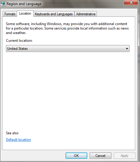

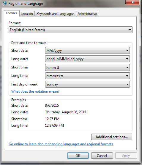

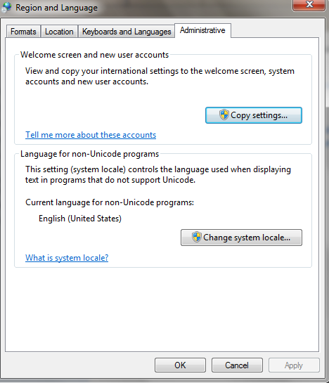

    Did you guys solve your issue? Just acquired Dirt Rally and experience the same effect: I'm shaked like crazy on the start line and then very random movements...
    I've read the whole thread, and applied why worked for others like switching the OS to English (UK)... But nothing really works. While reducing the main level at 90% allows to get rid of the shaking on the start line, the rest of the motion still seem to be mostly random. Any help appreciated.

    did you go in control panel - region and language and change Format , Location tabs and on administrative tab the Language for non-Unicode programs , into English
    [​IMG] [​IMG] [​IMG]
    or did you change your OS language into english.
    are you having the same issues with other games too?

    Thanks for trying to help :) I did the steps you indicate, didn't touch the OS language so far (already in English anyway).

    Ok, so I made a video to explain what happens:
    As you can see in the tuning centre, some values (only Sway, Surge and Heave) reset to zero from time to time. Increasing the delay in hardware_settings_config.xml doesn't help, the proportion of "0" within all the values remain the same, no matter how often we receive these values. FYI, I have applied a large filter on my axis while recording this video to avoid being shacked in every direction.
    I have no idea where the problem comes from, but I'm pretty sure this could be filtered within the plugin... @value1 , I don't have access to its code so I can't do it myself, but I would if I could. ;)
    Any idea of what I could look at is much appreciated.
