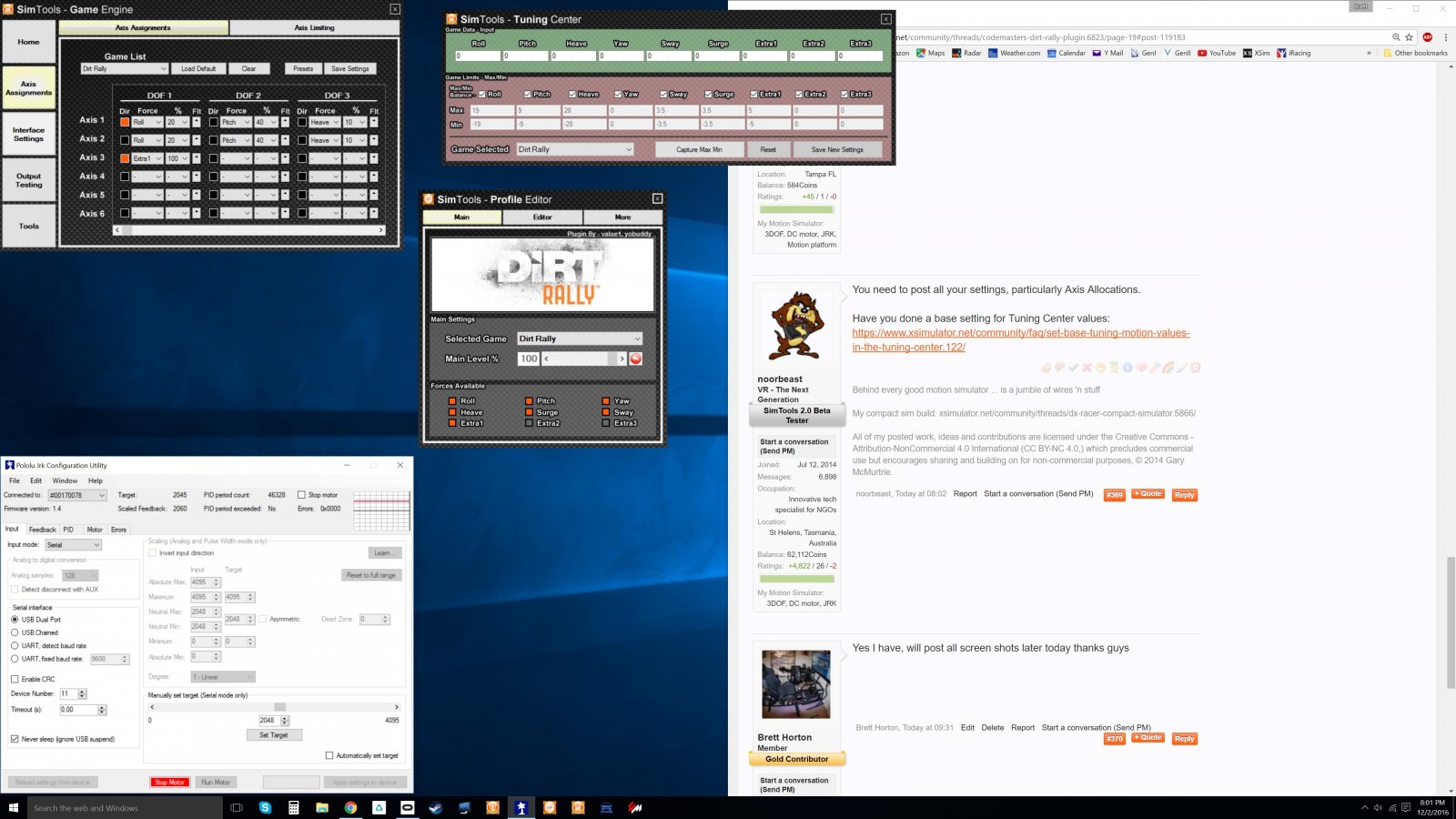

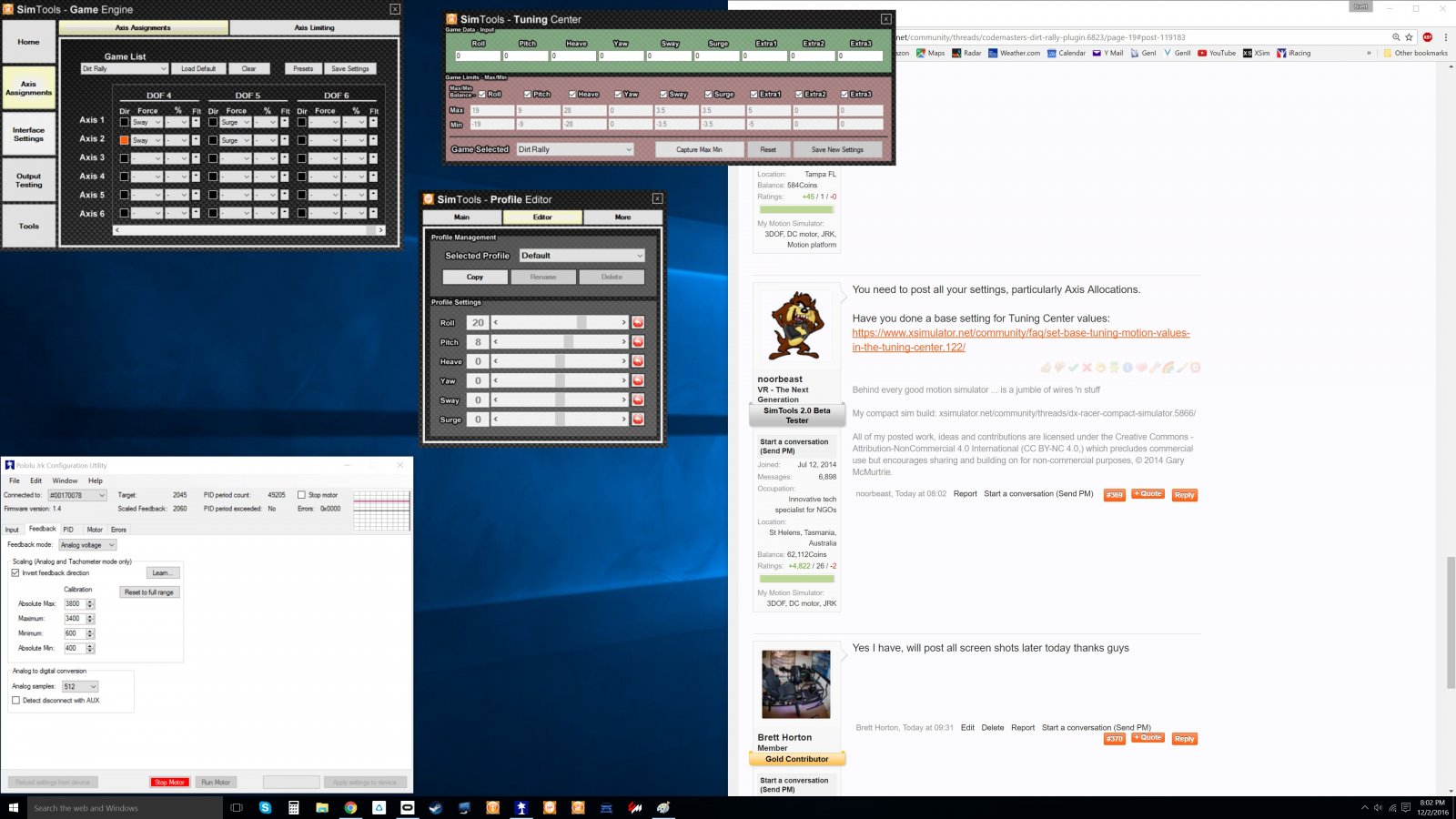

  15. Brett Horton
    Brett Horton Active Member
    Aug 18, 2016
    310
    Program Manager / Pilot
    Tampa FL
    118Coins
    +202 / 2 / -0
    here is what it is currently. I have heave, sway, surge off from output though Dirt 5.jpg

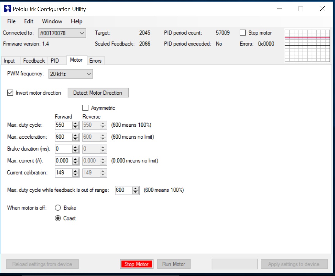

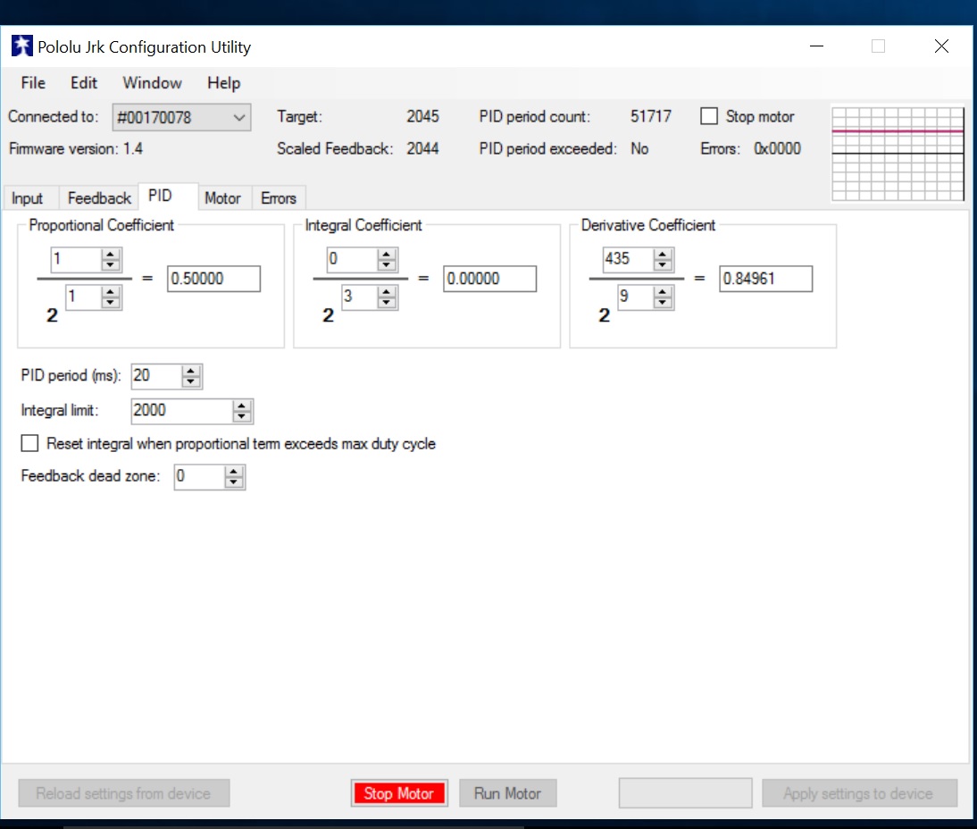

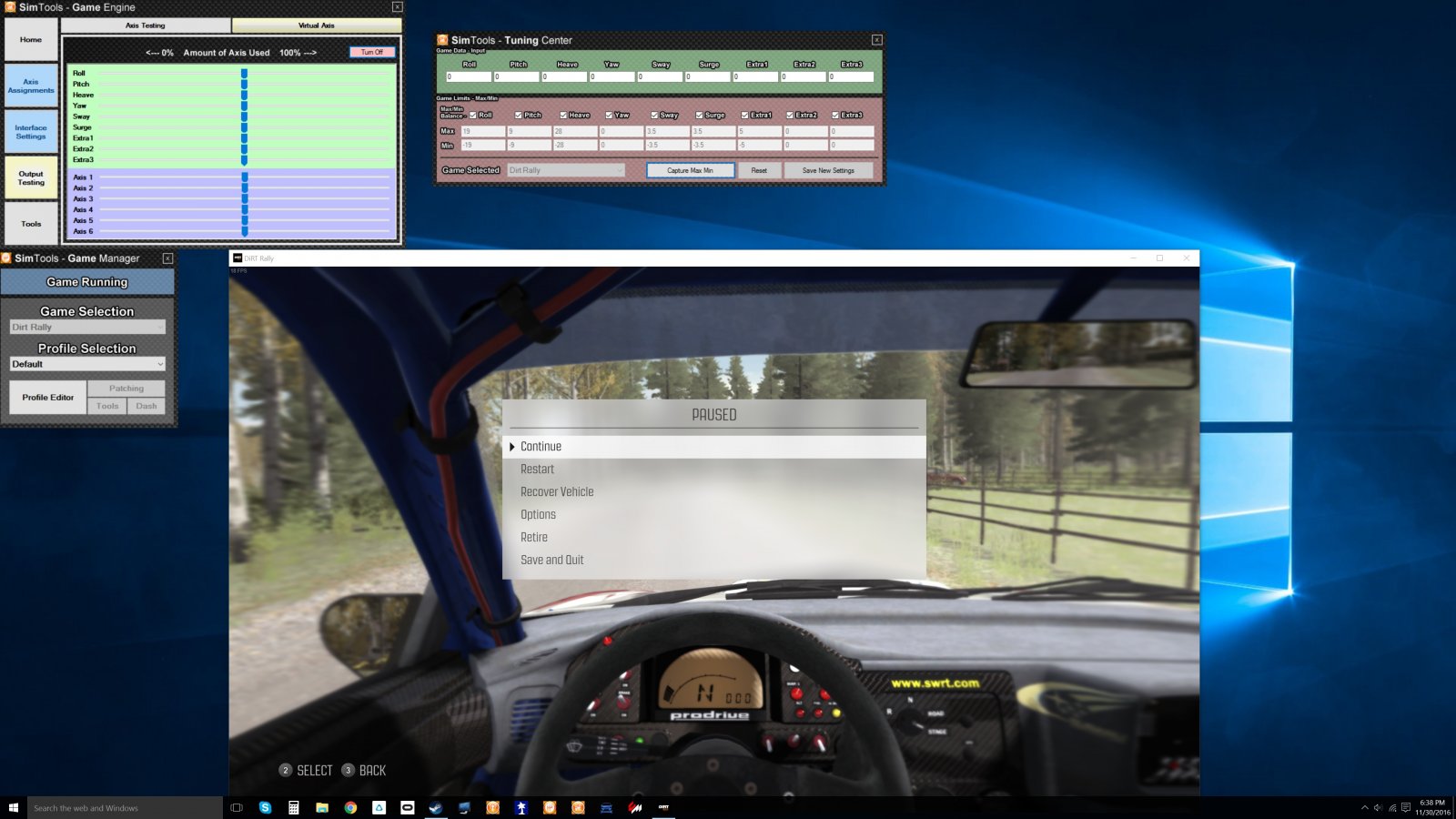

  19. Brett Horton
    Aug 18, 2016
    310
    Tampa FL
    118Coins
    +202 / 2 / -0
    here are all my settings in Dirt...
    Left and right motors are identical in the JRK Utility.
