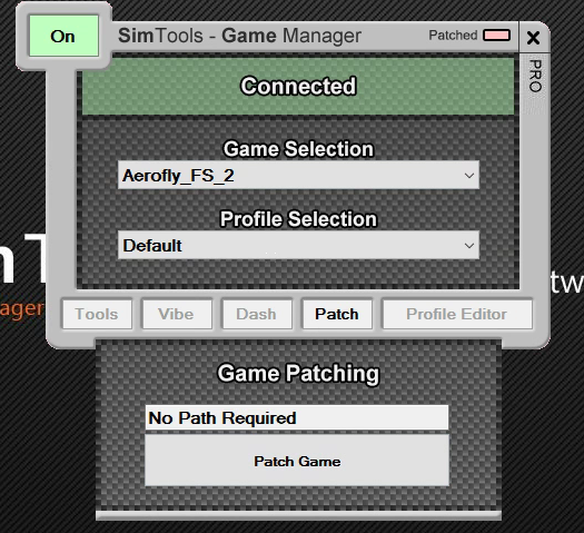

    I'm testing version 2.0, it does not work sway, surge and heave. When the vehicle is stopped pulls many values, but when it begins to advance the values of these axes are paused. The rest of the axes works. Which may be?

    I have already found the solution. In windows mode, there are axes that do not throw data. You have to put the game in full screen and there if it works normally.

    OK, you need to set the IP address in the software on both computers in the simtools software but first unpatch and then repatch the game.

    You just need to click the patch button in the UI like you did when you patched...Youre not adding in the patch itself..remember where it has a directory you have to find sometimes? That is where.

    There is installing a patch and then there is applying the patch...you just need to unapply the patch..

    You need to click the patch button to unpatch
