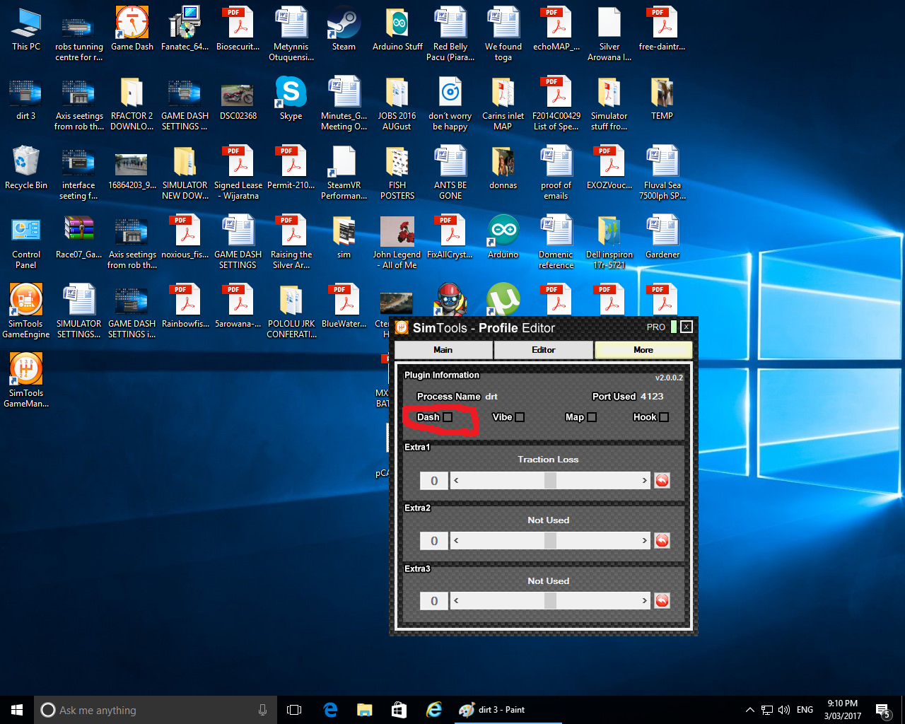

    Can some help me please Codemasters Dirt Rally Plugin 2.0.0.2 doesn't seem to work with Game Dash ,its not present in Sims tool profile editor .Work fine before with sims tool 1.3 version .Look at picture ,I have added pic of Profiler Thanks Domenic dirt rally.png

    Could someone with the dirt rally game and plugin installed try editing the DBOX line of the hardware_settings_config.xml to True?
    Then run the game again and see if it makes a difference.
    Since they added DBox support for this game, I wonder if its messing with the UDP output?

    Dbox = true motion is ok
    Remove Heave parameters in axis assigments ( put heave = 0)
    The pitch and roll value from the game are ok (tuning center and real test)
    Sway Surge and Yaw Values from the game are freezing during many seconds, depending of track.
    We must wait that Codemasters improve the telemetry or just use the pitch and roll value inside Axis assigments.

    @prosimu
    Hi Patrick,
    Did you edit the file like a said above?
    Seems to have fixed the problem you describe in your post buddy!

    @yobuddy
    Yes, we have edit the file and change only "Dbox= false" to "Dbox= True"
    Motion works put you need to put heave = 0 in axis assignment, if you don't do this, the motion is like a shaker.... ;-)
