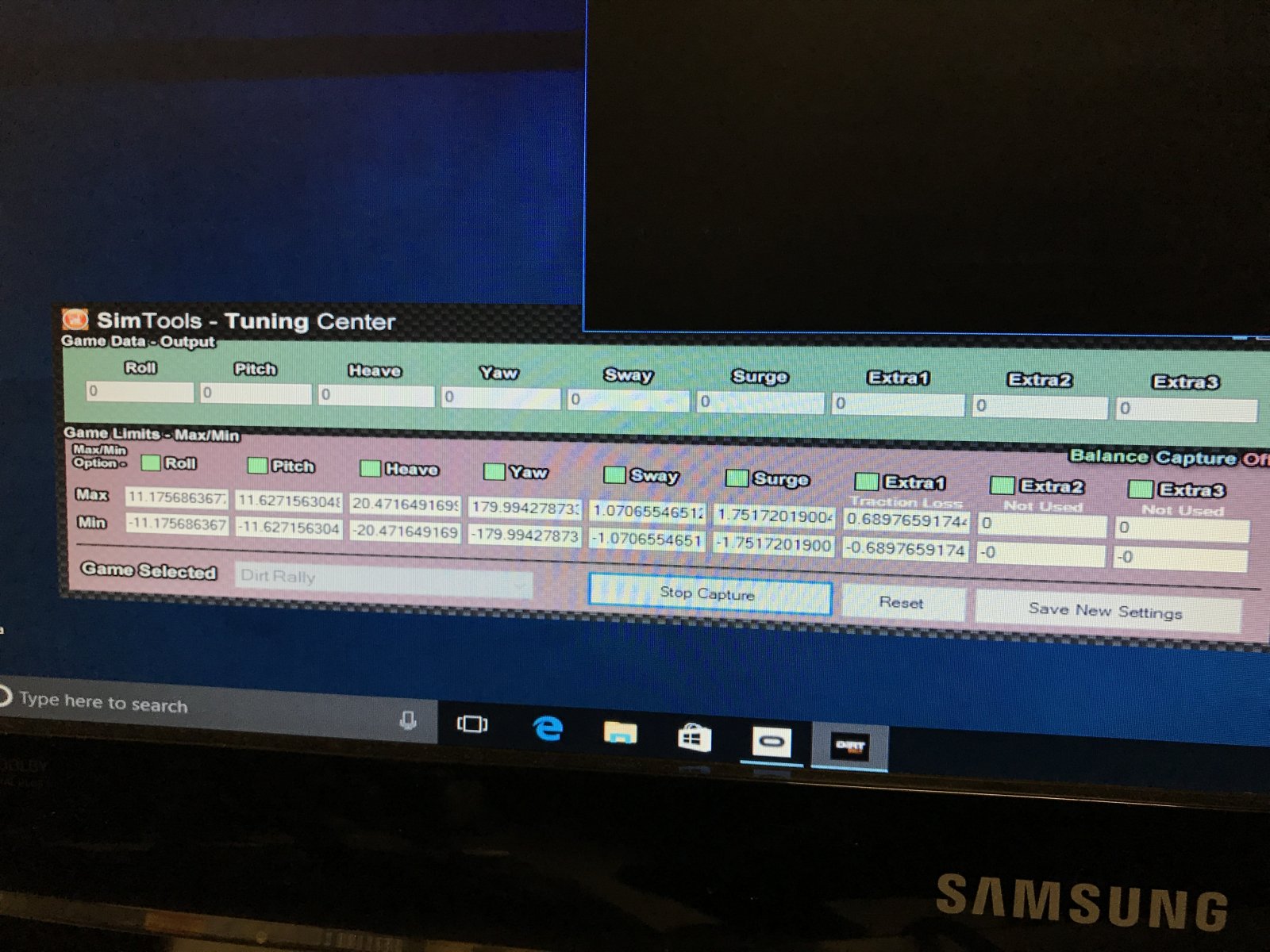

    Hi @value1 ,
    I'm having a hard time trying to get Simtools working with Dirt Rally any ideas?
    It just seem's to be going crazy!!!

    an you please post screenshots of your SimTools Axis Allocation and Tuning Center settings.

    Hi @noorbeast,
    I'll have another go tonight, but this was a screenshot I took last night, every time I click stop capture all the data/values disappears.
    Should I just manually enter these values into the Axis Assignments?
